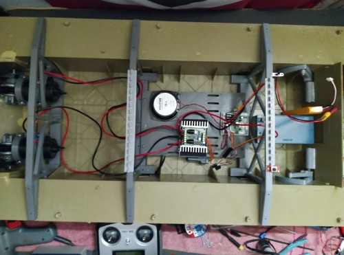

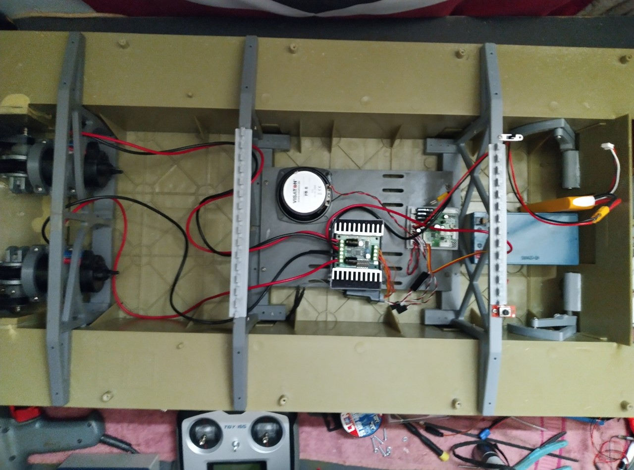

Mr. Biasphere,oddballseattle wrote:Looking great!! looks like you are using spyker also for the RC conversion. I am building Oddball's tank myself. I am working on the turret with the recoil action but don't know how to program that in my controller. Are you doing the recoil for the barrel?
I see that it looks like you cut in half and spliced back together the lower (pink) hull stiffeners. Would you share your reason?

That's not my tank mate that's Oddballs's I think.BarryC wrote:Mr. Biasphere,oddballseattle wrote:Looking great!! looks like you are using spyker also for the RC conversion. I am building Oddball's tank myself. I am working on the turret with the recoil action but don't know how to program that in my controller. Are you doing the recoil for the barrel?
I see that it looks like you cut in half and spliced back together the lower (pink) hull stiffeners. Would you share your reason?I ask because I have the Spyker sets for my 1/6 Dragon kit.
Barry
This is mine if it helps ?

OOPS!!! SorryBiasphere1 wrote:That's not my tank mate that's Oddballs's I think.BarryC wrote:Mr. Biasphere,oddballseattle wrote:Looking great!! looks like you are using spyker also for the RC conversion. I am building Oddball's tank myself. I am working on the turret with the recoil action but don't know how to program that in my controller. Are you doing the recoil for the barrel?
Barry

I think what happens at that centre join for the hull stabilizers is some printers aren't big enough to print a complete stay so they do one at a a time then join them (I think) I have a huge printer so I'm good .

No issue at all mate .Biasphere1 wrote:OOPS!!! Sorry
Did you print your parts or did you buy them from Ryan ?
I'm printing right now I threw an idler arm out my fault , I'm a little ham fisted and where the hex rod received in the idler arm it broke .lol
Cheers .[/quote]
Yeah, my printer was not big enough, so I had to splice. It works fine this way.
