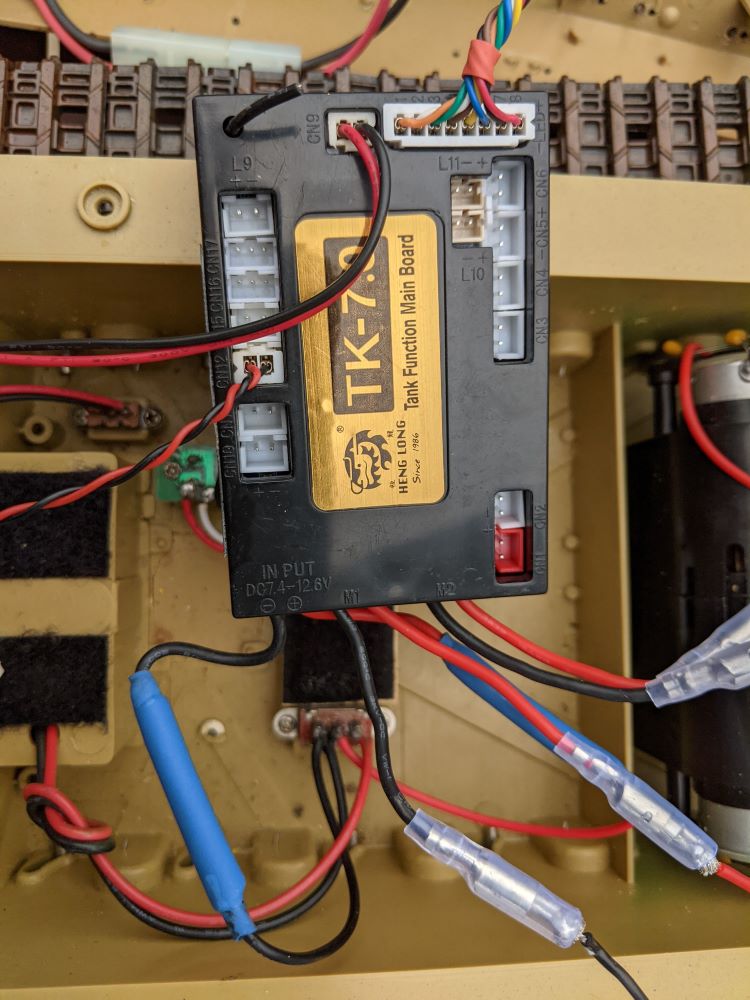

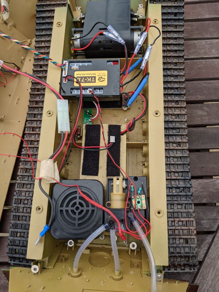

I already started, but I'm getting nowhere, to be honest. I'll get some pics of what I have done, pretty temporary, just to see if it worked. Don't laugh too much, I've spent around £130 on this baby to date. >:<

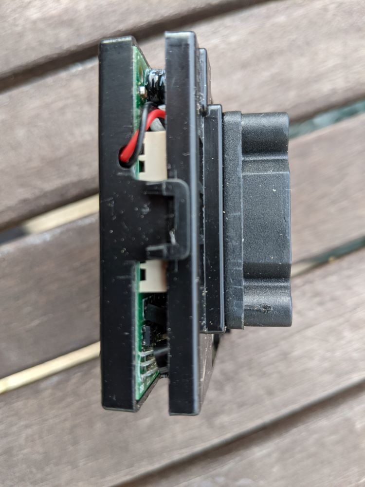

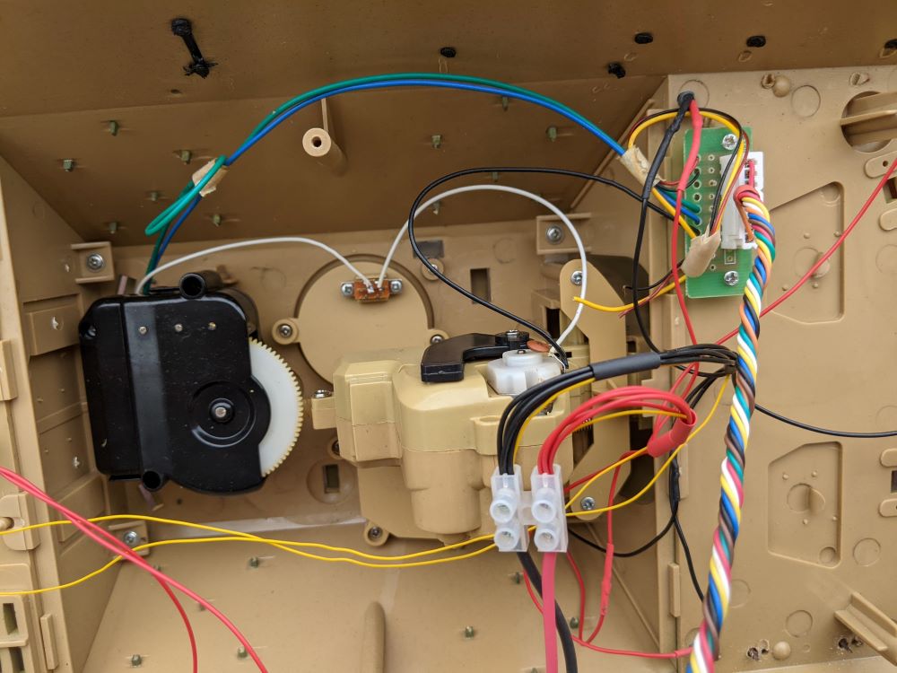

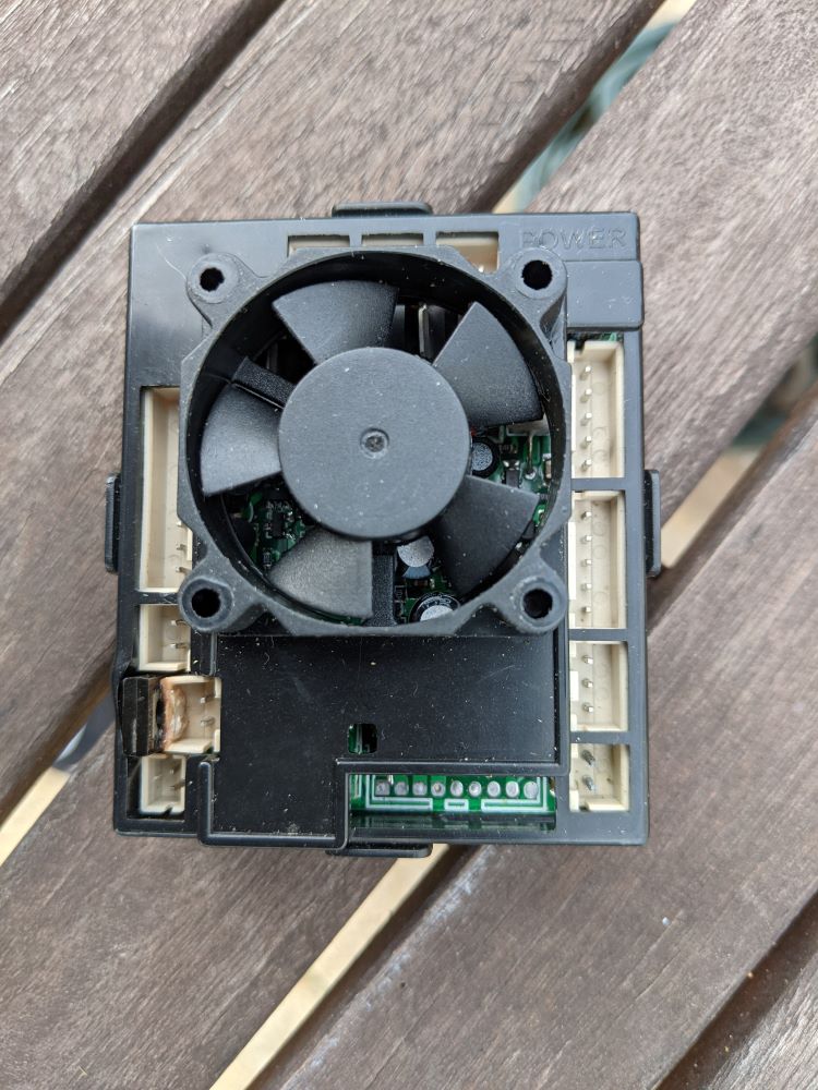

Pics of disconnected old CB.
old 1.jpg (85.52 KiB) Viewed 2349 times

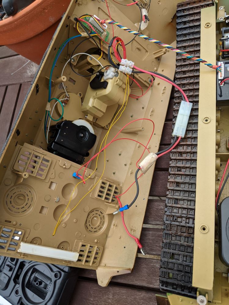

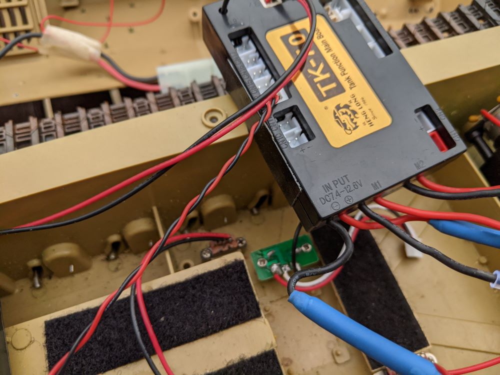

New setup and internals.
New 5.jpg (99.72 KiB) Viewed 2349 times

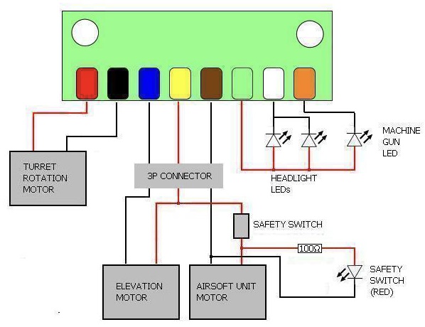

Hello, personally, following the diagram attached by John 70,
first I would do the test, just by wiring the two propulsion motors, the On / Off switch, the battery, do not forget to "Binder the radio, with the plate" and see what that is happening ? already make this work :thumbup:
PS: to avoid any worries, put the tank on a wedge, so that the tracks turn in a vacuum, otherwise risk of falling when starting

As wired, it doesn't work, no lights, no start-up on the transmitter, nada. I've wired the input leads to the on/off switch and the motor leads to M1 and M2. The CB has a 2 pin "Power" connector, according to the TK 7.0 wiring diagram I found on the net. I don't know where to wire this to? When I connect the battery and power on, there is 8v at the "Power" connector, but nothing on the other pins. How do I bind to the transmitter?

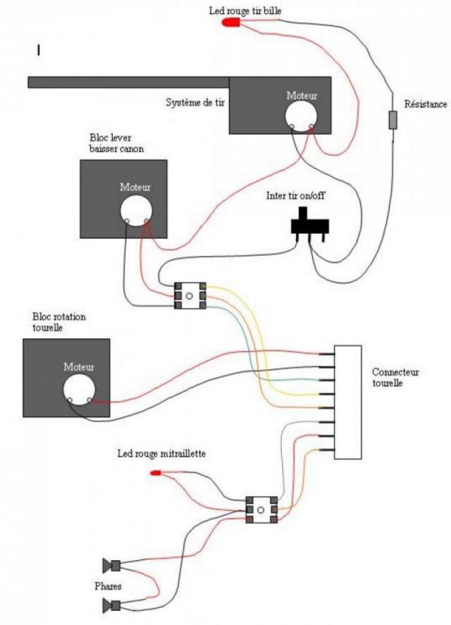

here are two photos of the original Heng Long wiring, hoping to help?
Original HL
couleurs des fils en correspondances avec la platine du châssis supérieur
you notice that the elevation and air sfot motor have a common wire, which is no longer the case with the TK 7.O

:'( be careful, unlike the existing board, the battery connects directly to Input, and the M/A button to Power, I think you shouldn't use the original switch? or rewire it in two wires? as in the diagram, I do not doubt your knowledge? just try to explain!!!
also see this post
viewtopic.php?f=79&t=31479

Stop before you set fire to the tank
disconnect everything you have attached. The tank needs a complete rewire the tk7 does not use the same connections as the taigen the 8 pin wire isn't used and it definitely doesn't plug into the led sockets connecting plus and minus terminals together.
