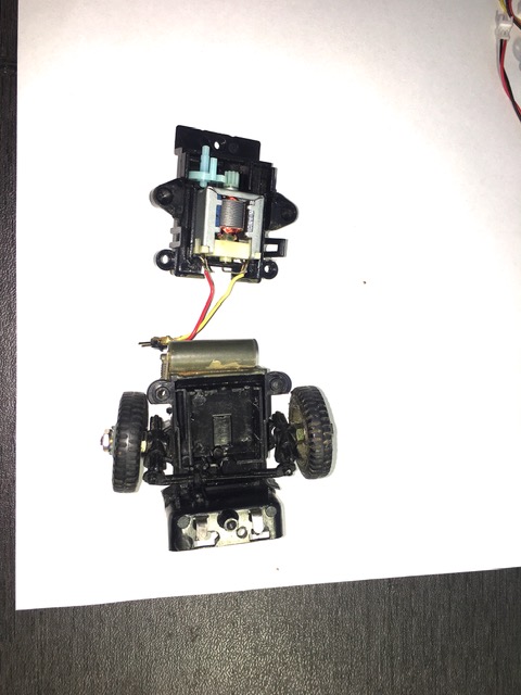

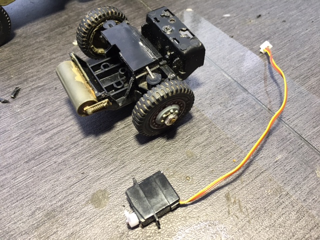

I took the old escapement from the M4 and converted it to a Servo steering box. I used a standard UM Servo in this one. Because you have to add linkage to the control horn of the Servo to the steering linkage, it takes way more time than using a screw drive Servo. I was determined to make it work with the standard Servo and spent way too much time getting it just right with plenty of throw as you need good steering movement and lots of it in a half track. Next one I will use a screw drive Servo. Anyway, I cut up the the Testers M2-4 or what ever it is to install the reworked steering box in the Testers model. I bought that model 3 years ago at Drug Mart for $14.0 and finally started the process of making it radio controlled today.
Servo gearbox test video
https://youtu.be/lFbILOotNVA
The Testers Halftrack now has a Servo steering box and is ready for the next step, A gearbox for the tracks
Servo goes in there to make it a Servo steering box
Escapement #2 gutted and ready for a Servo upgrade

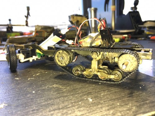

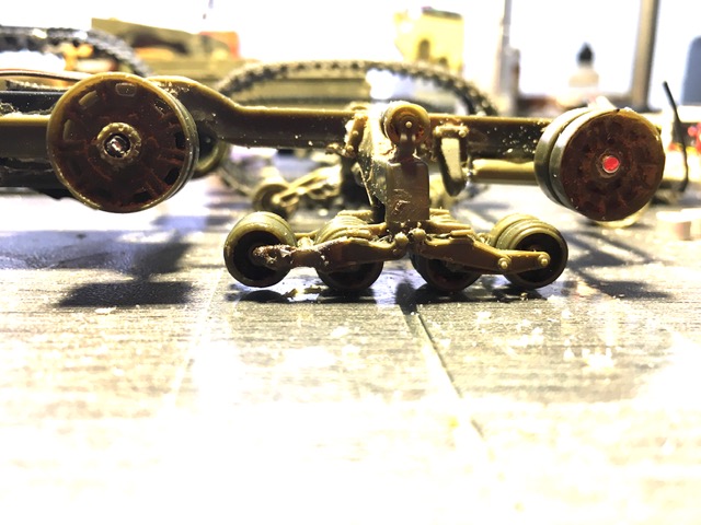

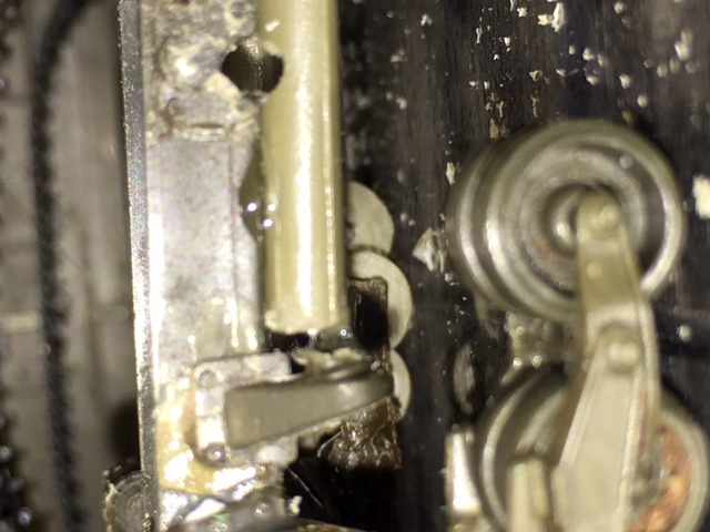

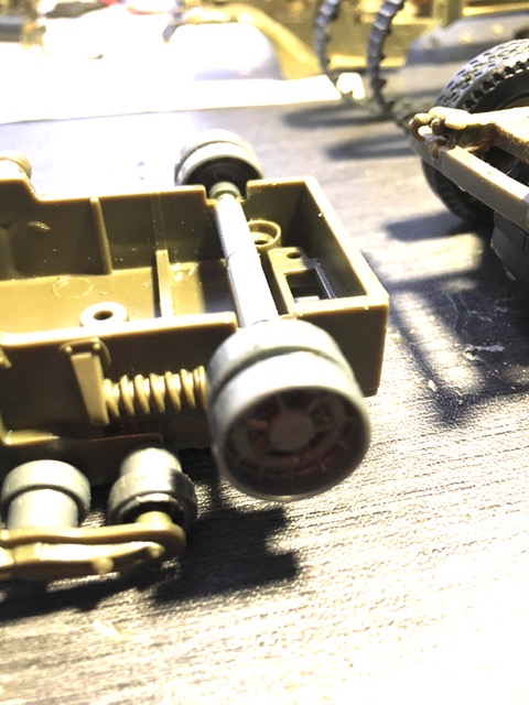

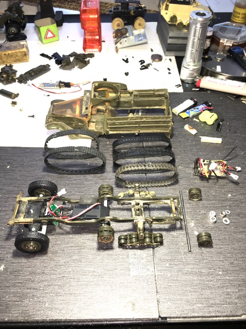

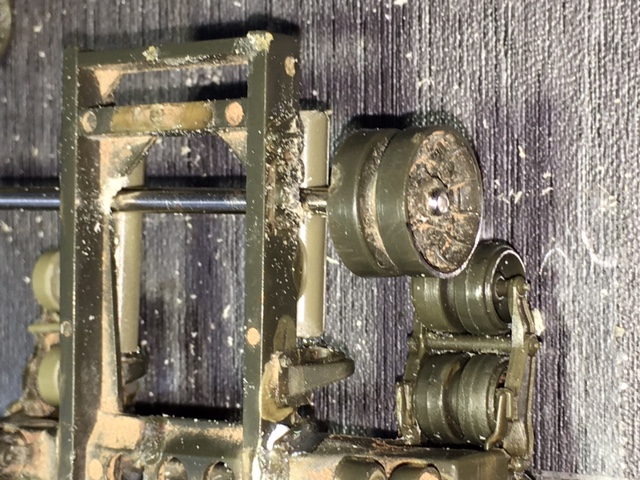

I am still working on this Halftrack. Yesterday I got to drive it a few minutes before the track idler wheels failed. They are weak on this model and need beefed up. Not doing anything too fancy just fixing the problem with basic repair methods
Both of these models are going to run. I have 3 sets of tracks for this model.
This is how the idler works on the Testers Halftrack, I used this method on the Tamiya's idler wheels
Idler wheel sits in the stock location more or less
Had to get creative here as the parts in this area were brittle and had to be cut out and replaced with parts tree material. Steel axle goes through the hole.
going for assembly here. Track idler wheels being repaired and beefed up.

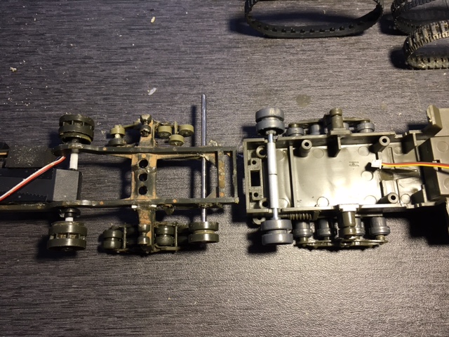

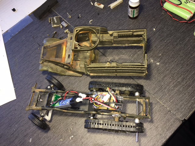

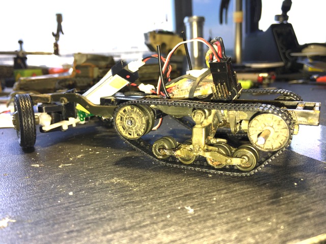

overhauling the Track idle wheels made all the difference :) Now it runs very well and despite my improvised Track roller repair on the right side seems to work very well as a rolling chassis test. Next is to install the body.
Chassis test with MTM gearbox driving the tracks video.
https://www.youtube.com/watch?v=qZNWn3-DFpA
Next step is to mount body back on the frame. Oh and to trim that protruding axle lol. The MTM gearbox is hidden under the radio gear.
Left side is original parts but now with steel axle for idle wheels. Idle wheel axle will be trimmed.
The parts that are a different color were the ones that were missing. Improvised "field repair" works well despite its looks.
Track idle wheels upgraded to steel axles

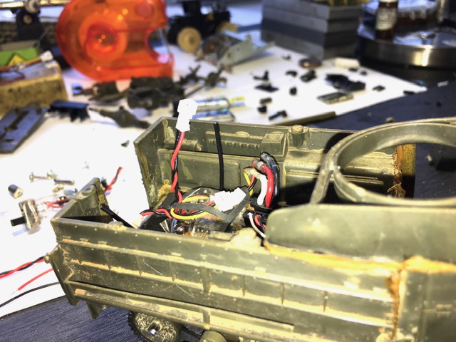

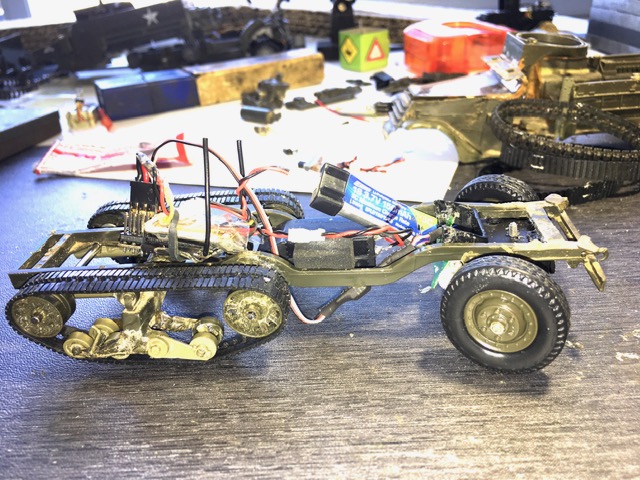

Ok I guess people are wondering if I will get this Halftrack going or what :eh: well I did finally get it going. It took more time than I would have liked but after driving it around on my workbench track I have to say that is was worth it to finally have a 1/35 Halftrack that is running on its factory tracks and rollers. Even though it is beat up and missing some parts it performs better than any other wheeled military model that I have. My M11 Tank transport Trucks can not make it around the track even with rear 8 wheel drive.
Oh and by the way, this build was only possible thanks to the very small MTM gearbox :D

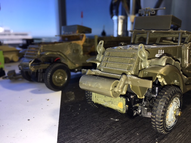

I am considering this model as my next project.
The MTM gearbox made this model as you see it here possible. I know of no other gearbox that is small enough to work in al model like this. This opens up a lot of possibilities for future builds that I will present here.

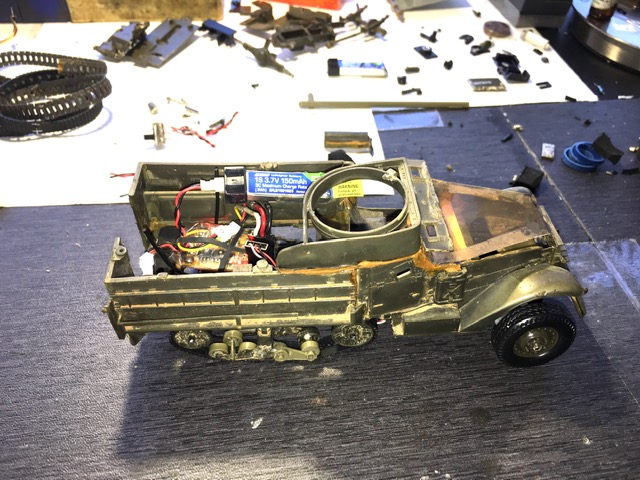

it is done and is fun to drive around my shop desk.

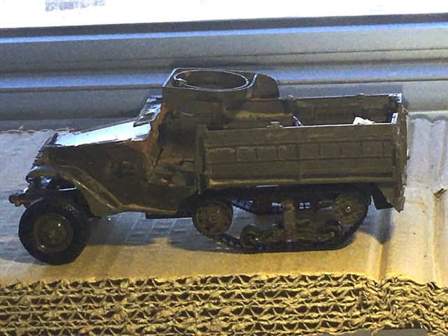

I figure this model is at least 37 years old (corrected). And regardless of what it looks like, it is Hobby Grade finally and is quite fun to run around my workbench.

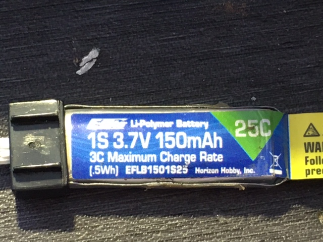

test radio installed. DSM2 with 1s ESC with LVC.
