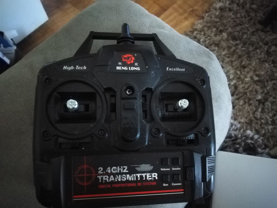

Im picking it will be a V5.4 as its a 2.4G with an 8 cable supply to a sub-board.
if the controller has 4 buttons on the lower right , its probably a late, if not, still a 2.4g but an early one .............
Got all that ??!! :crazy:
Its a 2,4G board, and thats good enough for now. All that having a late V5.3 might give you is a 2-option sound set.
Tiger 1
Leo 2
The next versions(V6.0 onwards) allow 4 sound options and various light and servo controls.
The V7 versions only have 2 sound sets, but different pairs (tiger 1 & Leo2/T90 & abrams) that I know of.
As advised by Mr Jofaur, there are lots of guiding posts in the H/L electronics section that should enable clarity on just what you may or may not have.

Yes the tx has the 4 buttons fight hand side

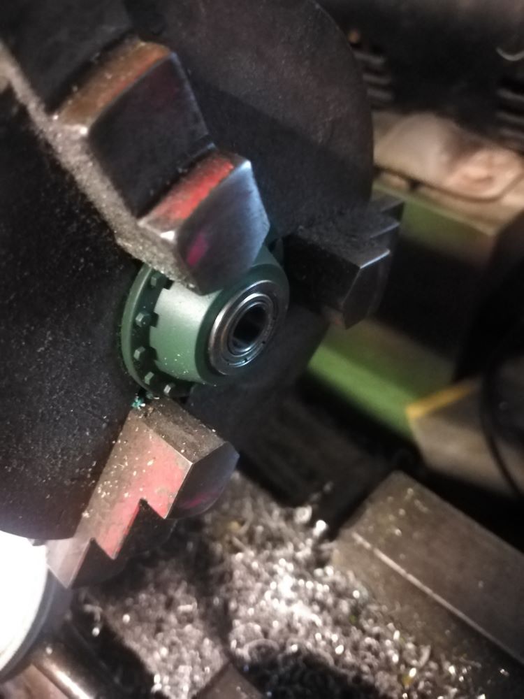

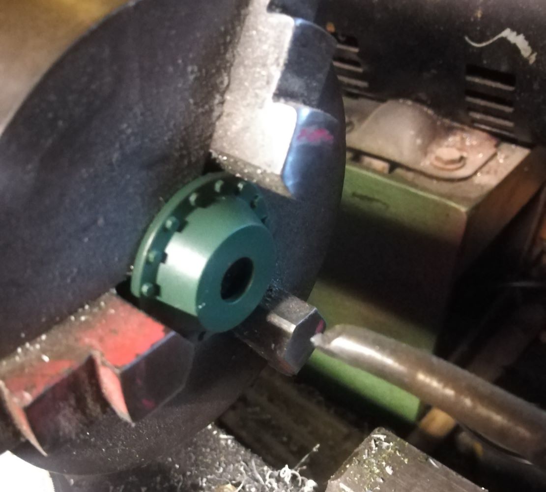

Got it in bits last night so I can start on adding the bearings and looks like it could do with a bit stiffening up inside the hull
Did the Idle wheels today at work just a drop of locktite on the bearings and fitting bolts has transformed them

this is the tx
sticker inside the hull has a sticker with 2015 on it

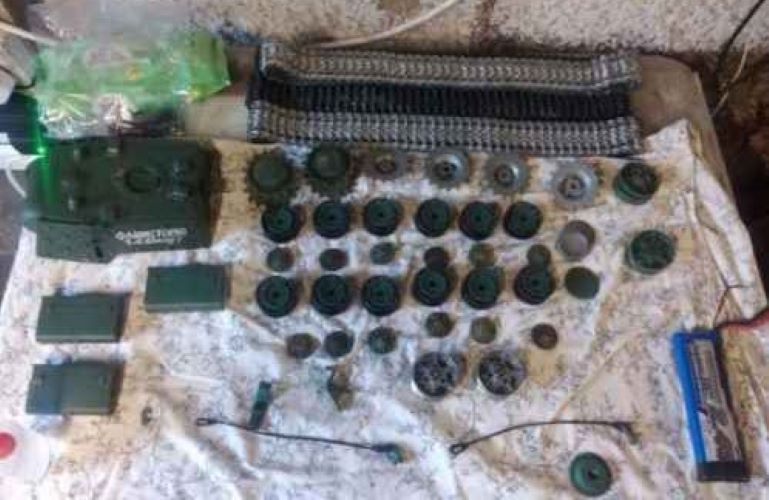

all in bits washed with soapy water ready for primer

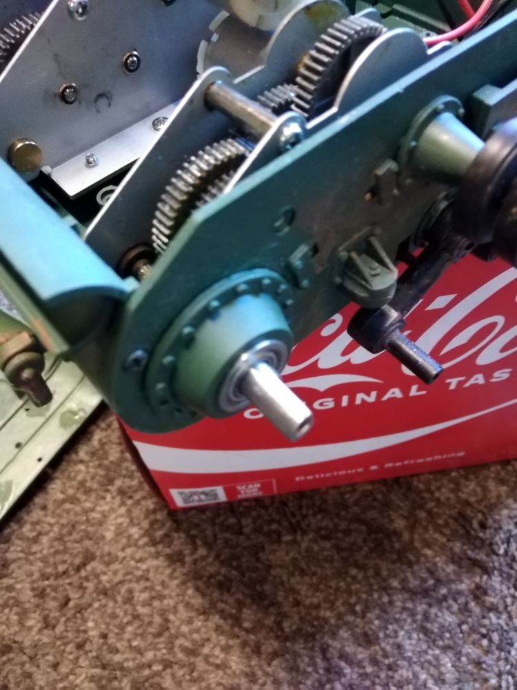

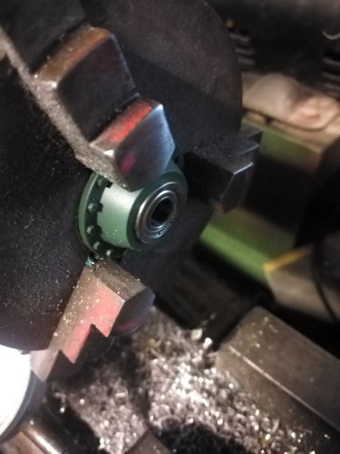

managed to get the bearing fitted
