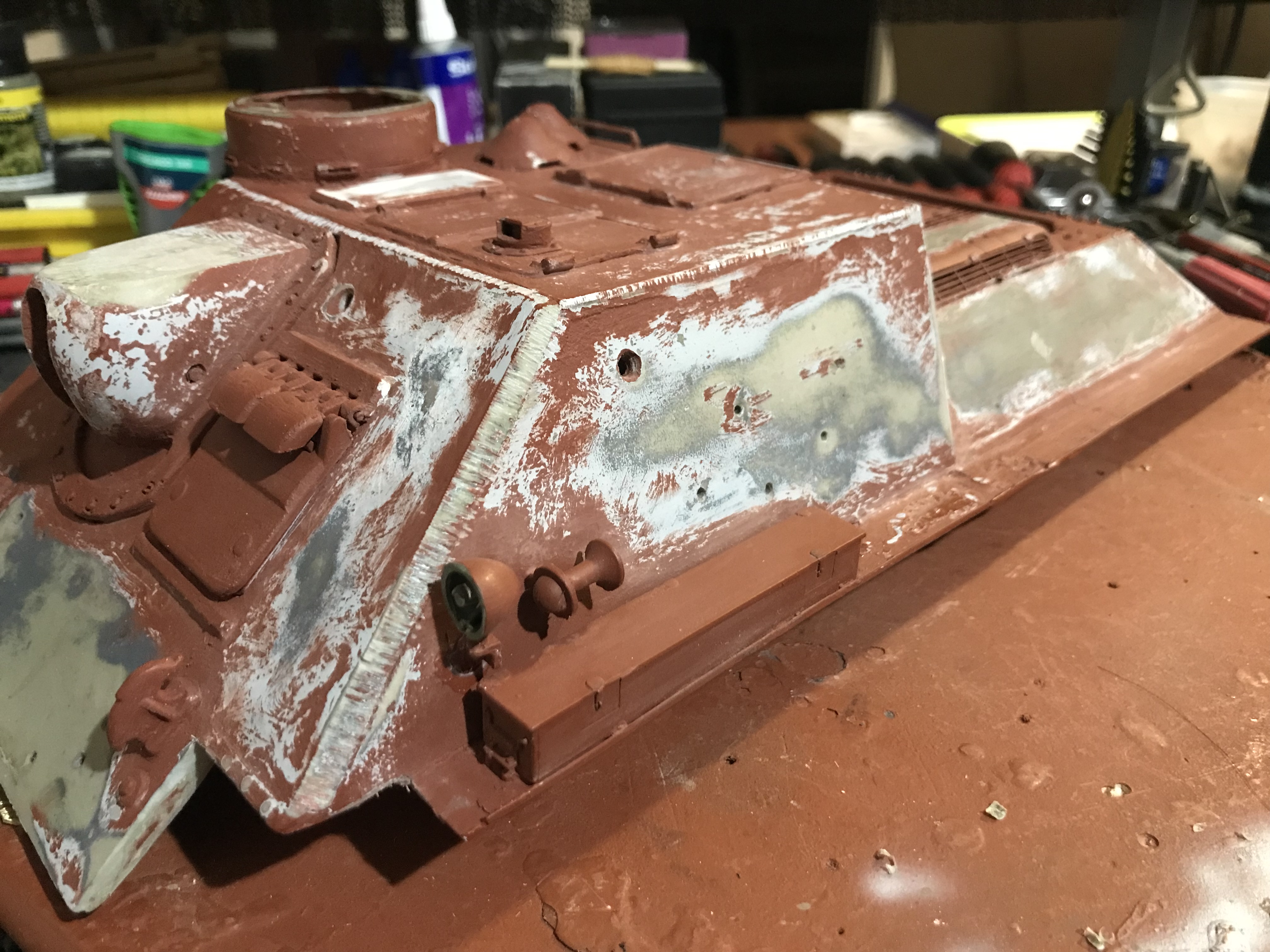

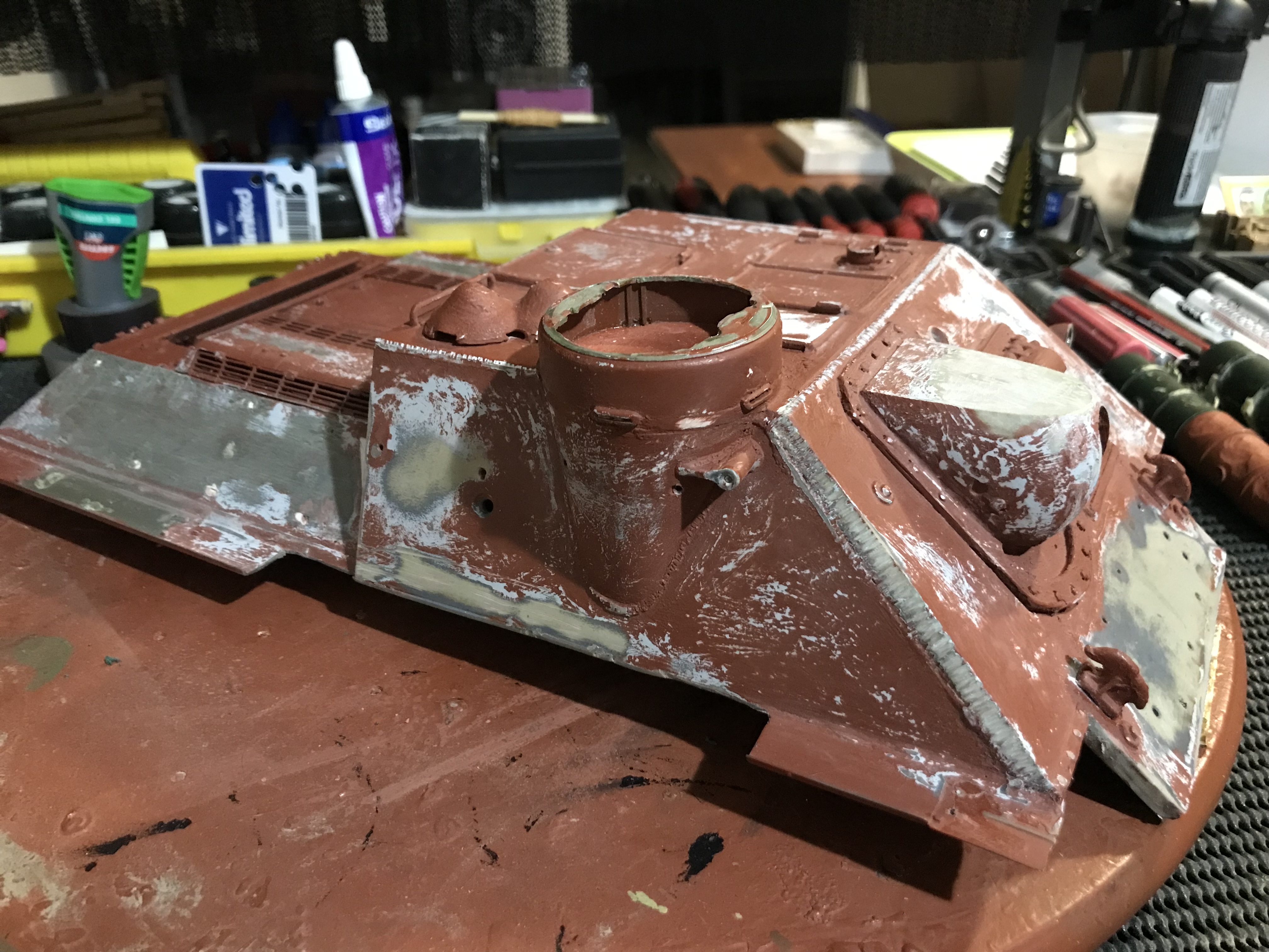

Well it doesn't look like much at the moment, but its cleaned up a lot.
Ive managed to get the upper located onto the new T34 lower, and all the grab handle mounting points cleaned out of broken material & the guards sorted out, and make up the casemate reinforcing gussets that strengthen the rear sides to the casemate rear wall which were missing.
Due to the method of retention of the roof hatches, I'm not keen to force them open.
I went over the plate edges & got flame cutting effects on.
The missing section of guard on the right side will be finished by making the crumpled section out of thin aluminium sheet as is seen in the period picture.
The auxiliary fuel tanks were very damaged, and had all the mounts snapped off, so I dug up some resin ones I never used on my SU152 project. I can use 3 of the 4 I need, so an empty space will likely be in order. That will be on the left rear position which is not visible in the period picture.
This could be getting a very worn out whitewash effect over the 4BO, not certain yet, but the picture and others of vehicles in the same unit at the time show many were whitewashed but not very well.
Commanders cupola & hatch covers next mission.

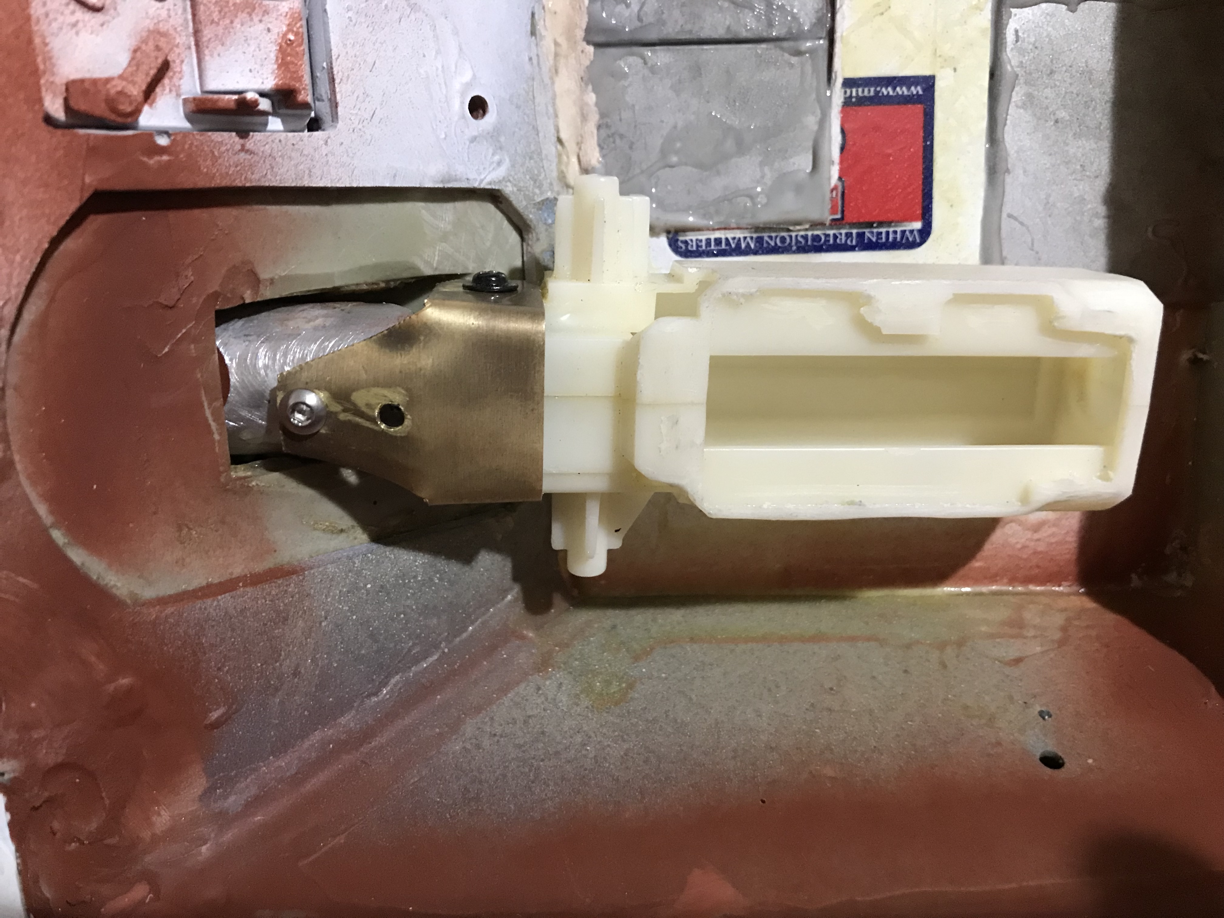

I decided to leave the cupola hatches until later as they would just get in the way & be vulnerable to damage.
The recoil/barrel mounting system is under way.
i've hacked up a BB firing mechanism and used that to form a base to attach the barrel to.
The barrel was overlength, but now corrected, and the joiner that will link the barrel to the recoil unit has also been adjusted to the revised dimensions.
To get the recoil assembly to mate up with the existing trunnion which is fixed in position withing the resin mantlet, I had to get, well, 'creative' with things :shifty: ...............I dont care about doing it ugly or pretty, as long as it works reliably.
The lot is inside the casemate so is not a feature to see thank goodness.

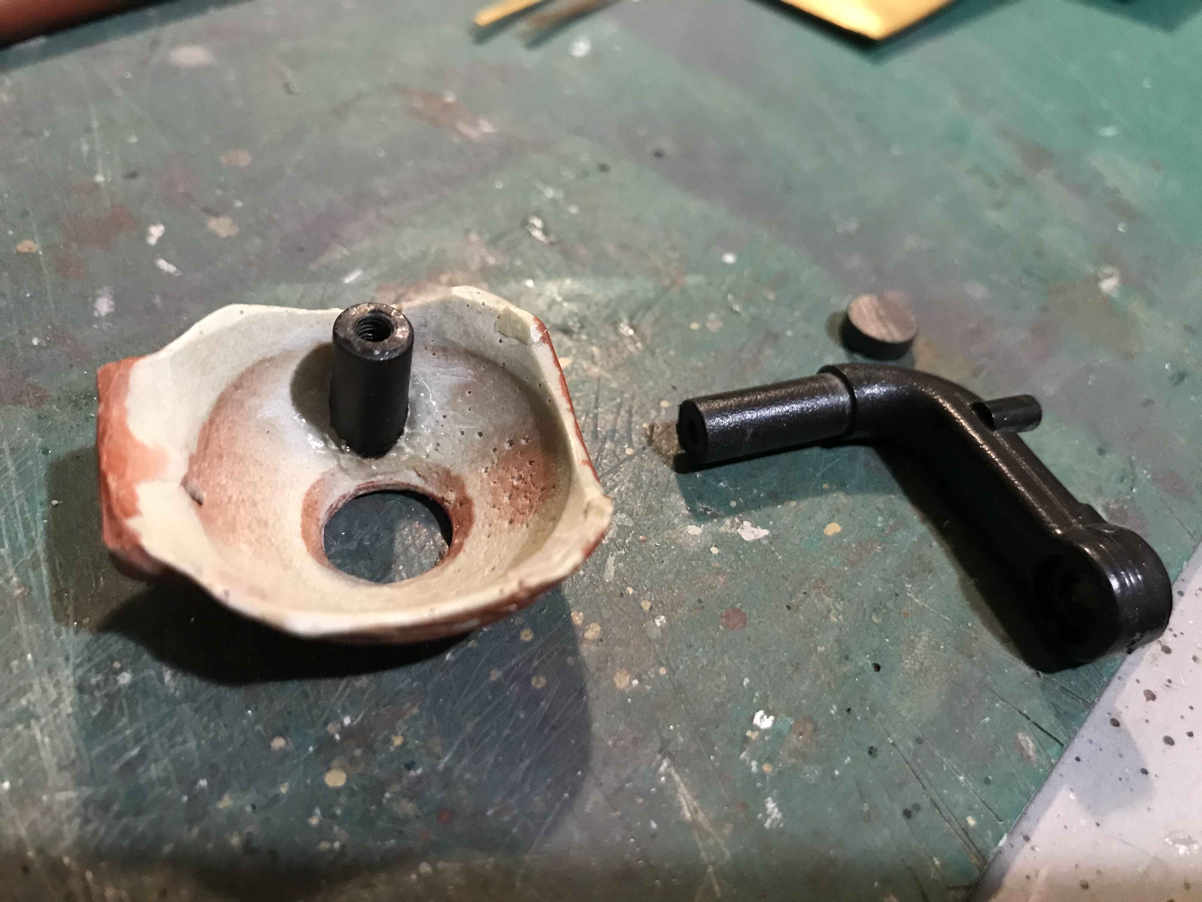

I made a brass link up out of scrap that was secured to the plastic assembly, then was joined to the trunnion by(at the moment) a single M3 stainless cap head bolt. A second one will go in once alignment has been set.
To get the mantlet to hang on in place I have sliced up an old plastic H/L Panther suspension arm to glue into the inside of the mantlet which I will put a magnet onto. Plan is to place another section of Panther arm onto the trunnion that carries some metallic device to attract the mantlet.
Will soon see once the gel super glue is set.
