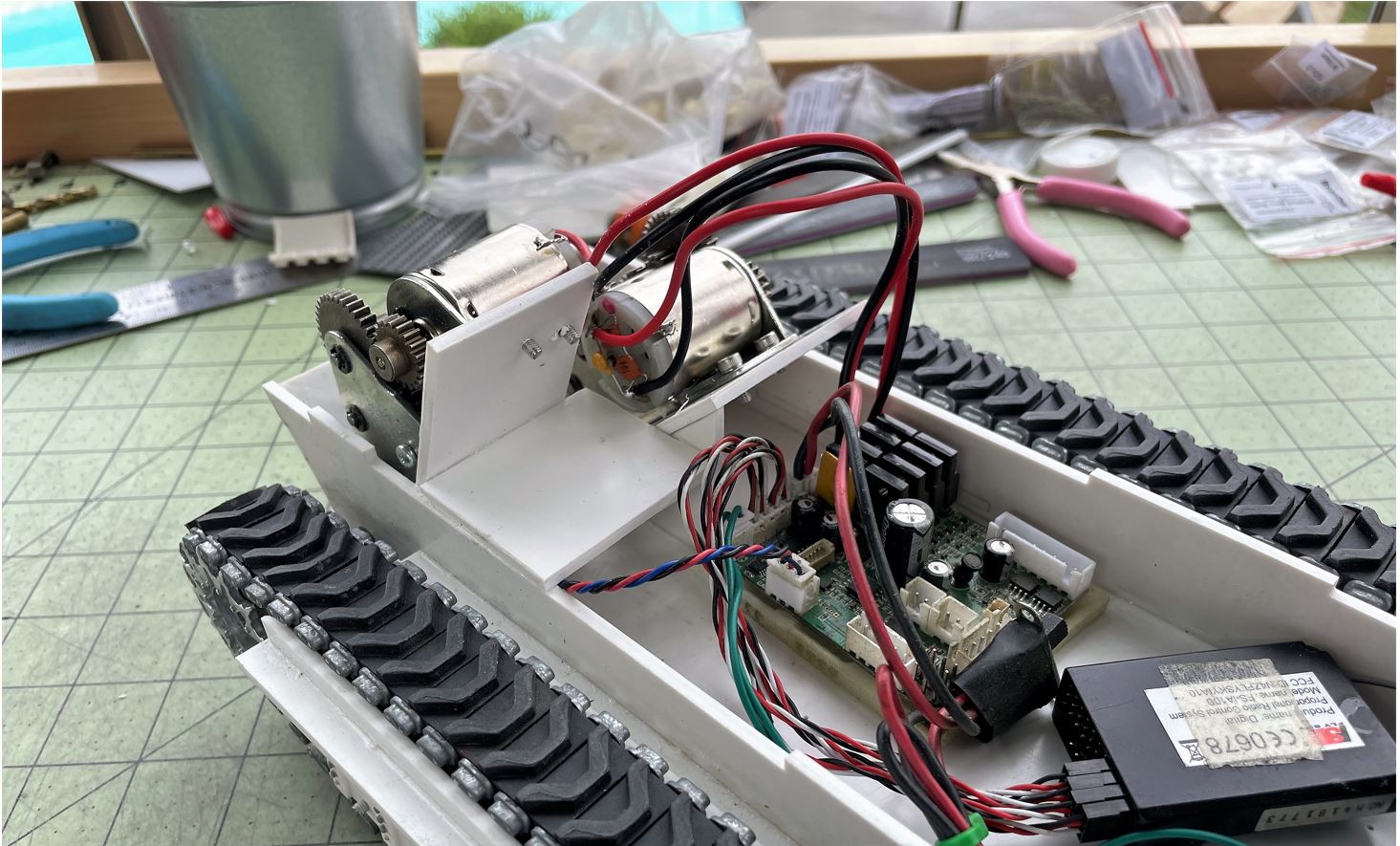

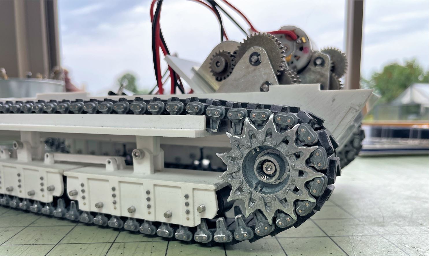

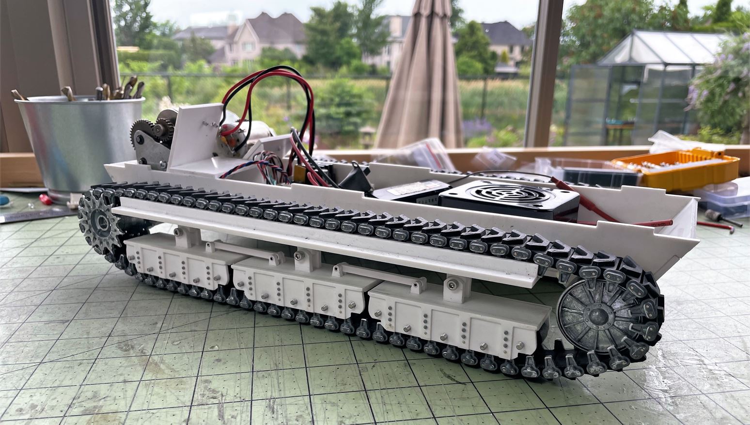

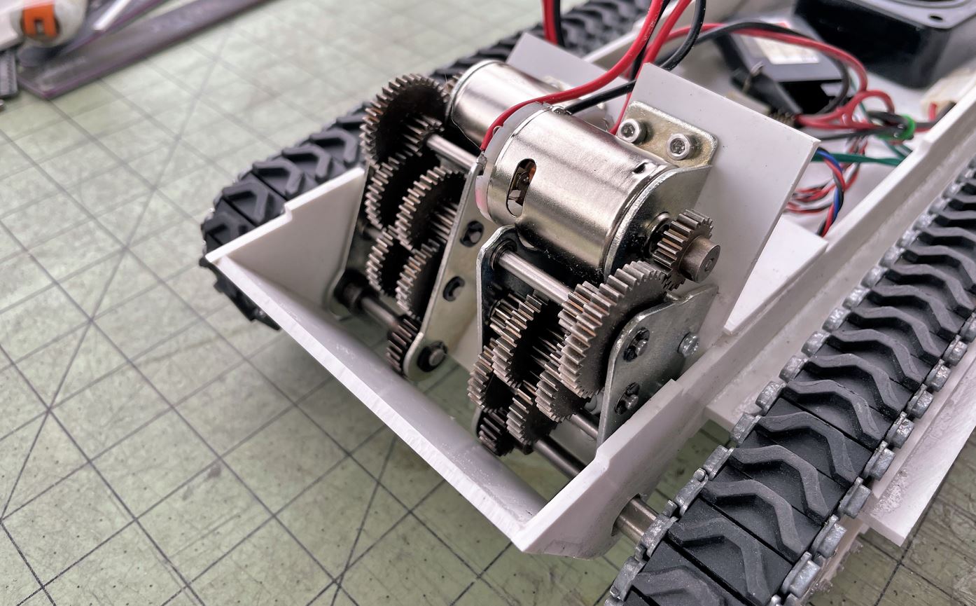

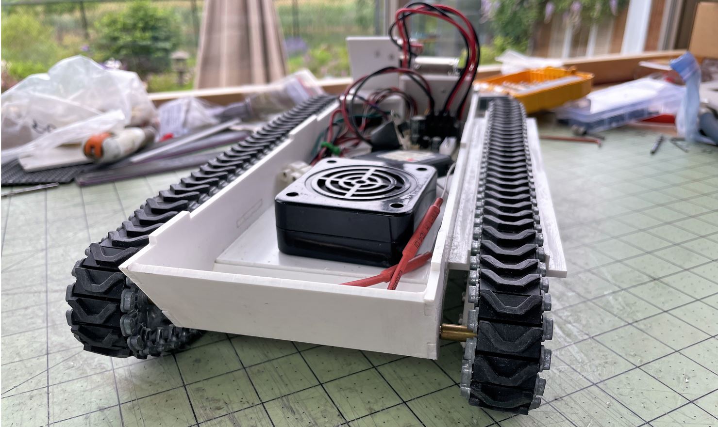

The unorthodox gearbox mount, allowing the shafts to reach the bottom of the hull at that location, and align with rest. These are Panzer 3 gearboxes, I had to put in a 3mm spacer between the tip of the shaft and the sprocket hole inside in order to align the sprocket with the road wheels and return rails.

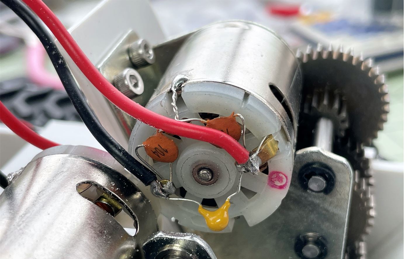

The motors were given an extra type 104 capacitor, positioned between the - and + connectors for extra low speed handling.

The two gearbox could not be side by side, no issues.

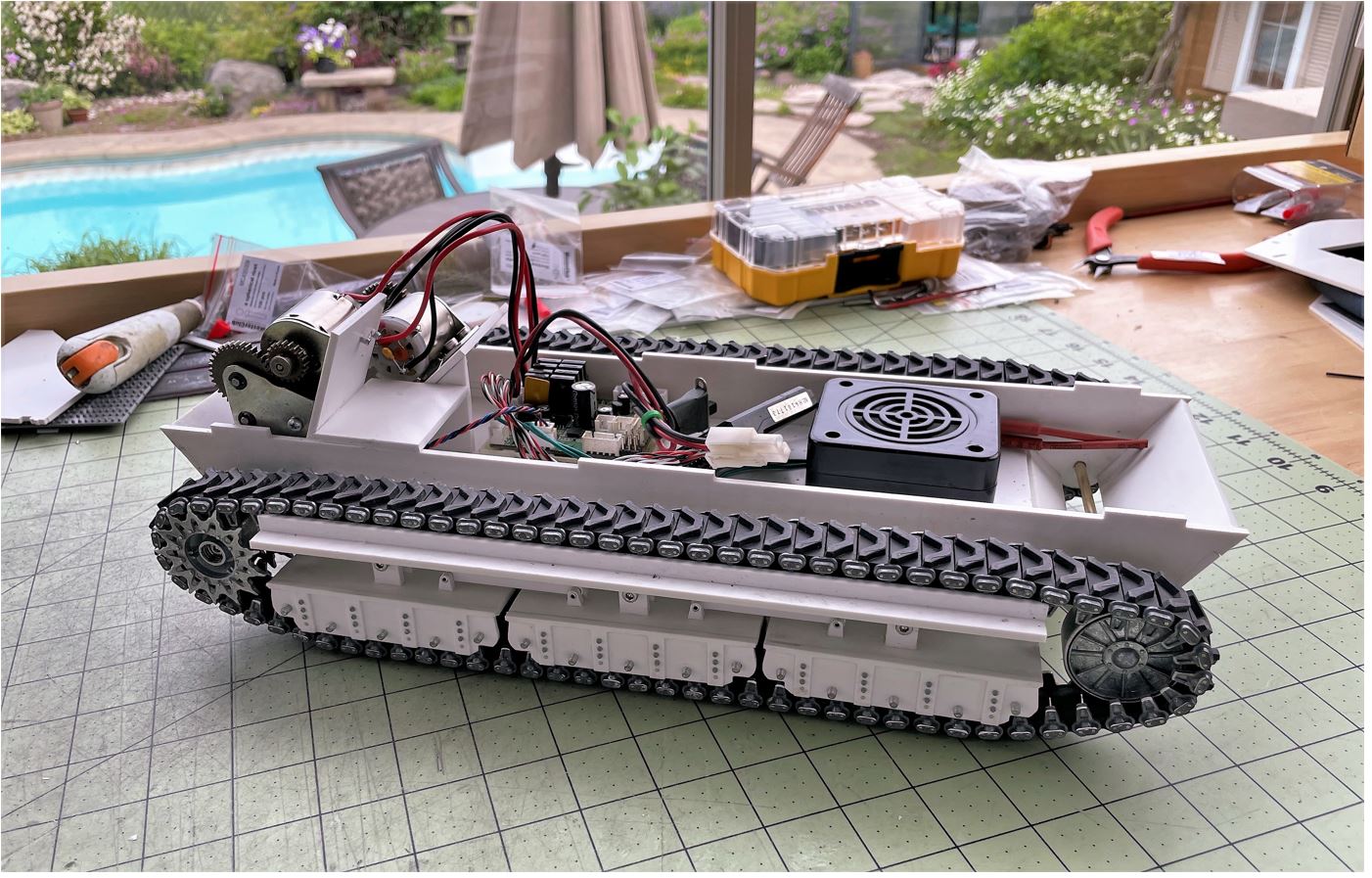

The chassis is ready for its final round of testing, after all the finetuning.

Thank you Herr Dr Professor. I noticed that when i have a track that jumps over the sprocket on a inconsistent fashion and can’t see obvious reasons, it is usually because of sharp edges on a new metal sprocket or tracks. A few heavy duty nail files with a 120 grain are good to smooth out the sharp edges to make the sprocket and tracks gently slide into each other instead of attacking or cutting into each other. The track connectors were filed without removing them. Took about 30 minutes per tracks, 10 minutes per sprocket.

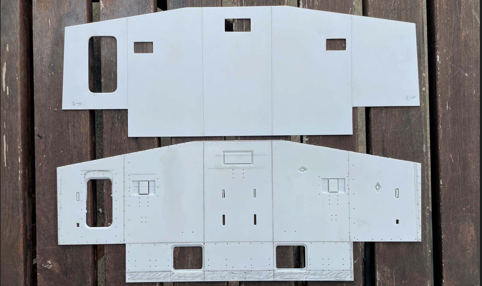

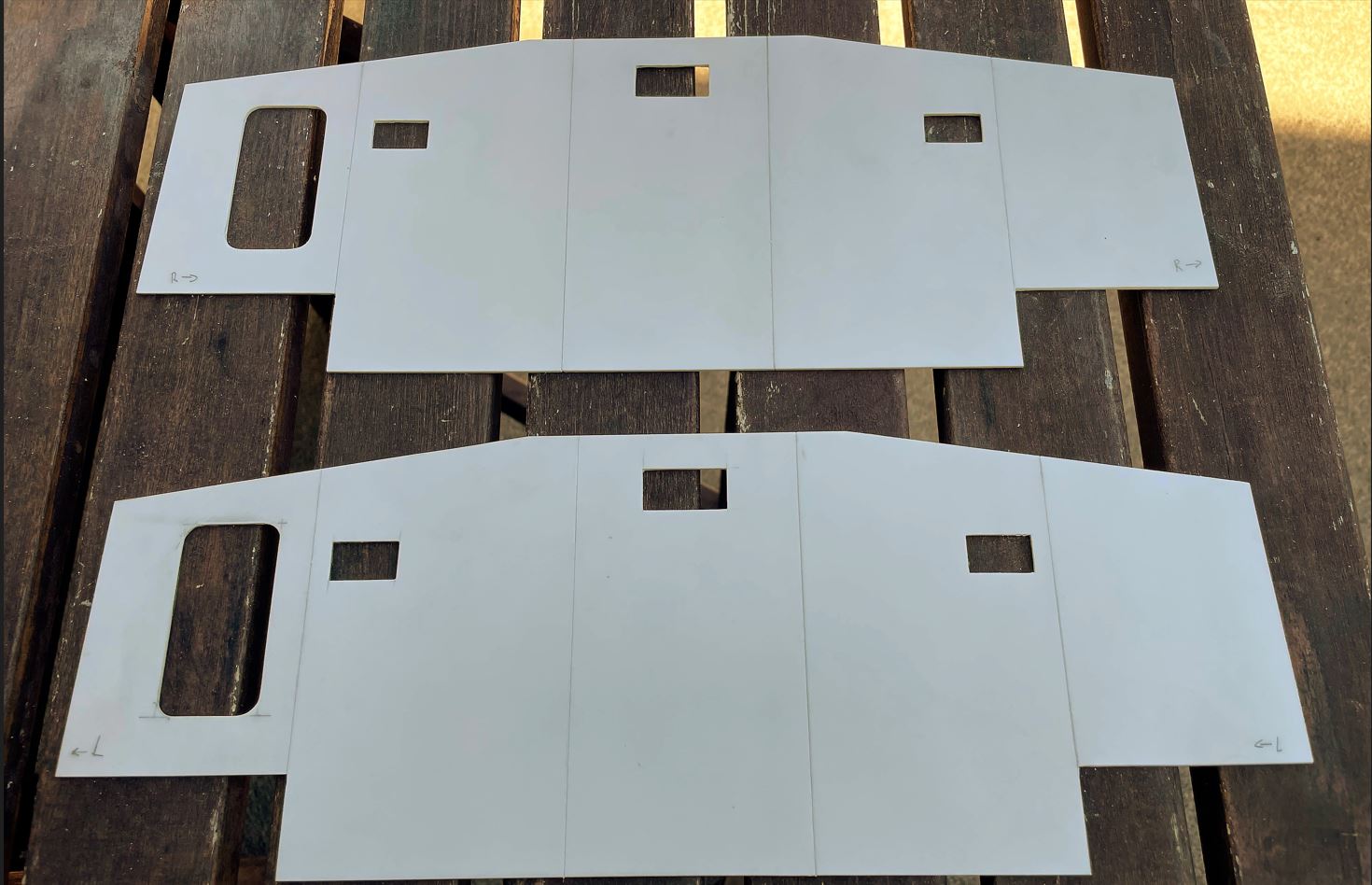

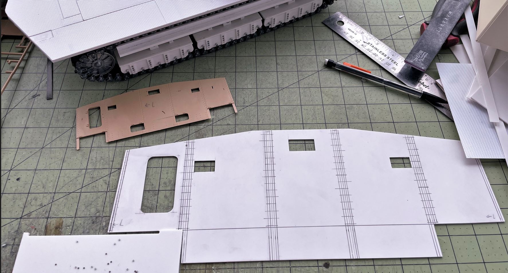

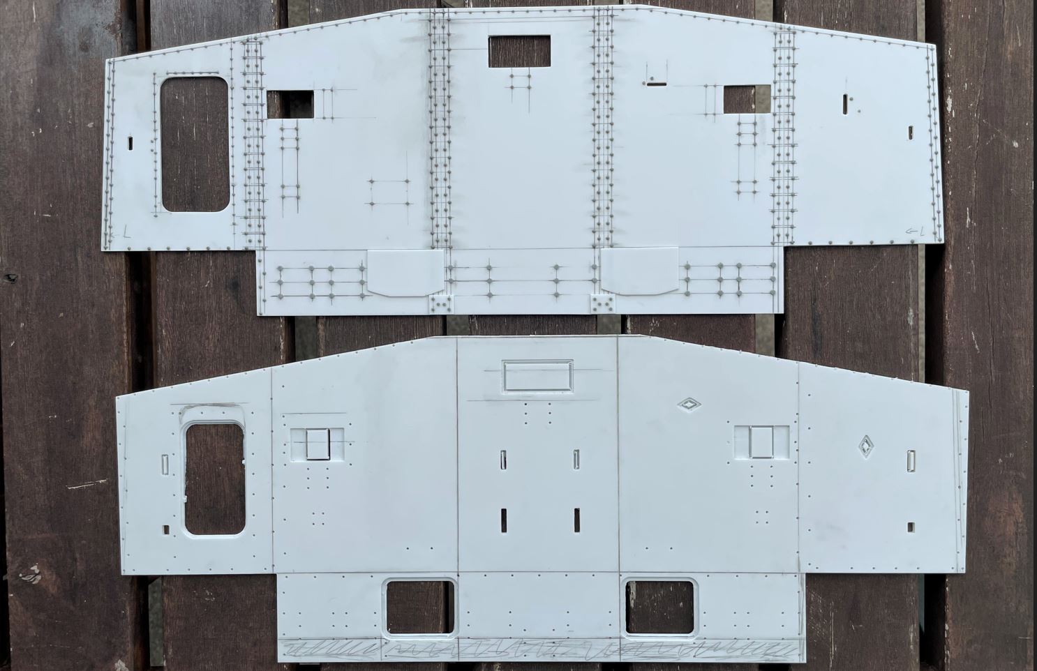

I created two new side armored plates in 1.5mm polystyrene that better match the thickness of the A7V armor, while still being firm enough. All measurements and angles were taken from the Meng kit. There is a right and left side. Although it is not obvious, the angles and dimensions of the A7V are not identical between the front and the back sections.

Comparison of one of the new side armor with the Ludwig kit at the bottom, which is a Rochling vehicle, and has some issues with shapes, number and placements of rivets and other items.

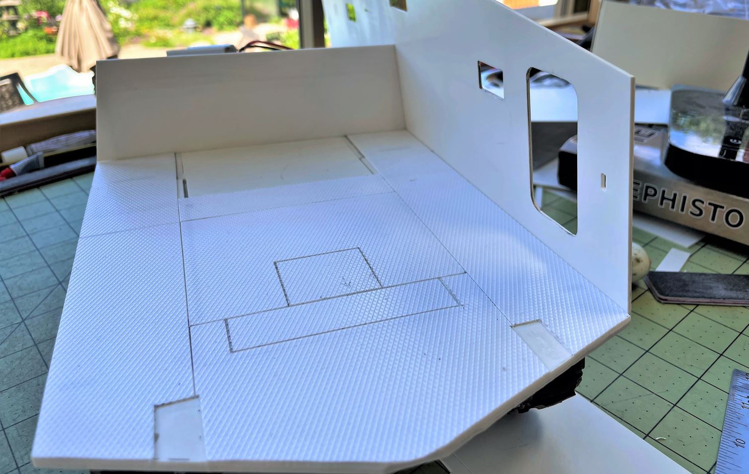

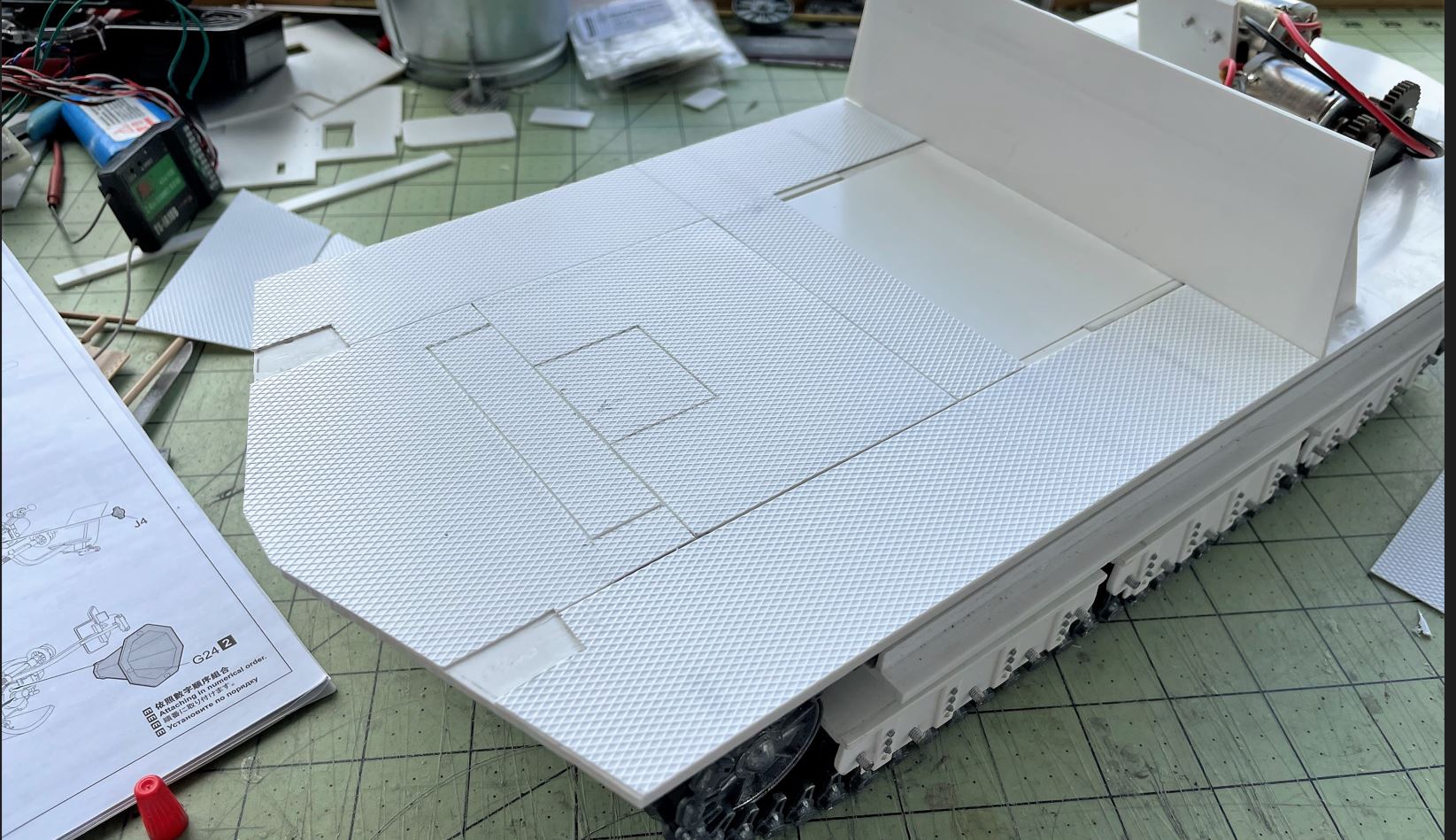

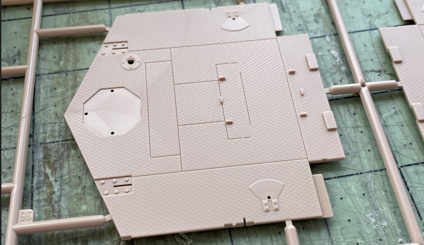

For planning purposes for the interior, i created the floor of the vehicle in the front section. The treadplate lozenge pattern matches the one seen on the Meng kit and also pictures of Mephisto.
A7V German WW1 tank 1/16 RC - Build
The central section is where the raise platform is for the drivers. The back that holds the gearbox and electronics will not have a detailed interior.

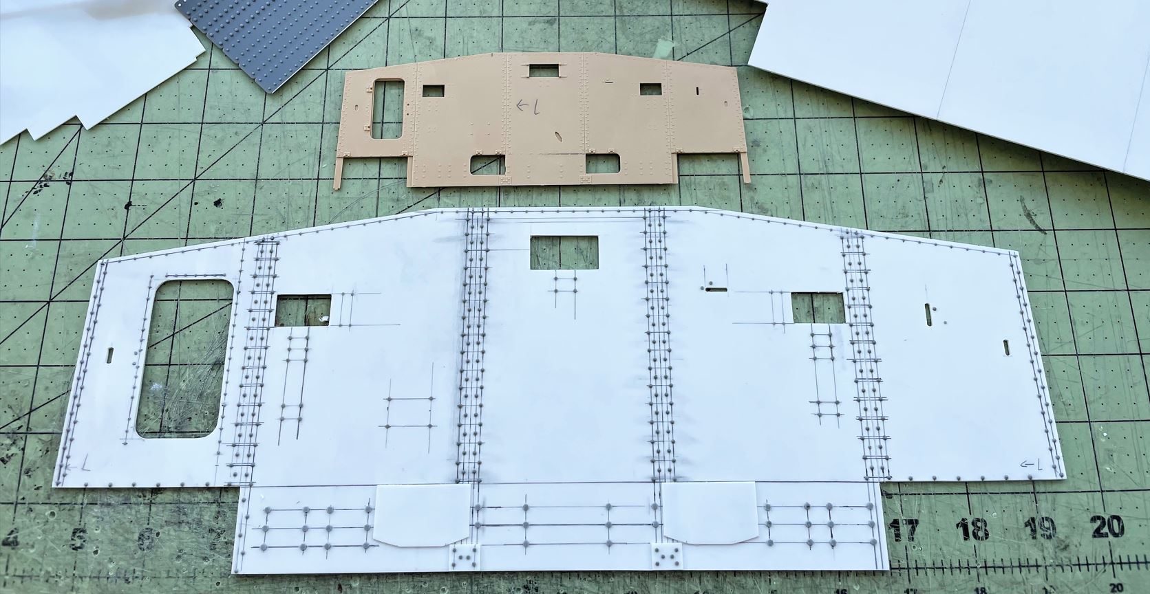

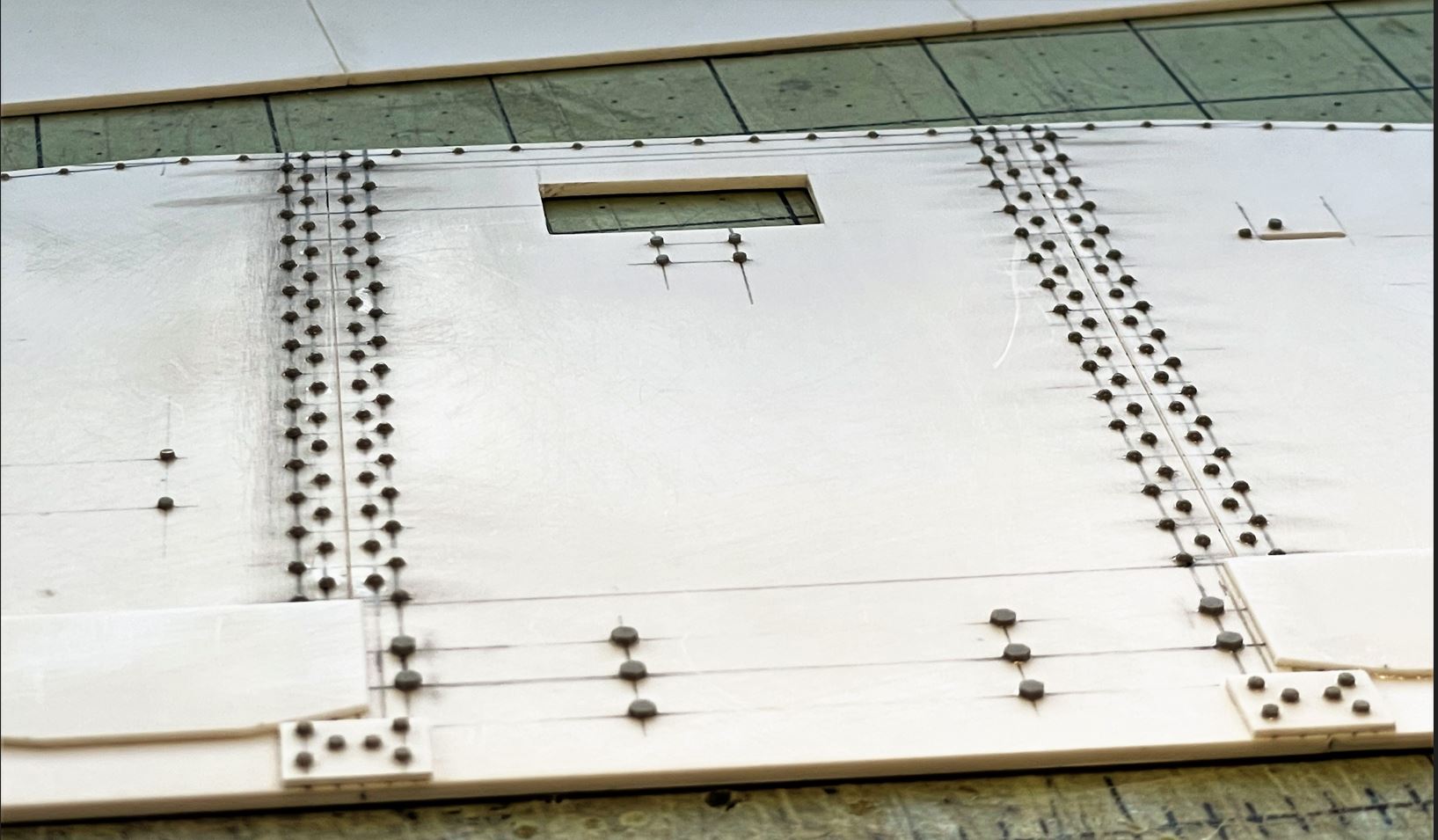

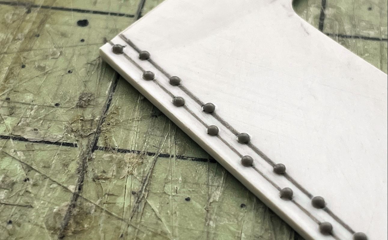

Planning and measurements for the rivets take a while. There are about 450 rivets of at least 5 different types on a single sides, each one requiring analysis, measurements and placement. Because i am no longer using the Ludwig side armor, i cannot use the holes to insert resin or metal rivets, as i had planned. I therefore need to use Meng nuts because i do not want to drill so many holes.

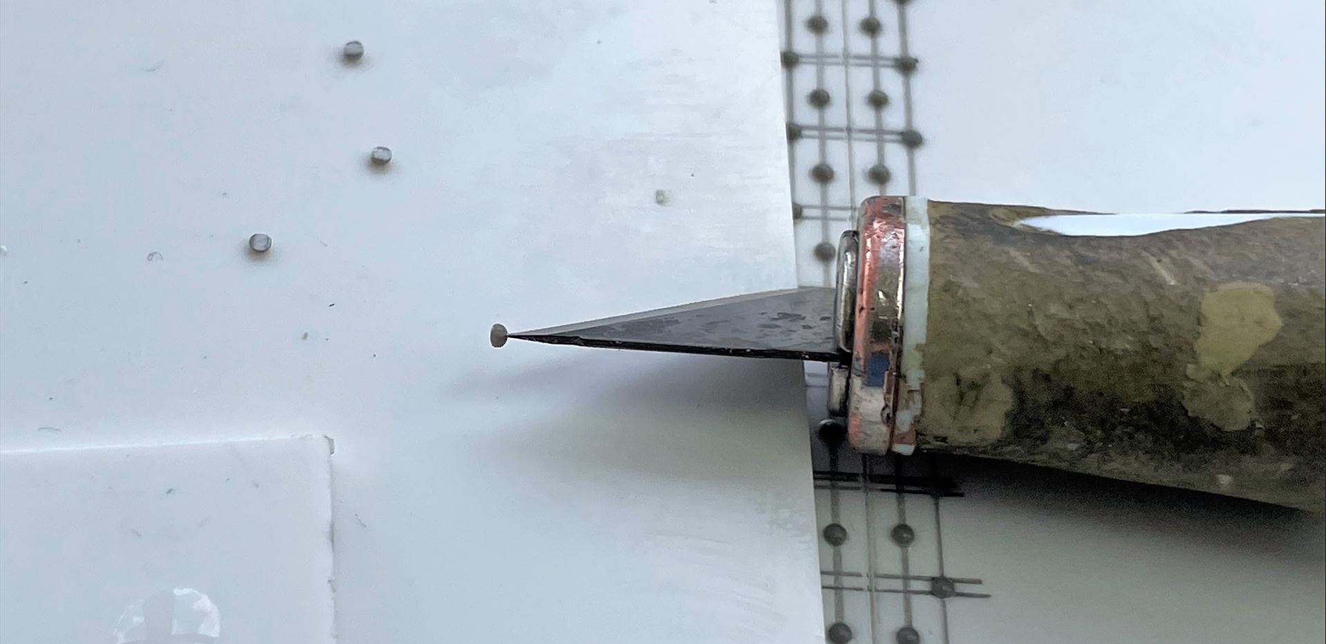

Each need to be cut from the sprue with a new blade, picked up with the tip of the blade, soaked in superglue and placed.

Patience is required. It took a couple of days just for one side. Polystyrene plates and Meng nuts make the best armored plate representation.

There are different types of rivets required. The Meng kit was essential for figuring out the type and placement of each rivet. Yes, i am a rivet counter.

All rivets are installed for the left side... Looking good.

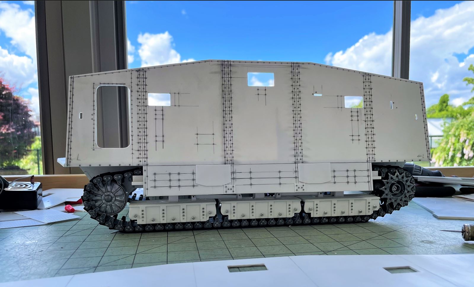

Testing of the look of the side armor on the chassis. Now you see where George Lucas got his inspiration of the Jawas Desert Crawler in the first Star Wars movie.
