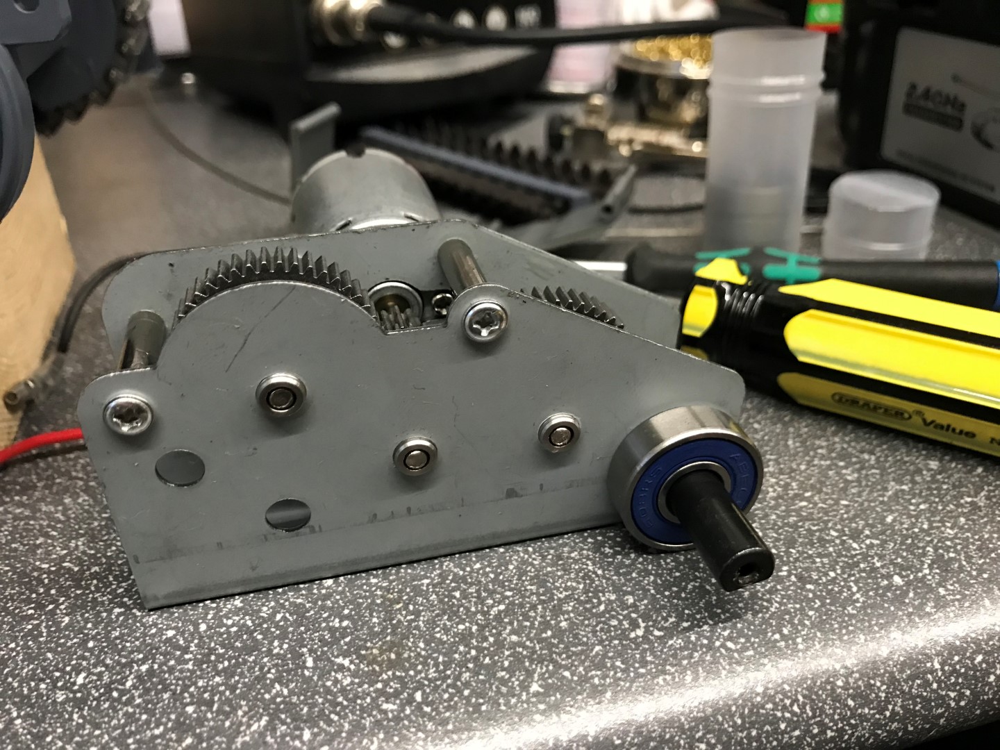

jarndice wrote:Hi, The Drive shaft support bearings go on the INSIDE of the hull and in my opinion are an absolutely vital fit.
Do bear in mind that to secure them they have a pair of nuts :{ on the inside and if you do not place the two holes in the bearings that secure the bearing in the right place on the hull you will never get the nuts on making a dry run essential,
That was not immediately obvious (and some online info has them outside!), but I looked and the ones around seem to be a brass bush not a bearing? At least the ones I saw. The drive shaft is 8mm, so I had a rummage and:
Gearbox with bearing
A skateboard bearing is a perfect fit (I don't skateboard but I bought a pack for something I 3d printed!), but too thick to fit in the chassis at 7mm - it seems that with a suitable bearing like 8x14x4mm would be perfect if you fabricated a mount? I am partial to a bit of mechanical tinkering I might look at that further.

I am not sure if the gearbox has bushes or bearing still, its not quite clear, they are flanged and they run smooth but I am still not sure - assuming bushes. The weak side plates let it down a bit, the gearbox I pictured earlier in the thread seems the side is a bit bent is the cause of my not perfect axle. The gearbox looks just like the Taigen ones pictured online apart from the gears and side plates are not black.

whitecitadel wrote: That was not immediately obvious (and some online info has them outside!), but I looked and the ones around seem to be a brass bush not a bearing?
Just to add more on this... looking at parts again tonight, I realised where I saw the external mount was:
https://www.rctank.de/Tiger-I-axle-supp ... l-bearings
And these ones are bearings, the ones I saw on Welsh Dragons and ForgeBear were more brass bushings as I remember, and it seemed like bearings were a better idea to me at least.
