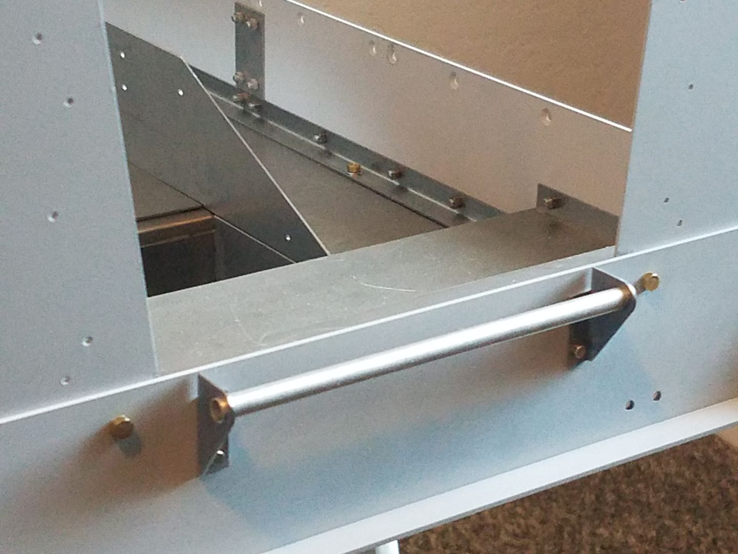

Hello everyone, here is an update on my rear floor, very complicated to make, all your measurements have to be spot on, i still have a ways to go, I'm about 60% done with it. and yes, i still need diamond plate, don't know when i will get around to making it but for now I'm just using steel plate which will be templates for when i do get diamond plate. I am very happy with how well this is turning out.

by Saracen
Alignment looks perfect. Are you cutting and folding everything yourself ?

Posted: Mon Jan 23, 2023 11:15 pm
by DAVEY65
Yes Adrian, to get a perfect bend in the sheet metal i put a slight groove in the metal with my dremel cut off wheel, i clamp a straight edge to the sheet metal so my Dremel wheel makes a perfectly straight line, then i fold it. On the thicker angle iron i just buy a square metal tube with the right wall thickness and cut 4 angle irons from it. And yes i was surprised too at how everything lined up and fit together perfectly.
