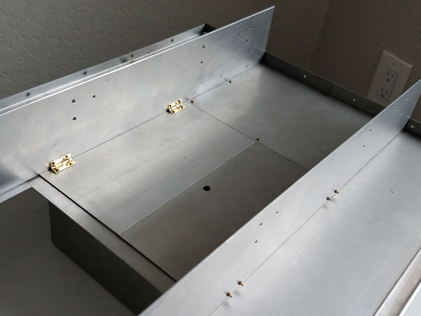

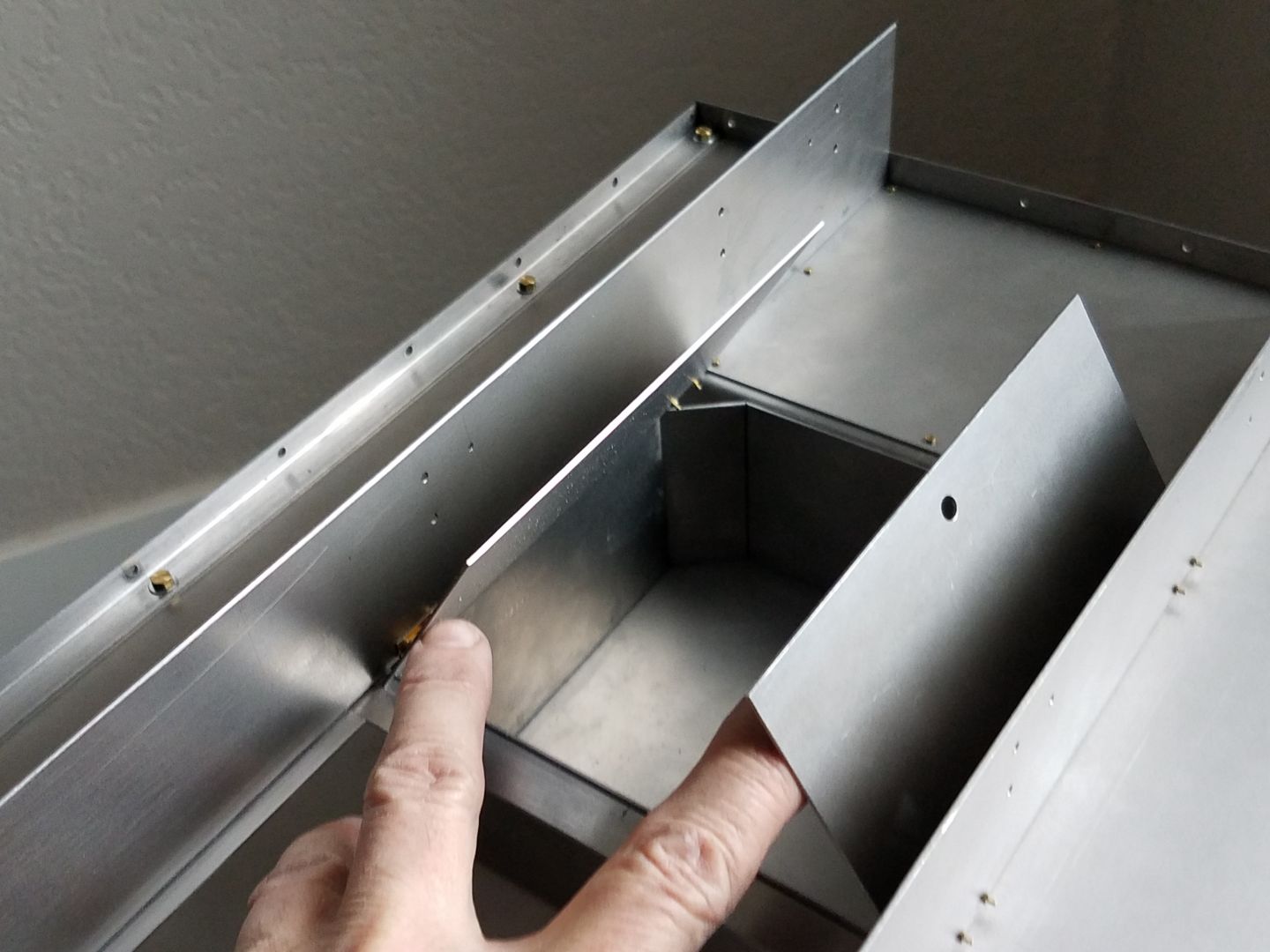

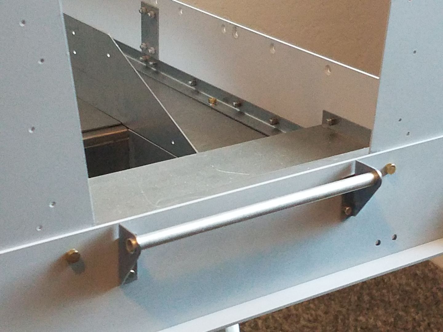

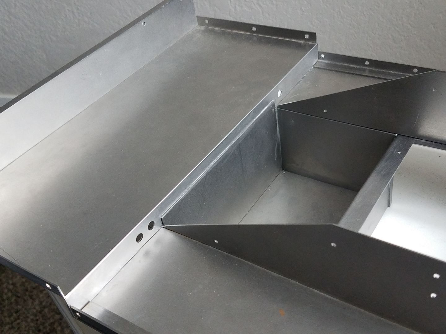

Hello everyone, here is an update on my rear floor, very complicated to make, all your measurements have to be spot on, i still have a ways to go, I'm about 60% done with it. and yes, i still need diamond plate, don't know when i will get around to making it but for now I'm just using steel plate which will be templates for when i do get diamond plate. I am very happy with how well this is turning out.

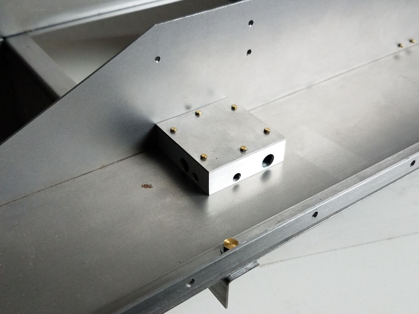

Here you see the main electrical junction box for the halftrack radio, im currently searching for some flexible metal conduit to run to this box

Alignment looks perfect. Are you cutting and folding everything yourself ?

Yes Adrian, to get a perfect bend in the sheet metal i put a slight groove in the metal with my dremel cut off wheel, i clamp a straight edge to the sheet metal so my Dremel wheel makes a perfectly straight line, then i fold it. On the thicker angle iron i just buy a square metal tube with the right wall thickness and cut 4 angle irons from it. And yes i was surprised too at how everything lined up and fit together perfectly.
