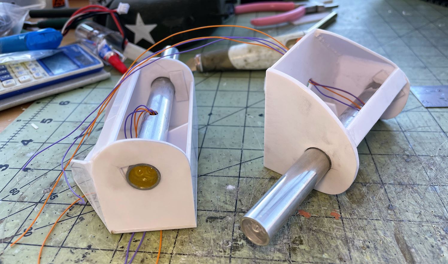

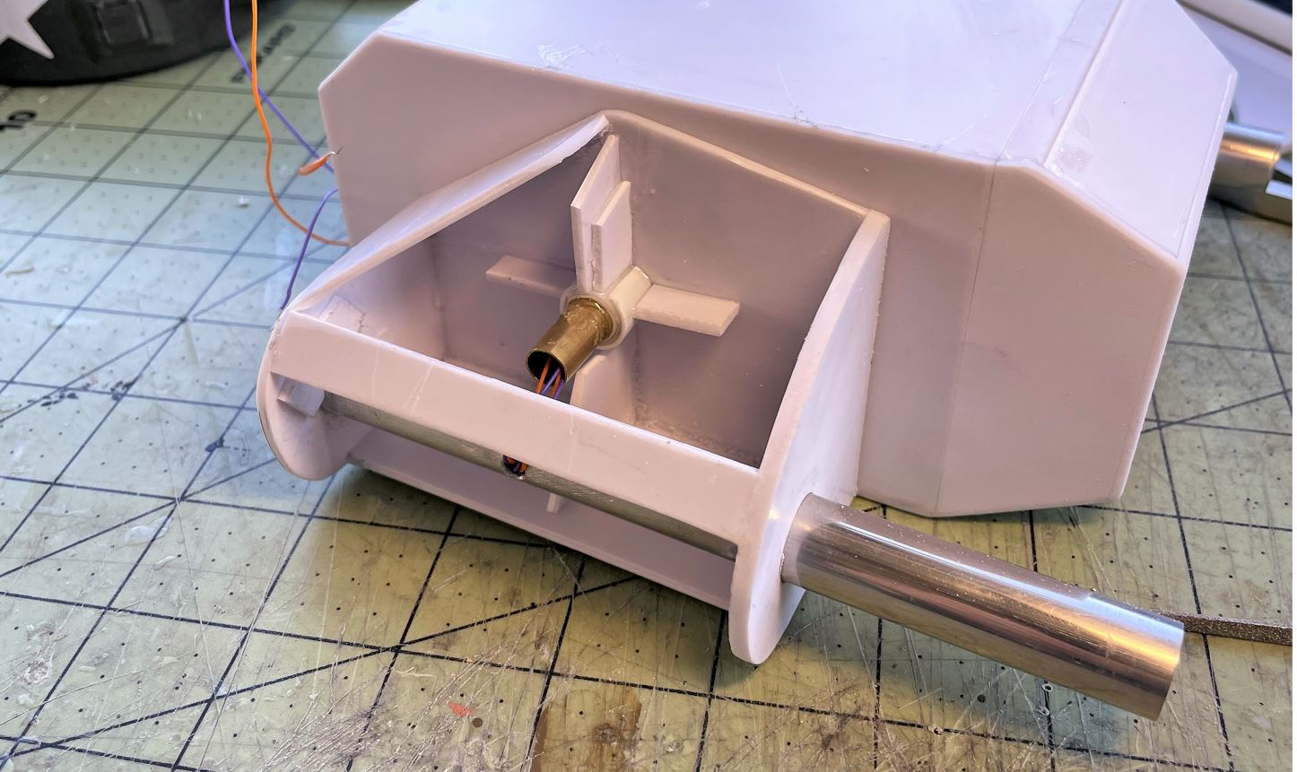

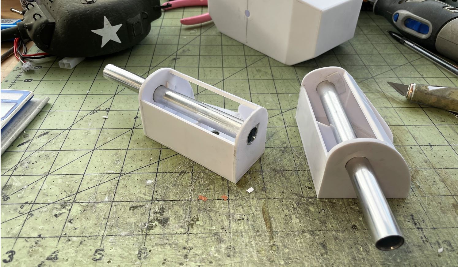

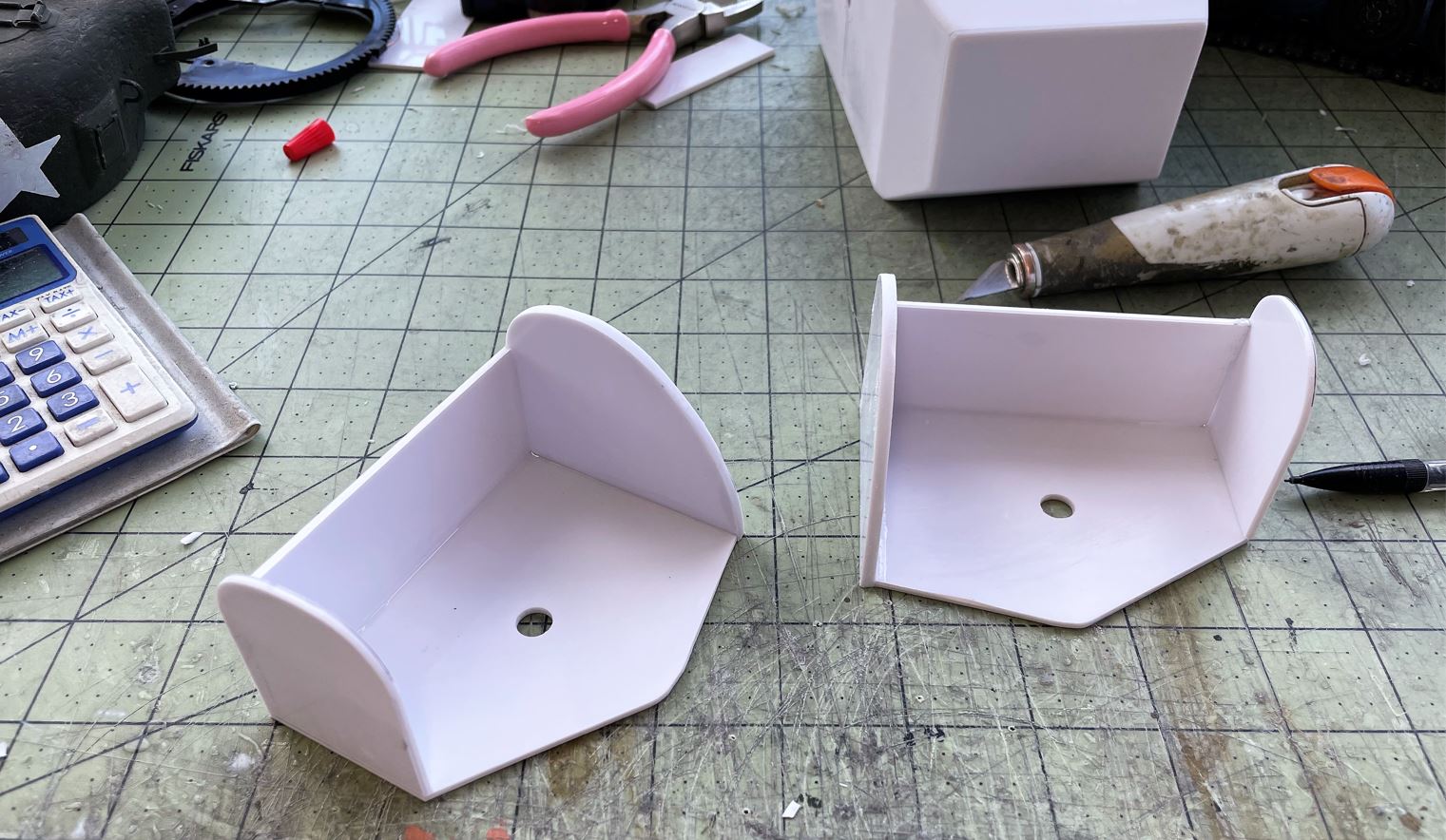

Armed with 14mm outside diameter aluminum tubing, and matching the 7.2 inch rocket calibre on the inside. The installation of the pods needs to be done before the pods are enclosed.
RC 1/16 Sherman T31 Demolition tank - Build

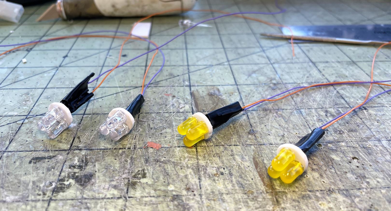

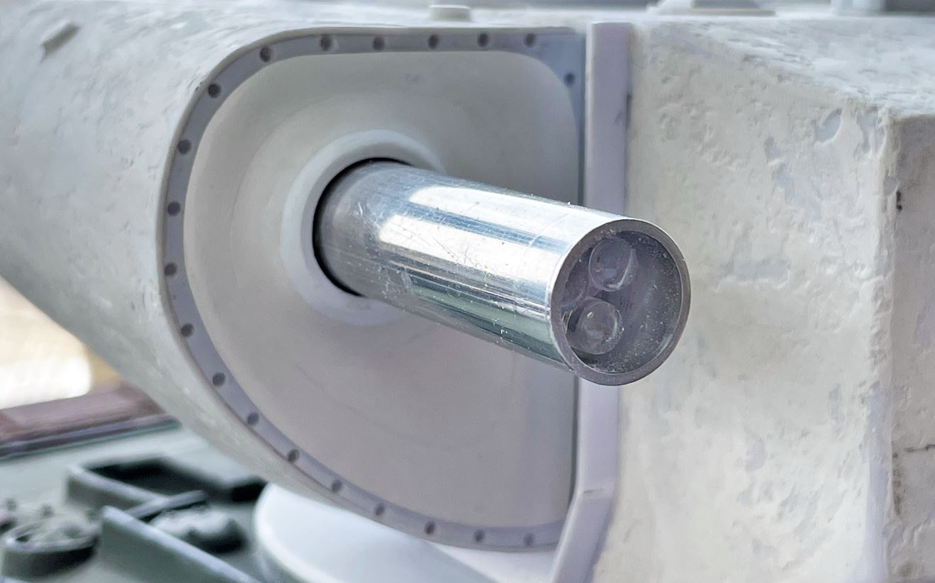

For rocket tube flash, i created 4 bundles of three 5mm LEDs, white for the front, yellow at the rear of the tube.
LEDs and wiring installed, and tested.

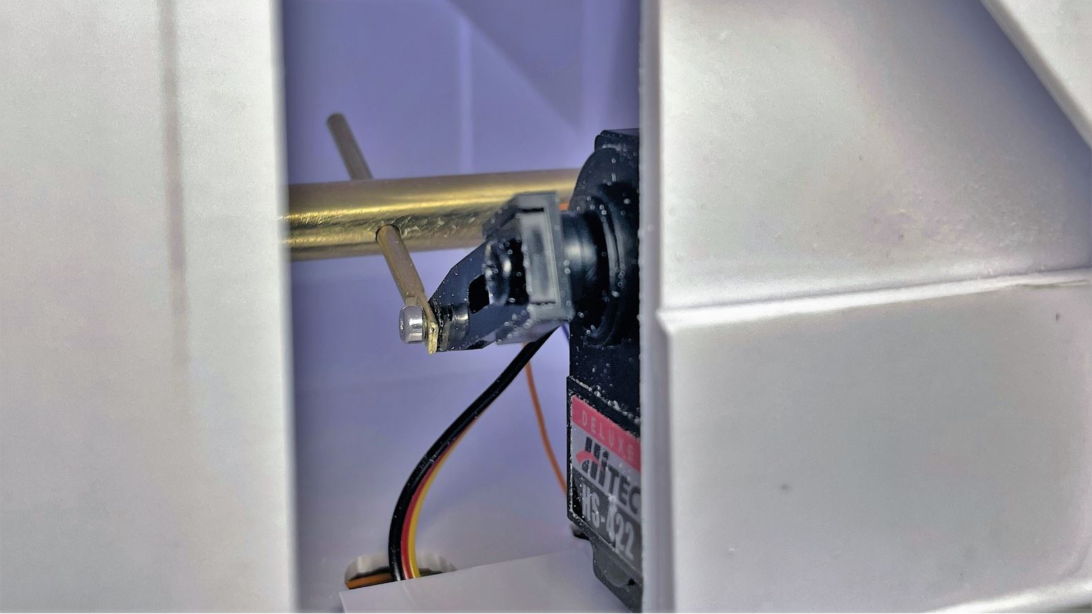

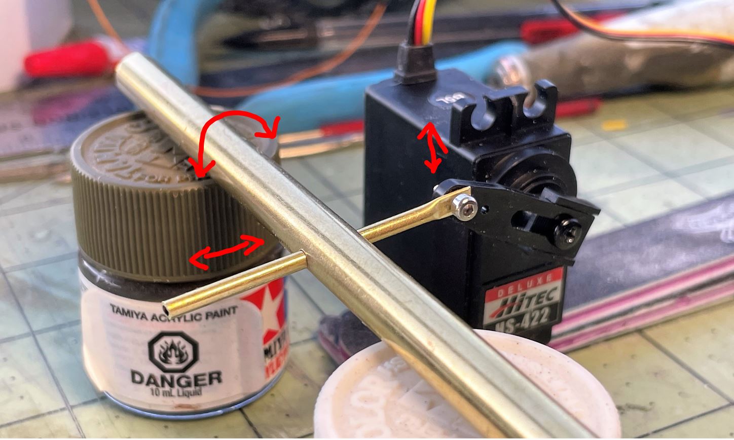

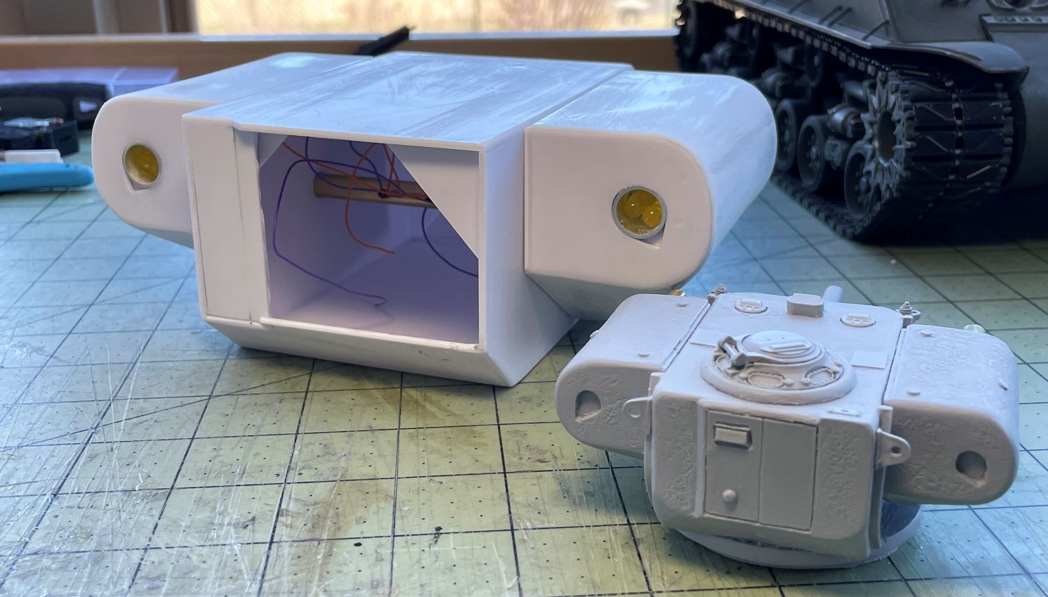

Servo elevation system for the central shaft is created with a simple design.
Pods are installed and firmly attached to the central shaft.
Central shaft and LED wiring are pre-positioned for the enclosure of the pods.

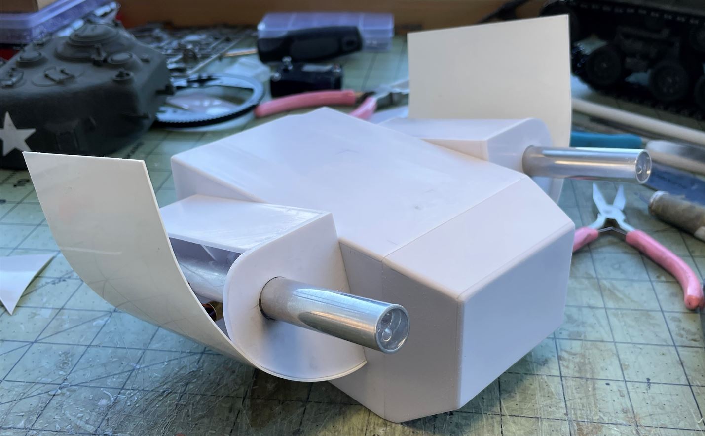

The pods are enclosed in two steps, bottom first and then top, with drying time in between.

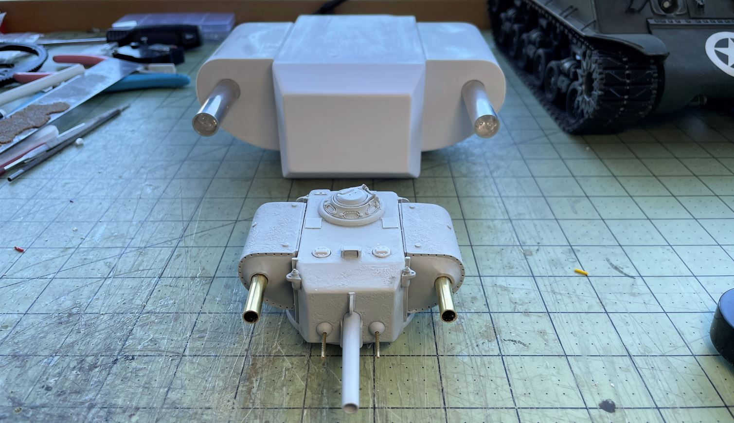

The 1/16 turret core shape compares well to the 1/35 kit.

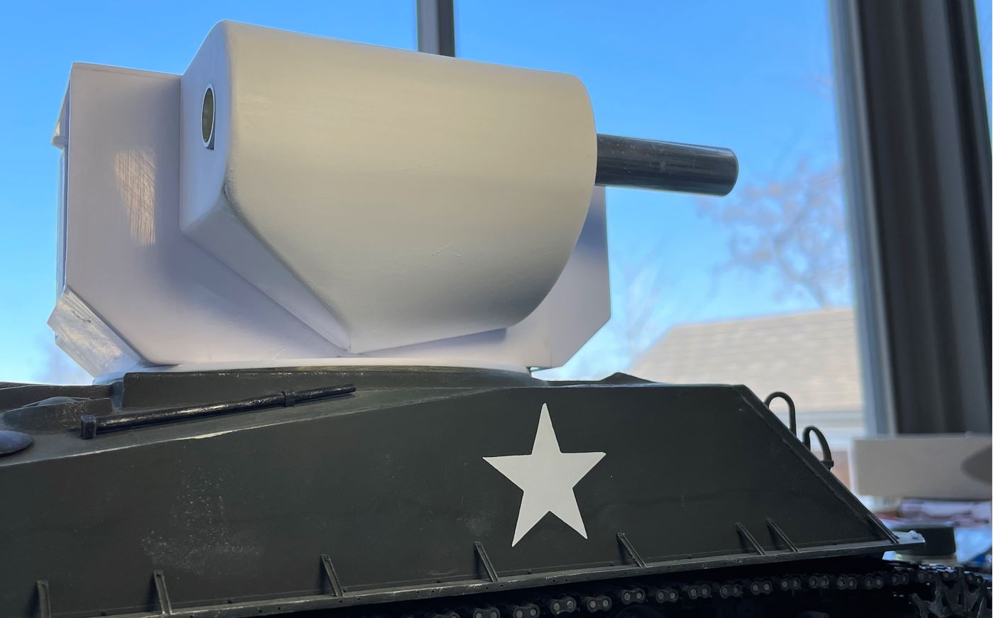

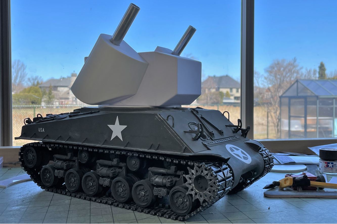

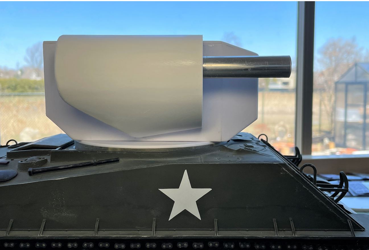

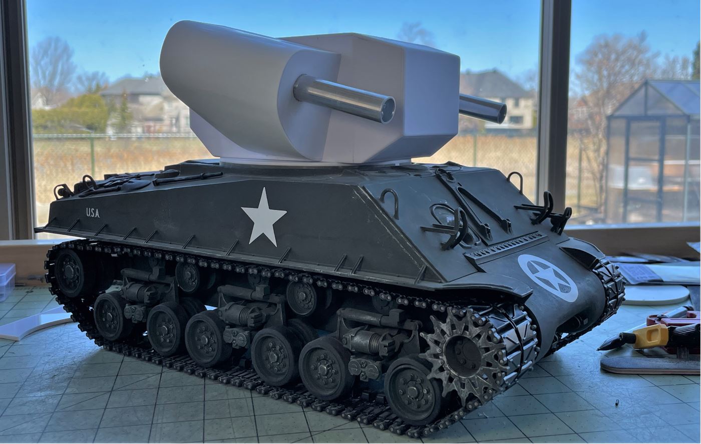

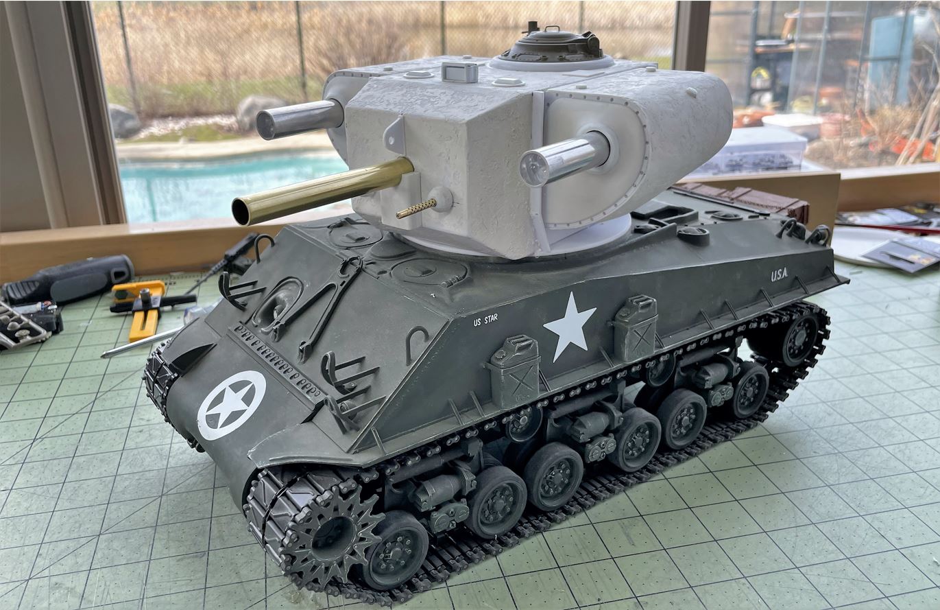

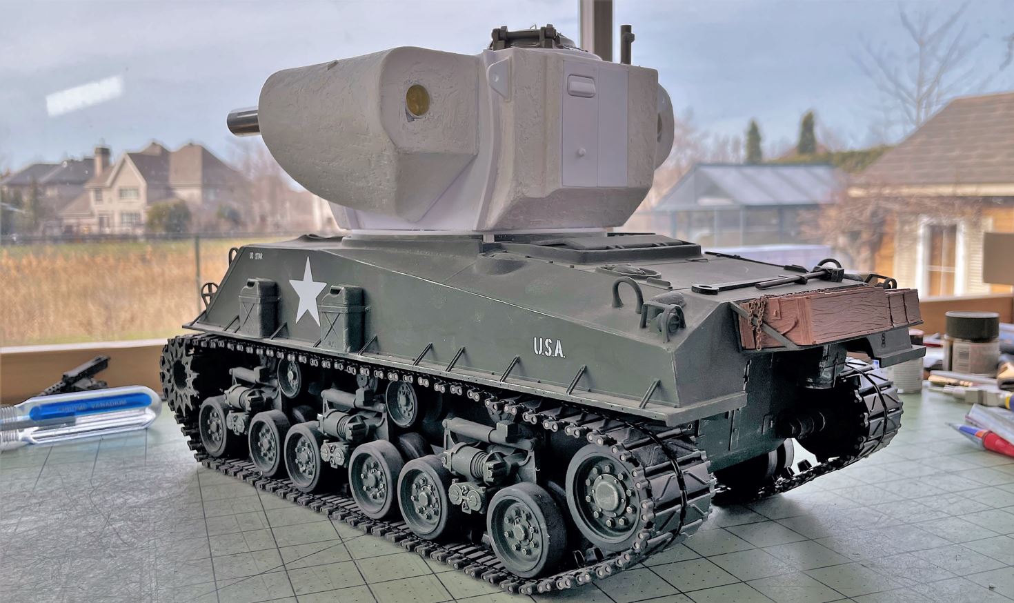

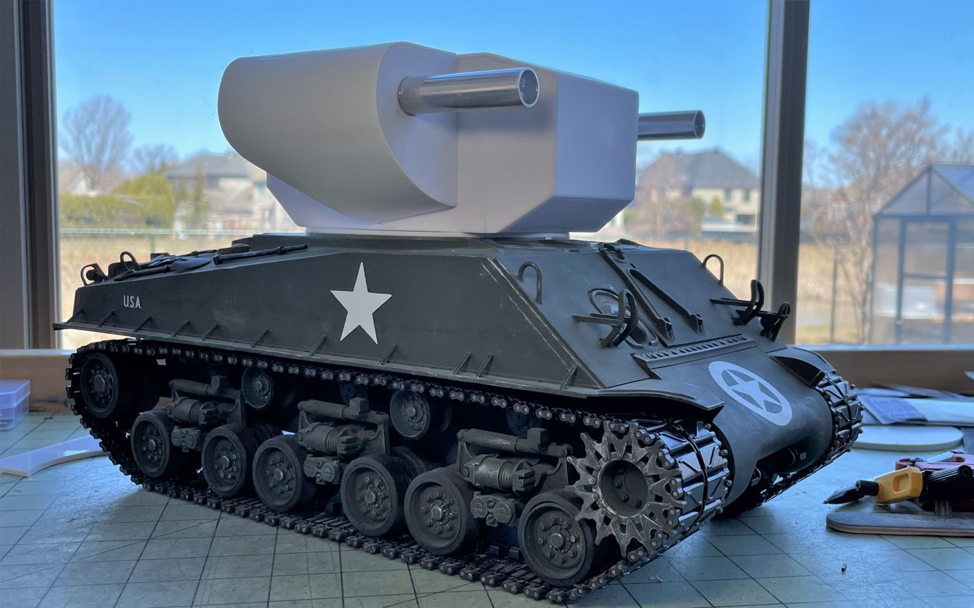

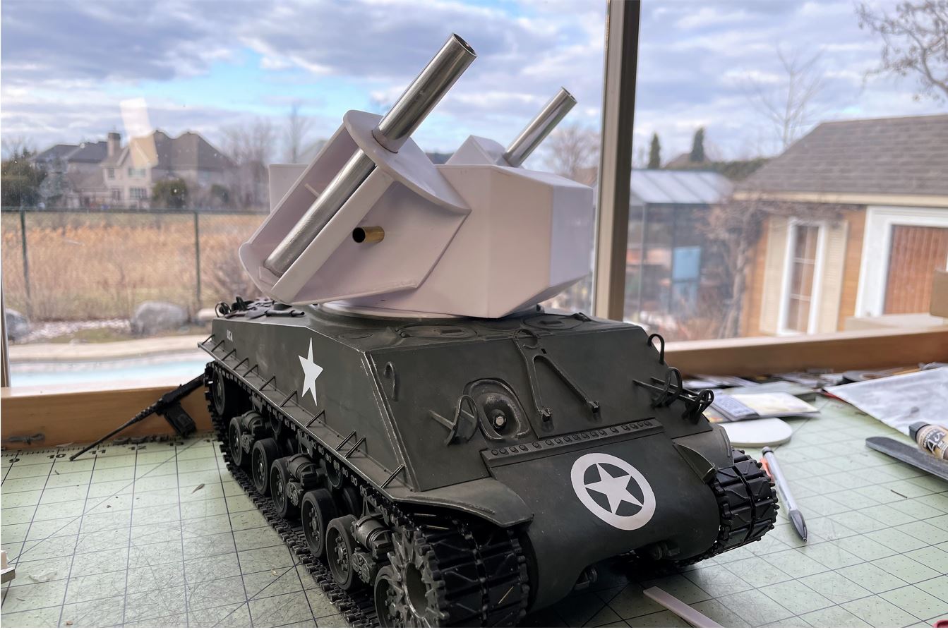

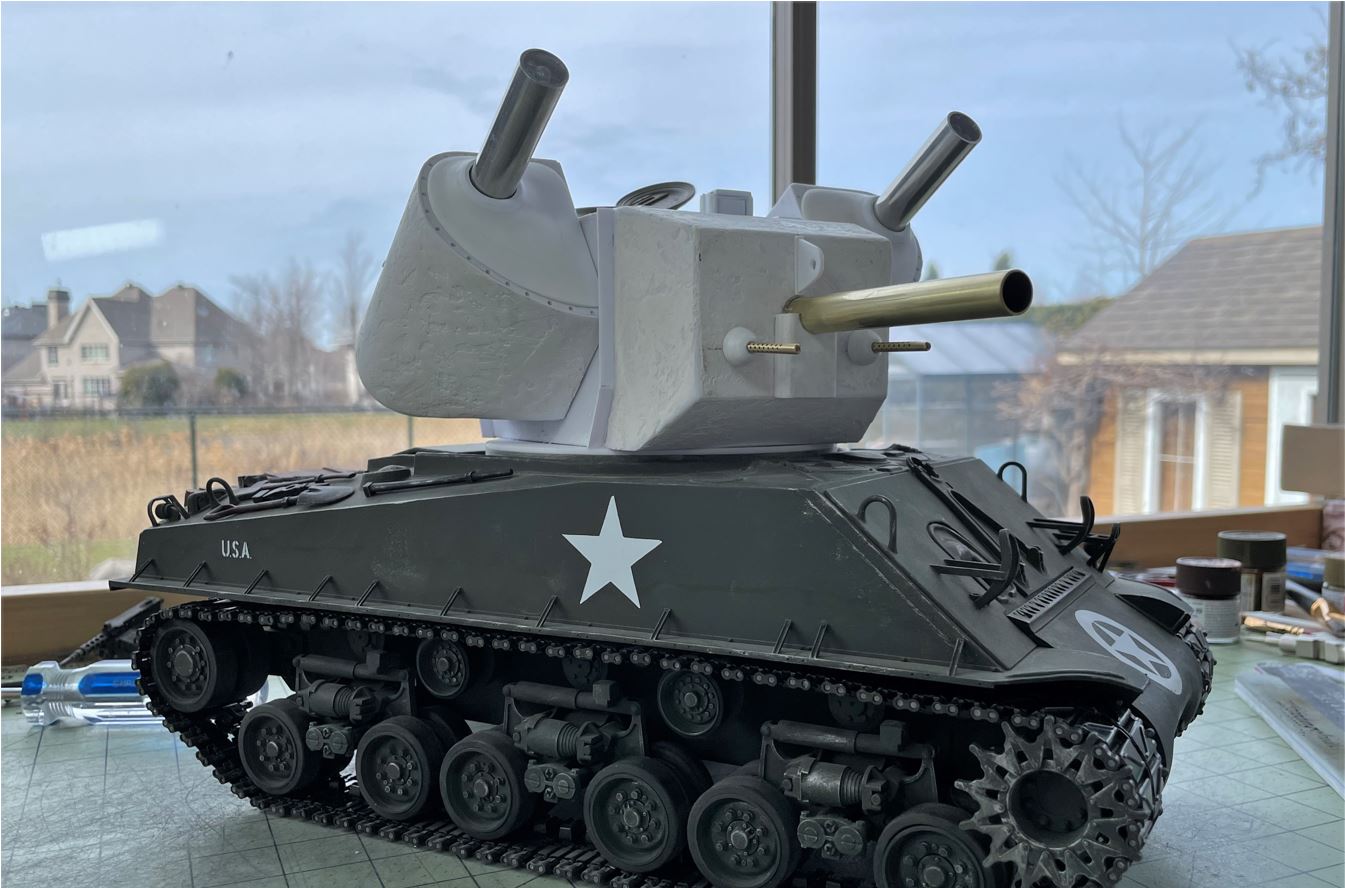

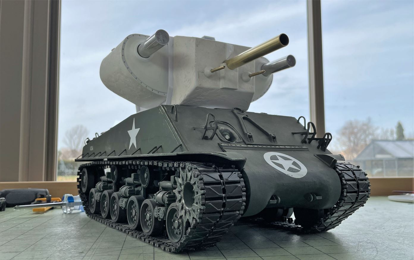

Depositing the T31 turret on the Sherman hull for a first good look of the basic shapes of the vehicle.

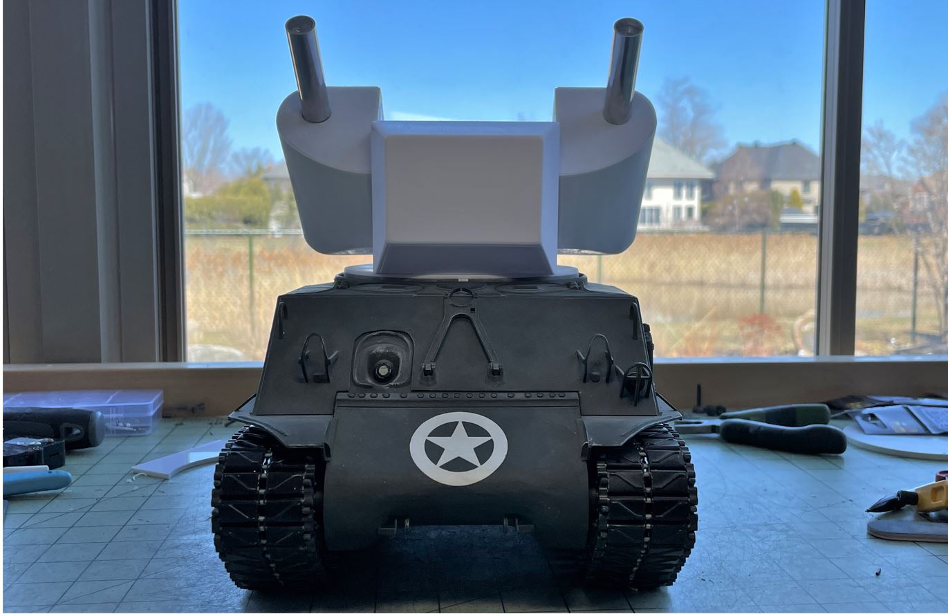

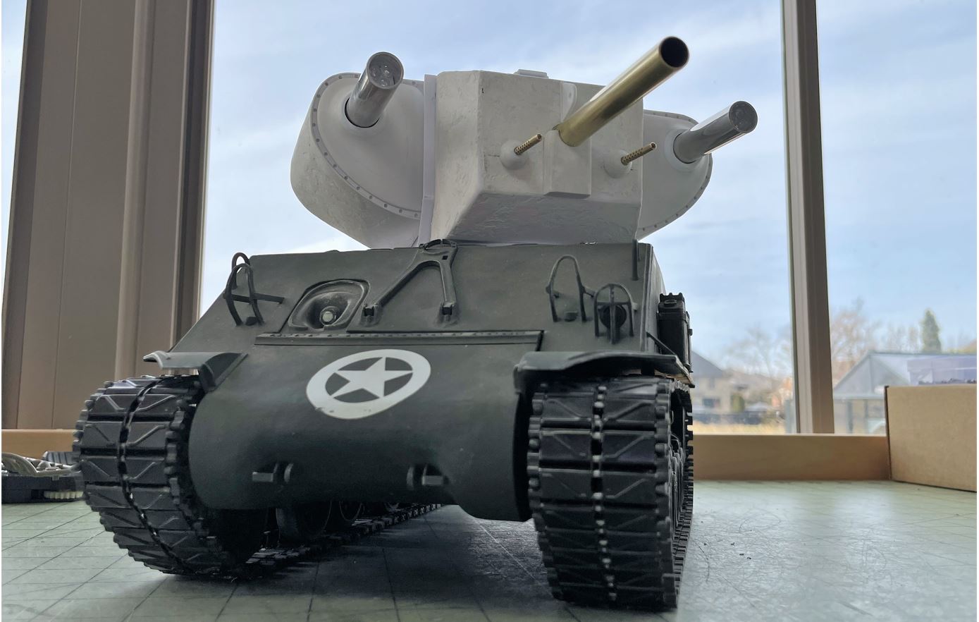

Frontal view.
Side views.
Next step is to reproduce the cast metal effect, and add the various details on the turret structure as seen on the 1/35 kit and reference pictures.

Elevation servo is installed and tested. It is a simple design but very efficient, strong and smooth. Elevation is assigned to independent channel and VRB Knob on the remote.

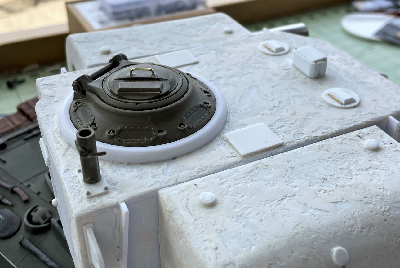

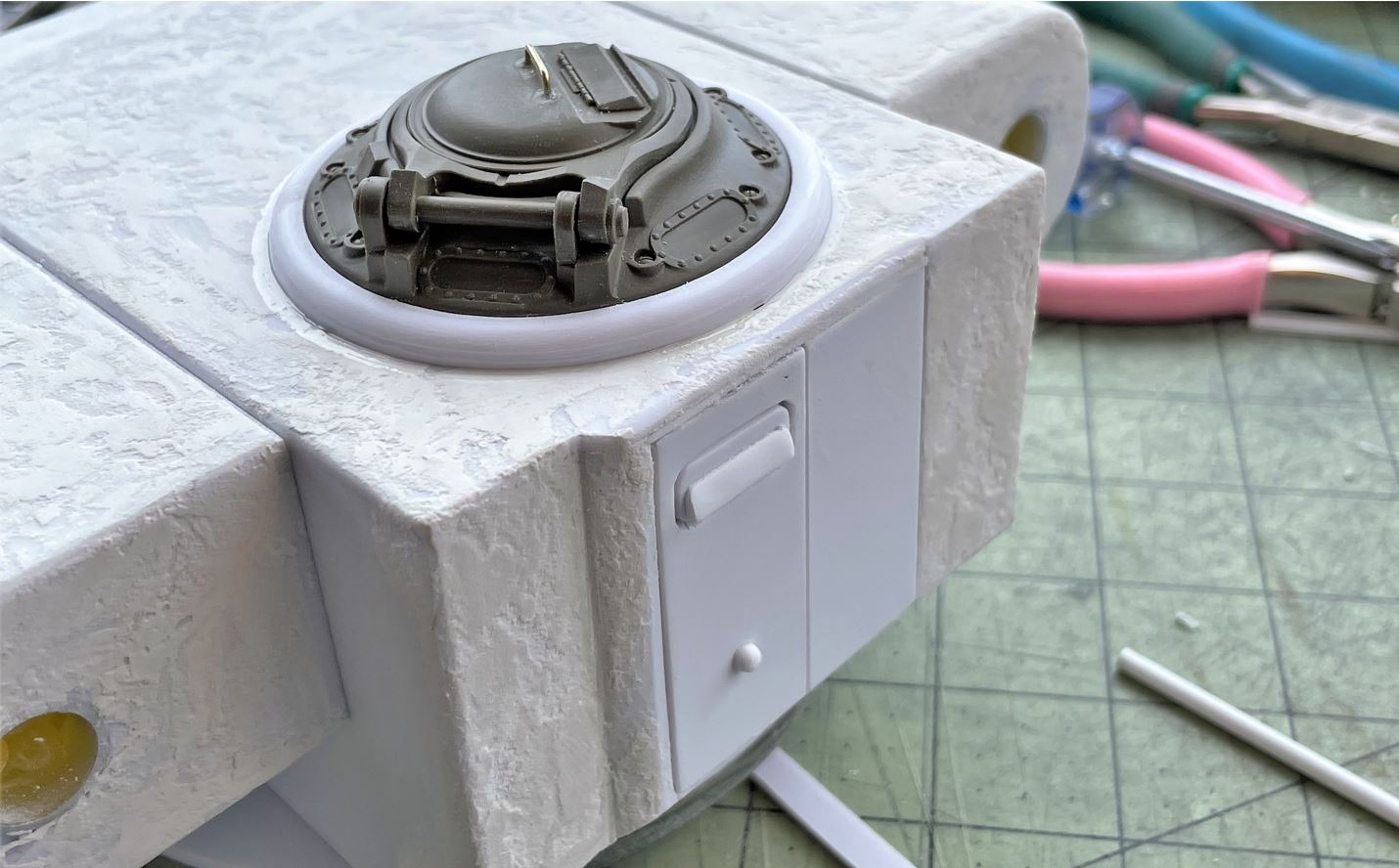

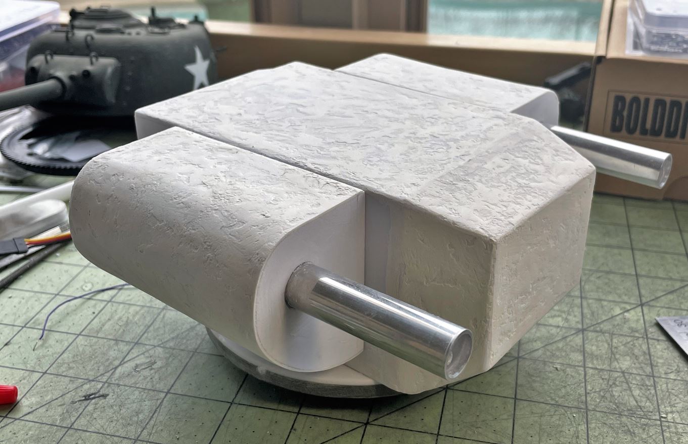

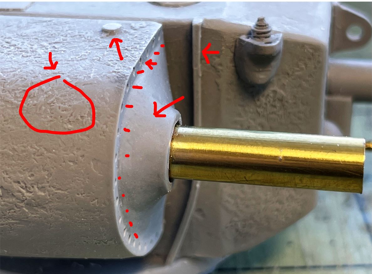

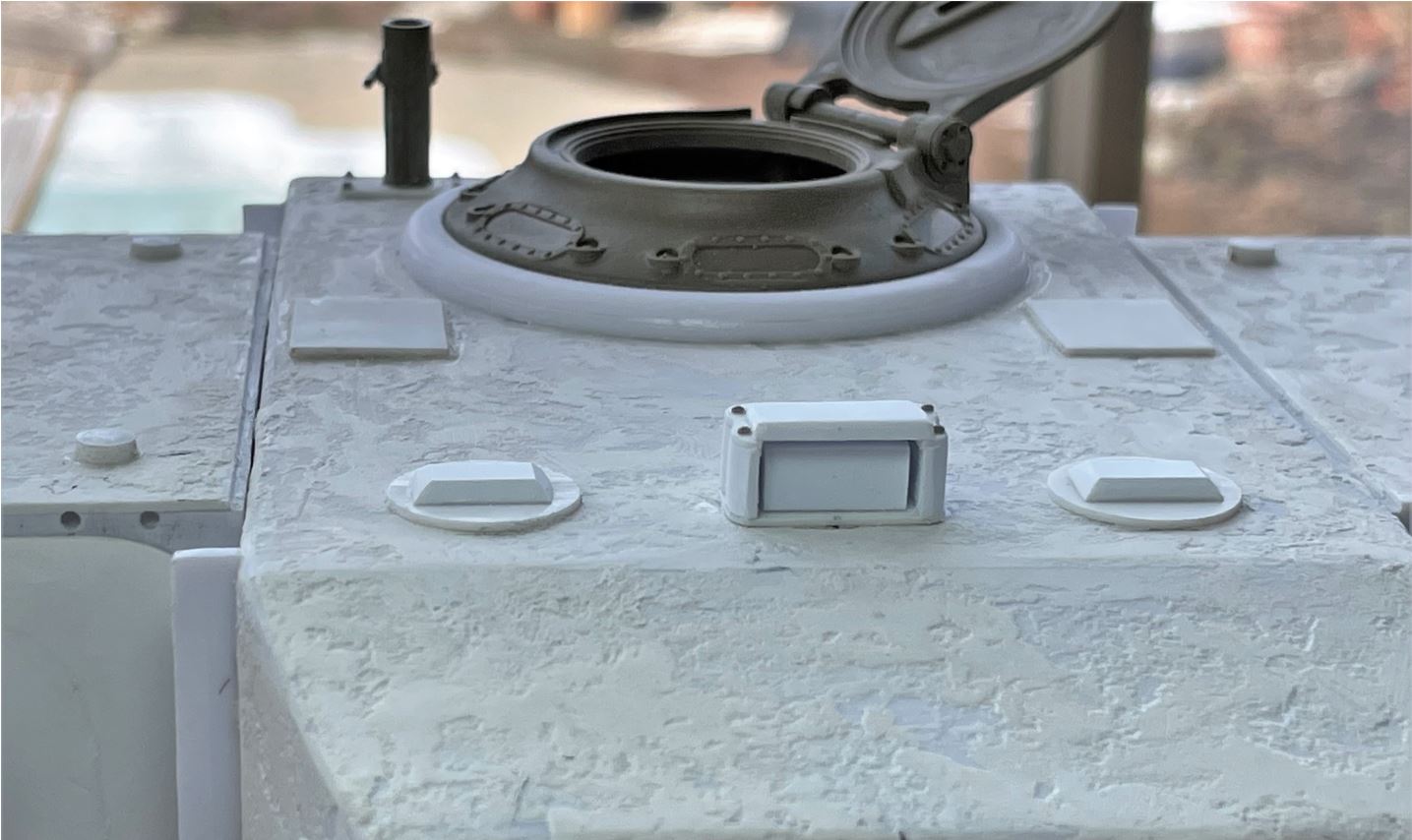

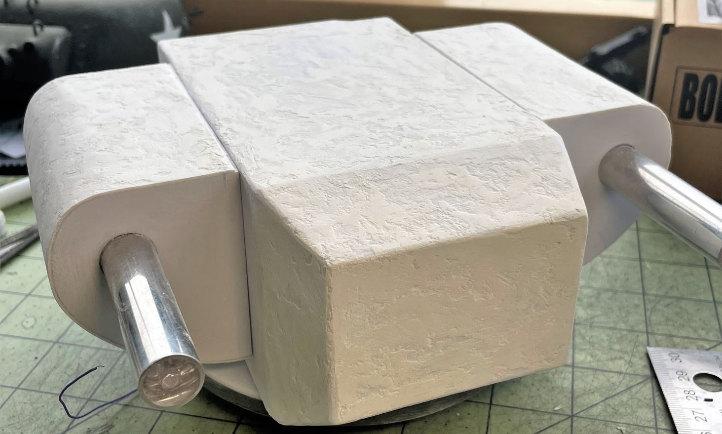

The heavy cast metal effect is done with Testors putty, put on by unevenly massaging the plastic surface with putty using a finger. After drying, the surface is sanded, providing this uneven heavy cast metal effect that i personally appreciate and seen in references.

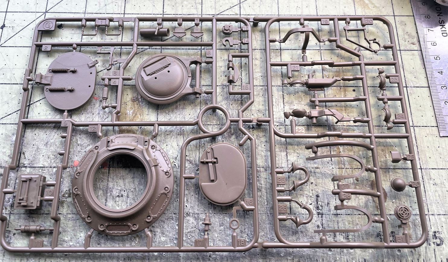

The G sprue of the Tamiya M-26 Pershing kit, purchase separately at Axel, is providing some goodies, such as the commander's cupola and M2 mount.

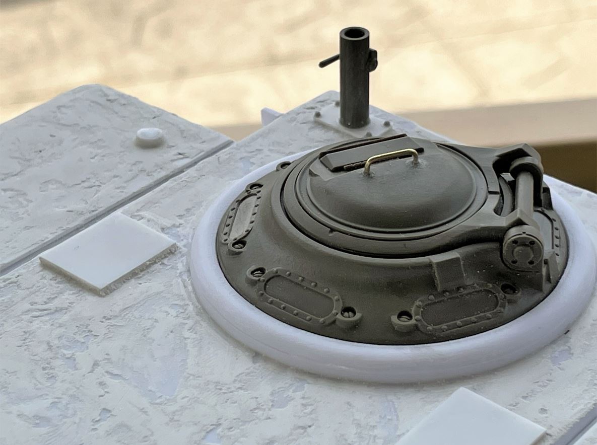

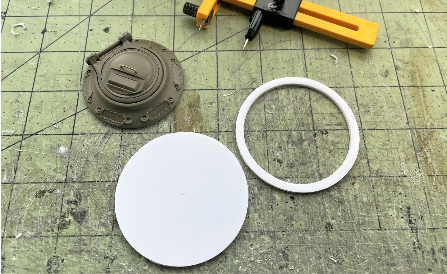

The base seen in reference is done using roundels created with a roundel cutter.
The cupola and the back doors are installed.
Here with M2 machine gun mount and other details added to the top.

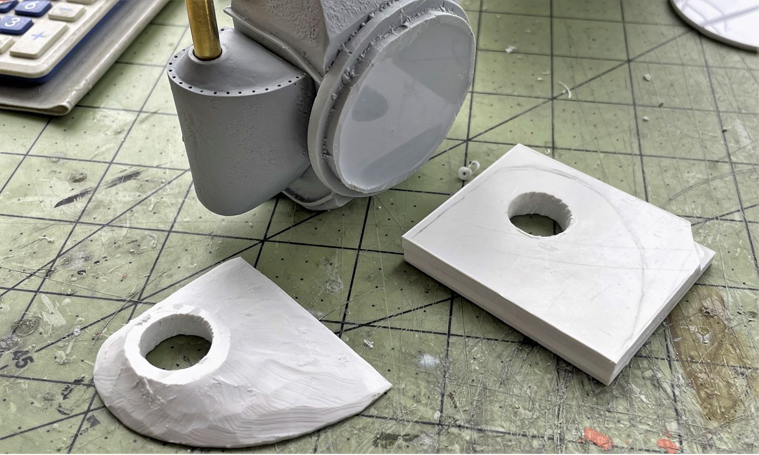

The rocket launchers have a uneven contour section, not sure how to call it. The basic material is 2 layers of 4mm thick plasticard glued together, then the basic shape is carved with the Dremel.
Then extensively polished with a hand file, the last ring is added on top and thoroughly finetuned before installing on the rocket pods with the remaining details.

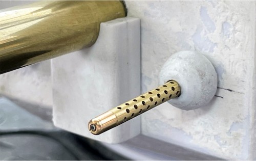

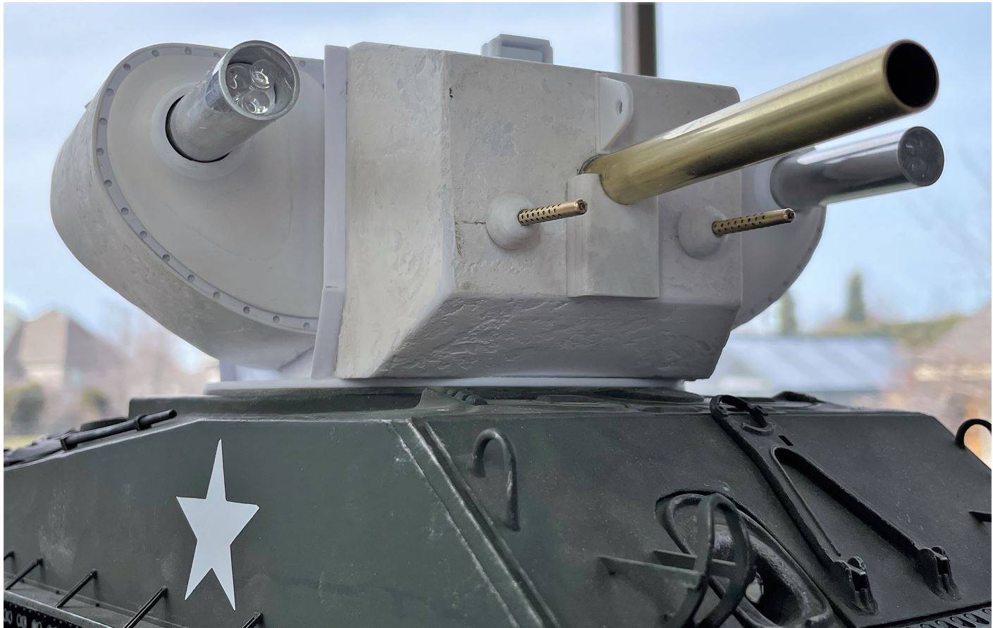

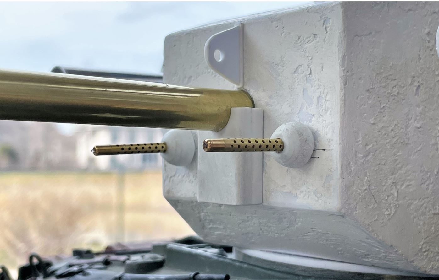

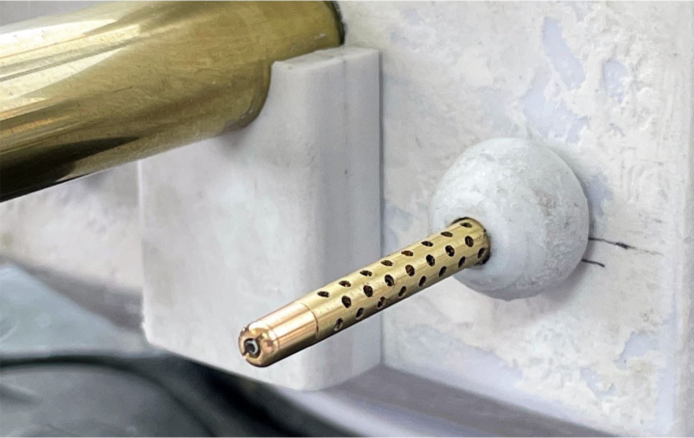

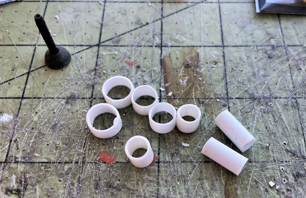

The material for the ball mount for the Browning M1919 machine guns is done with overlaid plastic tube glued together, then shaped with Dremel and finetuned with nail files.

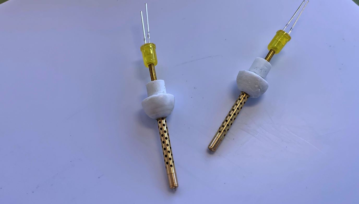

The tips of the Aber M1919 brass barrel are modified to accept a fibre optic through a brass tube and then armed with a 5mm yellow LED.

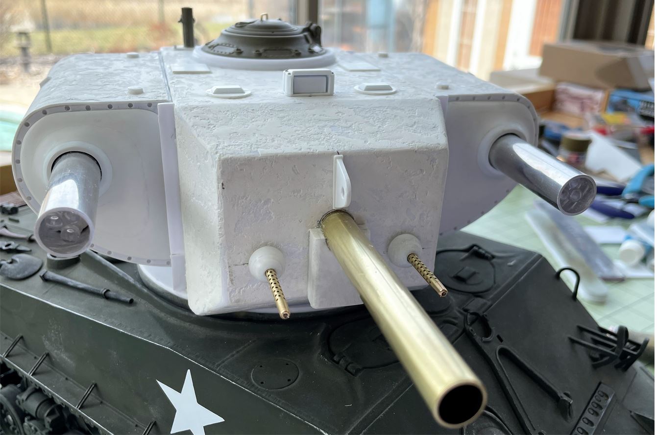

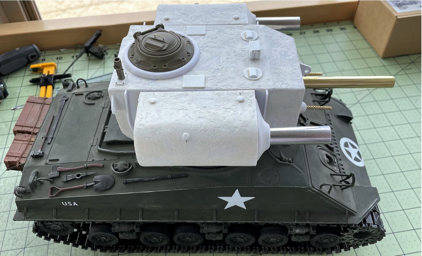

The ball mounted machine guns and the dummy 155mm barrel are installed.
Overview of the mostly completed turret.
