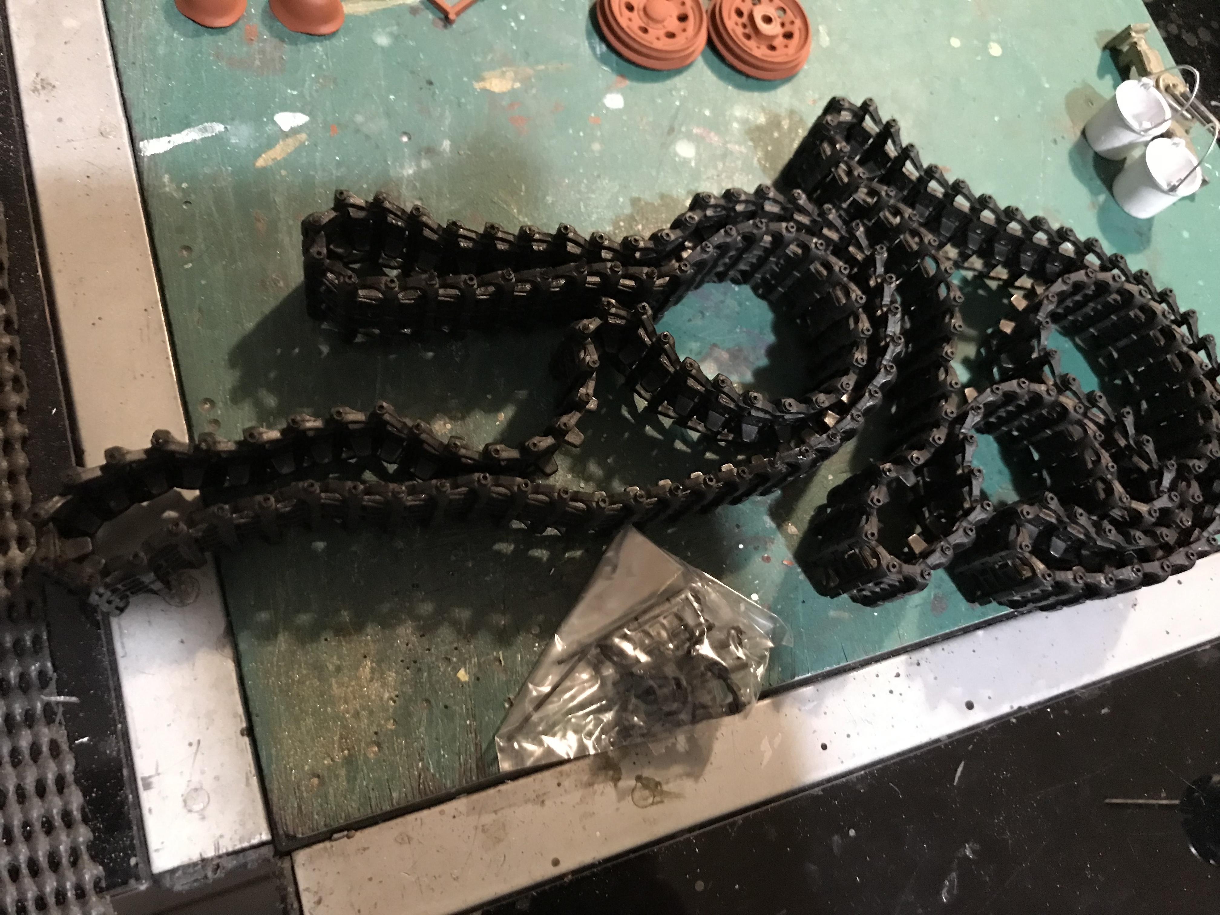

I have a set, and extra links, free if you want them ;)
Brand new.
Pm me with your address and I will get them away

I have one more day of mandatory wuhan isolation then I can get to a post office & send your tracks.

And our friend Herman from down under sent me his unused PZ3 tracks for the project. So thanks to him for that. 8)

More than happy to help in anyway to get this into life !
Let me know when its available in kit form ;)
