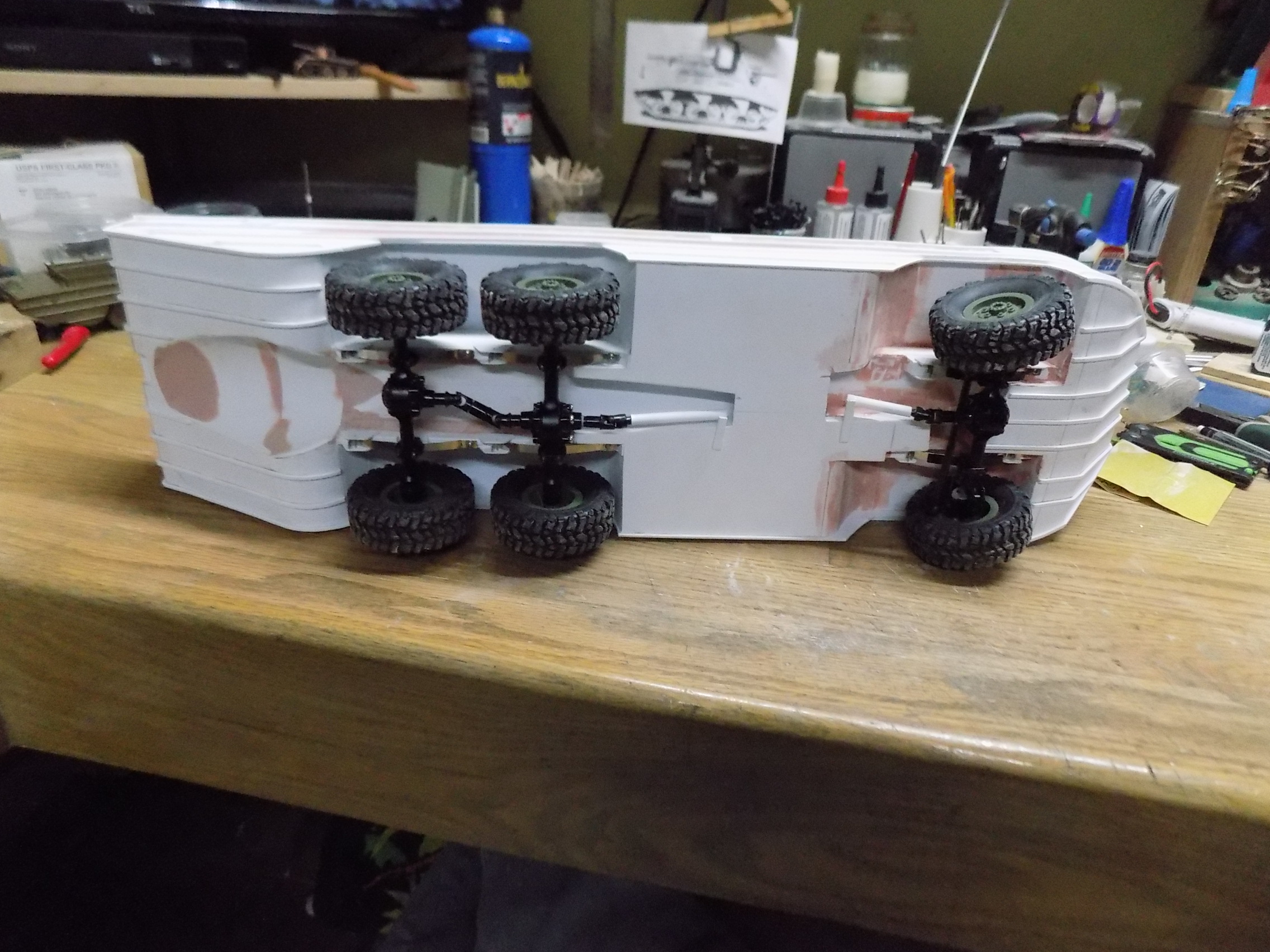

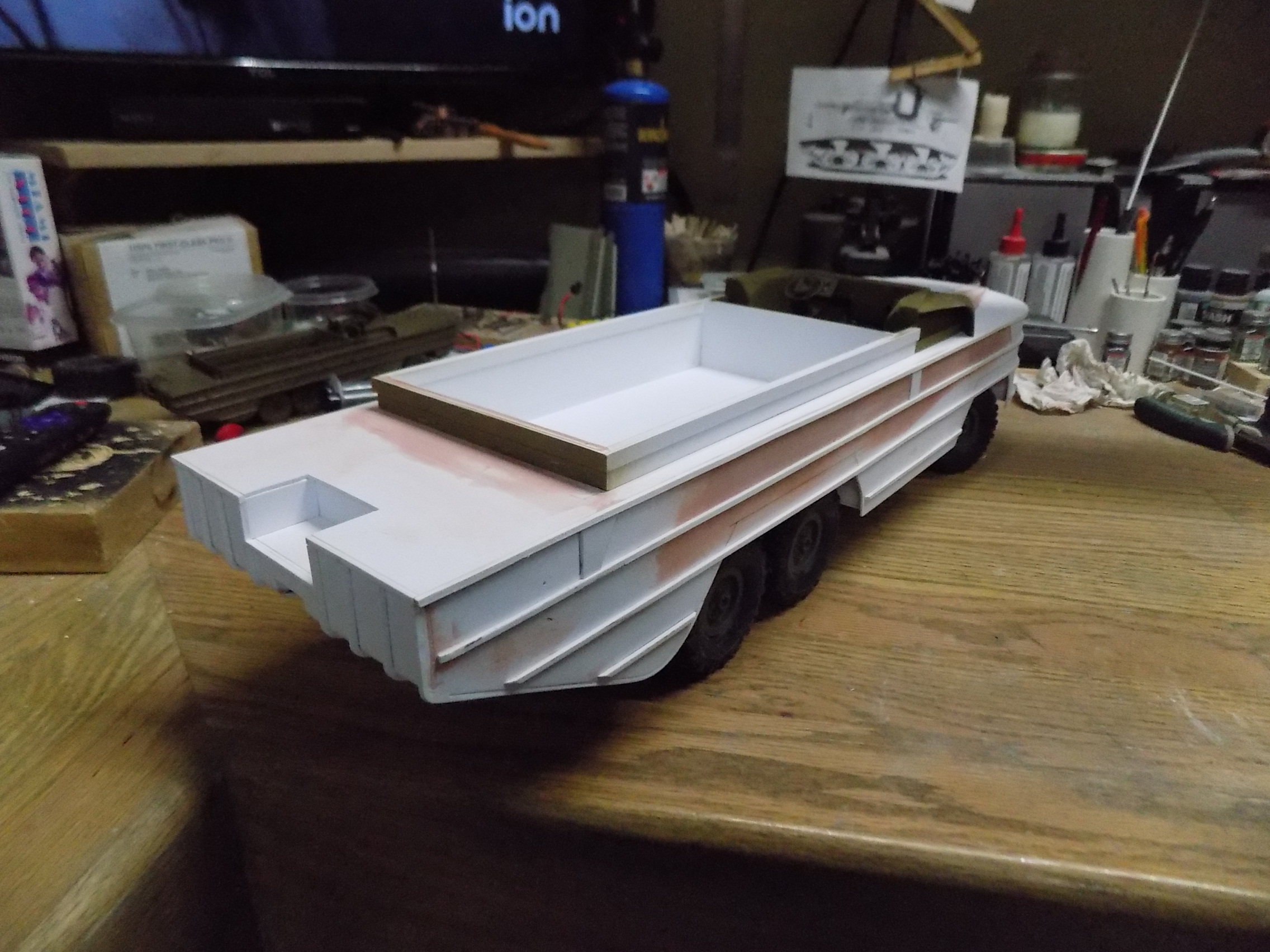

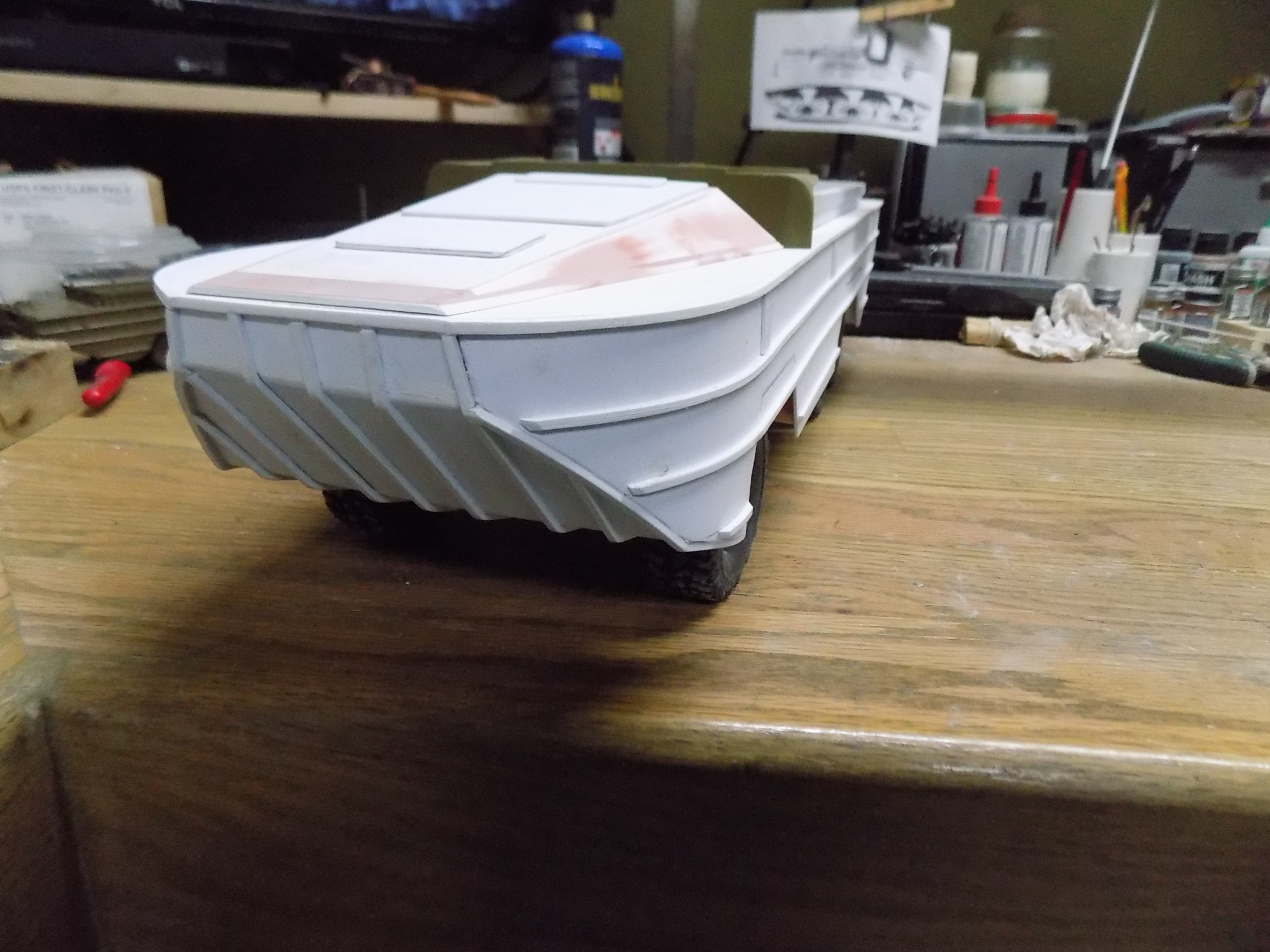

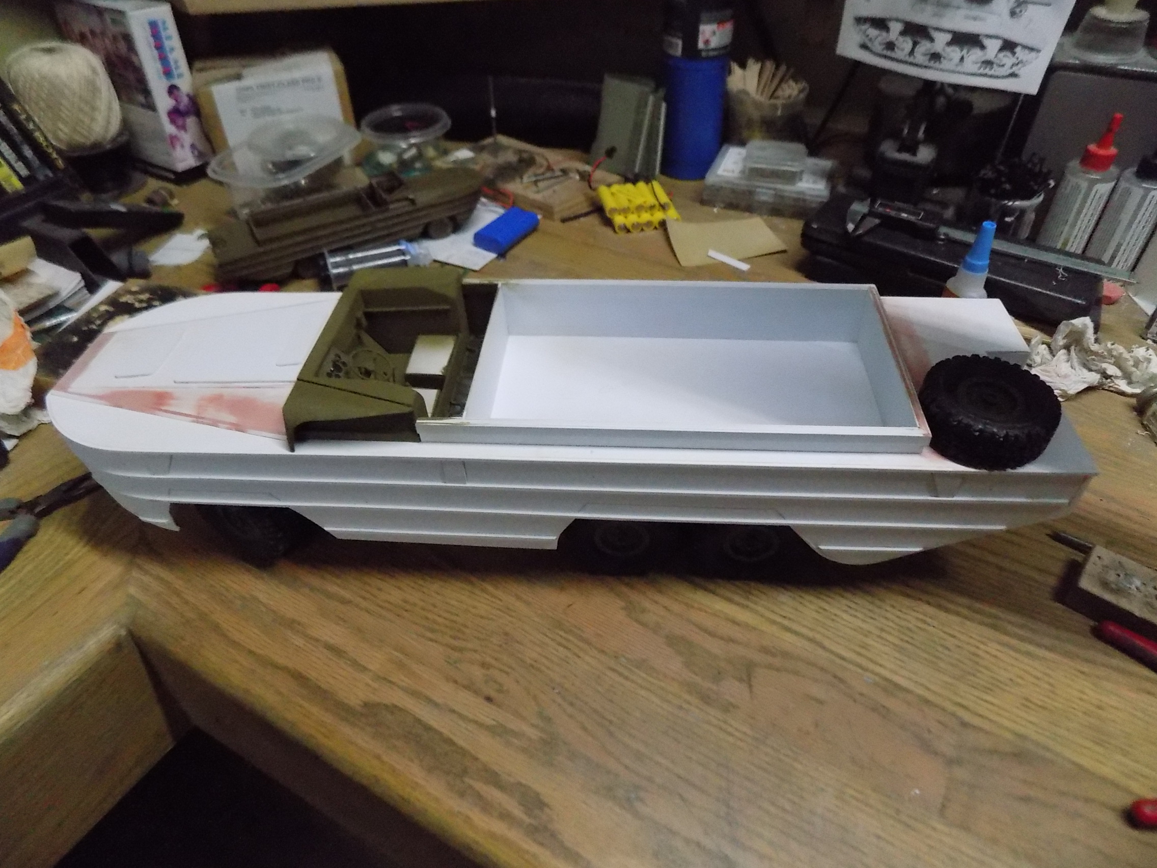

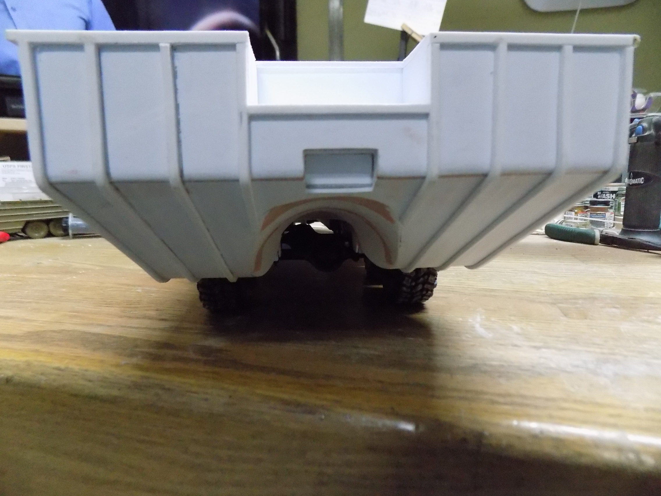

It has been a busy Spring for me and not a whole lot of free time for tanking. But here is some of the progress I've made.
I've decided on an early version of the Duck for the 16th scale. The first 2000 (ish) had a vertical windshield, spare tire on the left side, goofy fold up on the windshield surf breaker and a few other details. It's the less pretty (ugly duckling). The bigger build will be the later (next 19,000 or so) which is a more attractive DUKW. Basically they built 21,147 of these in about 3 years. Along the way they made 500 changes.
I've modified my original cargo bed to fit the early version. Its rise off the deck is even along its length. The later version is sloped up towards the rear as a rear surf guard. Which is what I first built, pictured earlier.
I haven't done the ribbing in the center of the bottom because I'm still working out a water proof transfer case. I tried to be as accurate as I can to the actual hull. But depending on what I come up with there may be some hacking, so I left the ribs out for now. The white tubes on the drive shafts are simply guides for the driveshafts allowing the model to be rolled.

Oh, and if anyone knows of a more accurate tire/tyre to the WWII version I'd love to know about it. The wheels aren't too far off.

Hi M16 Half track tyres are close, so are the 1/12 scale jeep tyres and wheels but you will need to make an adapter to fit the axels.Both are just a couple of millimetres out.

I bought the set for my build from Germany ( AFV model ) they're not cheap when you need six of them but they do suit it well, you will also need to widen the rims or get someone to print a set as they are slightly under sized for the tyre, zoom in on the picture to see the tread pattern a little better, hope this helps

I have not forgotten this build thread....
Parts have been trickling in. I recieved two transfer cases and chose the one that will work best. Now I've ordered and am waiting on the drive shaft and prop shaft pieces. I will have to do some custom fitting on the drive shafts for length and to go from 5mm t-case to 3mm HL axles. I'll get some pictures up soon as I get the T-case installed.
