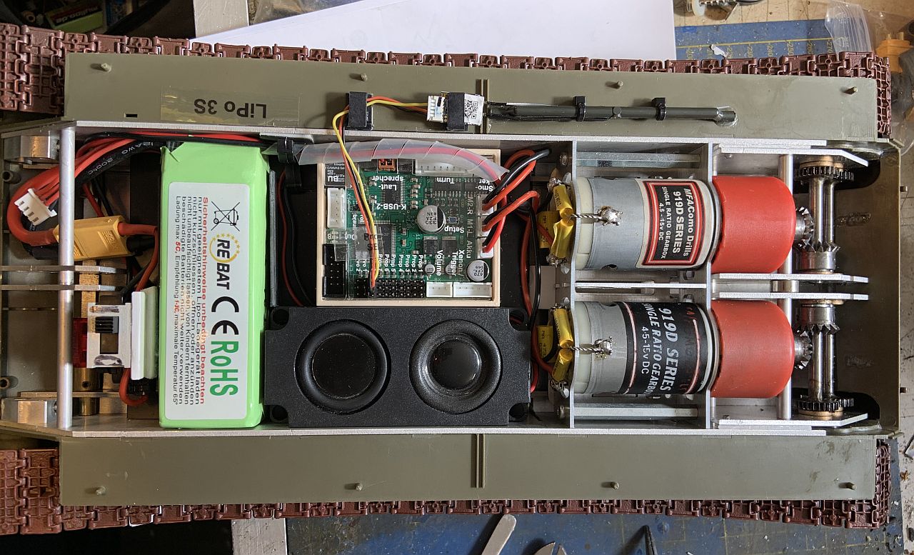

The last few weeks I have put the whole thing together and added a Beier SFR-1-HL electronics:
Yesterday it was time for the first rollout:
The tank is not ready yet, details of ageing and weathering are missing.

Cool build. For a small tank, it's amazing how much room there actually is inside for all kinds of different configurations.
