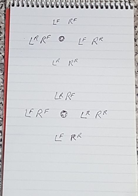

Here's a quick diagram to explain. This is the right-hand joystick, with its four main positions.
Top picture shows what each gearbox should do when you push the stick to those positions. Bottom picture shows what your boxes are doing when you push the stick to those positions. Note only the left box is different, as in wired the wrong way around. Gearboxes only go forward or reverse.
Large L is for the left gearbox, and large R is for the right gearbox. Smaller F for forward and small R for reverse, which are showing the direction the gearboxes will drive.

Re: Gearbox upgrade
Hi just to clarify
Do I only change one motor polarity on one motor only and nothing else and is that the left motor looking from the front or looking from the back

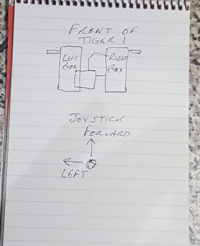

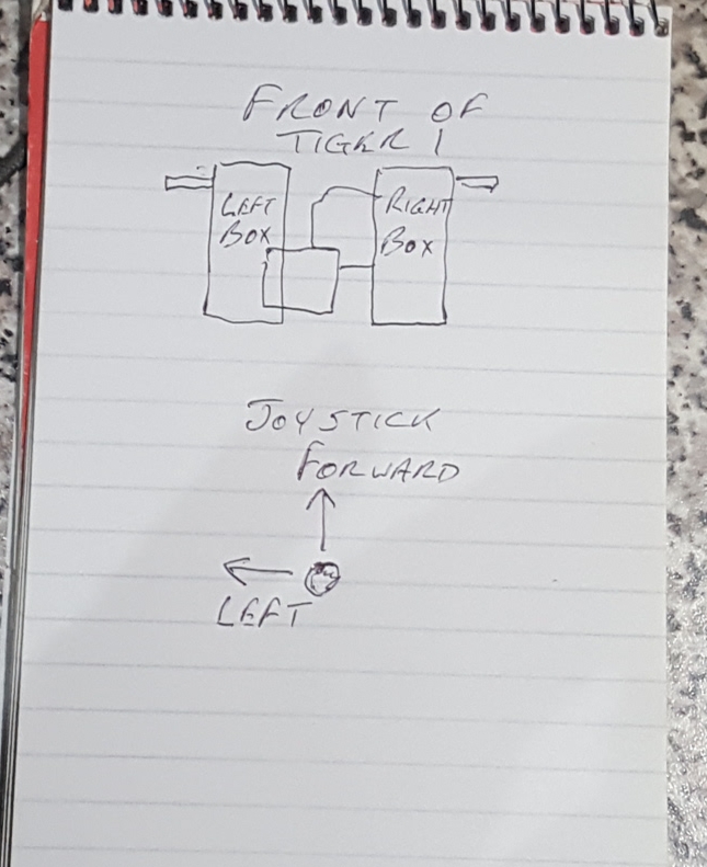

Only touch one motor, the one that is wrong.
You said the tank drives left instead of forward and drives forward when it should go left. Therefore you alter the polarity on the motor that is on the same left you are referring too.
Diagram to show what left I mean

Re: Gearbox upgrade
Apologies sent question before diagram received
Many Thanks
Dave
Many Thanks
Dave

Re: Gearbox upgrade
You have been most helpful
Many Thanks for your advice
Dave
Dave

Re: Gearbox upgrade
You were very clear, as the mechanical tank Virginia I was crossing the t'sand doting the i's lol

Just opened tank, oh how embarrassing, I had reversed the polarity..
Just heating up the iron whilst I ring the GP for a colour blindness checkup
