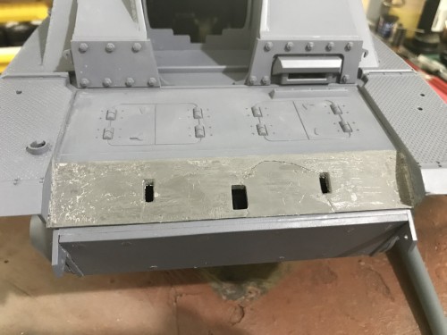

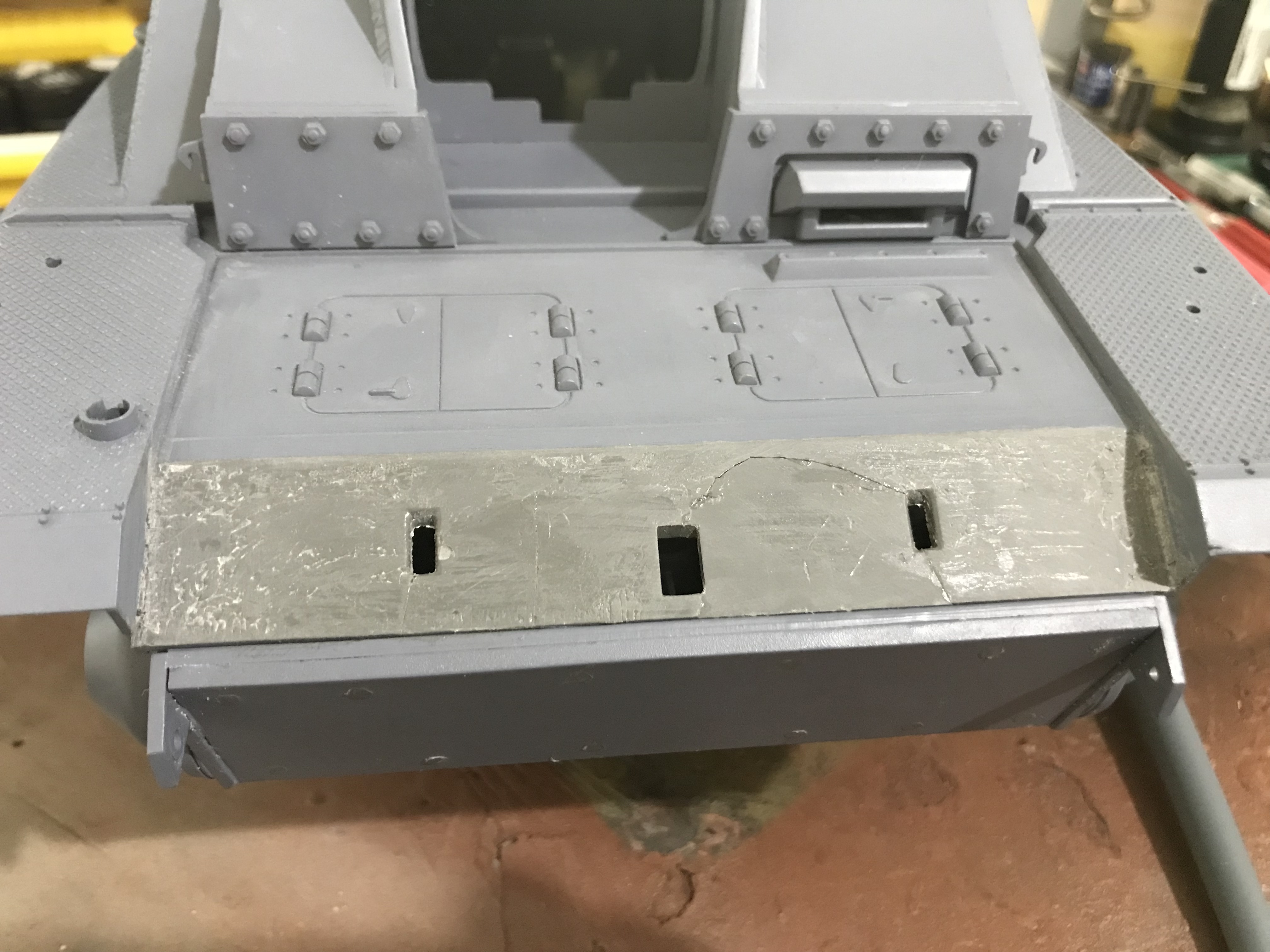

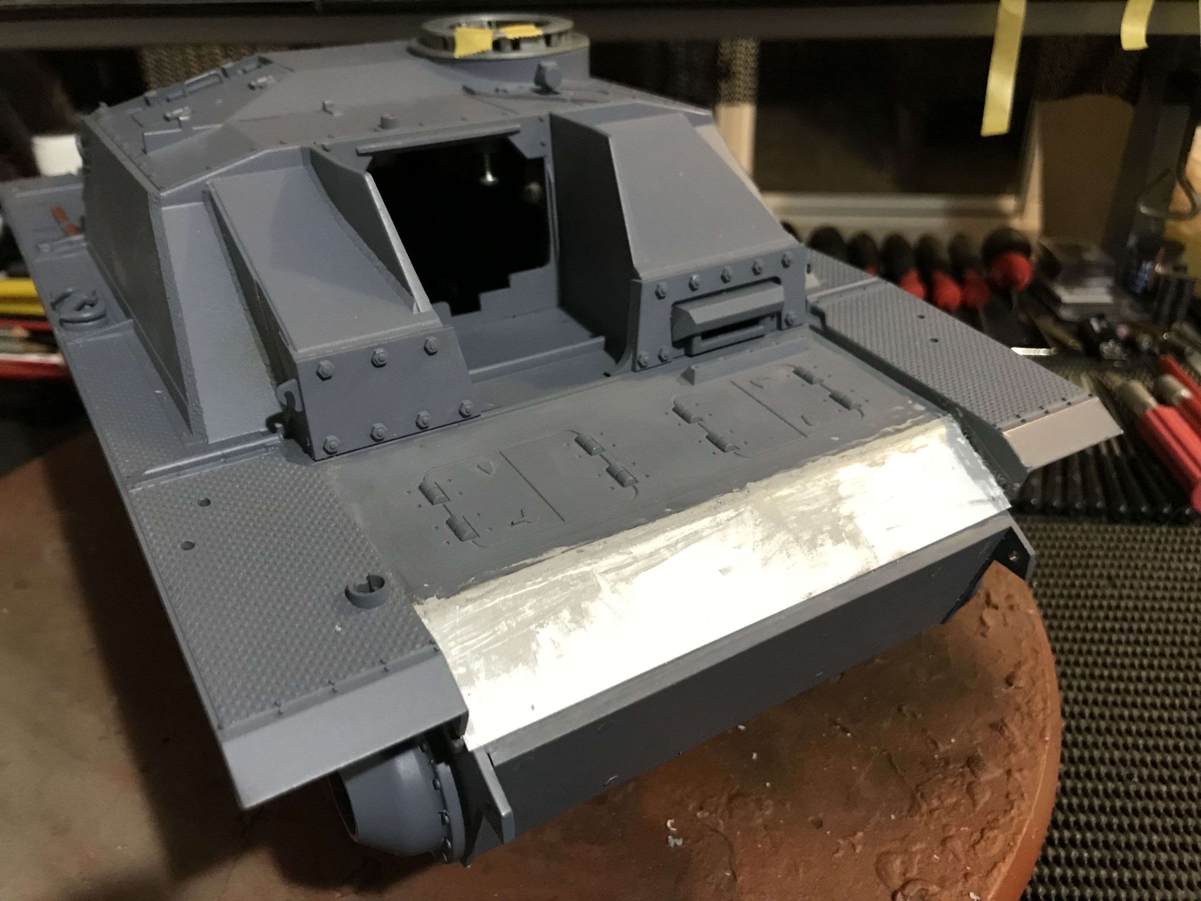

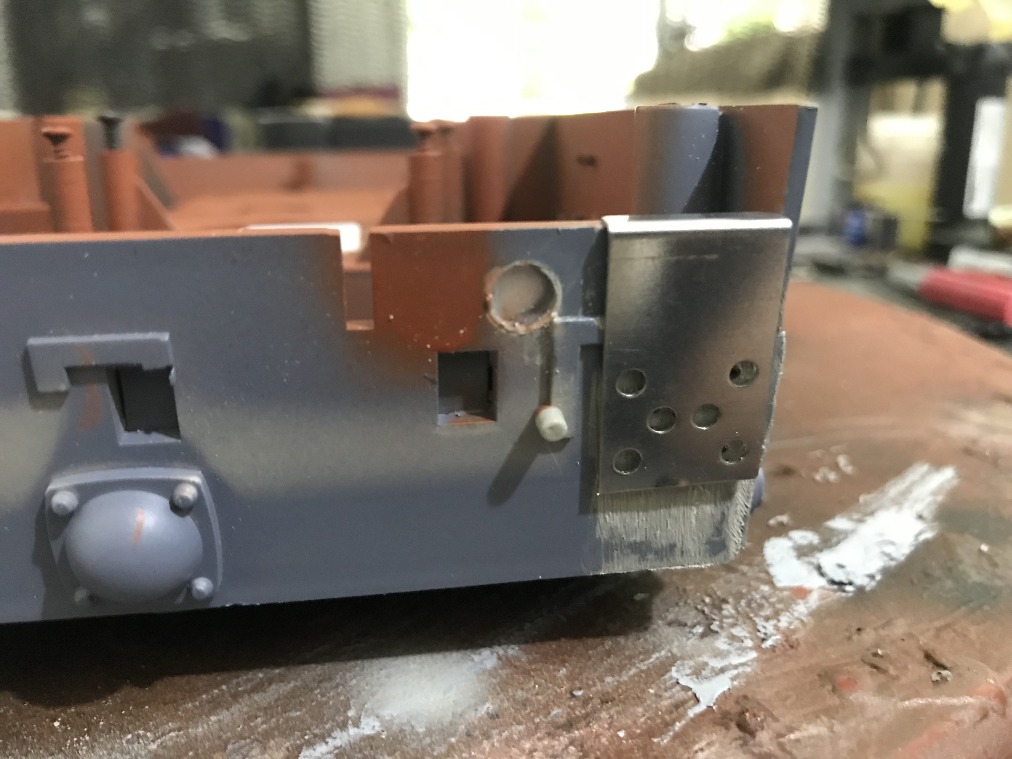

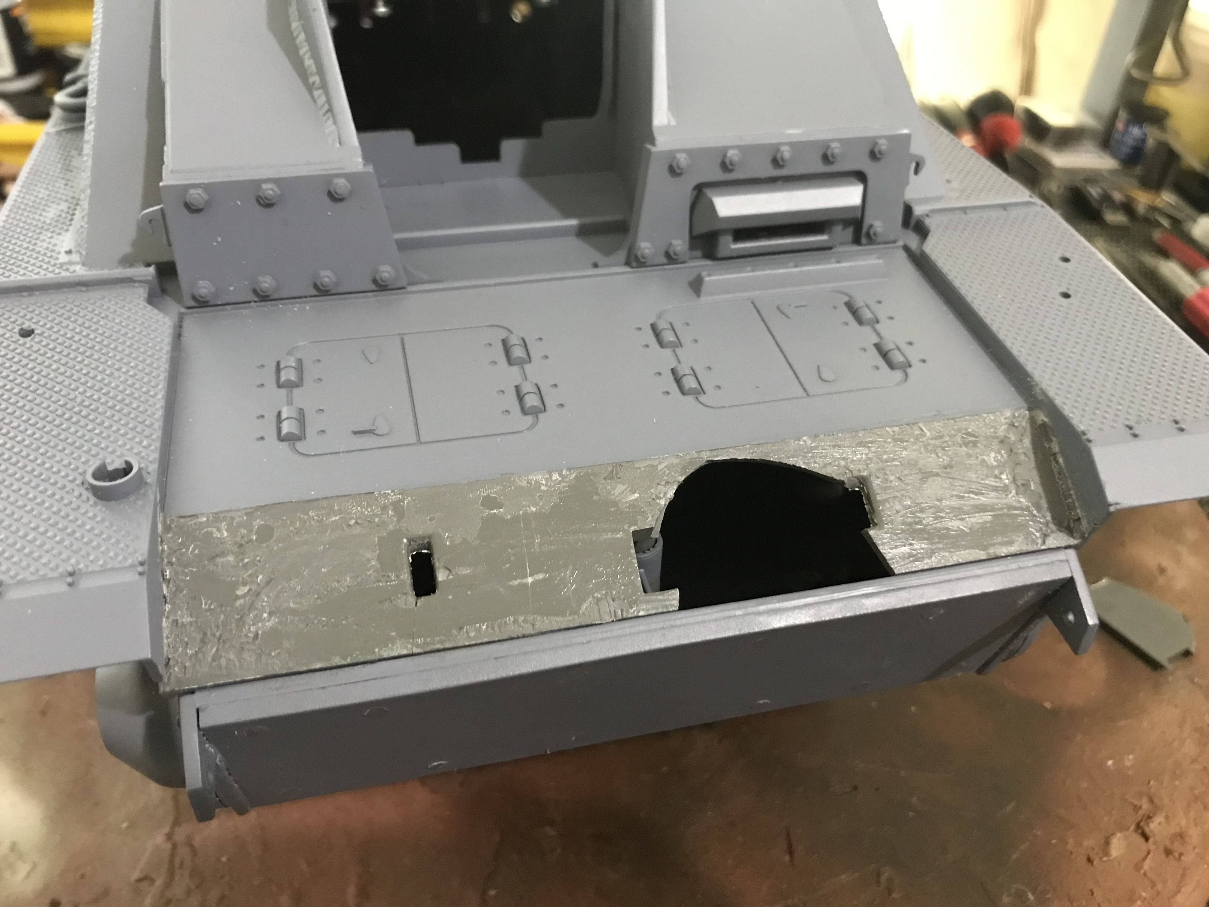

Now I have a box of removed bits on one side, and the empty carcass of the Stug on the other :/
Ive filled the hull penetrations and removed the bolt heads from the lower hull glacis plate.
I tore off, yes tore, the bolted plate off the upper glacis as no matter what glue de-bonder I used, it did not work.
Jammed a screwdriver into the joint & got my twist on :shifty:
Paid the price for that, but its off, repaired, and now a thin 0.5mm section of styrene over the mess to recreate the look of the later front hull armour.
Mr Mcq11 did this process on his winter Stug a while back, but used a Taigen lower hull.
Its the only way to get the later thicker armour to look right.
Im staying with the H/L hull due to simple economic sense of not shelling out on poor currency rate and high postage down here. :/
Things like the tools molded on the guards will be ground off & replaced by others with a better look & left over PE sprue brackets.
Most of that wont be seen behind the schurzen anyway.
I was intending to do the conventional Zimmerit with a hot screwdriver, but I may go another route(NOT Atak) yet.
Lots to do even though its a small machine

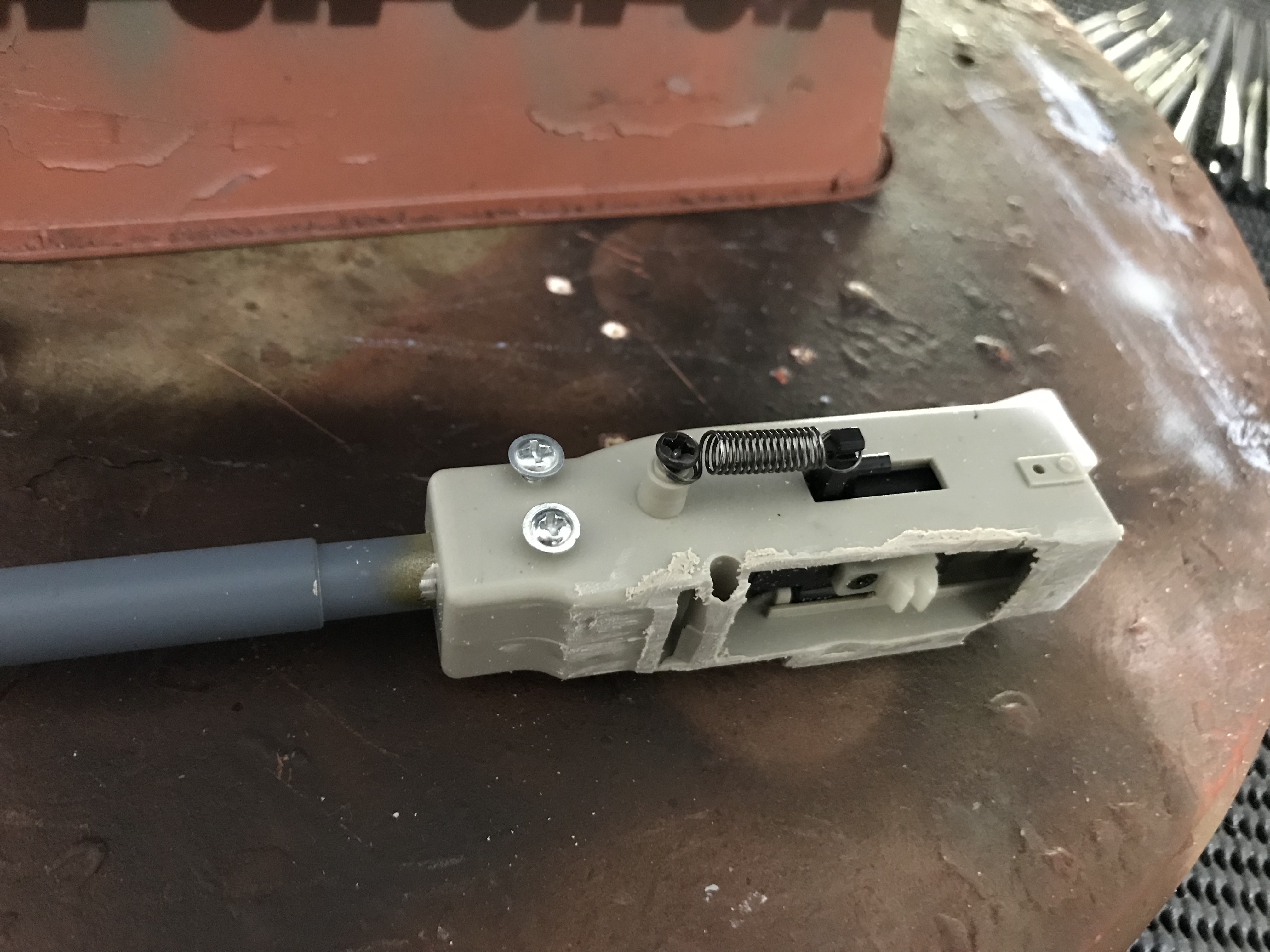

Recycling the recoil unit for servo control

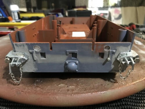

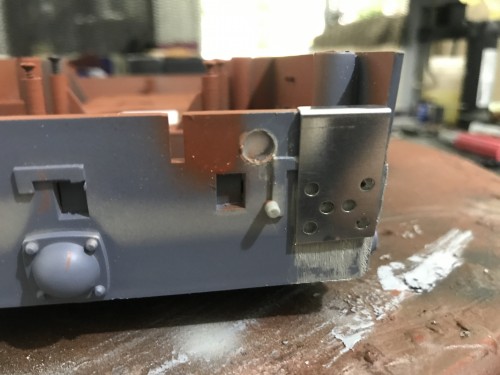

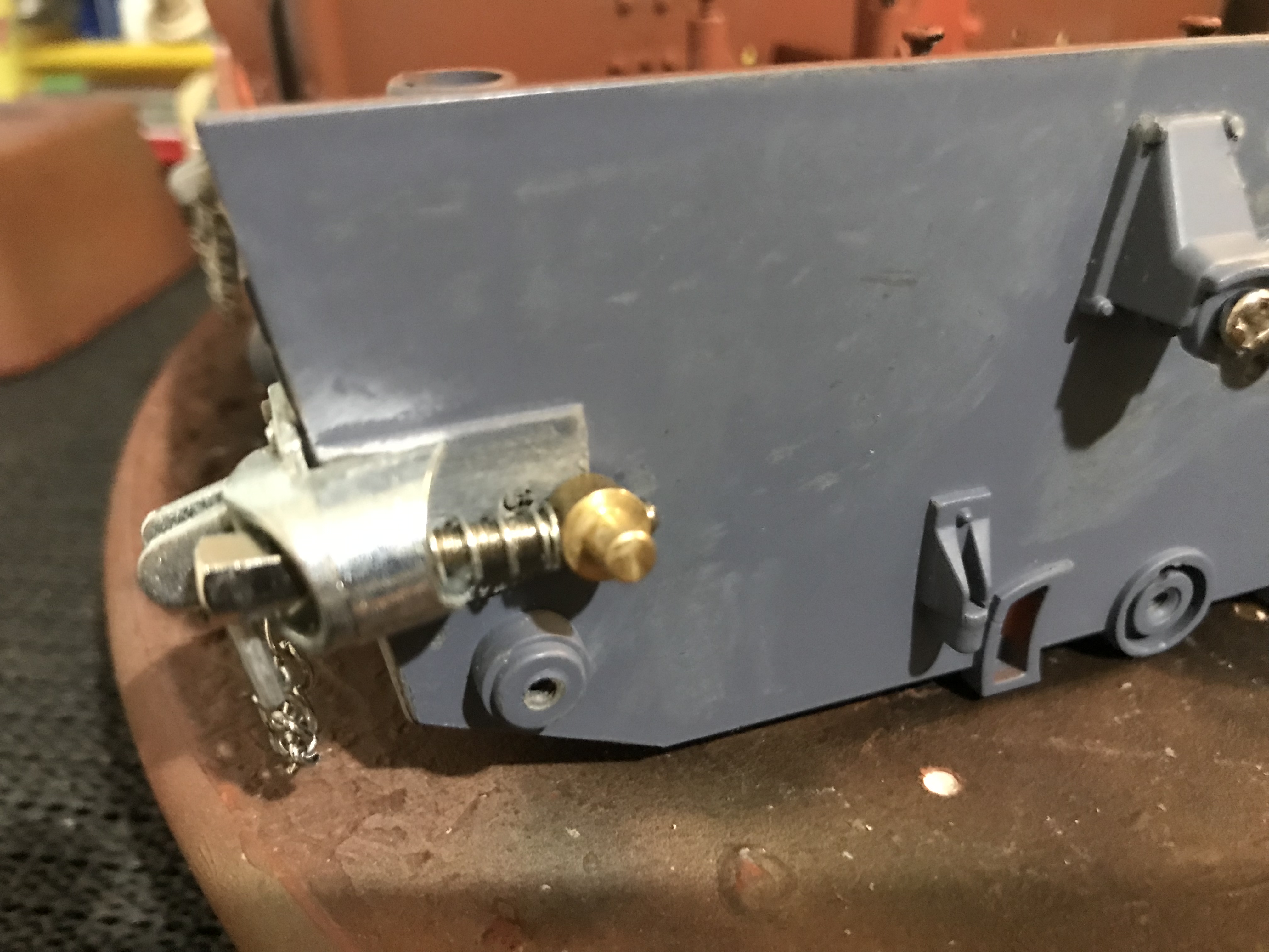

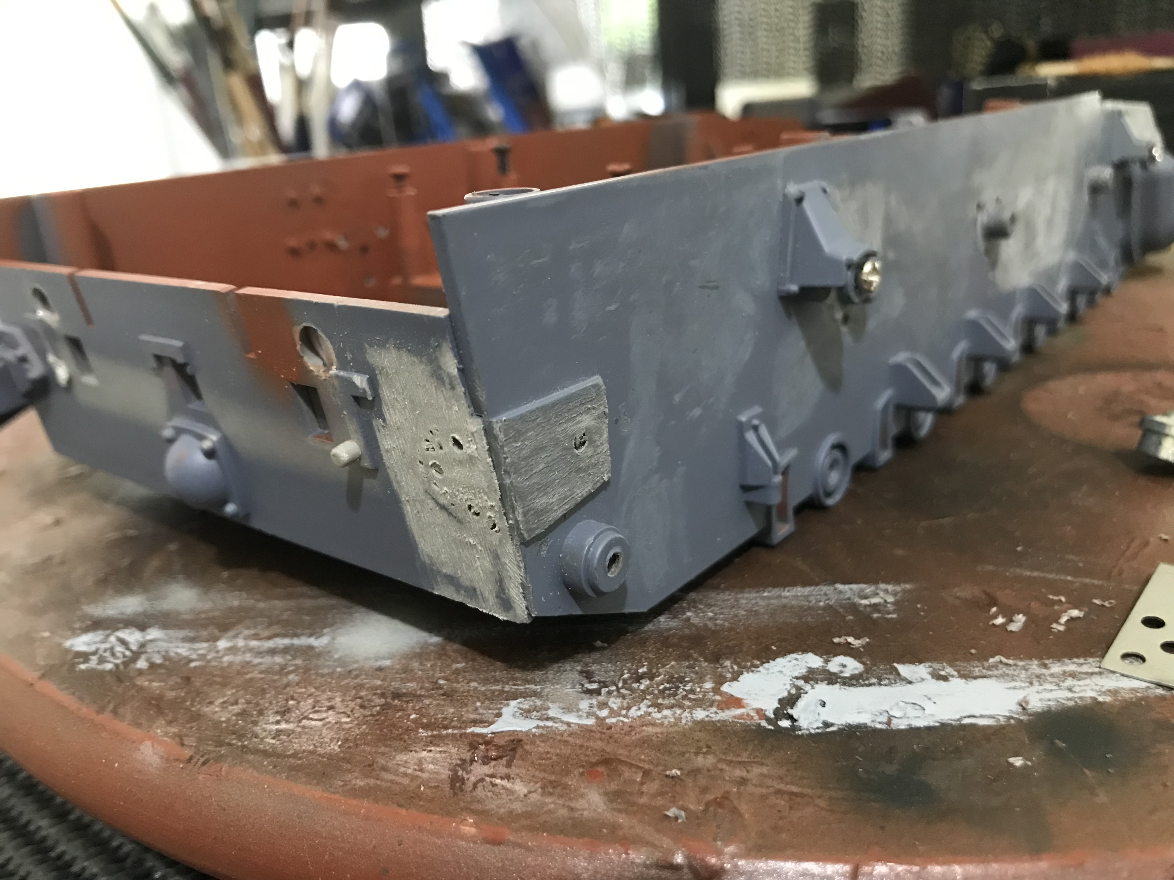

Bit much re on the lower hull today.
A lot of grinding off and sanding to get the thing looking right.
Again the mini-vac was the best tool in the house !
The track tension units were fitted a lot easier this time than on my Krieg-Schwein StuG ages ago, I had the drilling template this time.
I’ve had bits for this for 3 years & not paid any attention to them as I gathered other bits along the way as they came up.
Now I find out that the idler wheels I have don’t fit the tensioner’s :-<
Some minor engineering required to overcome that. No replacement parts available down here so adapt and overcome it will be.
Also found the road wheel tyres are perished :wtf:
Again , I know I can get replacements but only from overseas and not in a day or so.
One half of one road wheel is also missing. I be assume at the time I bought them, years ago, new and open the bag to find half an F’n wheel missing :-<
It’s like me doing 3 Russian tanks in a row has upset someone!!
