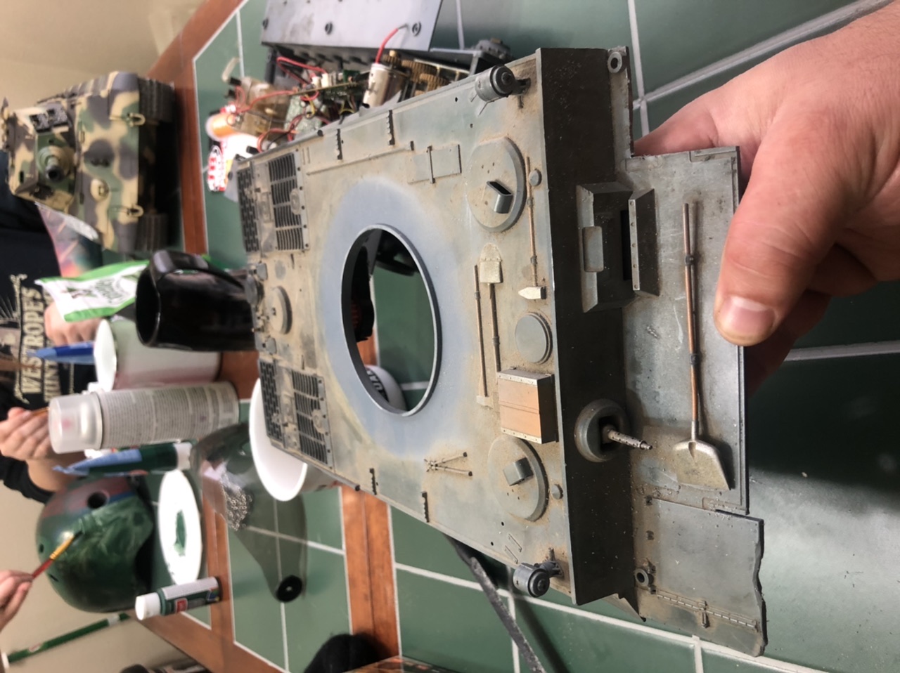

While waiting for hardware for the road wheels I started to do some cutting! Question does anyone have any experience with completely gutting all heng long old style electronics and using all new taigen motherboard and all other parts internally? I saw a kit for $199 for what looks to be all electronics needed.
