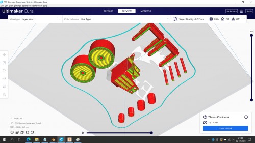

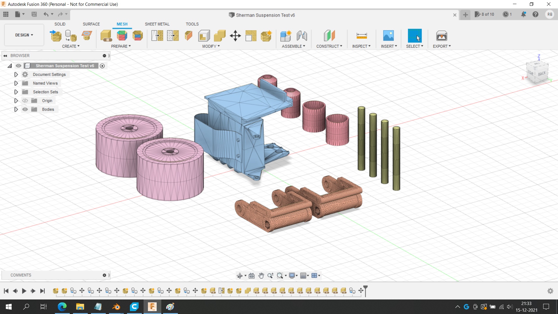

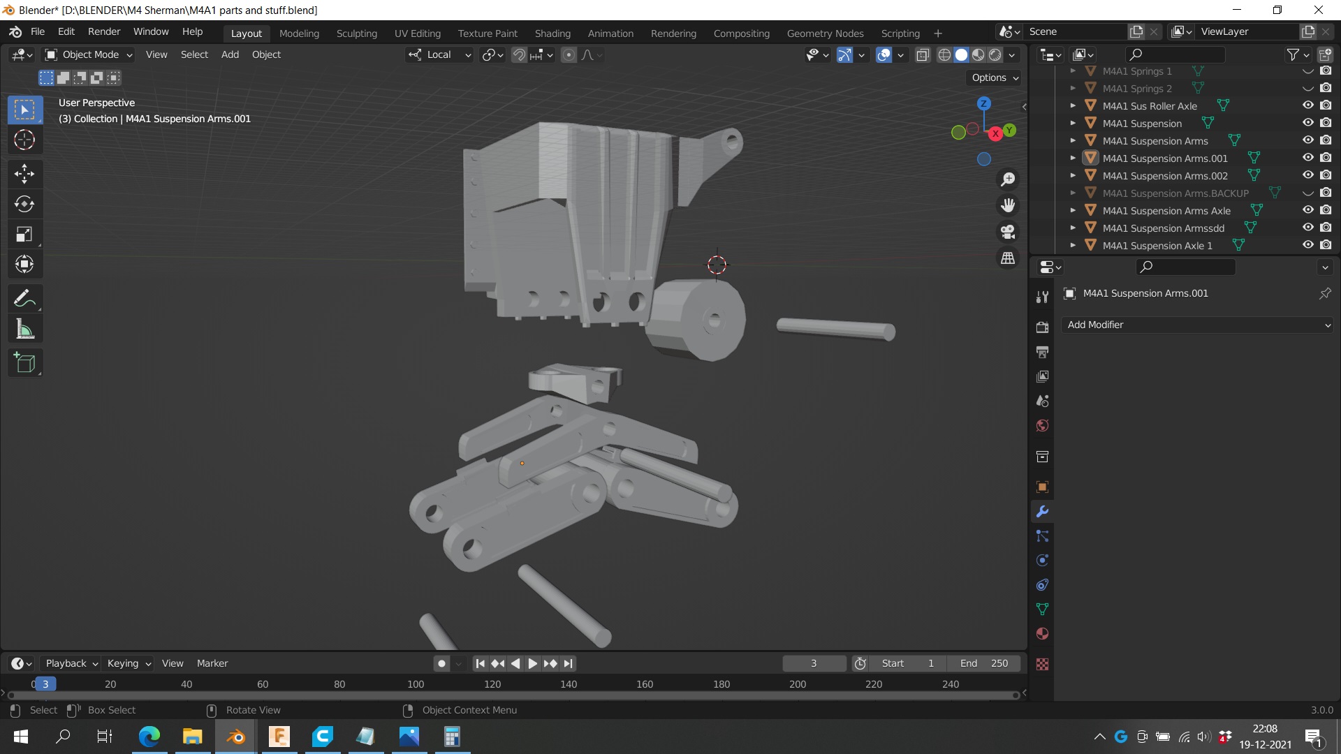

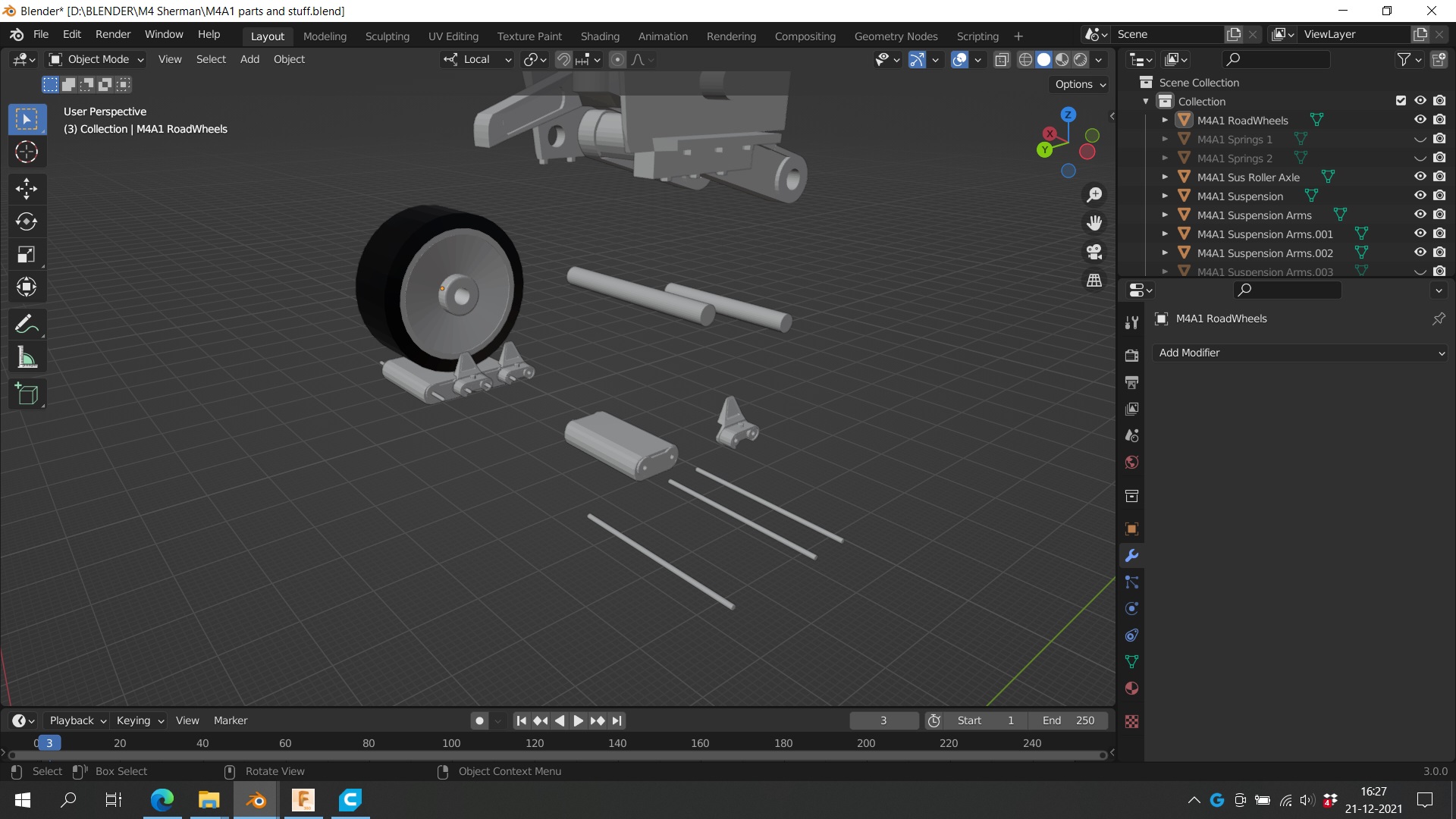

So I spent quite a few hours on redesigning and working out the suspension. I think I've got a first prototype now, so I'll print one the check if it works as I designed it!
I've designed it in Blender V3.0 (I like how the program works, very nice for scratchbuilding complex parts), then imported in Fusion 360 and reworked so that it can be printed and finally checked in Ultimaker Cura slicer.
The first prototype will be printed tomorrow, so hopefully some "real" progress soon!
Here you can see the difference between my old 'static' bogie (right) and the redesigned working unit (left).

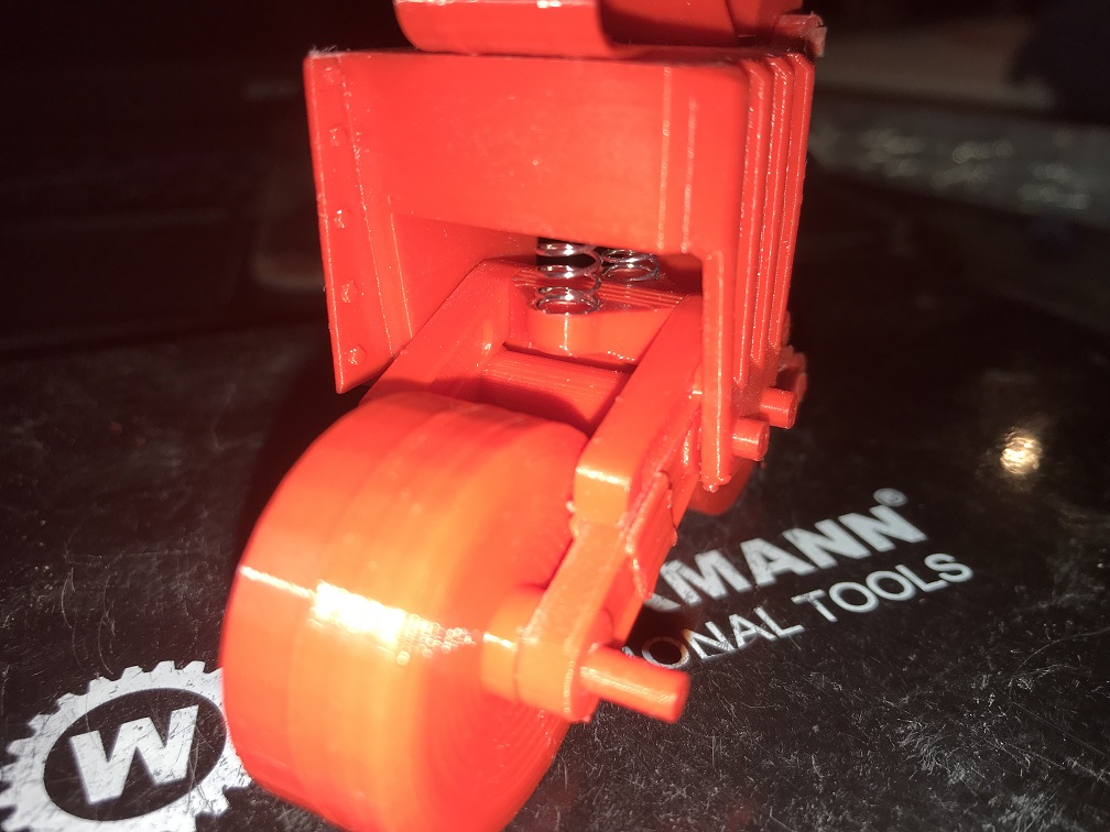

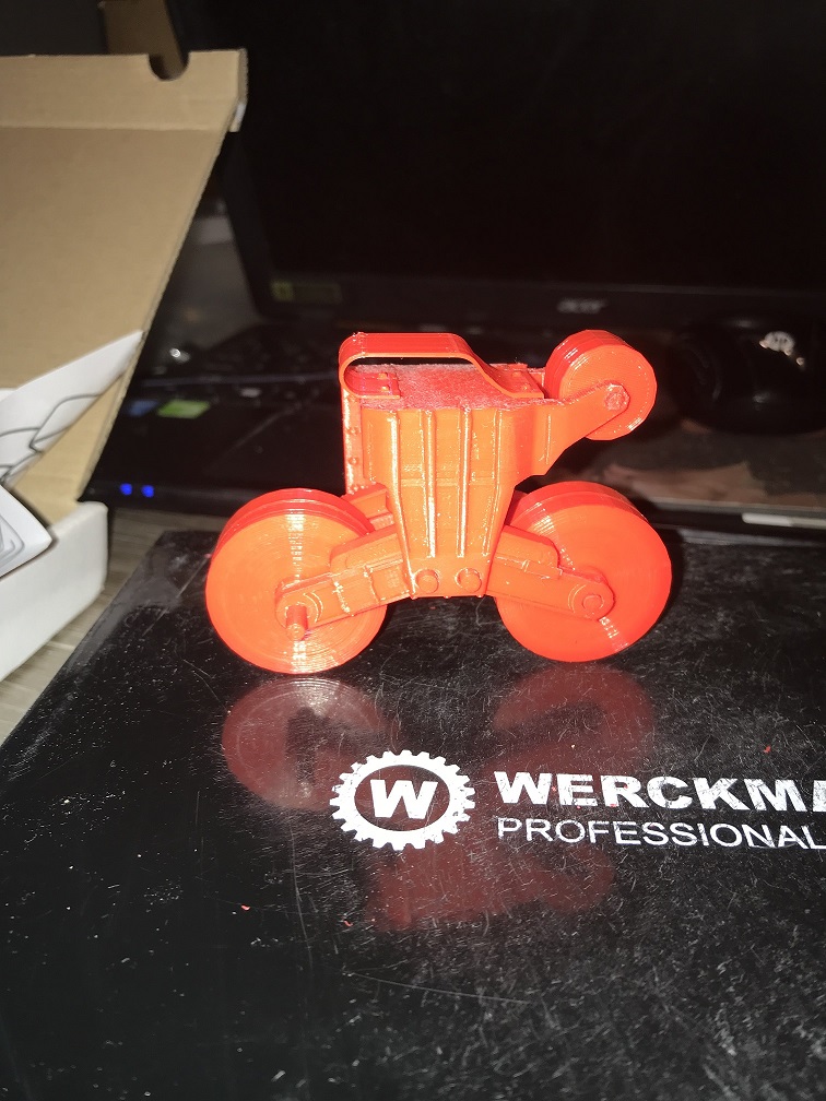

So I've been busy with the suspension the last couple of days. The top one is the first prototype, but had a lot of flaws.
The bottom one is the second prototype, and everything looks and fits a lot better. Every part has been modified. The springs still don't work as I want to so that will need some rethinking.
Overall quite happy with the current version.
Verstuurd vanaf mijn SM-G960F met Tapatalk

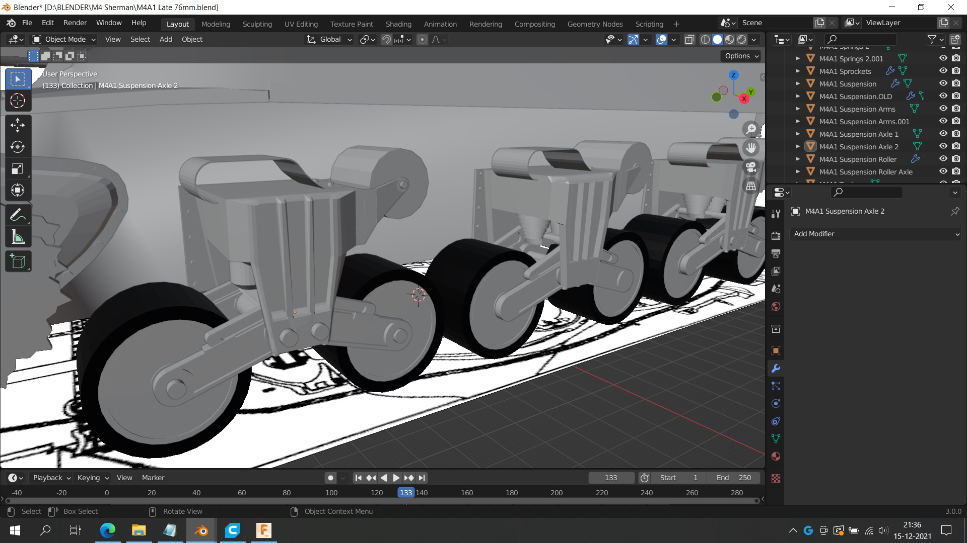

Third (complete) redesign of the suspension. I think I'm getting close to a good working suspension now! With some luck the third prototype will be printed somewhere this week.

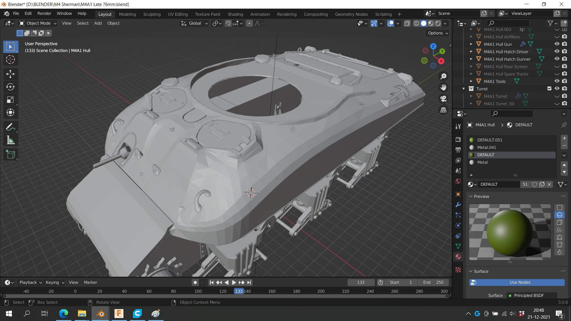

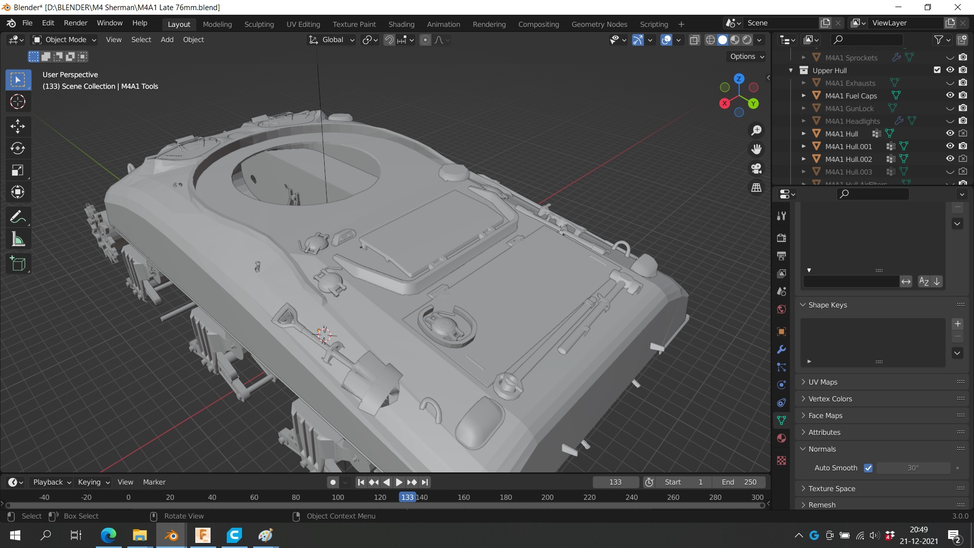

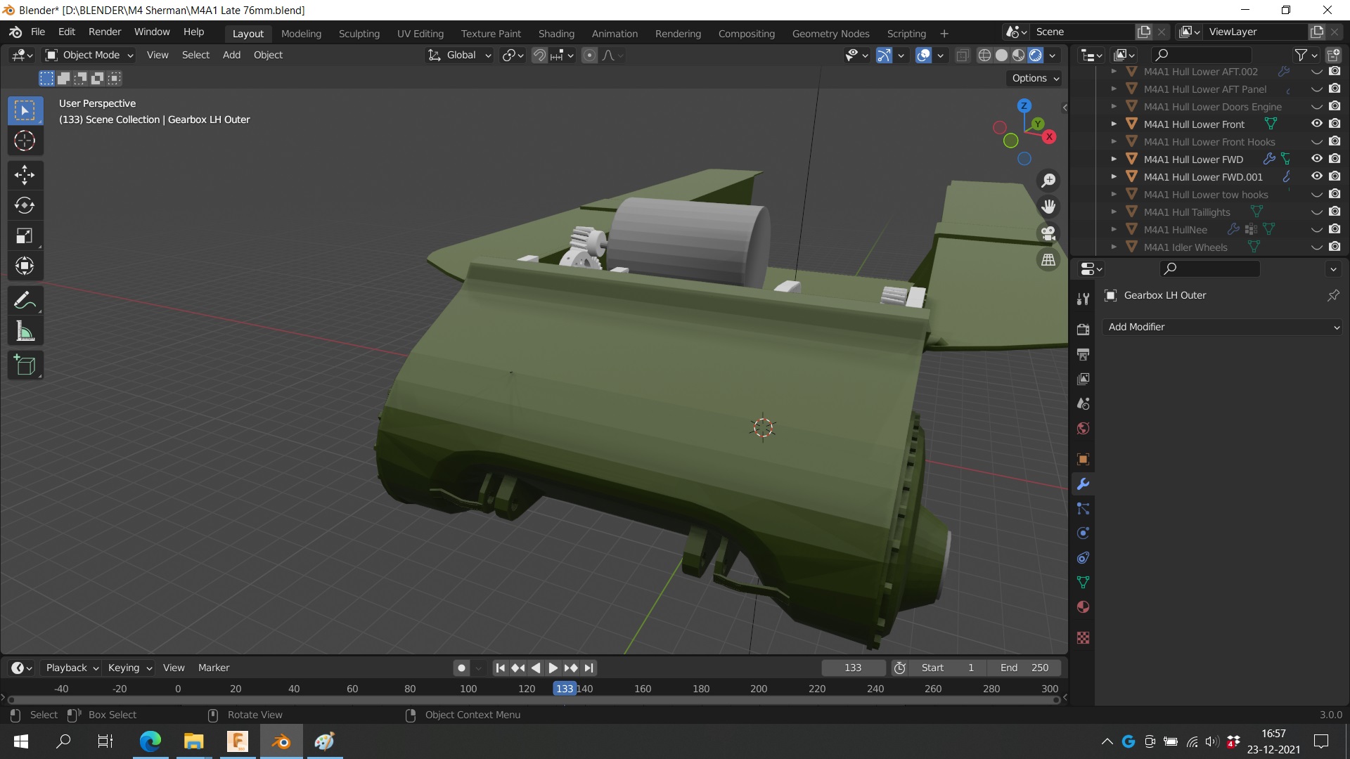

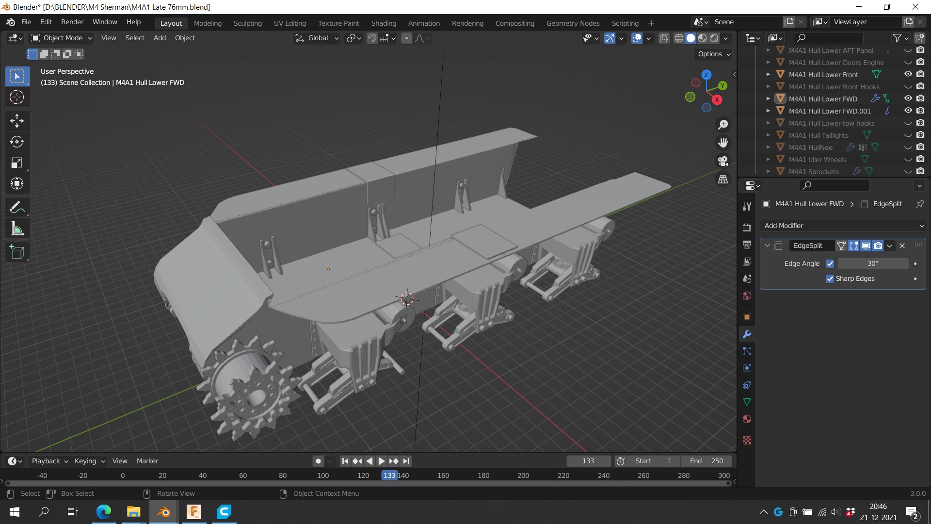

So while I wait for the next prototype to be printed (my dad does the printing, I do the designing), I've spent a lot of time on the hull to make it useable and printable. Also spent some time on the tracks and thinking how to make these without breaking on the first test run..!
So sorry no real progress, but this is how it is going:

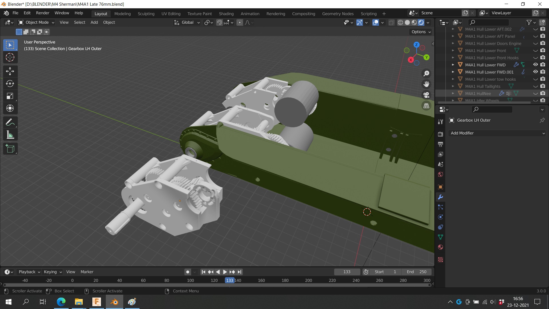

Third prototype has been printed, and now it works! Still some minor adjustments to be made, but I'm very happy!

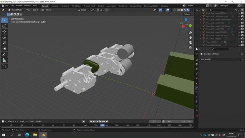

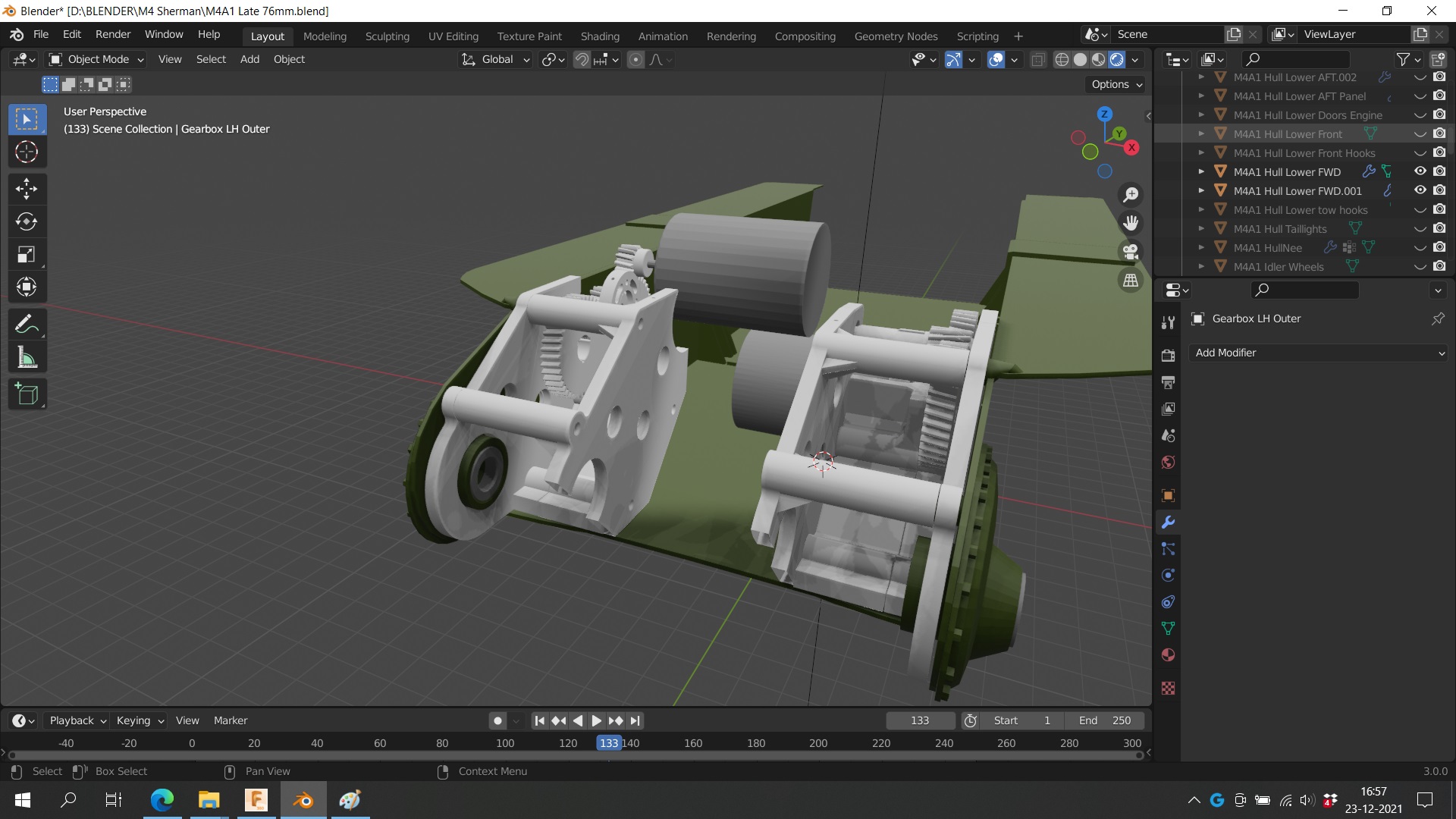

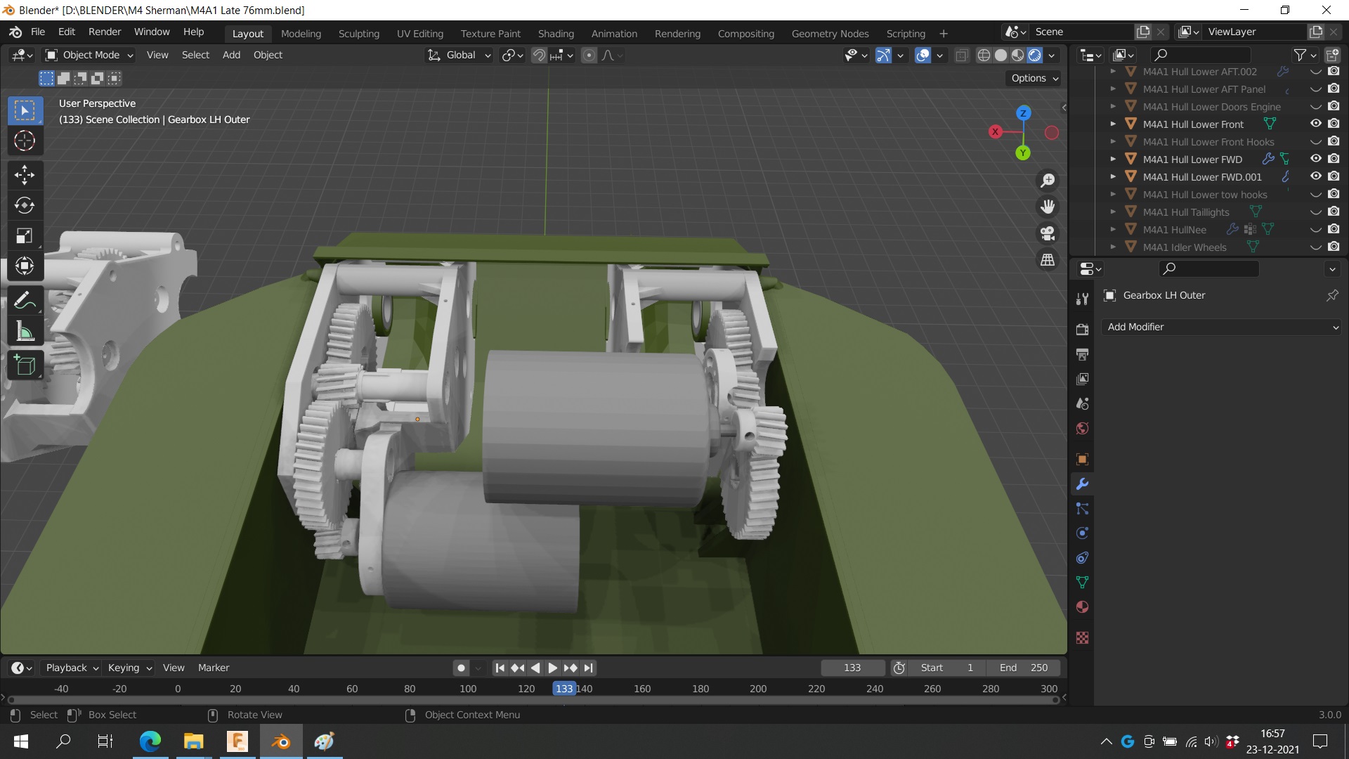

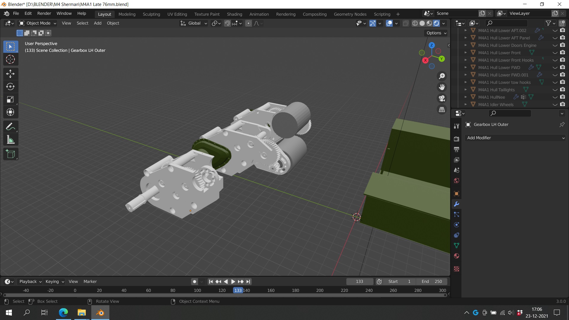

I've been thinking about the gearbox options. How nice would it be if that was printed as well?
After some research I've found a 1/10th scale KV-1 model on Thingiverse with a completely modelled gearbox.
I've resized this to fit in the sherman, but the motors wouldn't fit because of the resizing, so I've spent some time redesigning the housing to relocate the electric motor and a testprint is being made as I post this message.
Difference between original (left) and modified (right) And it looks quite good! Hopefully this will work well when used... fingers crossed...! Right hand gearbox still has to be modified... but I'm going to do that after the test print of the left hand gearbox.
If this doesn't work I'm not going to spend a lot of time redesigning the other side

Awesome work, but this is the point where I tell you to get a steel-geared gearbox for a Heng Long Sherman from AliExpress (for about €25 if you shop around a little...) and save yourself the agony of stripping those 3D-printed gears the first run you take on long grass...
