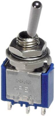

if you have a soldering iron and some knowledge, it is easy to replace this defective switch with another model, even if not identical. Another solution, inject WD 40, it is a penetrating agent and cleans the electrical contacts :thumbup:

Post by General Jumbo01 »
If you have an test meter try checking the cable runs from the battery tags through the various tags in the controller. You should son be able to identify where the circuit is broken. Re the switch, just check the continuity with the meter- that wil tell you if it's faulty or not. If you don't have a meter.....get one! ;)
