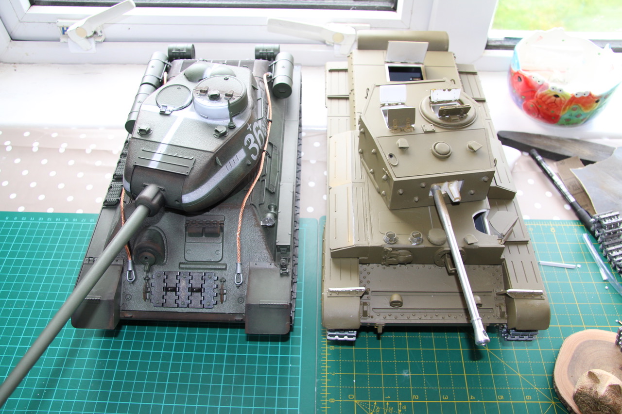

I'm going to have a go at building the Trumpeter/Taigen (ABS/Alloy hull) T34/75, much as Raminator did in his exemplary thread.
However, I have the Torro (metal ed.) T34/85, and I love the rock-solid feel of it. IMO, it's a cut above most of their products- Taigen/Torro, that is.
I bought it in 2017, and so an MFU update should bring it back into peak condition. It will also make it move in a more authentic manner, and sound more credible too. :) As far as I can tell, apart from regimental markings, the Taigen and Torro metal editions are identical.
Torro metal Ed T34/85 and Cromwell Mk IV
Here it is alongside my Cromwell project, which was still largely unfinished.
