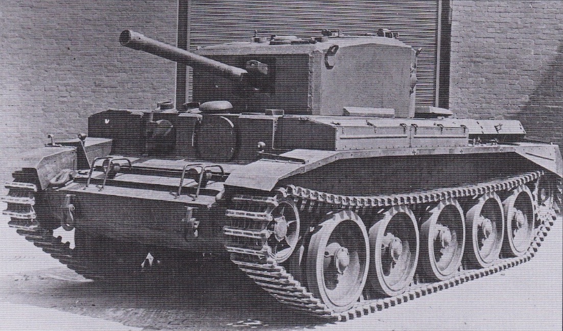

Here's an interesting development version of the Cromwell, from Summer 1943. It was fitted out by Rolls-Royce with a welded turret (similar to the one fitted to the Churchill, and later to the Comet A34); applique armour, and slightly wider tracks.

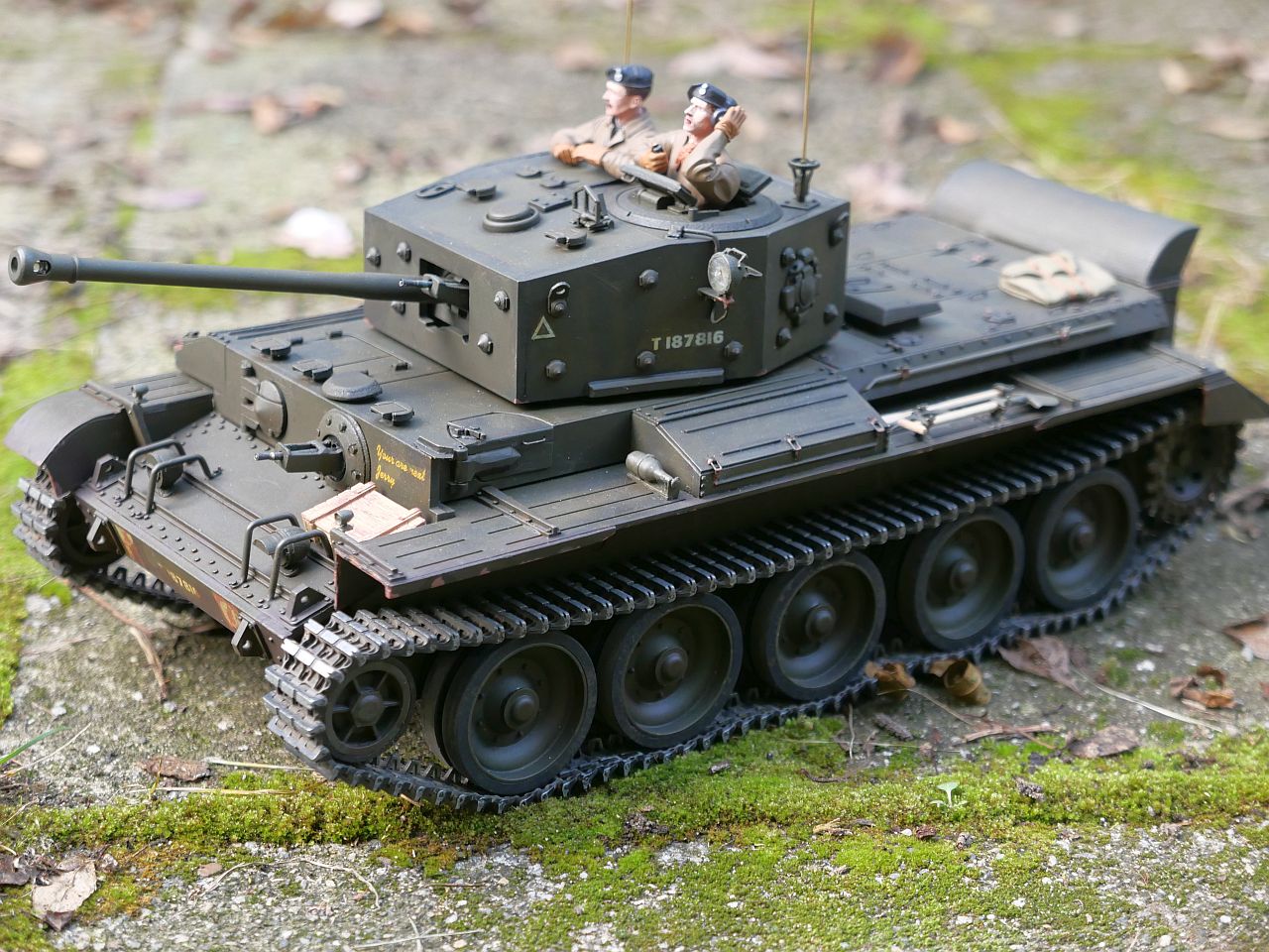

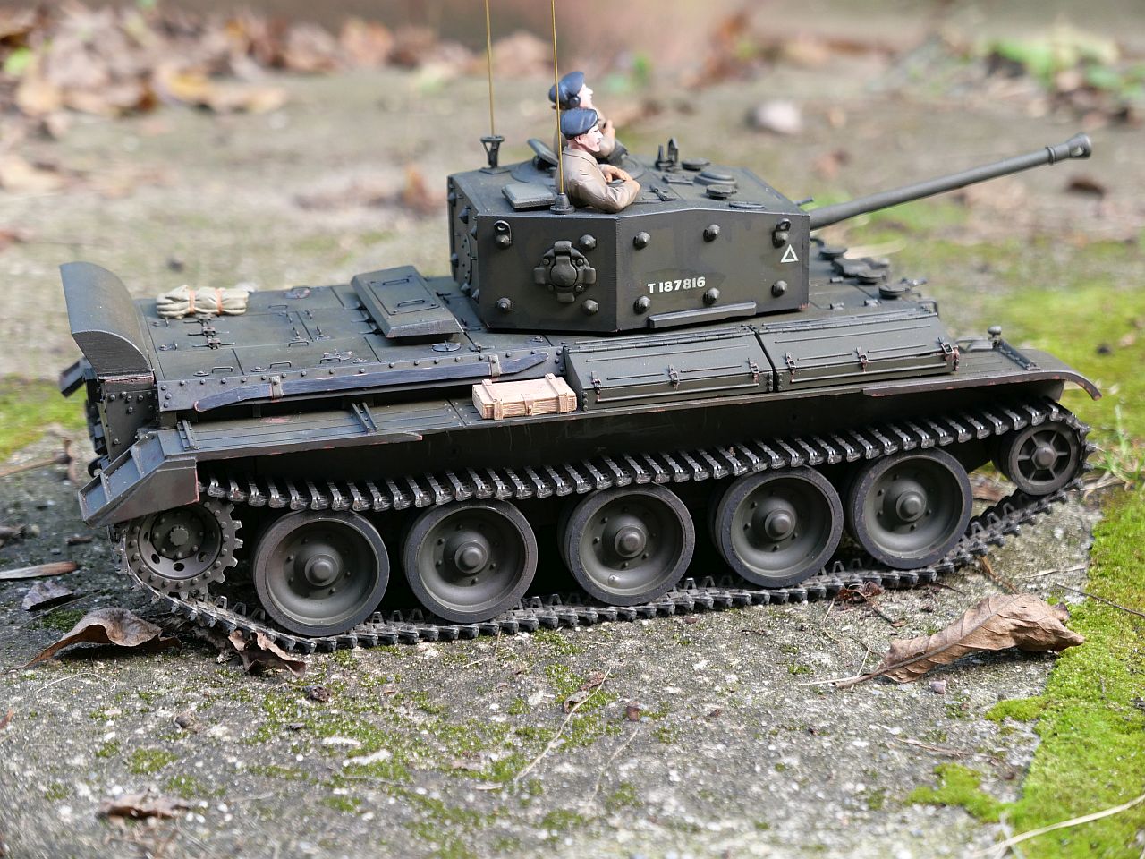

The turret roof is not removable, because barrel elevation and recoil are done with small servos.
The servos are protected from shocks via the linkage.
Here two Pictures from the Cromwell:
There are still a few small things to do, then it's ready.

Are the latches/locks on the storage bins, and the lock/catch on the Driver's Hatch from Shapeways?.
I'd almost finished my Cromwell build, before I found- a bit too late- Woz's (Warren Hudson's) prints on Shapeways, and these from Zavod- some of which I then used on the Comet. The ones I made, by hand, are not as good (petrol/oil tank caps, for example)
https://www.shapeways.com/product/W6BPM ... arketplace
https://www.shapeways.com/shops/warrenh ... omwell&s=0
While these prints offer amazing scale detail, I found the plastic on Zavod's offerings to be brittle and too delicate.

Correct, i use the Parts from Shapeways and additional Parts from Warprints Cromwell-Set.
If you have a 3D-Printer, the Warprints-Cromwell contains many parts that can be used.
