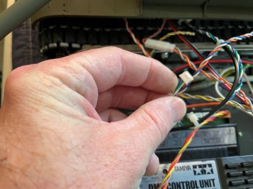

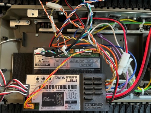

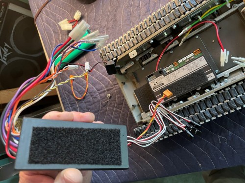

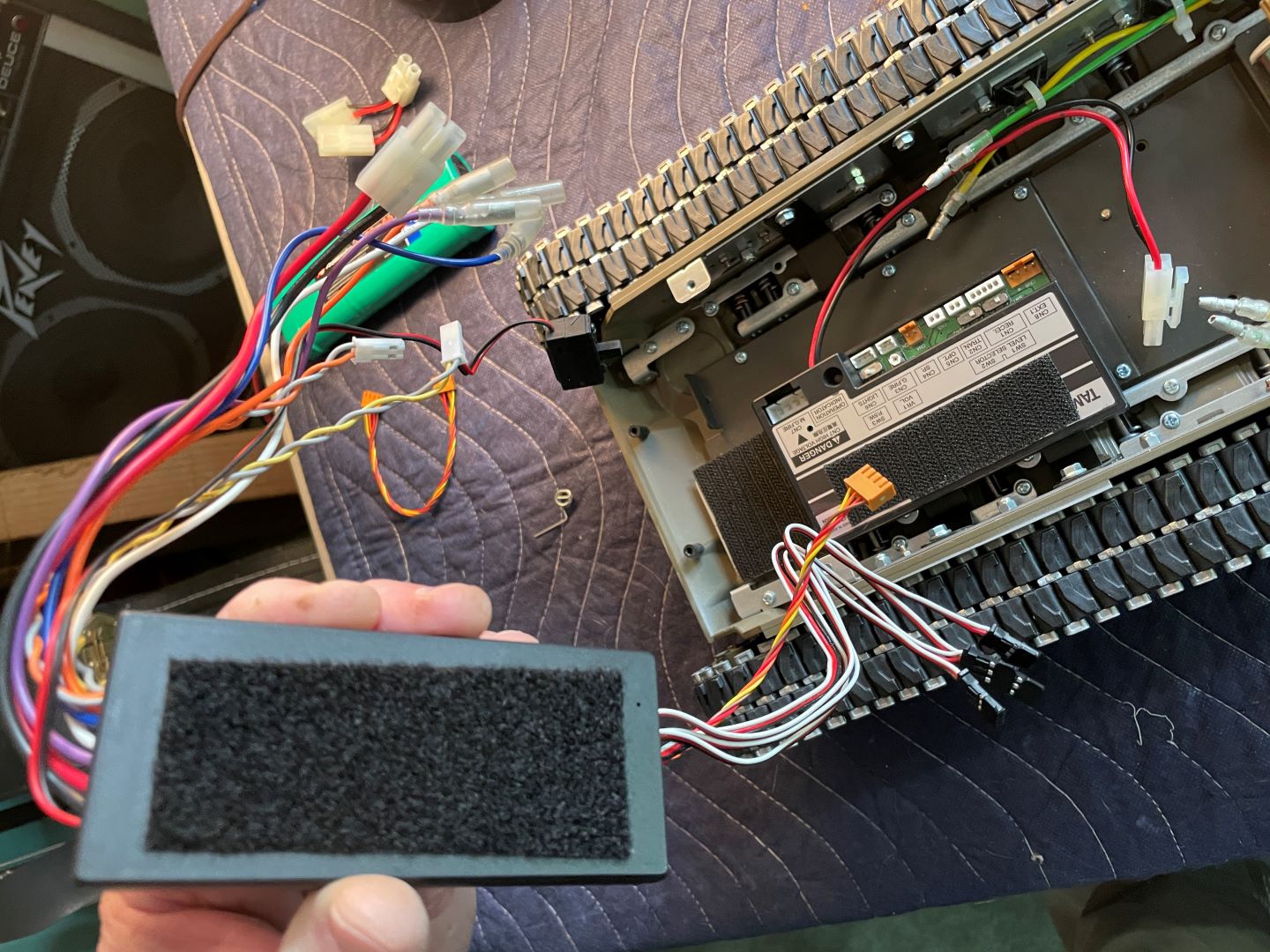

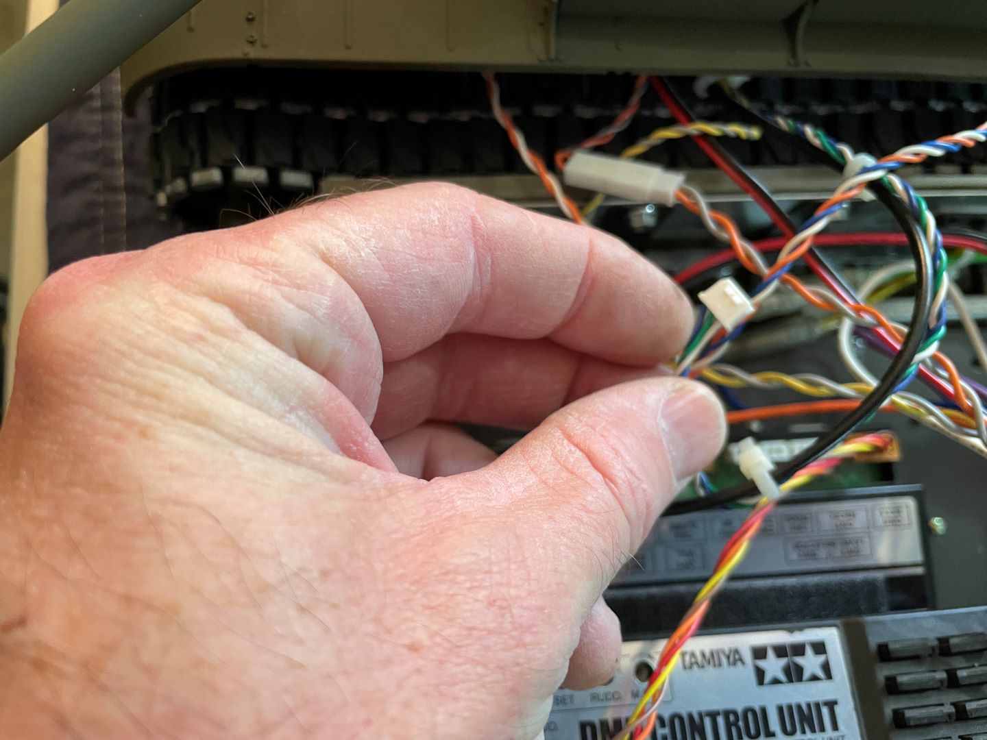

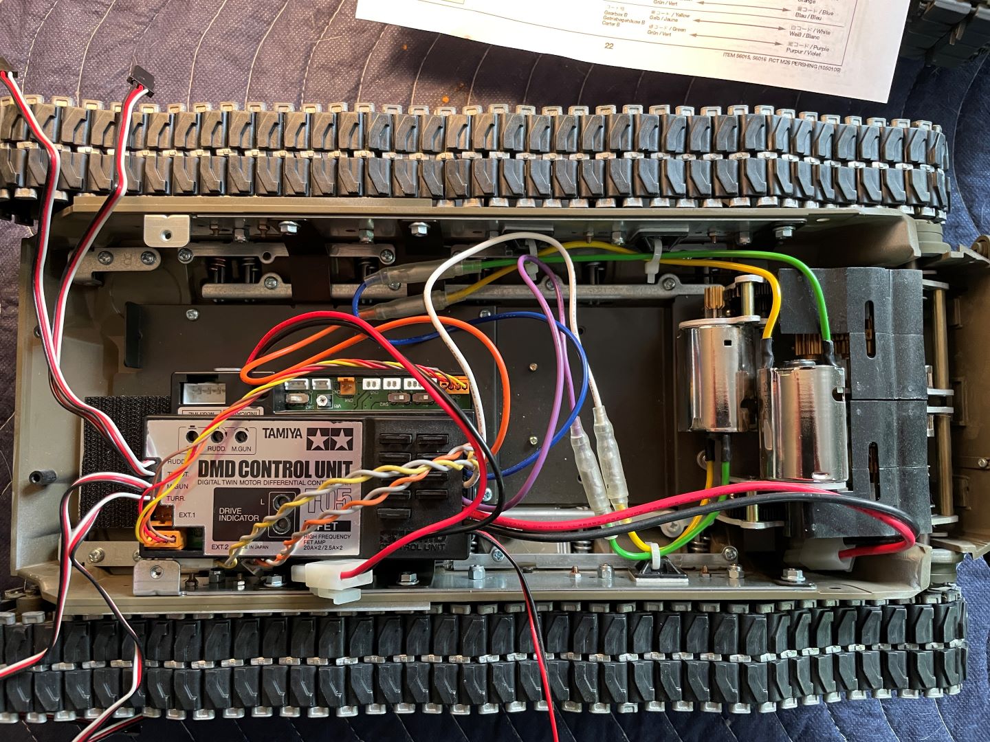

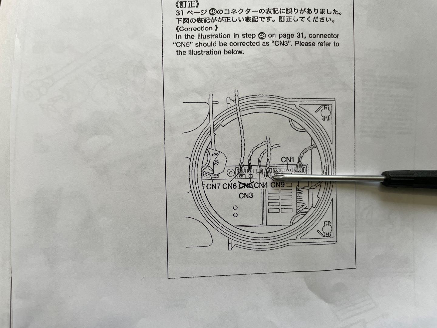

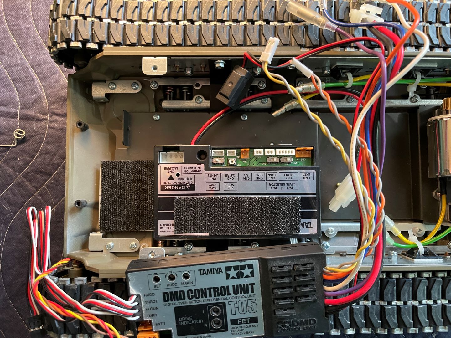

Greetings,
As I have stated previously this Tamiya "kit" is a partial, minus electronics and few other little things. One of the members here reached out to me, and got me a DMD unit with MF and metal tracks to boot! Anyway, I'm hooking up the electronics and I can't seem to figure out how to hook up the recoil unit. On page 31 of the assembly instructions, step 48, the illustration shows a 3 wire connector hanging from the turret and states "Connect to CN6". On Page 25 Step 33 the illustration shows the other 3 wire connector, I believe there are only 2 looms of 3 wires, lights and recoil, step 33 states that the machine gun goes to CN3 and the lights to CN9. However, the MF unit I have has CN6 labeled with "Lights" I don't see a CN9 on the MF Unit. Is it possible I am misunderstanding the assembly instructions or are there older MF Units that do not support recoil and I have bought one?
Kind regards,
Steve
Kind regards,
Steve
Re: Tamiya M26 Pershing Kit - Missing Electronics
Tracks look great!
Not an older dmd and mf as such as it was from a new Sherman kit.
The Sherman dmd and mf doesn’t support recoil as mentioned in an earlier pm but supports lights and elevation/rotation etc.
