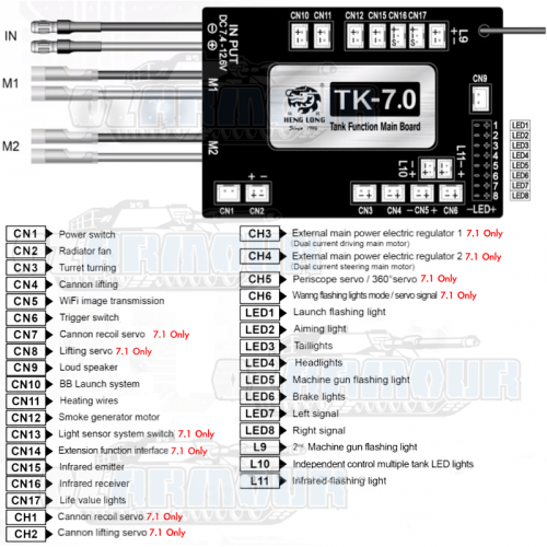

Hello, my son and I picked up some of the barrel flash simulators that were supposed to be plug and play with the HL tanks. They have a 5 pin connector that doesn't appear to be used on the 7.0. Does anyone have any idea how we could wire these up? I'm not averse to soldering or changing connector pins around. But I don't want to let the magic smoke out either.
HL M41 7.0
HL Abrams 7.0
HL KT 7.0

Good evening,
if you talk? what i believe? Flash X?non? actually I am thinking of the view of the circuit board,
that it is not possible to install this system, but a flash Led on the corresponding card
on the Xenon system, there are 3 wires for the +/- power supply and the signal, and 2 others on a small connector, for the flash control microswitch.

Hello,
They are the Taigen high intensity flasher module. To install on the 6.X HL boards, there was a socket for the 5 pin connector. As you said, +/- and signal and then a small connector which was supposed to be "jumped." If I could figure out where the +/- and signal wires needed to go I think we would be in business on the 7.0. There just isn't a lot of info out there beyond the chart you displayed. And then there is getting rid of the airsoft functionality while retaining the cannon sound, hull recoil, etc. That wind up and delay is pretty terrible.
HL M41 7.0
HL Abrams 7.0
HL KT 7.0

I looked again and I was mistaken. Its for older tank function units. Back to the drawing board.

Am I missing something?
Why do you think a Taigen Flash module will work with a Heng Long Control Board ?
They are completely different companies.

yes exact, but I am right in the sense, or the unit X?no, works as well on Old RX 18 HL or Taigen !!! in the case here it is not possible, since system not identical and specific HL, me may be misspoken :'(

The Taigen flash unit in its complete state won’t work on a 7.0 but if you cut & join the two woes to a servo connection plug and place it it the correct port it will .

:) Hello Herman, OK for the modification, I do not know the 7.0 turntable and do not question your knowledge. But some of you misunderstand how possible to plug into a servo socket? you need a plus and a minus for the electronics that produce the high voltage of the Strob, with a third wire on it, the other two are the contact activated, on the RC Tank.de site it is indicated that not intended to work with a type 6, but nothing for the 7?
