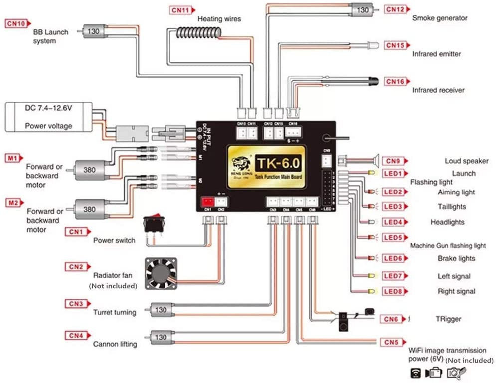

As our friend Kaczor said, it does not seem to be identical model? but on the video, after pressing the switch below, the start is done on a push button of the transmitter ?? a question can be stupid? but would there not be a pairing (Binder) to be made between the transmitter and the board? I think that indeed it is necessary to take the time to read the instructions !!!! to understand all the subtleties, do you have a way to check that the battery is well charged? voltmeter or others? I think you have to start with the. On the attached schematic, there seems to be a single start-up switch ...

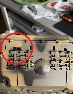

this is the charging socket, are you sure you have it correctly positioned when commissioning? is it new or used equipment? and proper charger? I know a lot of questions?
Yellow…

Jofaur86 wrote:this is the charging socket, are you sure you have it correctly positioned when commissioning? is it new or used equipment? and proper charger? I know a lot of questions?
Yellow…
I have charcher for battery it was in set and I have to take battery from T90 and charge it like phone no other possibles maybe it is additional new method but in the set I didint had charger for this input
