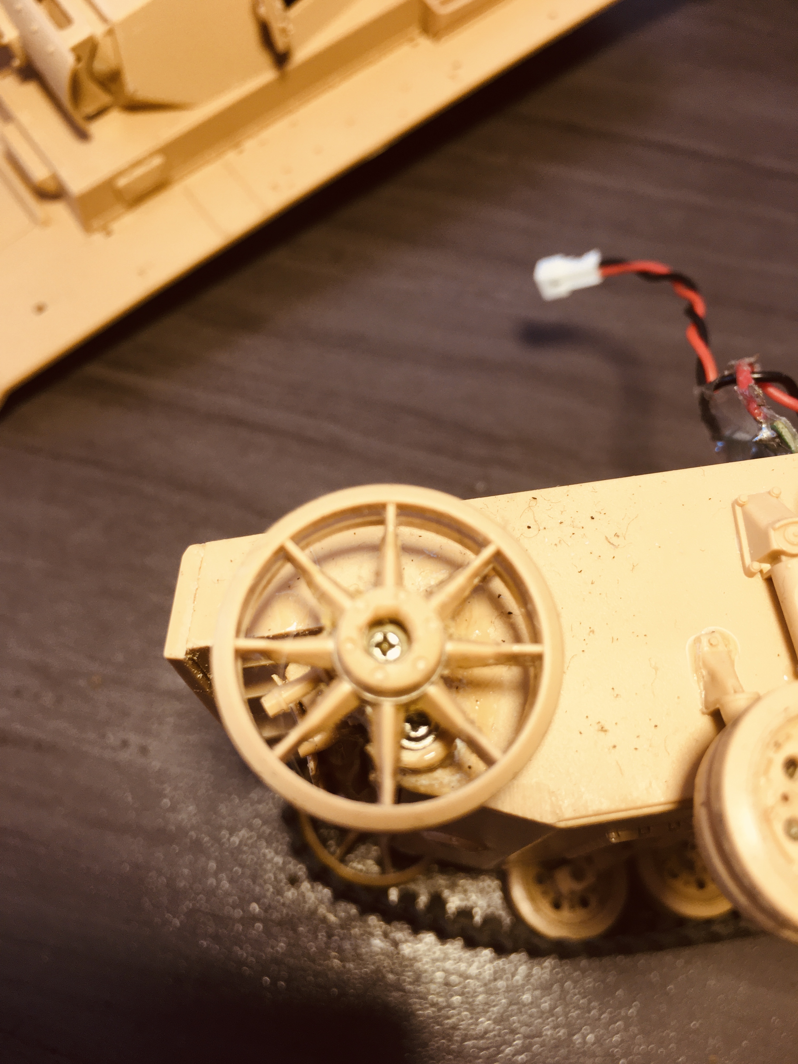

philbibbey wrote:The road wheels and track guid wheels had to be modified for movement. The stock kit had these items glued in place.
For the road wheels I used some 1/32 piano wire that was small yet strong enough to attach the road wheels. If I was to do this again I would also use some small tubing to help secure the piano wire like a bearing sleeve. The suspension arms had the plastic axles cut off and drilled out to allow the piano wire to fit through. Some homemade securing nuts were made from plastic sheet and glued on the back side. (Not pictured) before I secured the road wheels and track guide wheels I tested out the rubber band tracks to make sure everything was spinning freely and as always making sure track alignment was good.
Up next is the motors. Image
I just noticed this picture with the mods to the road wheels, yes there is a problem with the road wheels on this model. I went a different way to solve this but looks like you may have a better solution.

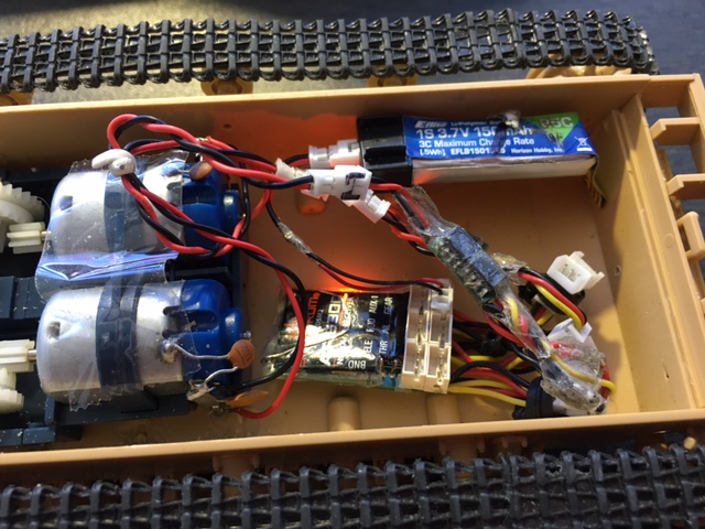

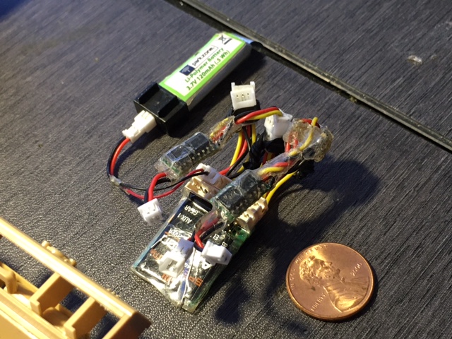

The answer is not necessarily. You just have to use a Ultra Micro receiver, ESC's, connectors.
The Tank I show here has a small 6 channel DSM2 rx with external twin UM Esc's. They run on a small 1 cell Li-polymer. As soon as possible I will post info on UM radio gear that I use in small 1/35 models in a new thread in this forum soon.
6 channel rx with twin ECS's has small foot print and perfect for this1/35 scale Tank. Uses 2 pin 1.5 mm micro JST connectors. Full size red JST connectors are overkill for models this small and take up a lot of room.
Panzer III has a small DSM2 6 channel RX from a Heli with 2 UM 1s ESC's and a small 1 cell lipo. This Tank will run wide open for 15 minutes with this 150 mah 1s lipo.

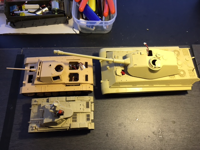

King Tiger, Panzer III, PanzerII. A small sample of 1/35 Tanks in my collection. The Panzer II has a Ultra Micro radio setup because that is all that will fit in there.

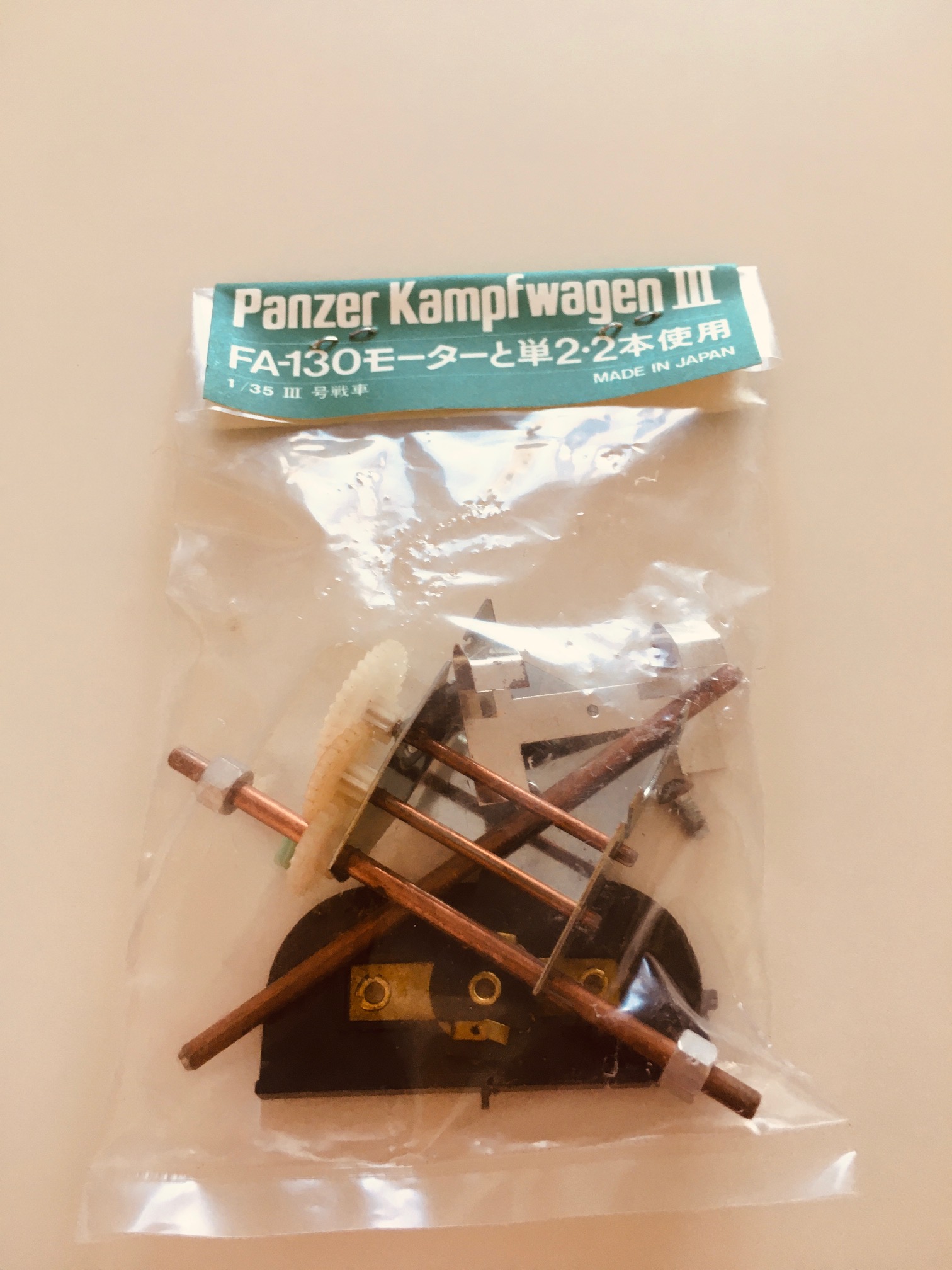

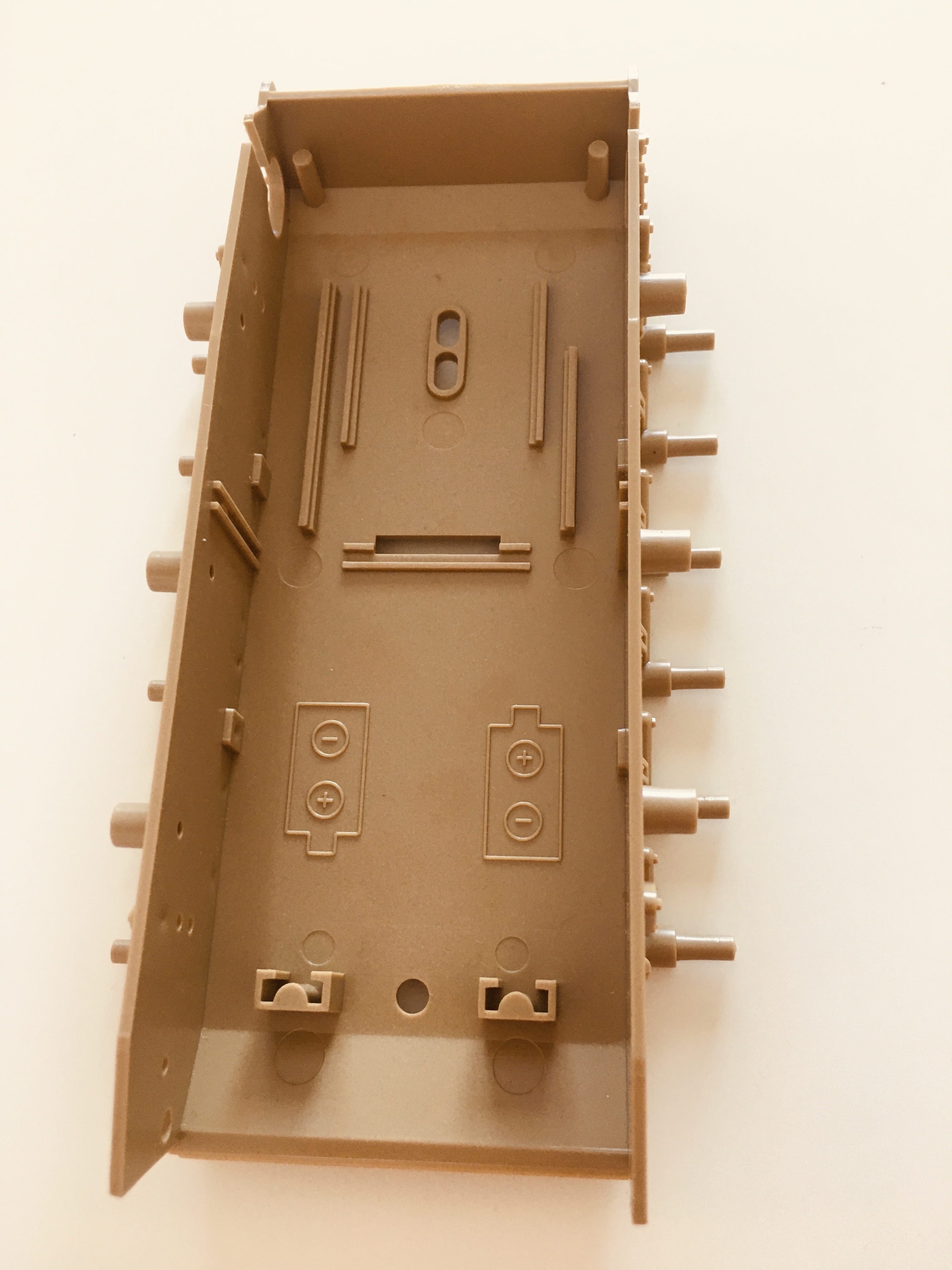

Well first thing to do in a 1/35 R\C conversion is to convert the right model. Below is the right Panzer III to convert. It comes with a single motor Gearbox and that makes things a whole lot easier. The road wheels, tracks, drive sprockets, track idler wheels are designed for motorized operation. This is half the battle. Now all you need is a twin motor gearbox.
All the gearboxes below can be modified to be used in a multitude of 1/35 tank models. I sometimes buy a model just for the GB parts.
more on this topic as I get time.
This Nichimo motorized remote control kit sells for less that the Tamiya usually and is compatible with Tamiya motorized models.

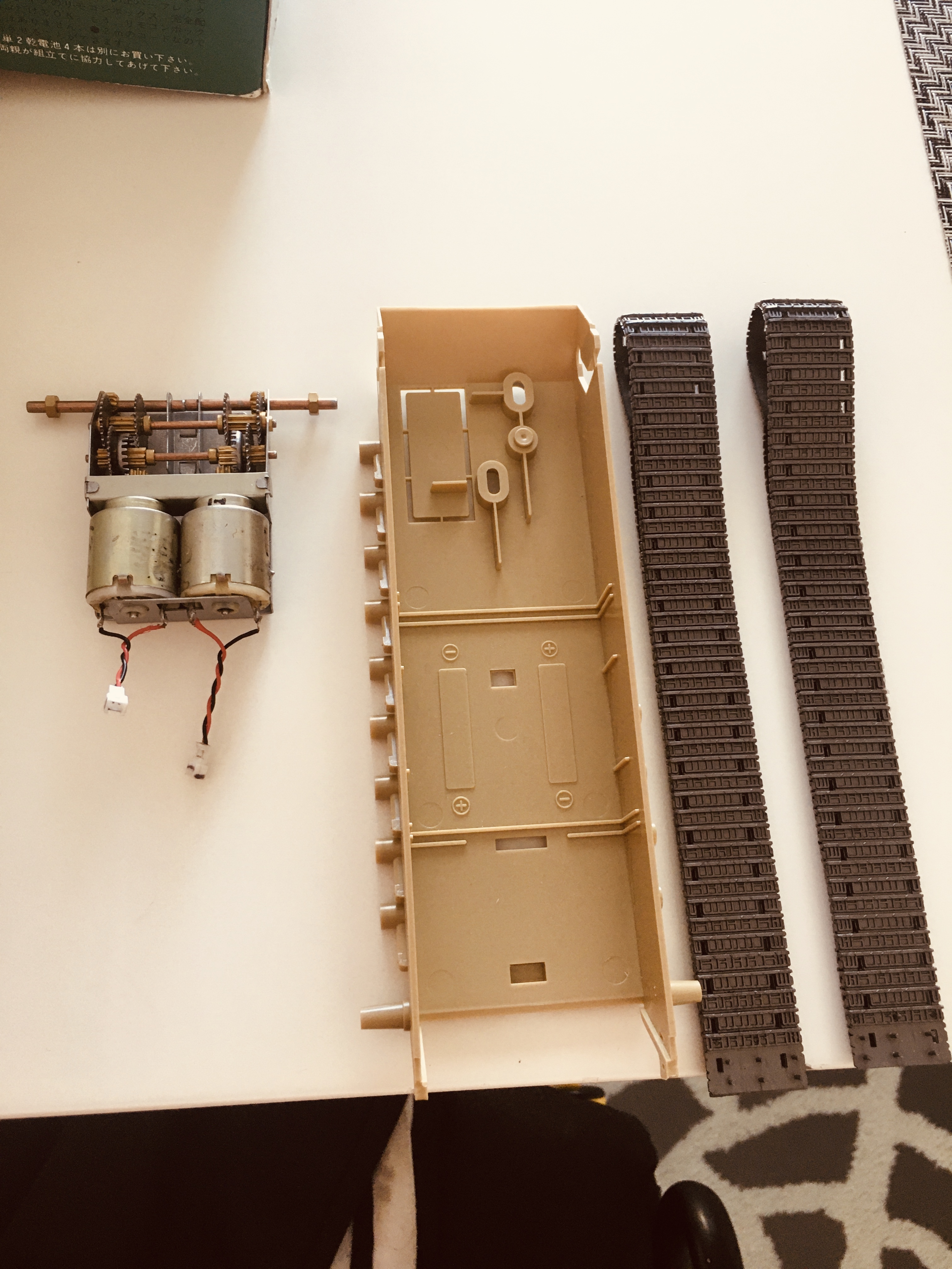

This dual motor GB from a Nichimo Tiger II kit is going to be used in a Tamiya Panther.
This is the included single motor gearbox. Many Tamiya kits available on ebay both NOS and or prebuilt. Smart shopping and patience will get you what you need. There are other options as well from other sites. I prefer Tamiya, Academy, Nichimo gearboxes.
The Hull is already setup for either single or dual motor gearbox.
This is a way better choice for R\C conversion as its already motorized and has all the necessary elements to become R\C less the twin motor gearbox.

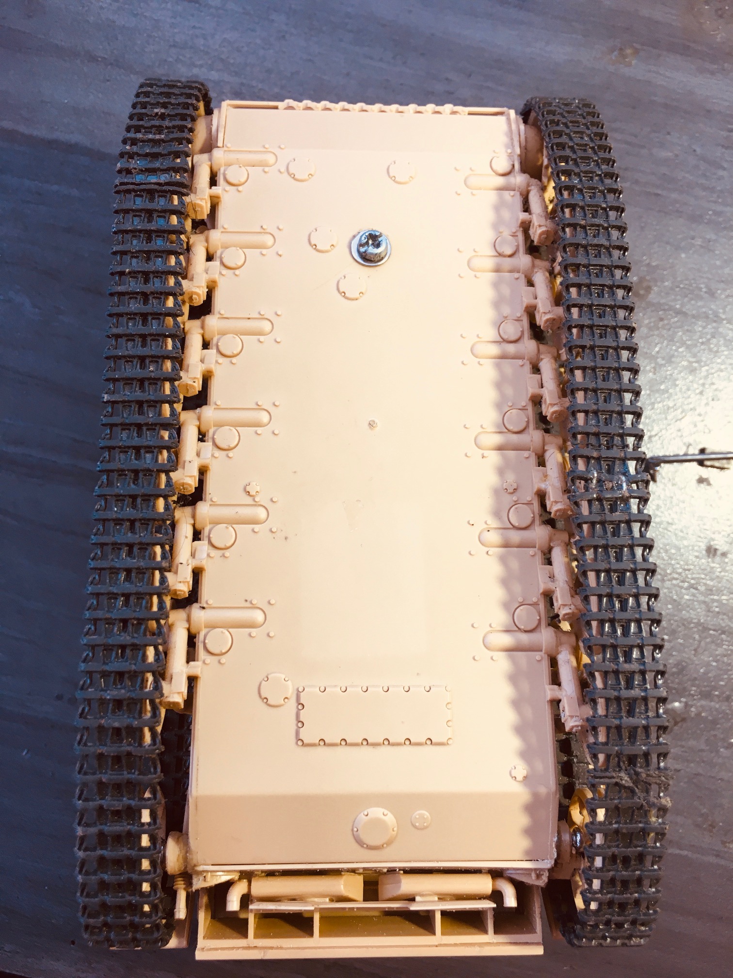

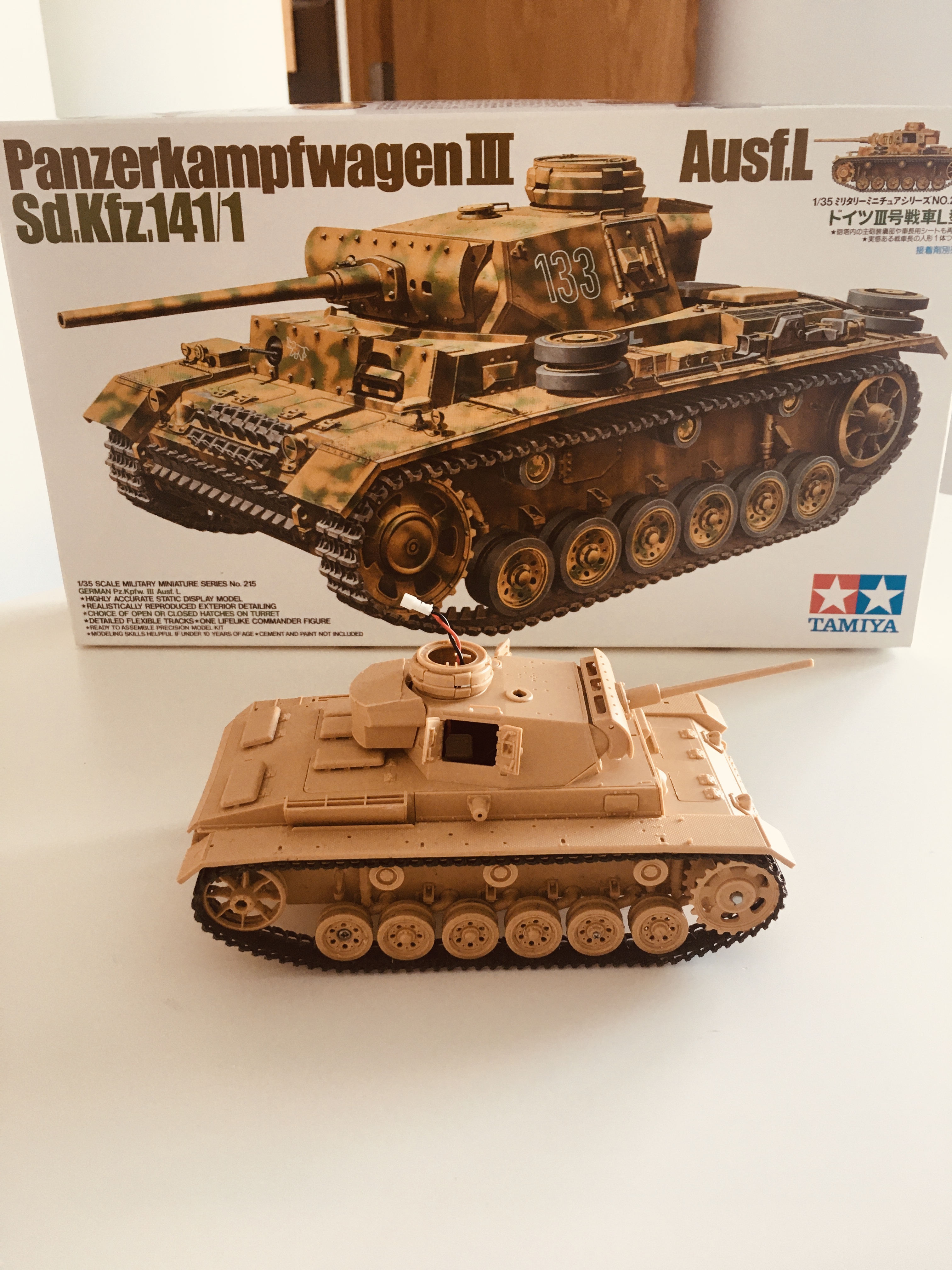

Here is the SDM Pnz III that I converted to R\C about 2 years ago. With what I know now, I would pick the better candidate for conversion.
The road wheels, Drive sprockets, Idler wheels, all need modification to work as a R\C model.
The tracks that come with this kit are not really suitable for motorized operation. They are early PNZ III tracks\Sprockets. Hard to find suitable replacement tracks for this version PNZ III. There are plenty tracks available on the newer M/N version of the PNZ III.
No motor mounts either so more mods required to position the twin motor GB in the hull.
It is a nice scale model but really too much work to convert to R\C but here it is anyway. The 1/35 Academy M60 gearbox works for this conversion.
I will do a new 1/35 PZR III R\C conversion using a more suitable PZR III model in its own thread soon.

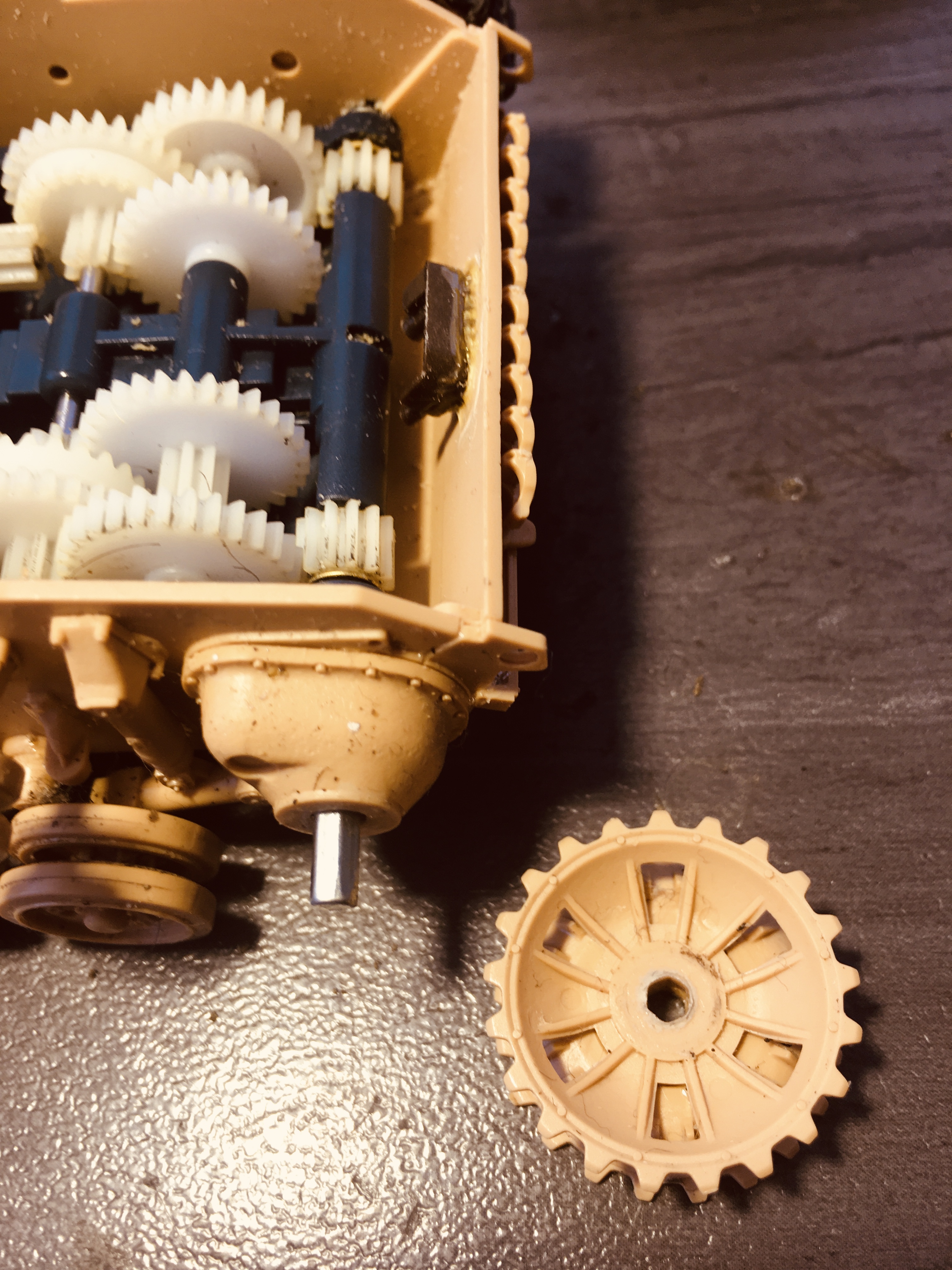

Precise positioned screw mount for <br />GB.
GB.
This scale sprocket setup does not allow forward\aft adjustment of gearbox and requires precise positioning of mounting screw. Also tedious to remove GB for maintenance. Too much work compared to most other sprocket interface.
No upper hull mounting parts in this kit. Made to so upper and lower hull is glued together, BOO! Micro screw added so that hull can be separated for maintenance.
Going R\C conversion the HARD WAY! I do not recommend this model kit for conversion.
