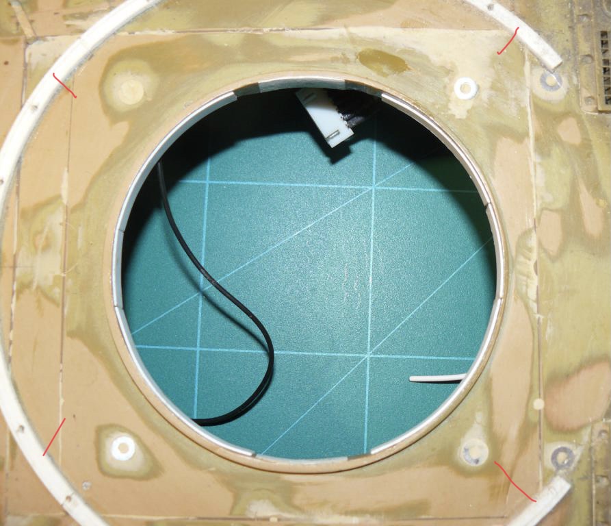

HERMAN BIX wrote:Solid start Mr Topper :thumbup:
Dont forget to remove the unneeded aerial tube from the left/drivers side ;)
You will also need to add a turret ring armoured band that protects the gap between turret and hull, its a late version indicator.
Do you have a specific machine in mind or are you freestylin it :think: !!
unless I'm mistaken? Herman talks about this piece, this one was cut from a sheet of ABS,( reed)
I don't think it's all done? so a bit of manual work, also remove that ugly set of molded edge, and replace with metal :thumbup: Good day.

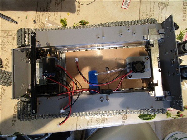

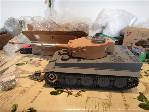

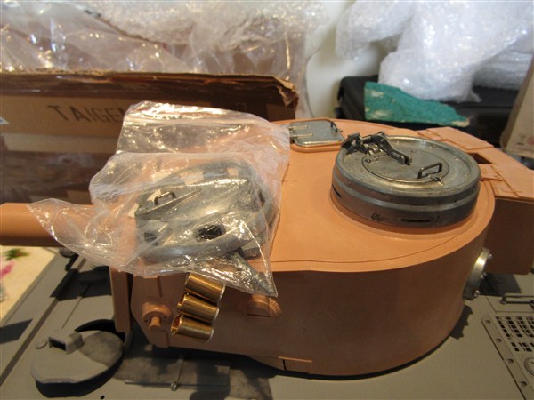

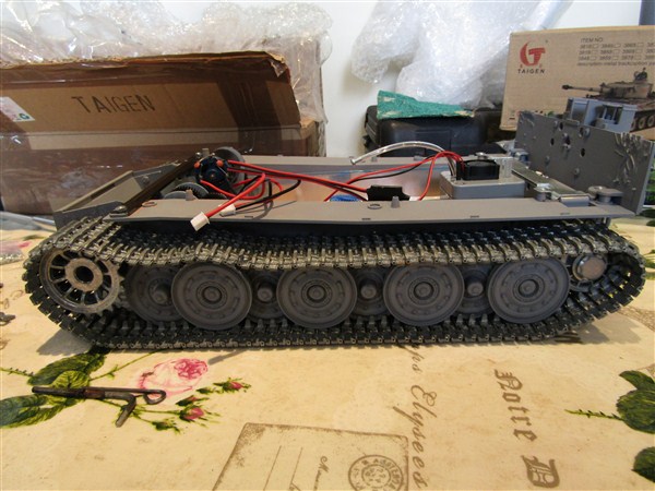

Some of the part arrived this morning, just waiting for the electronics , how do I remove the cupola? I looked inside the turret and there aren't any screws holding it but its really stuck on,
All the best and thanks for all the help!!!

Topper wrote:Morning
Frank
Place the blade of a screwdriver/penknife through the viewing slit of the cupola and gently I SAID GENTLY !!! Lift the blade,
Remove the blade and place it in the opposite viewing slit and again GENTLY LIFT the blade,
You should hear the crack of the glue failing,
Lift the cupola off and note the locating hole for the placing of the replacement cupola.
