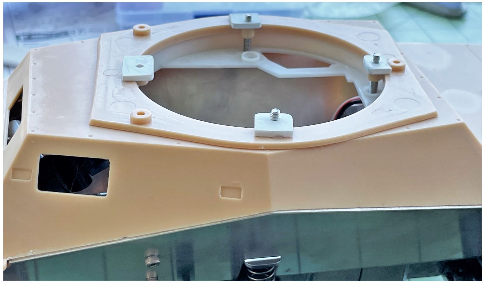

Upper hull sides are attached without problems. I found the plastic upper hull to be on the thin side but well detailed.

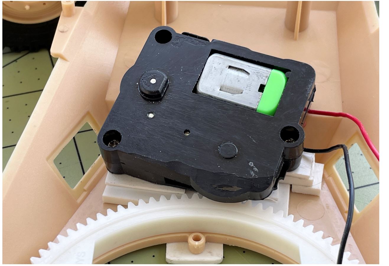

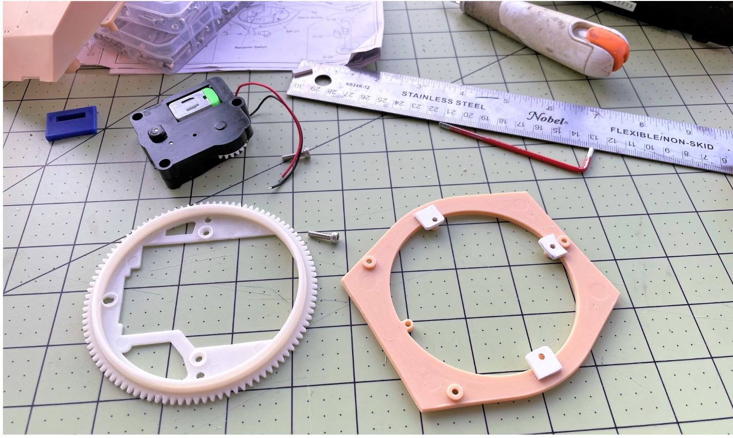

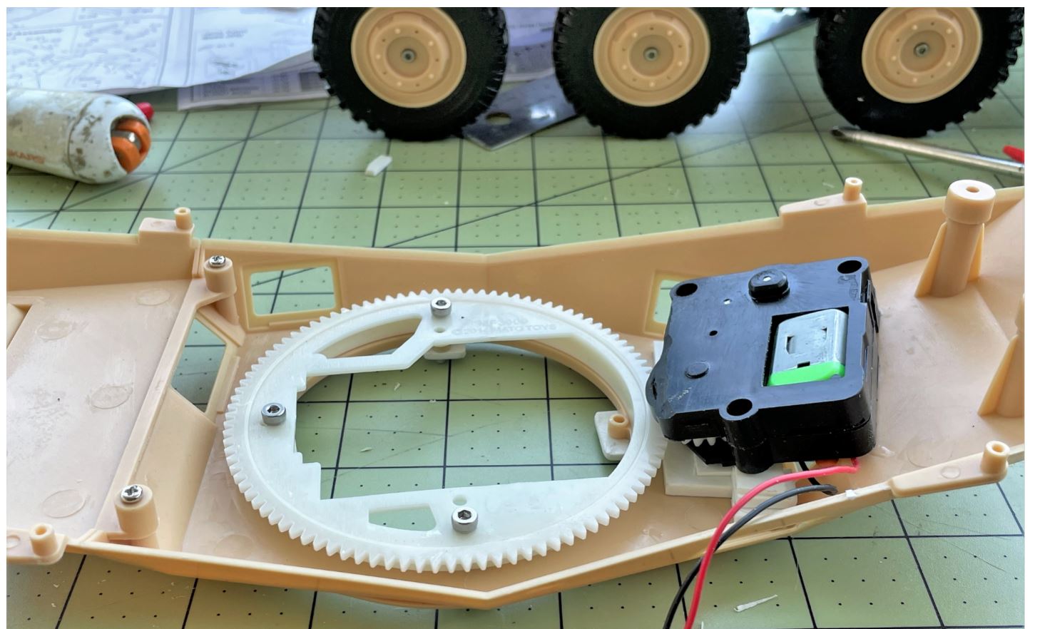

I hesitated in purchasing the Metal Origin turret rotation set. At $68, it is overpriced and looks weak with a small motor and gears. Availability of spare parts is non existant.
1/16 RC Sd.Kfz. 234/2 Puma armored car - build
For $20, i could get a standard Mato 360 rotation wheel and a proven Heng Long rotation unit. The size of the wheel is perfect for the Puma, no need for custom size. The attachment points on the turret base are reinforced with a plasticard layer and holes are made for M3 hex bolts.

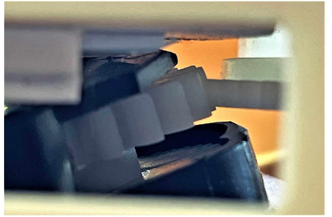

The wheel is centrally installed on the base of the turret, with removable hex bolts. The rotation unit needs to be installed at an angle under the glacis.
A hastily made plasticard base was created as a platform to screw the unit at the right height. Notice that i had to grind the lip that was touching the hull transversal bar.
It works perfectly well at an angle. No need to be too difficult or purist.
The wheel is installed just to be a bit loose but firmly holding the turret base in place like any other turret. It took about 1 hour to do this.

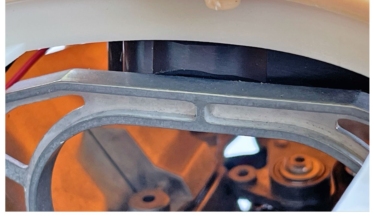

I had to grind the lip of the rotation unit to clear the hull front transversal metal bar. The rotation unit is actually resting on it, which is ok as it provides some support because the plastic of the upper hull is quite thin.

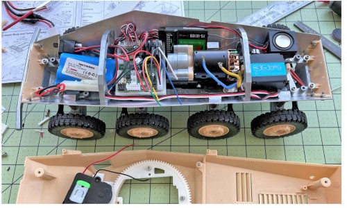

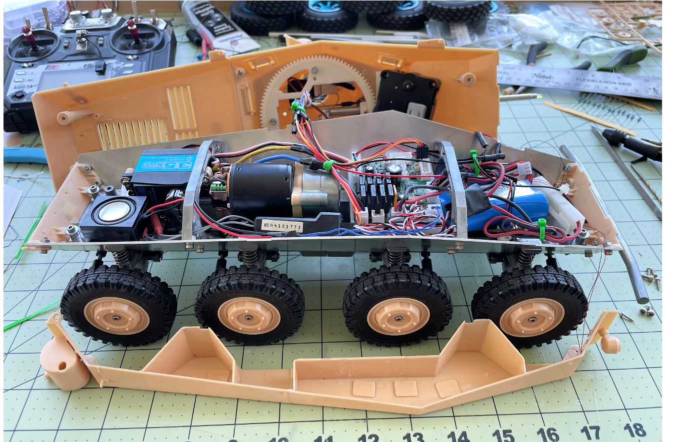

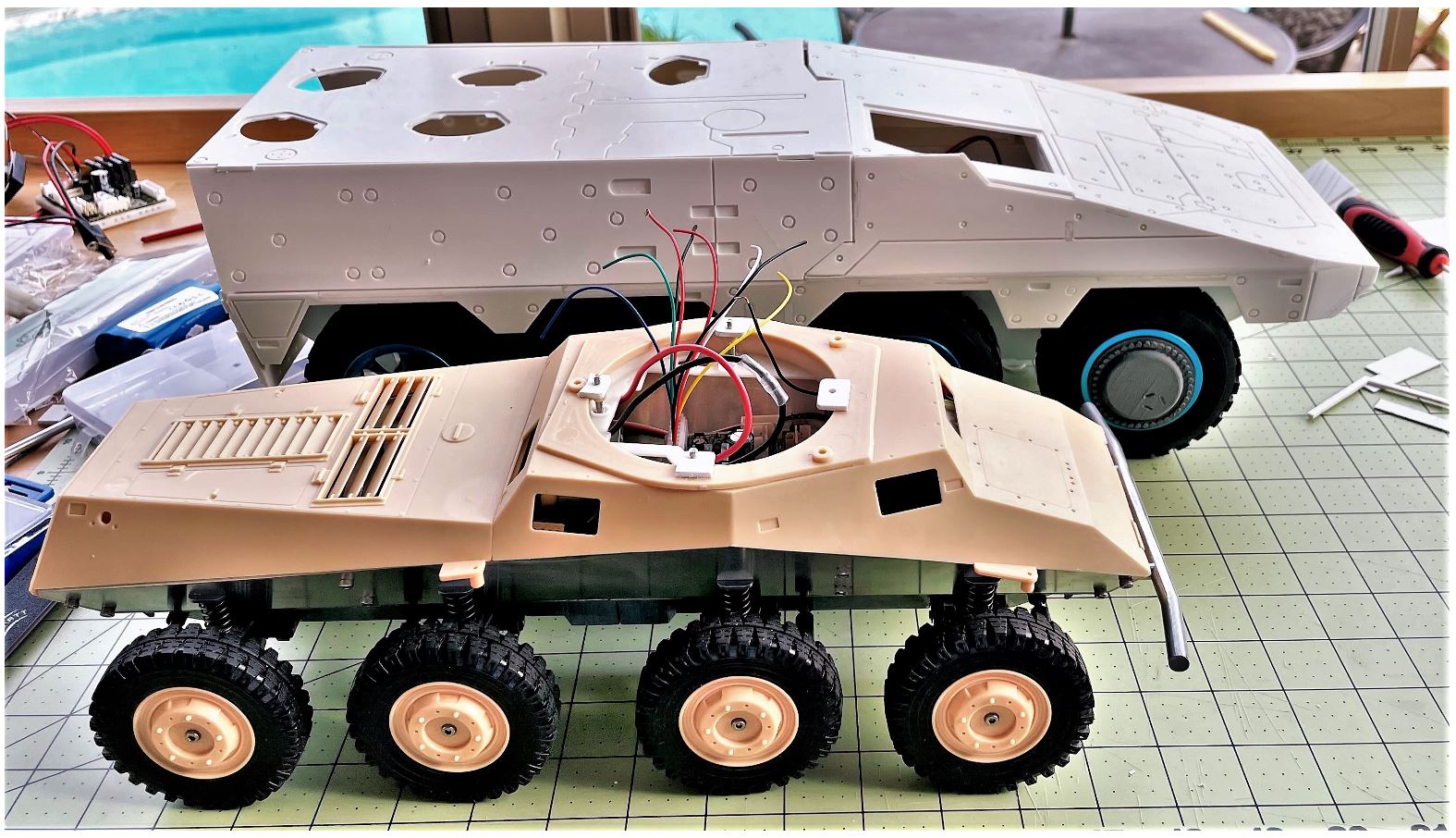

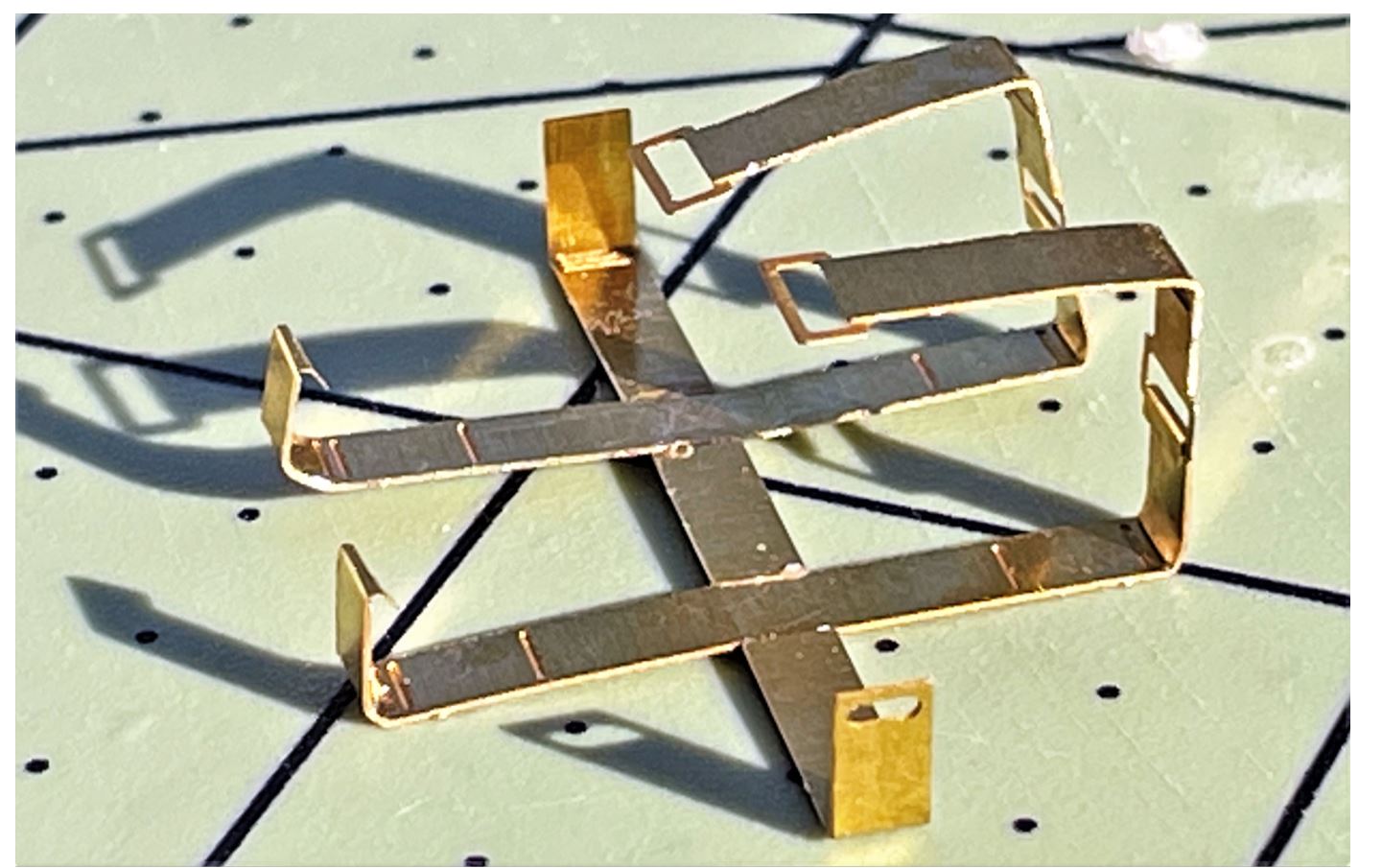

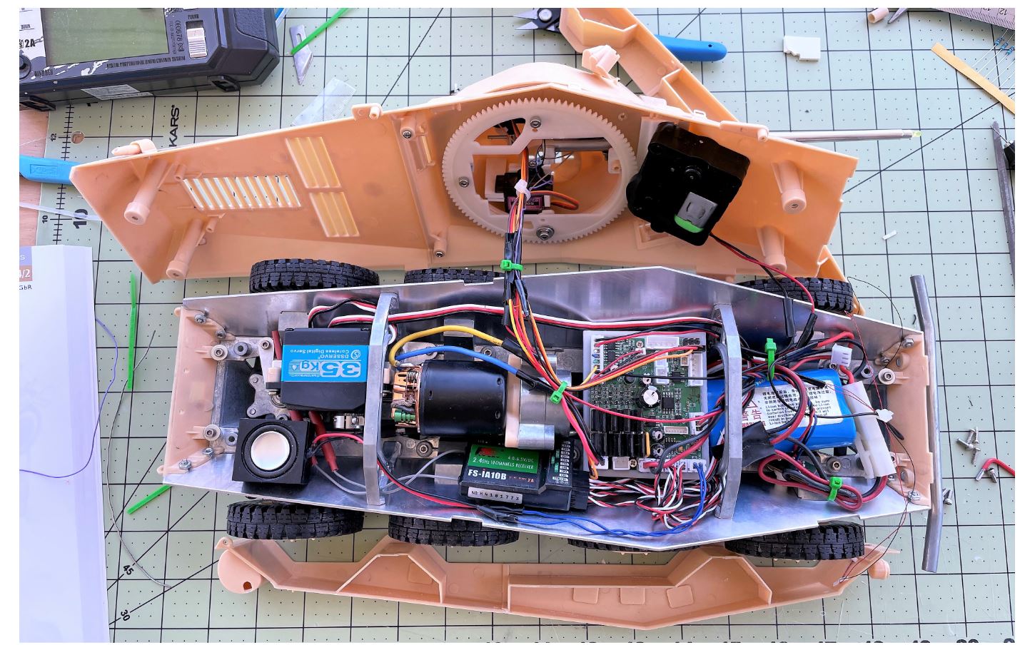

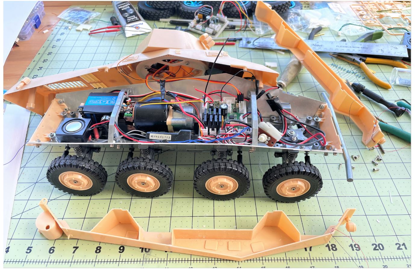

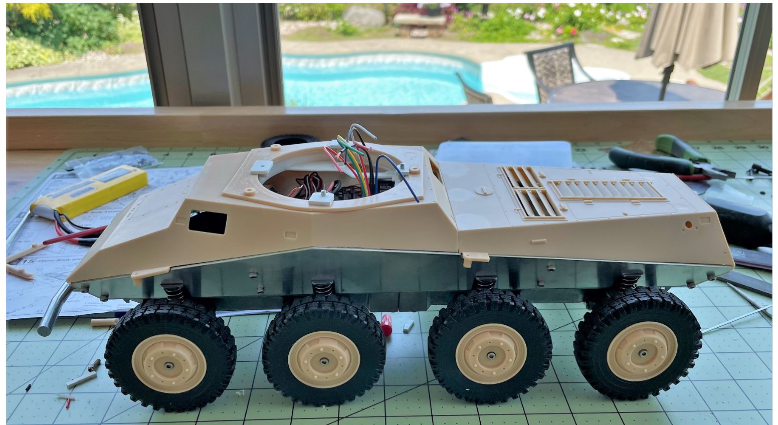

Shown here is the new planned layout of the electronics. Small speaker at the back, receiver on the right side, Clark TK-22 control board in the middle, battery at the front, rotation unit on top of the battery. I replaced the planned TK40 by an available TK22. I need the TK40 for the GTK build.
Everything fits well inside. This is the model as it stands today after only 4 days of part time work. I will put this build aside for a while, going back to the GTK build while i wait for a hollow Puma gun barrel from MK Modellbau. The plan is to give the gun elevation, recoil, flash, sound with coax MG flash and sound.

It's amazing how much you've managed to pack into such a small space, Louis. Hardly a millimetre to space in some places!

When i compare the Puma with the GTK Boxer than i am building in parallel in the Modern tank section, these are two very distinct modelling experiences.
- The Puma is a small size V shaped metal lower hull not allowing much latitude to the builder unless equipped with a lathe, metal skills and lots of time. The common builder need to reuse the provided mechanical parts, no way around it. I have latitude only on the secondary components. The Boxer is a very large cavernous hull in plasticard with lots of freedom and tons of options to assemble a drive train from available components from the RC Buggy market.
- A big concern for the Puma build is to keep costs down as they explode if you pick up all the custom created options and they only seem to make the model more complicated to build, with no spare parts available for maintenance. The Boxer is being build with inexpensive but very high quality RC parts from China with plentiful spare parts available with consistent free 2 week SpeedPack delivery service.
- I reused a TK22 Clark board for the Puma instead of buying the custom Elmod. I am not picky for the engine sound, as long as it is a diesel that does vroooom and cannon that does boom, i personally do not see the difference... Others seem to find exact engine sound to be important but it comes at a cost. I prefer reusing a board i know than buying and configuring a new one from a brand that i do not know, and its just to drive the Puma around...
Every builder has its own solutions and style for building the Puma. This build is one of them where use of basic skills, limited time available and costs containment are the main drivers.

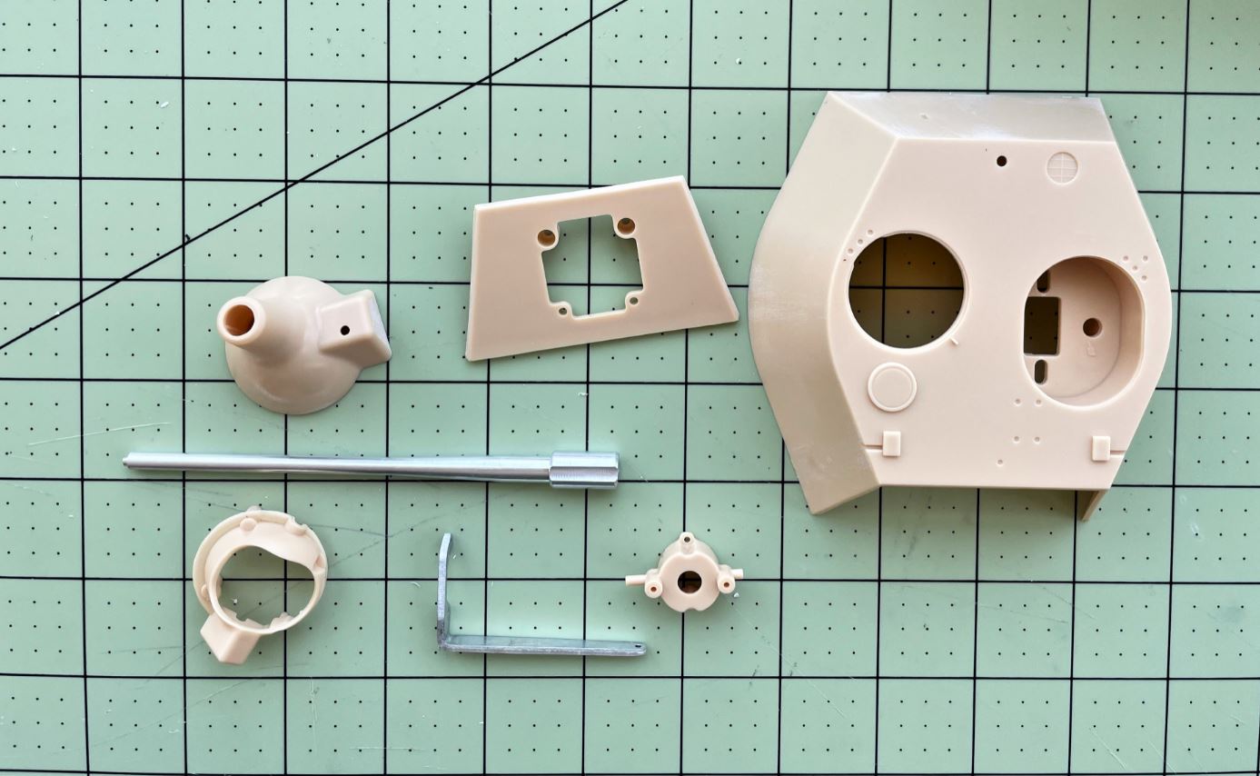

Continuing with the Puma build.
I got the barrel yesterday that i had ordered from MK Modellbau and i took a few hours to create the recoil system and the turret electronics.
These are the parts coming for the turret gun. There is no recoil. A metal bracket is provided for gun elevation purposes but i will not be using it.

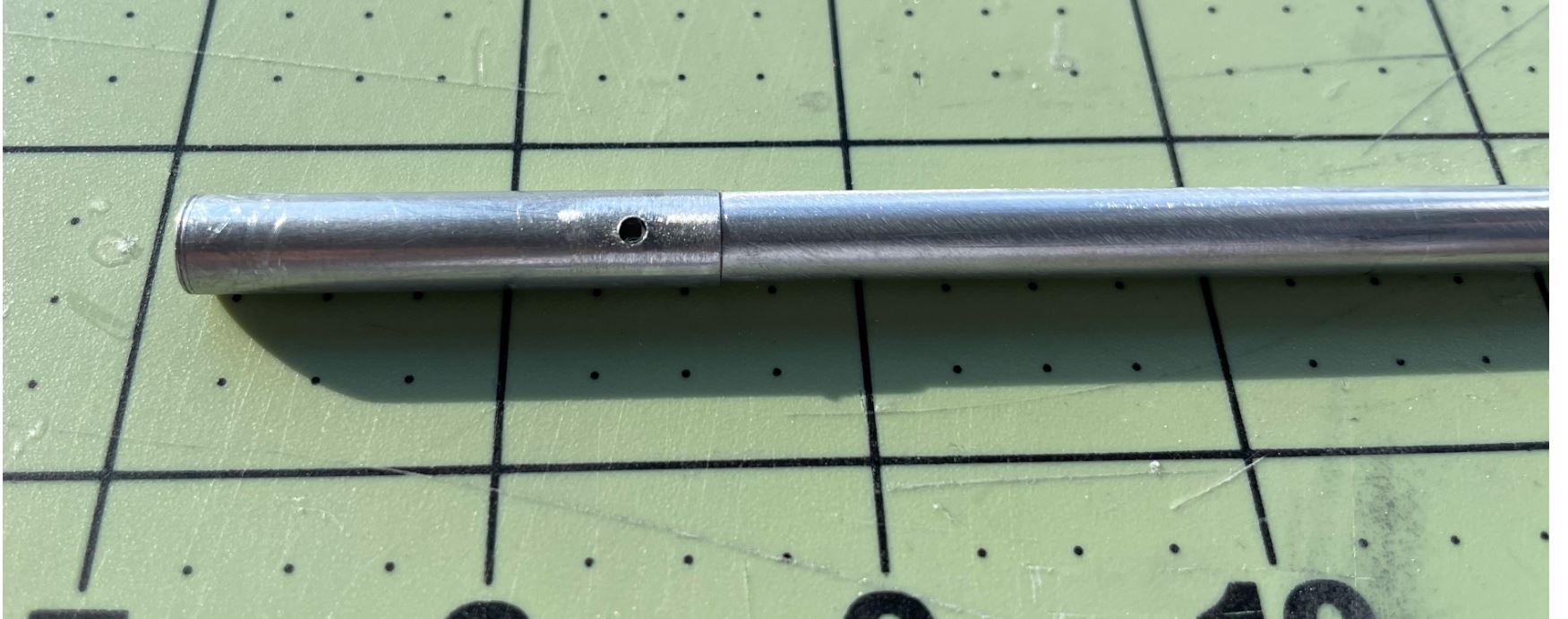

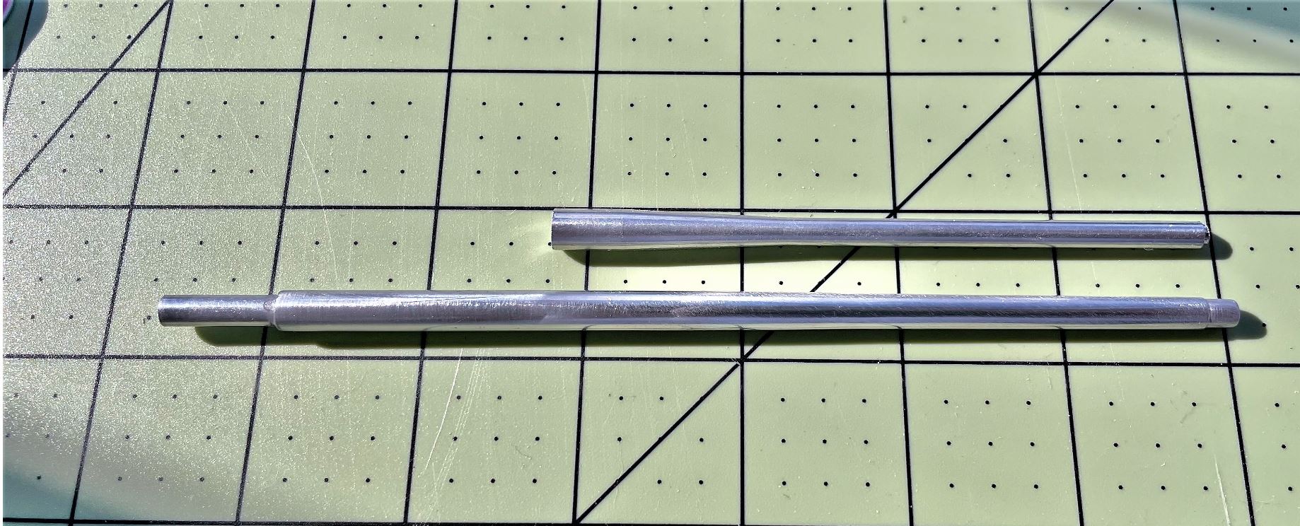

I ordered a Puma L60 barrel from MK Modellbau, seen at the top. However, i was not pleased with it. It is too large and still too short, its more like a 76mm calibre barrel than a 50mm. The slope is not well made and the 3D printed muzzle seems very weak. You can compare the size with the Metal Origin barrel below it.
But i was not going to return it. Using a coarse nail file, i thinned the aluminum barrel in a circular movement for about 15 minutes until i was getting close to get through it because the hollow inner is quite wide. So, it is as thin as it can become, i gave it a slow slope for an inch in the area where is exit the mantle, then it was pretty much thinned evenly up to the tip. I inserted another aluminum tube inside it to reinforce it and to provide an anchor for the required extension. It was then polished with a polishing nail file. You can compare the result with the metal origin barrel at the top. Still not thin enough but acceptable.

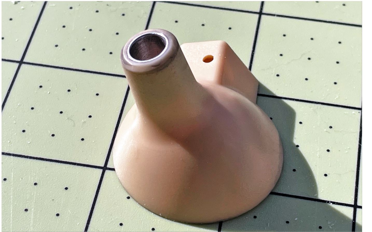

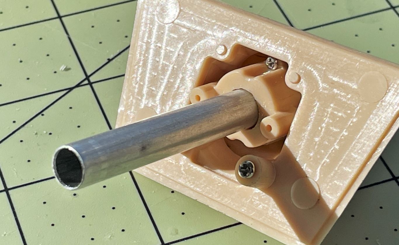

A new wider hole is made on the mantle to insert the metal sleeve coming with the MK Modellbau barrel.

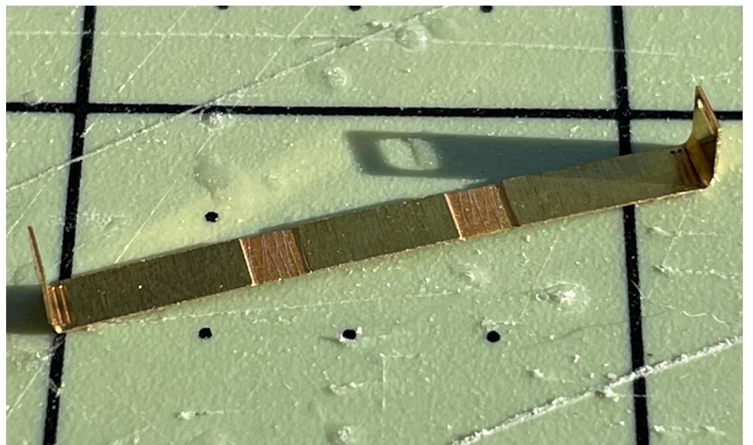

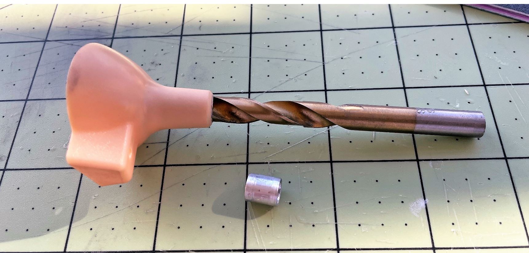

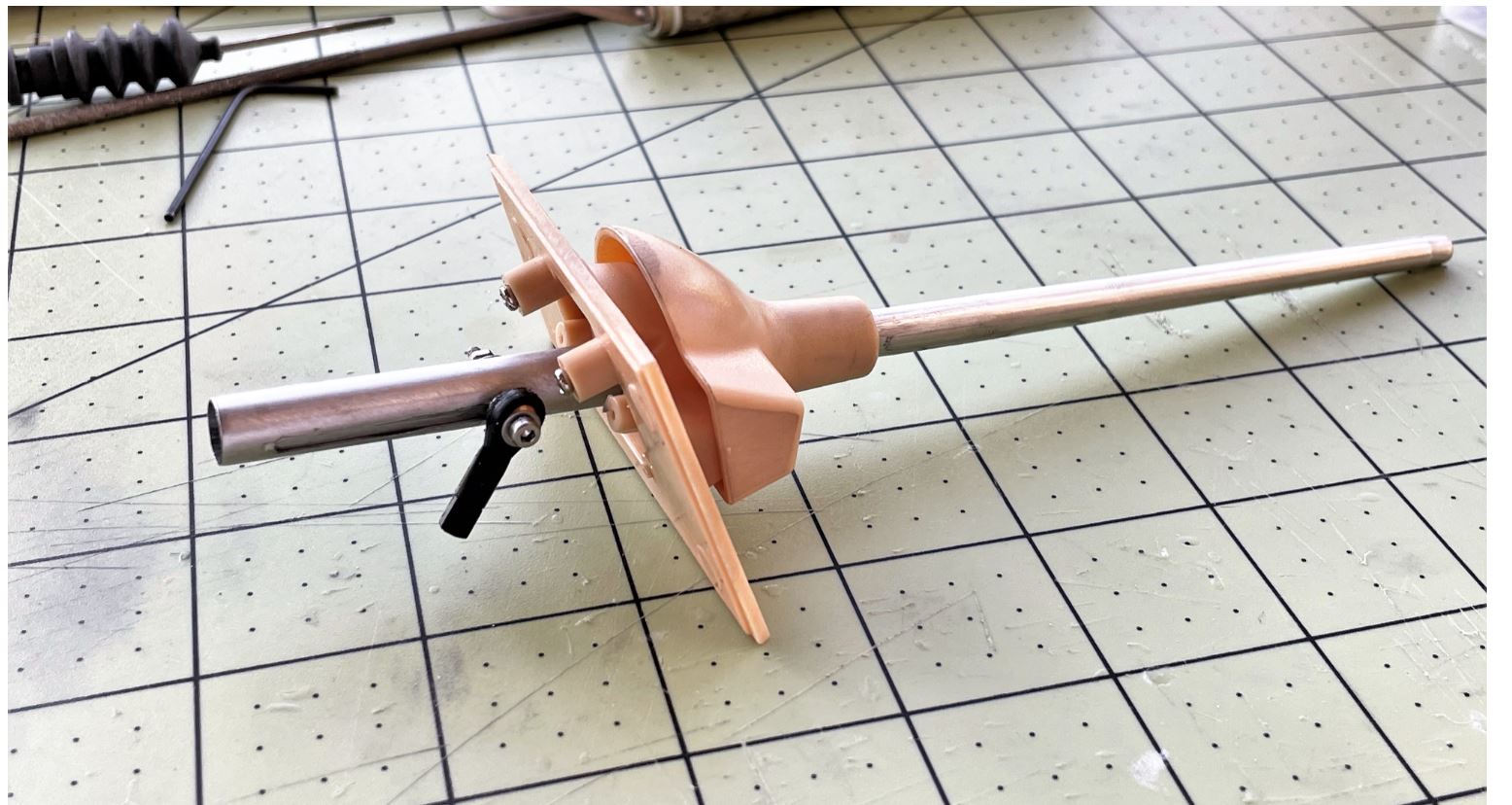

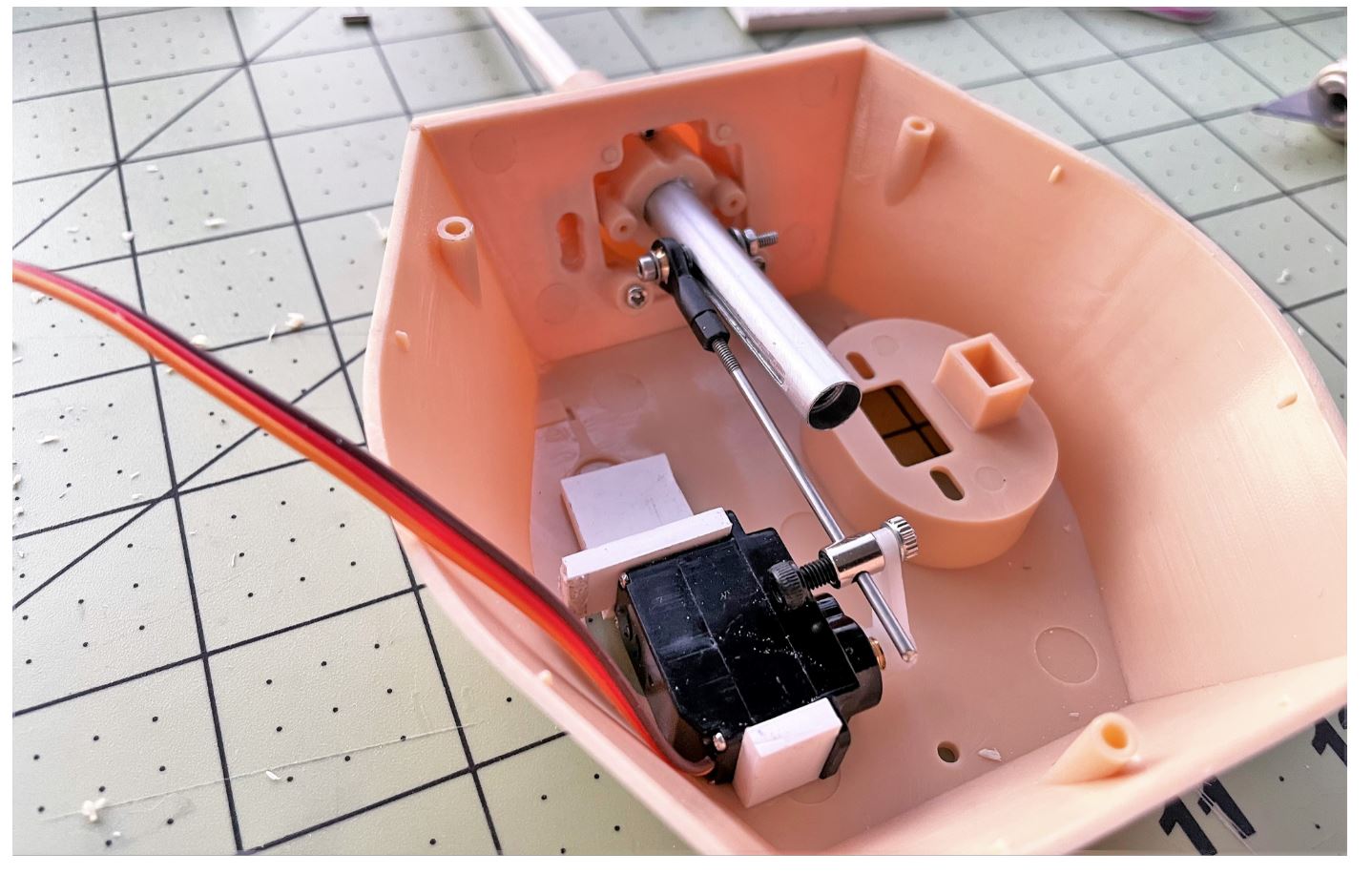

There is nothing really complex about creating a custom recoil system. As used in the Stuart and BMP builds, all that is needed are two overlapping metal tubes and a push rod. The secret is to properly select the tubes in relation to the barrel. Not too tight, not too small. When inserted into each other, they just need to slide into each other and be loose, usually a 7mm and a 8mm tube would do it. If it is tight, its not good.

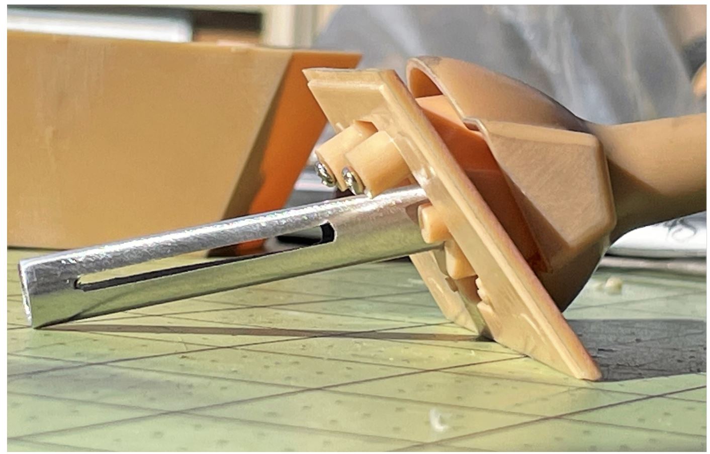

First, a 8mm aluminum tube section is inserted to the kit mantle after a wider hole was made to accommodate it. It is important to test the potential integration at every step. Then the tube is removed.
A 2.2mm wide groove is made with a Dremel hard cutting disk on both side of the 8mm tube, then the inside is filed to clean all debris, polished smooth and tube is put back.
The barrel is inserted from the tip to see the situation and where the anchor can be drilled for the push rod. It is critical that the barrel manually slides loosely. Some grease is applied. I usually have to make the two part recoil manually for 2-3 minutes, to clear any obstructions and give the recoil a good workout.

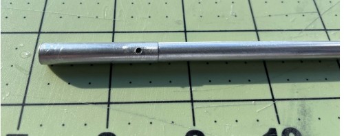

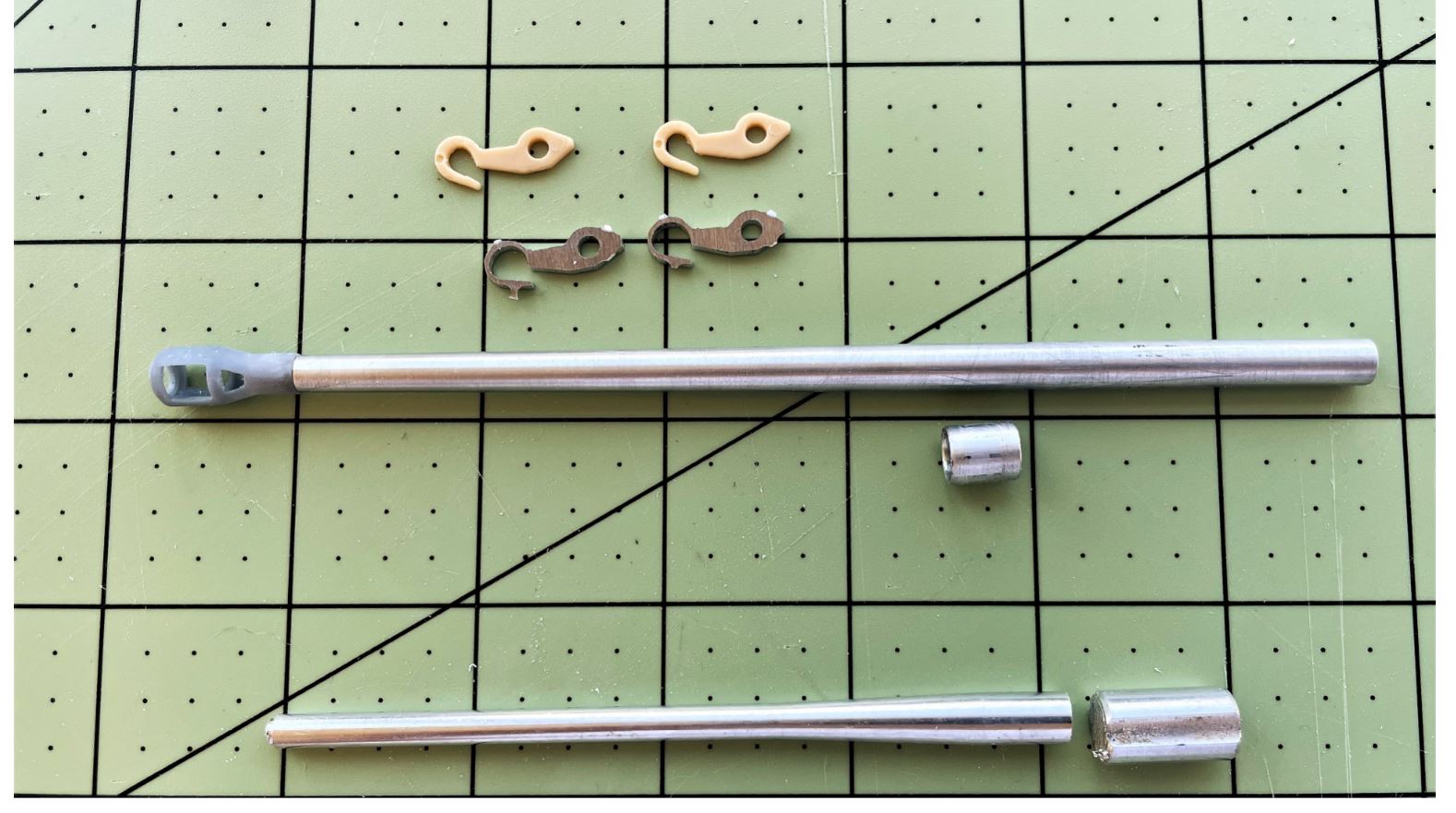

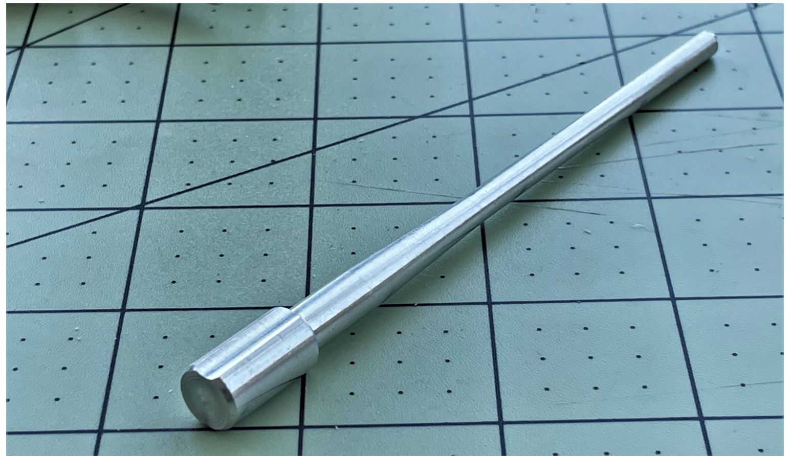

The MK Modellbau barrel is too short for recoil and need to be extended a bit. An extension is glued over the small tube previously added to the turret end section.
Continuing on following post
Re: 1/16 RC Sd.Kfz. 234/2 Puma armored car - lmcq11 build

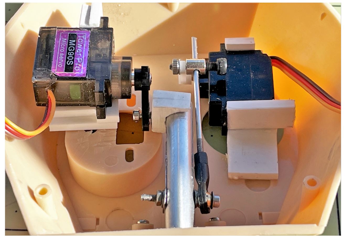

The exterior length of the barrel need to be carefully calculated (100mm between mantle tip up to the bottom of the muzzle) and then the hole is drilled at the right location to connect the push rod with a M2 Hex bolt and some washers. Give the recoil a good workout at every step, check for issues and use the hand file as required. Sometimes, it only take a very tiny shard of metal from the cutting phase to create a blockage that is resolved as soon as the shard is cleared. Keep everything polished and clean.

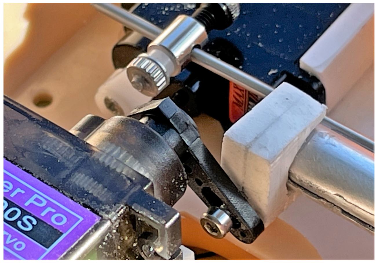

An e-Max servo is connected to the push rod. These nice push rods can be found cheaply on eBay China for a few dollars for 5 or 10. They have a swivel mount for the servo arm, they are really nice to work with and to make adjustments fast, at any time. Also makes maintenance easy.
Here we have a custom made Puma gun recoil... No need to wait for a vendor to design and sell something. You can basically make anything recoil with such simple design, specially for small size guns.

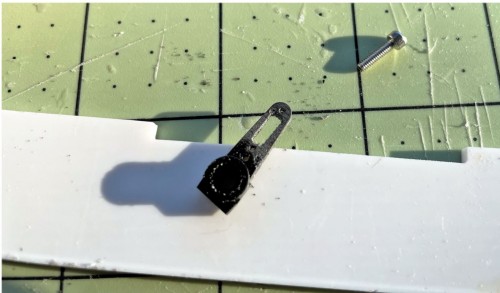

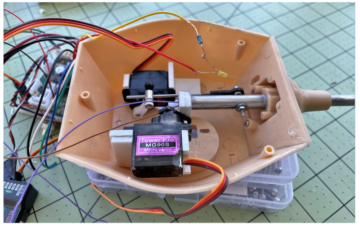

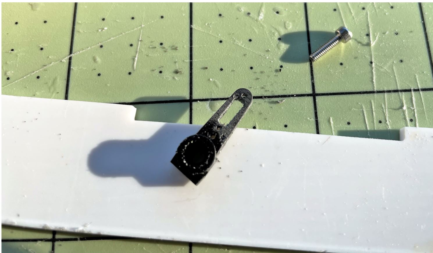

For elevation, a groove is created in a micro servo regular plastic arm.
A plastic stub is glued to the end of the recoil tube into which the elevation servo is connected with an M2 hex bolt.
Here we have Puma gun elevation. The Puma turret is surprisingly spacious, no need to put the elevation servo under the turret like the instructions suggest. This way, it provides more room for the electronics and cables inside the hull, and for the turret to turn more freely.
Overview of the turret electronics with main gun and coax machine gun flash added. The wiring is just for testing purposes, it will be permanently added once the other electrical components of the model are finished, such as head lights.

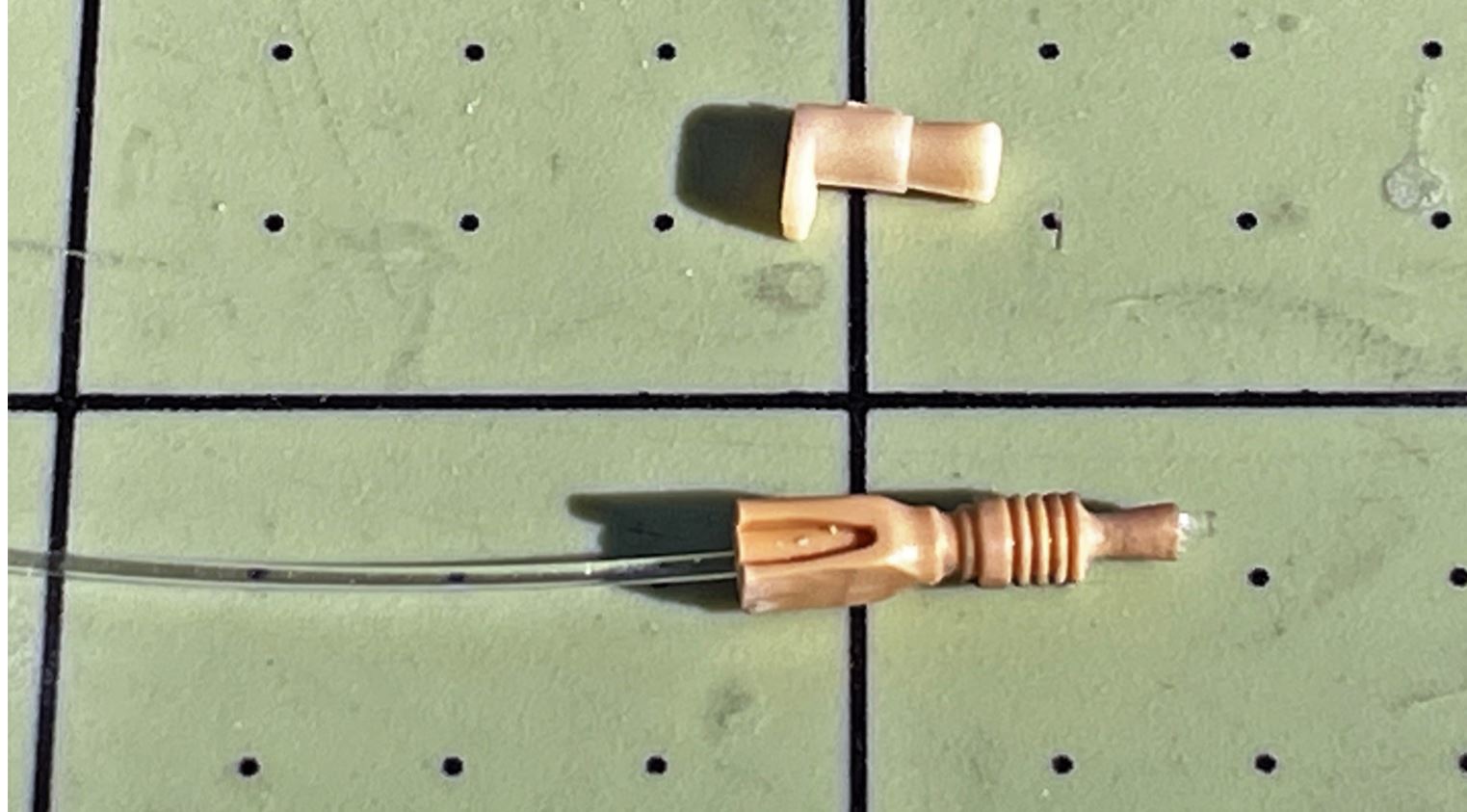

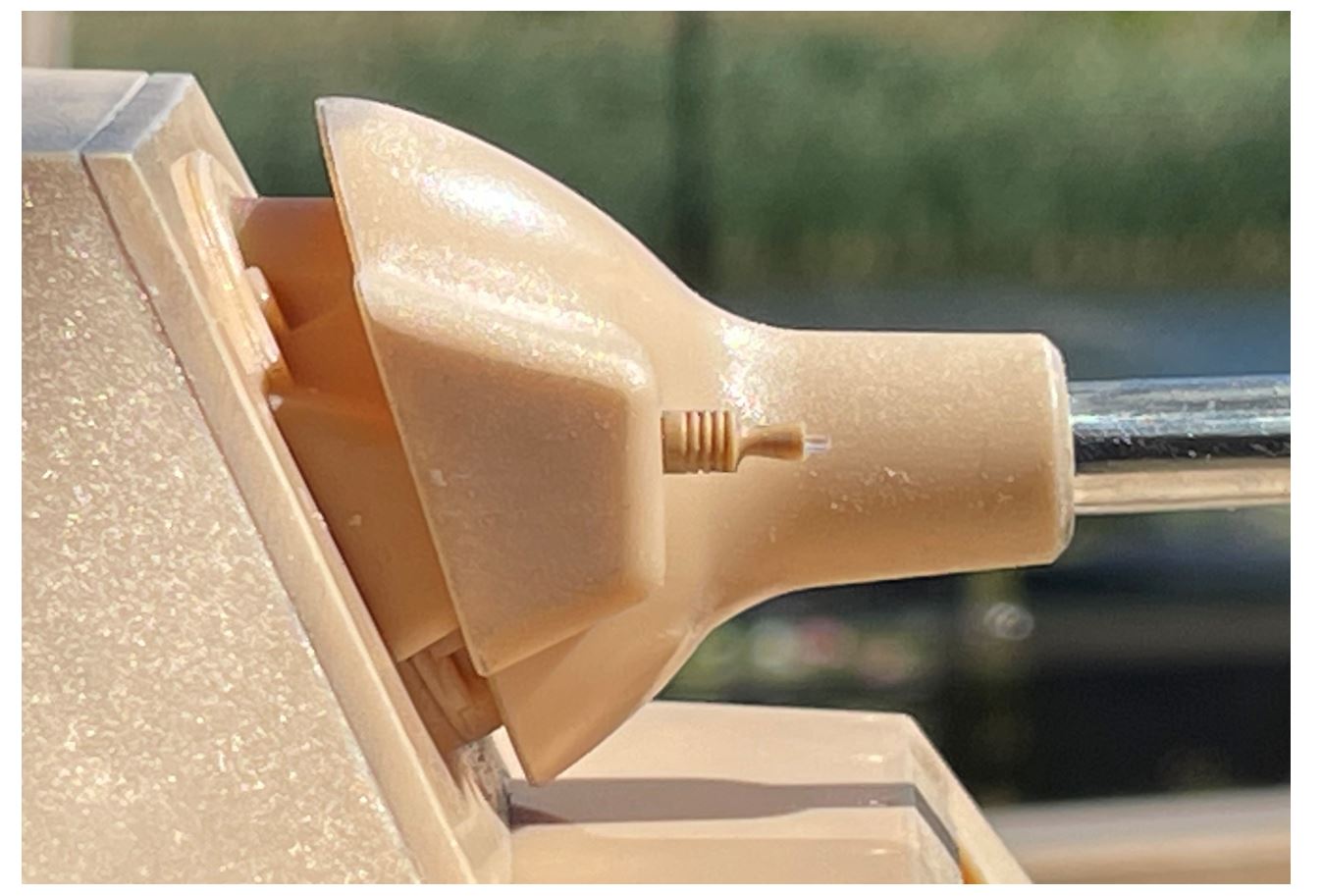

The ugly kit part for the coax machine gun (top) is replaced with the tip of a Tamiya MG-42 from the spare box. It originally came with a 1/16 figure. A thin fiber optic cable is inserted.
Then the coax MG is positioned in place on the mantle.

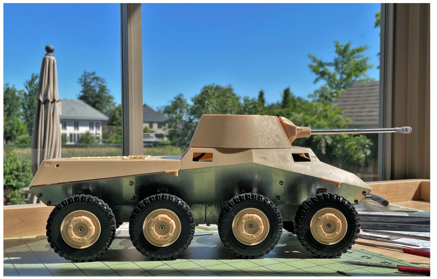

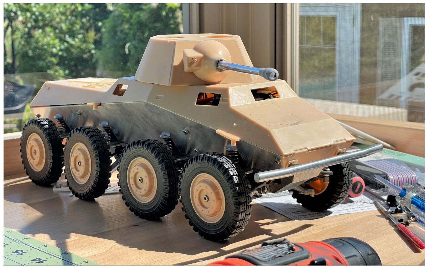

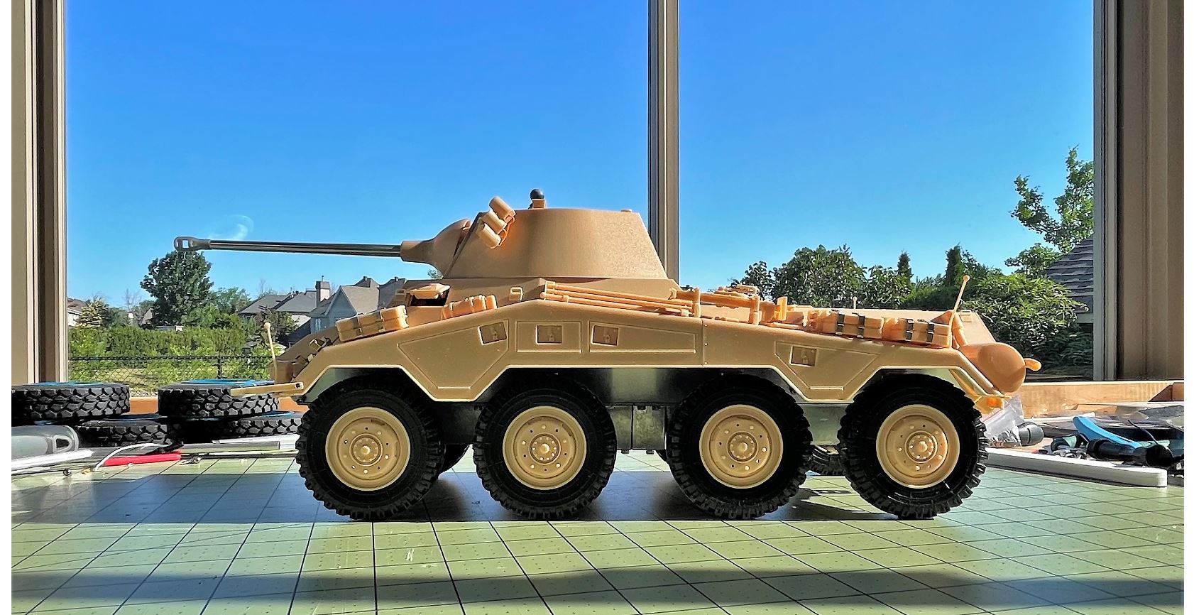

Overview of the model as it stands today.
Regards, Louis

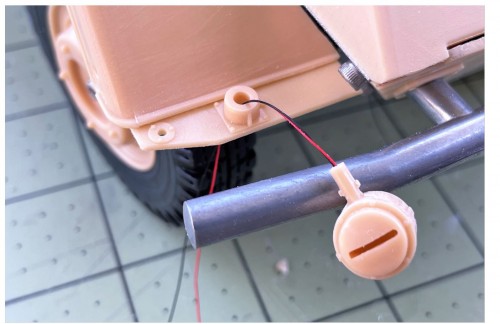

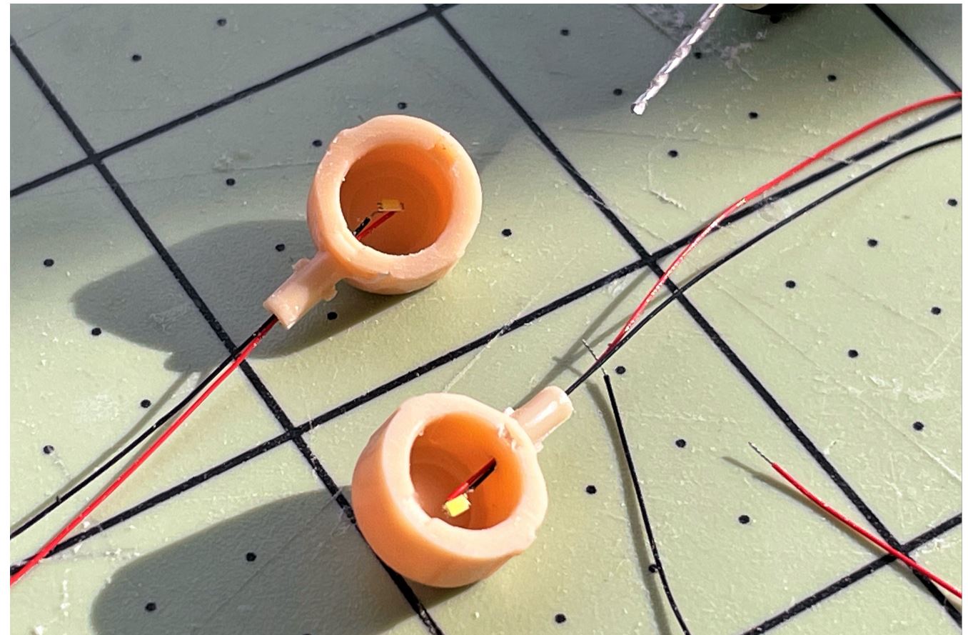

A simple hole is required to make the headlights functional and add the small LED inside.
Mounting the headlights is easy.

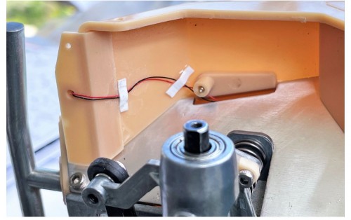

The wires on those LED can't be glued by themselves on the hull for some reason. Need some plasticard bracket.

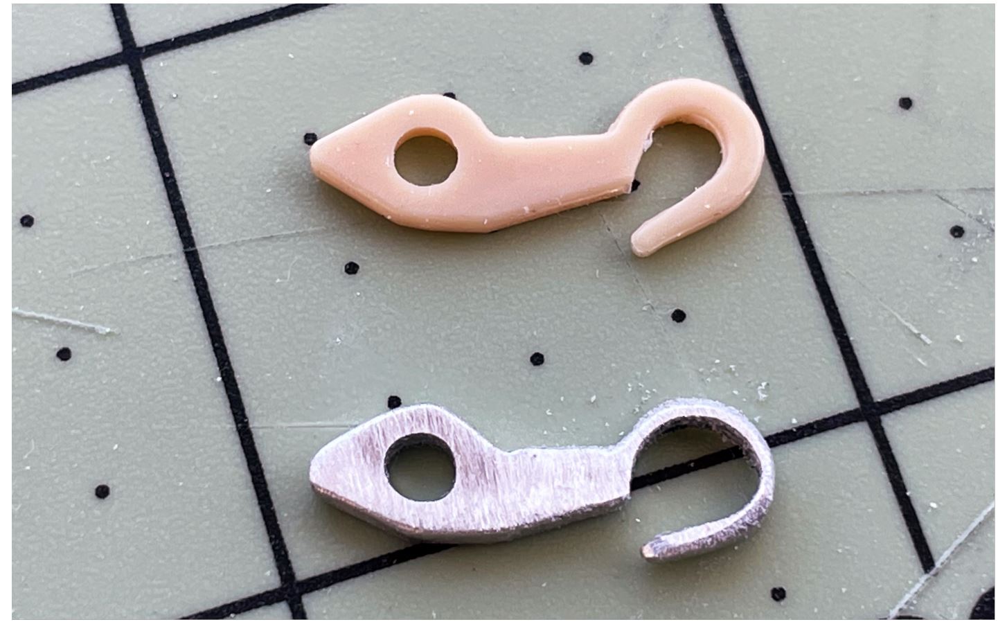

MK Modellbau was selling a metal replacements for the kit plastic rear hooks that i was concerned would easily break. The replacement turn out to be of very poor design and are ugly. I tried to do something with them but the hook section is just too thin and ugly. No way i am putting this on my Puma. In the end, i discarded the MK Modellbau hooks and kept the original plastic ones. I will be more careful going forward with such order.

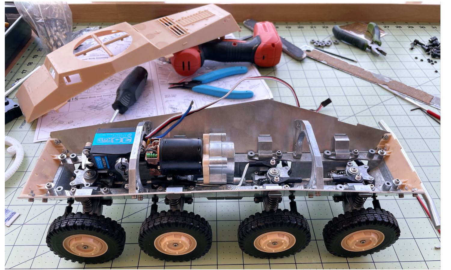

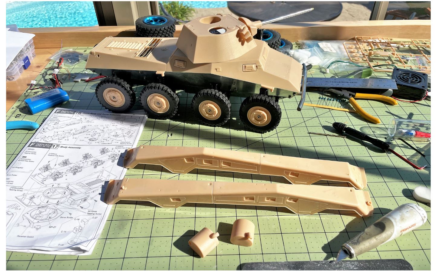

It is only now that i realize that the fenders need to be kept removable in order to open the vehicle all the time. The hull has a lozenge shape and the fenders are going over top and bottom sections, squeezing the hull together like a sandwich. I know some guys like to put magnets on upper hull but forget about it for the Puma.

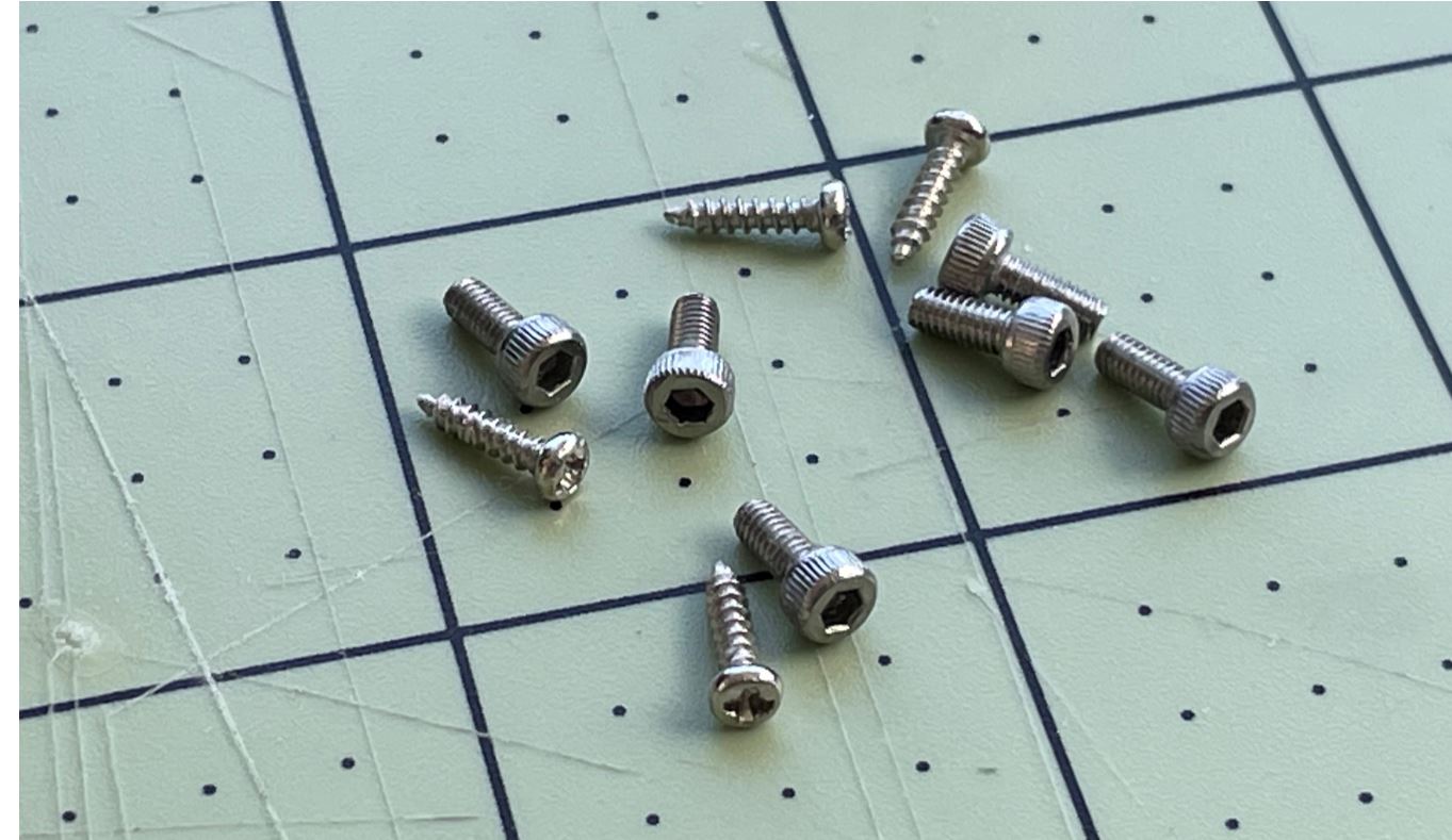

A total of 10 screws from bottom, sides and top need to be unscrewed every time you open the hull... I see no alternative. Well, its the Puma shape to blame.

Final view of the electronics with battery inside and all. Keep in mind that a small battery is required as i do not see how a large regular one can fit with a control board, turret rotation, and all the wiring. Maybe it does but things are a lot simpler with a smaller size battery.

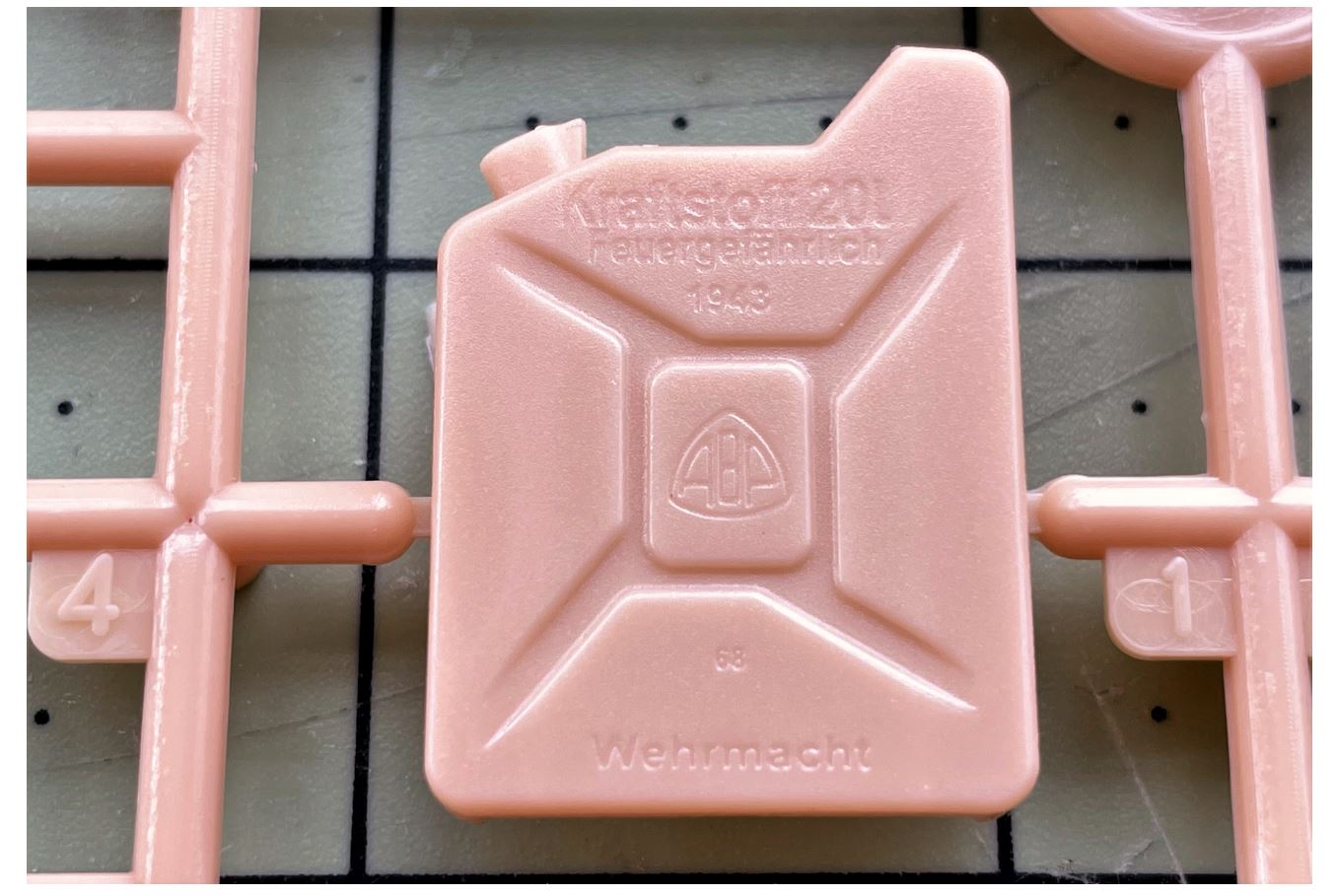

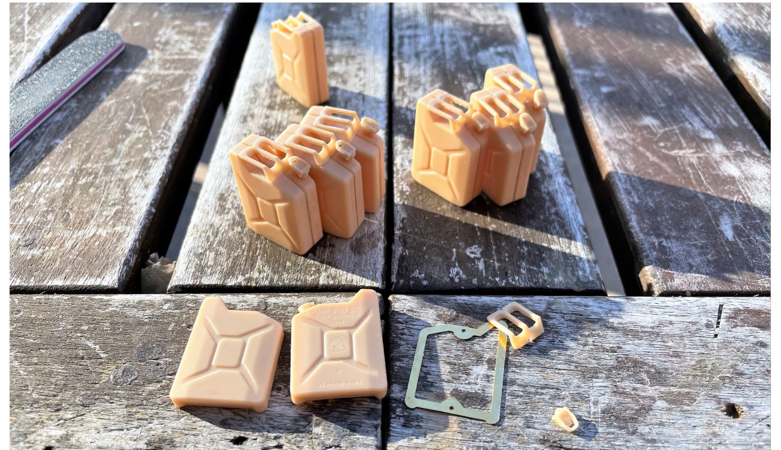

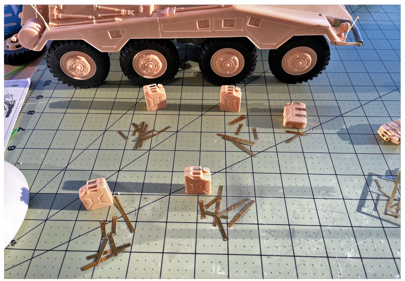

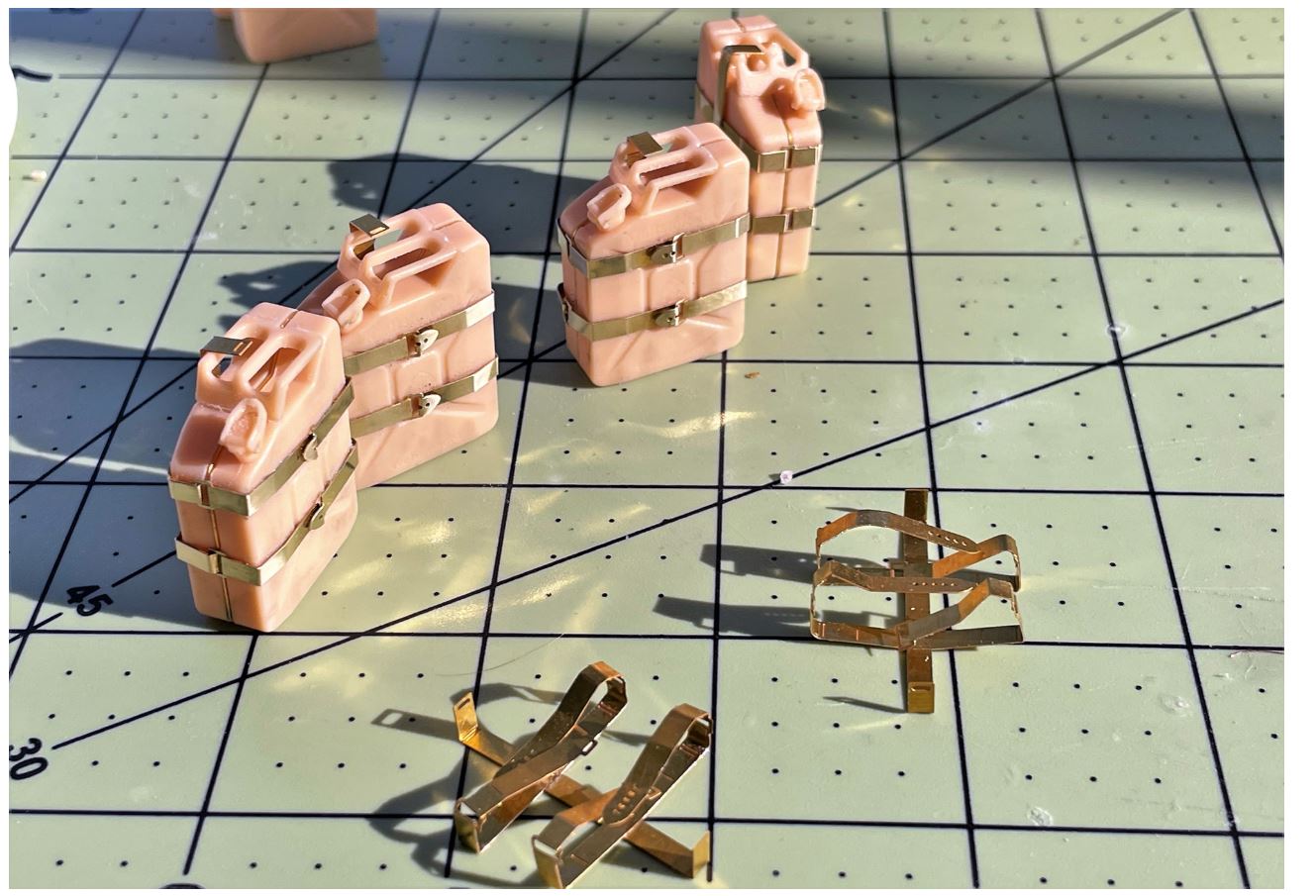

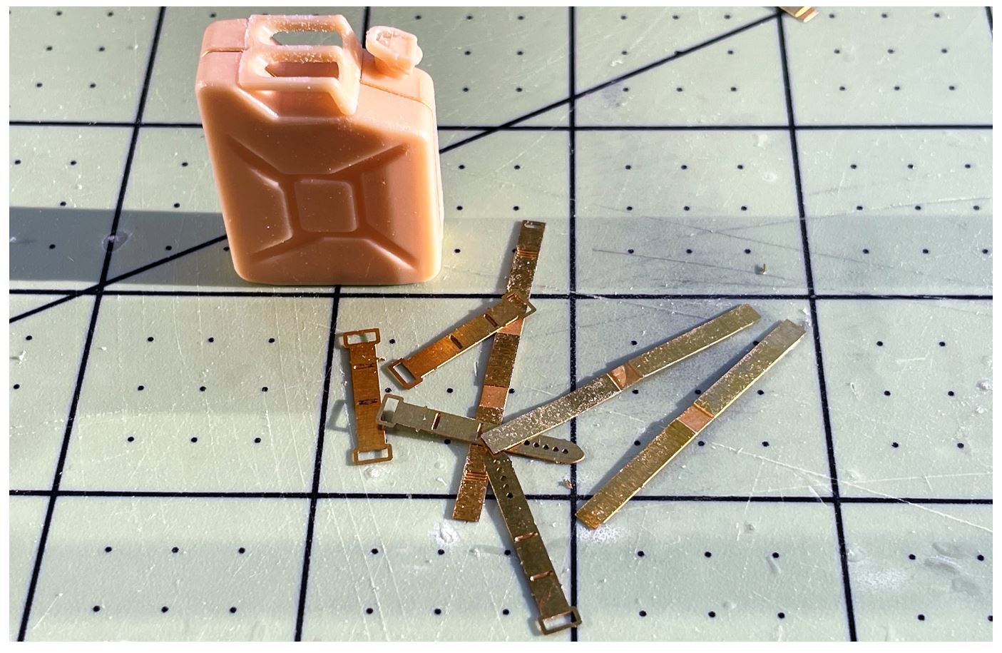

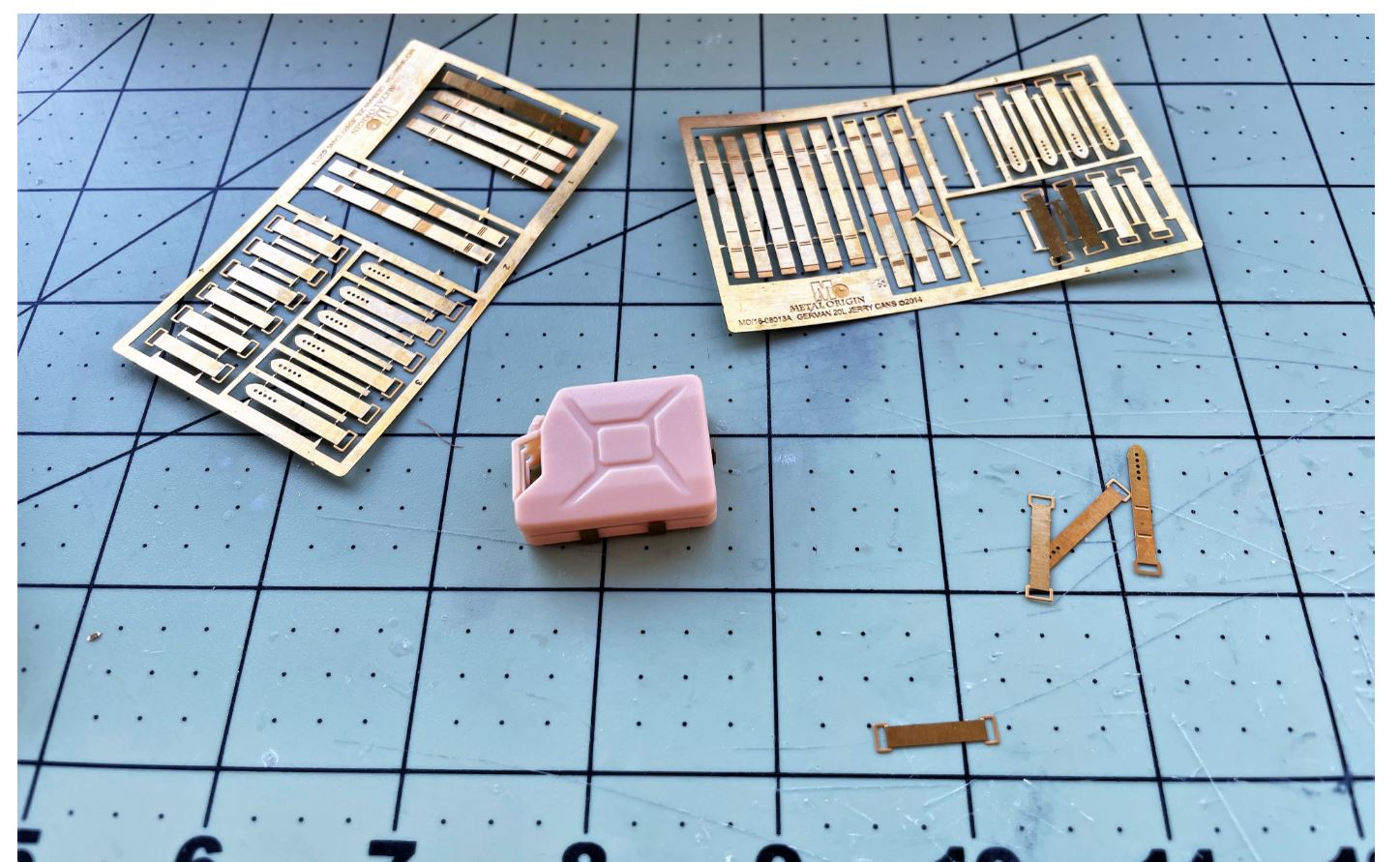

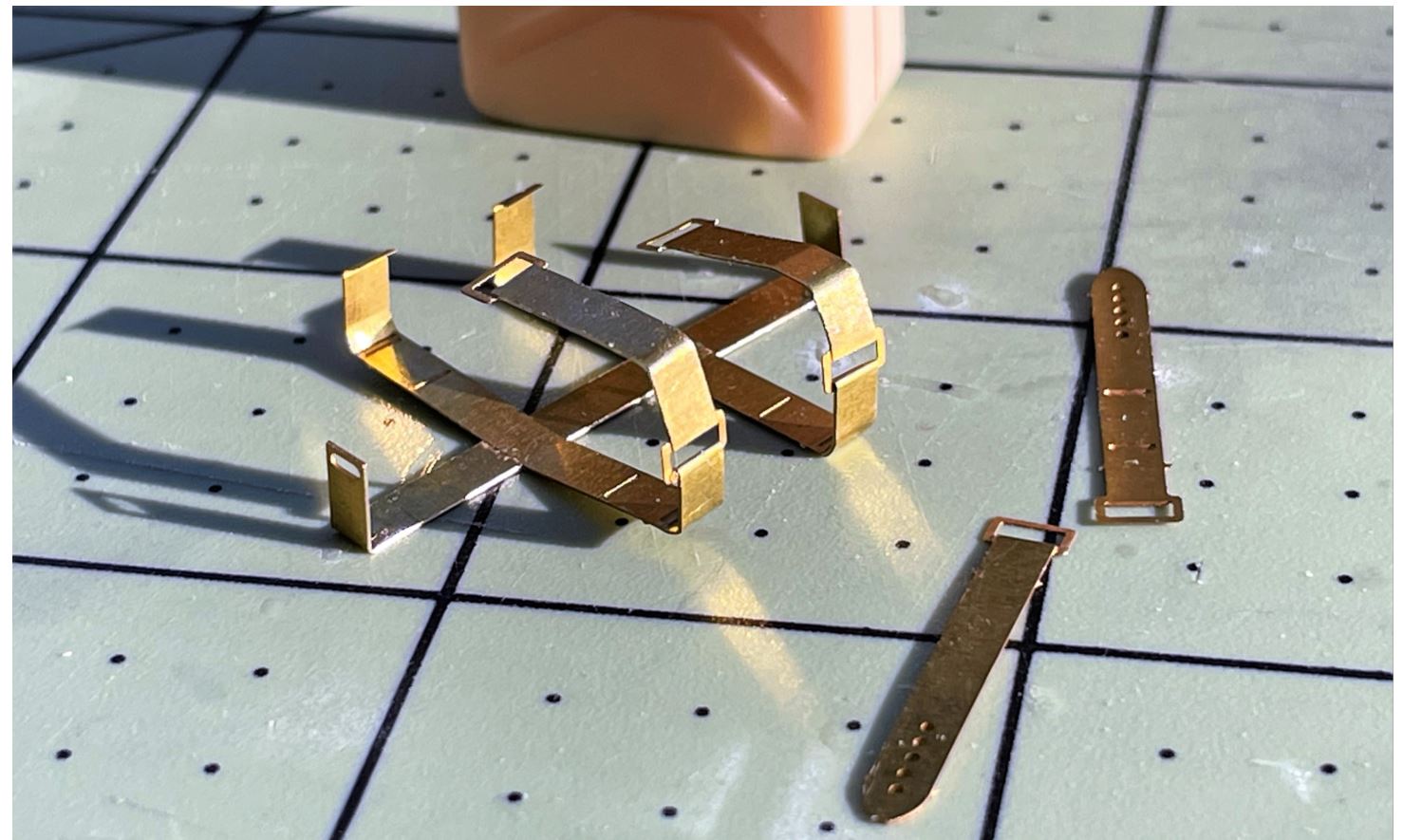

The kit Jerrycans are the best i have ever seen. Metal Origin should sell them separately.

Each Jerrycan comes in 5 parts. Eight Jerrycans are provided although only 6 are supposed to fit on the hull.
The mounting brackets are enough to create great concerns.
The mounting brackets are provided in Photo-Etched parts, each bracket requiring assembly of 7 small PE strips.
You need to do this when you have a cool head and rested. A small assembly chain is created.
The PE parts
I use superglue on everything, i like the fast drying. I know a lot of guy are using some special glue because they think superglue is not strong enough. I personally do not like to mess with exotic toxic glue and smells. My trick of using superglue is to ensure the glue has some anchor to adhere to. Some small scratches are created using a blade on the parts where the glue is required. It helps making superglue a lot stronger.
The trick for an easy assembly of the straps is to handle the PE parts like real straps... and avoid putting glue everywhere.
I will only be installing 4 jerrycans. The 2 Jerrycans at the front cannot be installed, otherwise you will not be able to open he hull anymore because the screw holding the fenders is right under it. So i will only be installing an empty holder.
Construction is finished.
