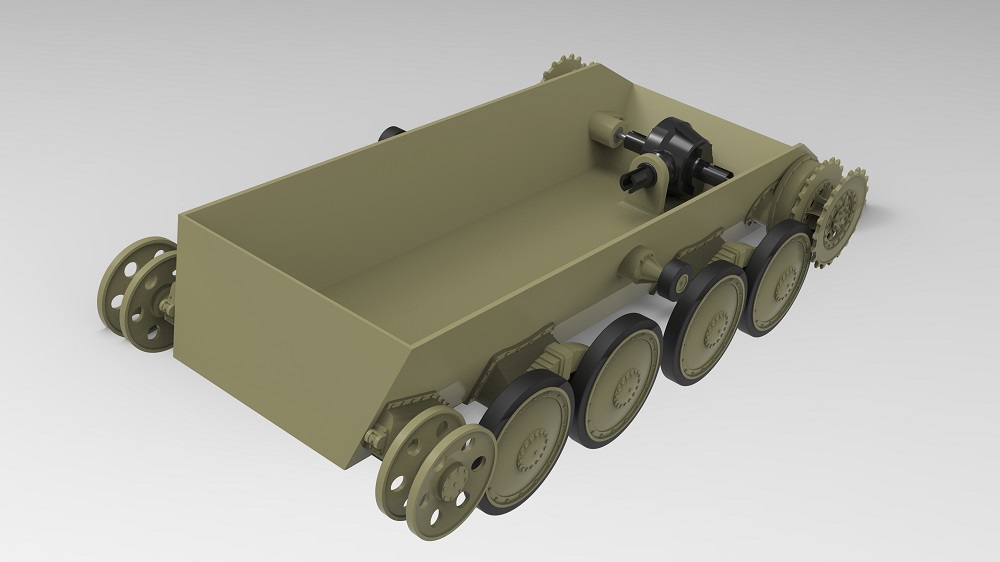

Differential in, tons of tweaks, figuring out the steering brakes now.

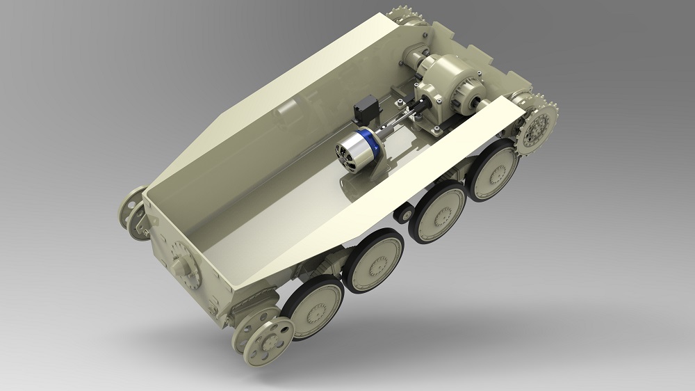

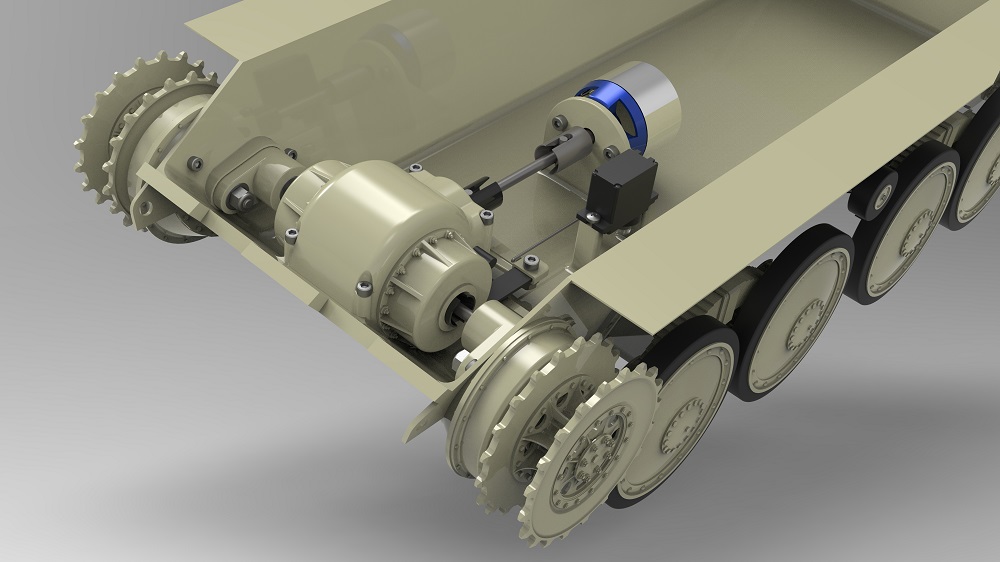

Steady progress... Every feature I add, I realize I had something else not exactly right... rolling waves of updates, and lots more to go I'm sure but happy with progress, especially the steering brakes.

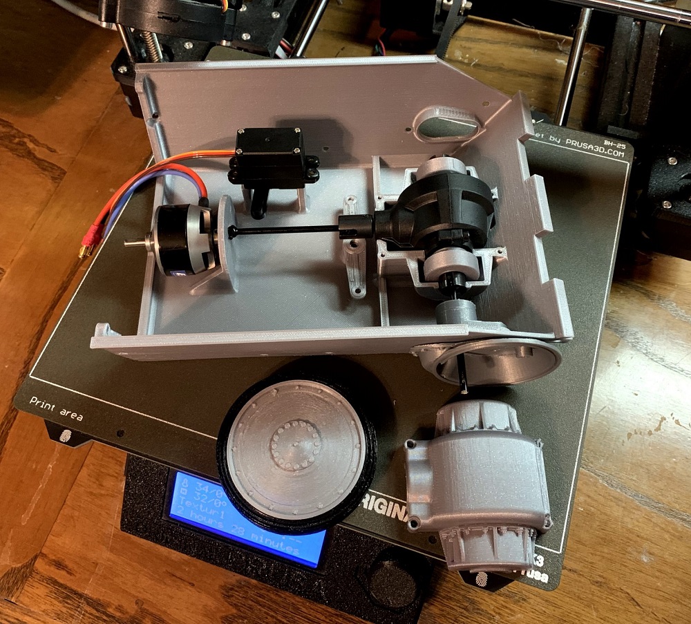

Coming together well... Differential has a ton of break away torque. Nothing but to test it. I have a metal gear servo for it, will see how it goes. Need to reprint with adjustments for motor mount and servo mount. I'll probably need to make some kind of modular mount so I don't have to reprint every time I may want to use a different motor or servo but just reprint the mount itself to go on top of a sub-plate.... Hmmm. Off to do that now lol.....

Hi, what kind of motor is this ? It looks so tiny for a 1/12 tank. I think you will need to upgrade to something more powerful very soon, specially if you are designing the drive train to use brakes for steering. I am intrigued by your design but worried at the same time. In any cases, we will see what will happen and that makes your build interesting.

lmcq11 wrote:Hi, what kind of motor is this ? It looks so tiny for a 1/12 tank. I think you will need to upgrade to something more powerful very soon, specially if you are designing the drive train to use brakes for steering. I am intrigued by your design but worried at the same time. In any cases, we will see what will happen and that makes your build interesting.
Thanks... Its just what i had laying around. bear in mind that a 1/12 hetzer is about the same size as a 1/16 Panther and those have crappy little brushed motors and this is brushless and really geared down. I'm an engineer, and nothing here I can't do :) I'll try it with what I have, and upgrade from there; No point in buying new parts until then though I'll probably end up with something twice that size I imagine. I am using steering brakes and they do have a lot of drag, though the diff is very smooth for straight forward motion. I wish I had some idea on how to calculate the required power without a crazy amount of work. I'm going back through now and standardizing al the fasteners. Looks like I'll have about 3-5 basic ones to cover it. The hull halves are keyed and self aligning, so that should work good. I also made it so the top flanges will slide on riding on a keyed slot for alignment and stiffness. Pretty happy with it overall. Once I get the powertrain all debugged I'll start on the superstructure. I found some more good documentation, so did some overall minor revisions too.
Yeah, I looked at the mount and the motor and thought the same thing. When I scratch build tanks, there tends to be a lot of re-engineering since things don't tend to work out the way I see them in my head as I am not a mechanical engineer. I do end up getting them to work though one way or another... :) Having broken motor mounts in my tanks due to the torsional stresses of the motors, I have learned to overbuild everything as the forces of motion in tanks tend to be quite large.
All of my scratch built tanks have ended up with a dual motor setup as it is the simplest method of control of the two tracks. I do understand that you are trying to make this tank act like the real thing which is why you chose the "breaking one track" method. I have found that it can be done with electronic methods, but it doesn't 100% percent replicate the motion of using a brake on one track. I do hope you can get it worked out as it will be a cool build.
