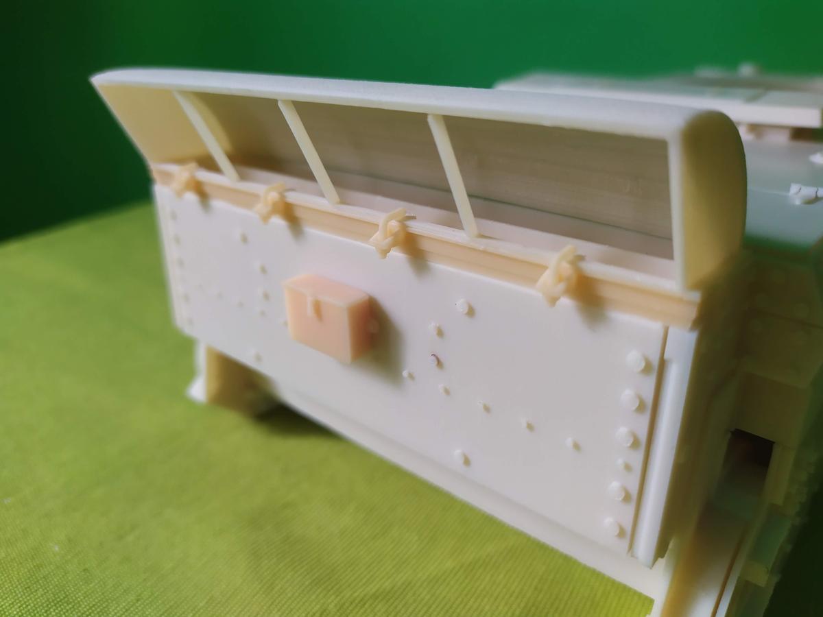

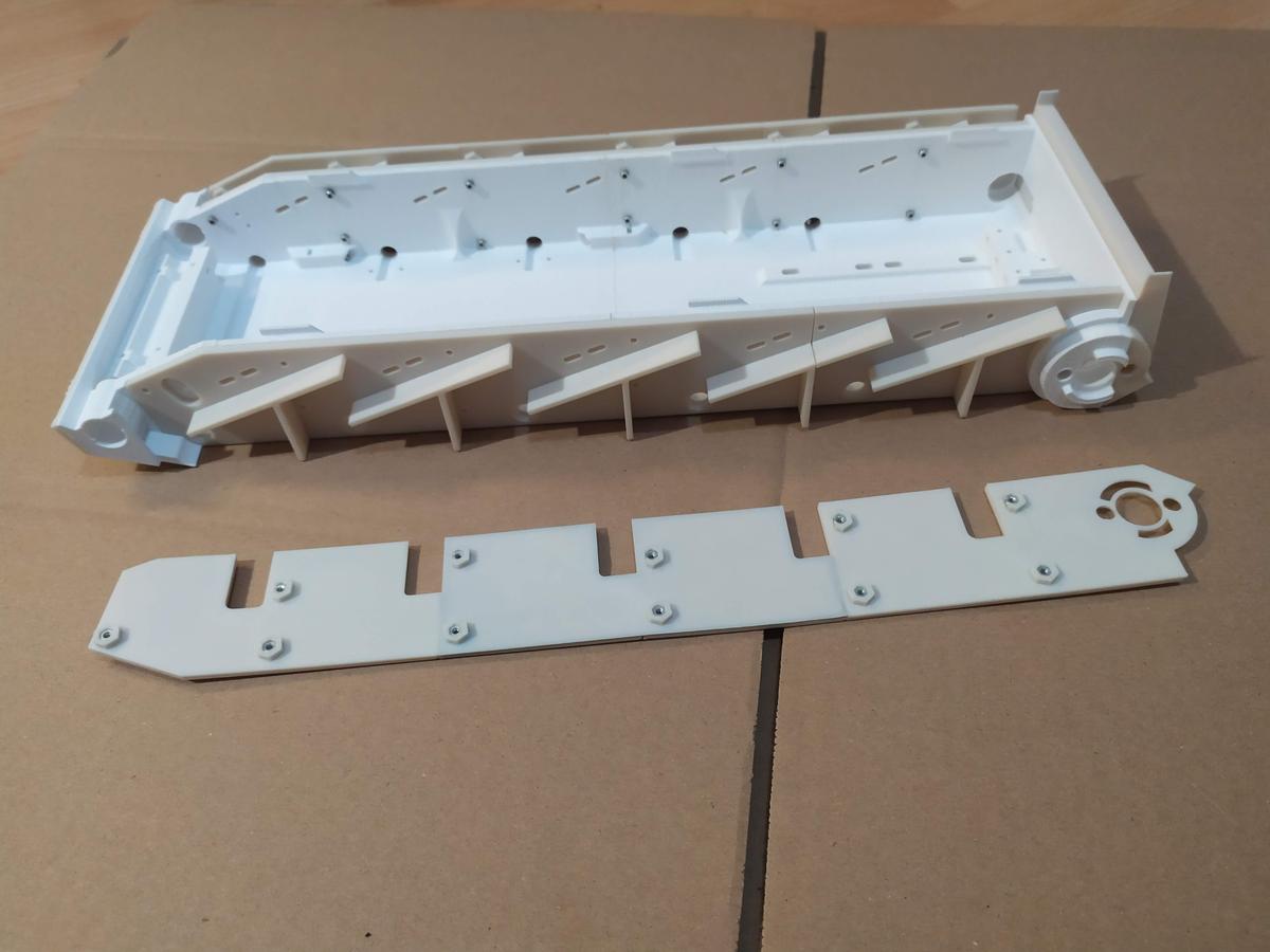

The hull is almost complete.
Have to reprint engine cover, but its normal, when i make prototypes.
Almost all parts on the pictures are at least version 2.
CAD files have even 6 or 8 versions before first test print.
Its big assembly with hunderds of parts, so i am unable to catch all problems in PC.
Nevertheless, prototype is growing fast.Going to prepare that tracks finally.
I have a lot of photos.I dont want to spam all that big pictures here.
If you want to see them, use this link.Attaching only one picture for the illustration.

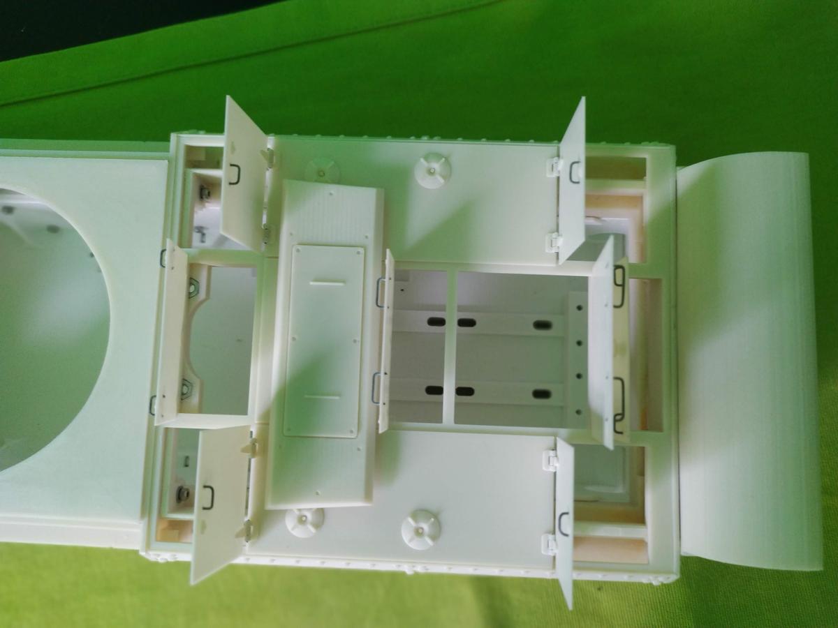

Have some news.Engine covers and the exhaust.
Going to assemble turret and tracks.
Have more finished parts, but i dont have time to make photos of all that things everyday.

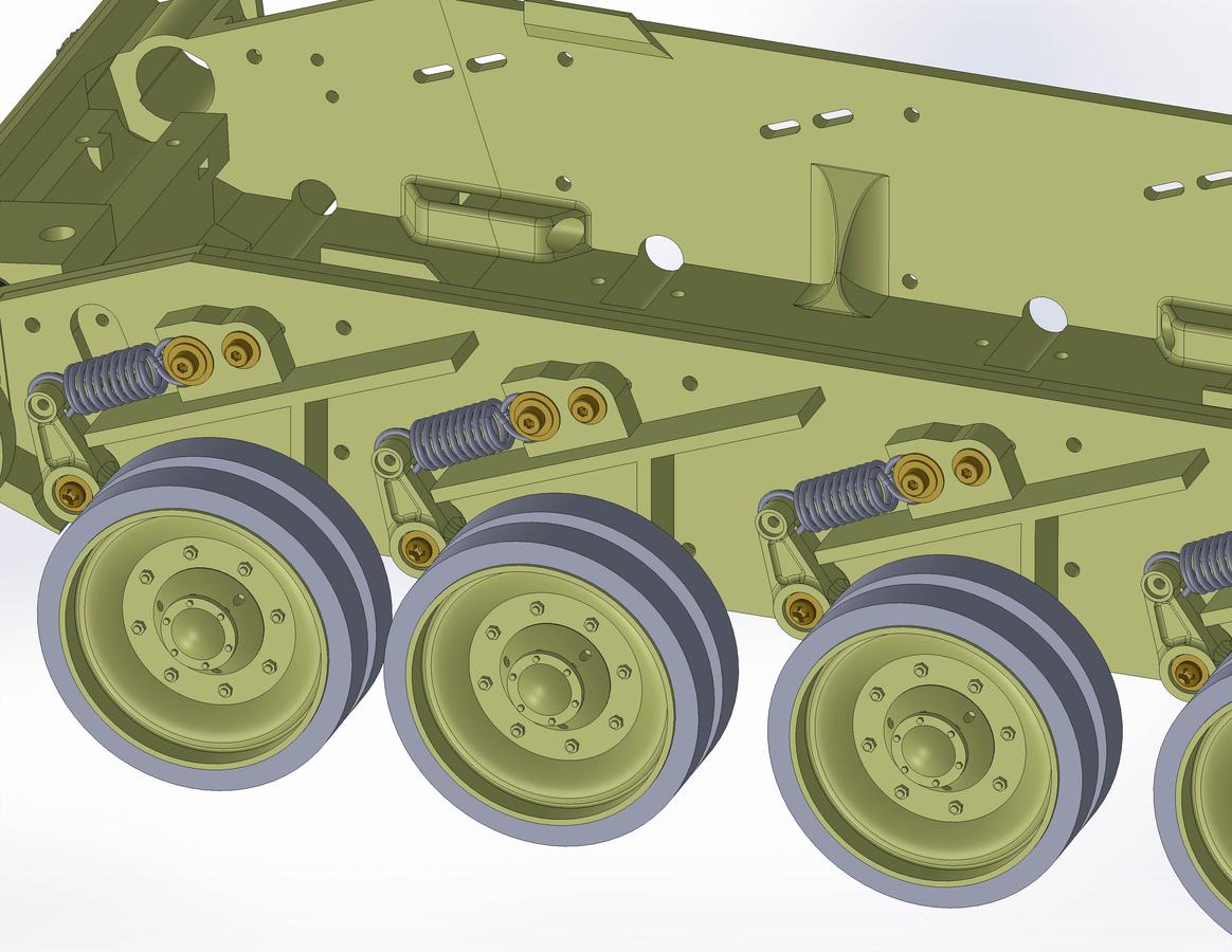

The suspension housing truly follows the pattern of the original full-size Mk IV.

Re: 3D printable Cromwell Mk. IV in scale 1/16
Post by 50koruny »
Yes.I am trying to follow the original as much as possible.
Apperance of the suspension springs is different, of course.
Same with the parts, used to mount that springs.
Swing arms are close to the original, but some shapes are changed for better durability and because of that springs.
Suspension springs will be 30-35mm long, diameter 8mm and 0,8-1mm wire diameter.It must be tested all together to find perfect springs.
Anyway, tension of that springs can be fine-tuned by moving that spring-holder part.
Armor plate uppon the suspensions can be removed anytime to get access to the suspension system.
Its fixed with screws, not with the glue.

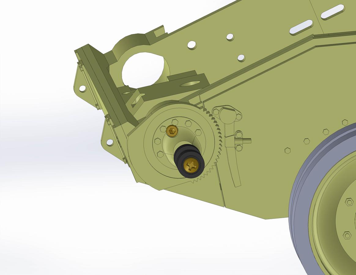

This is a track tensioner from the outside.
Following original as much as possible.
There will be still some limitations and some compromises, but i am trying to do my best.
