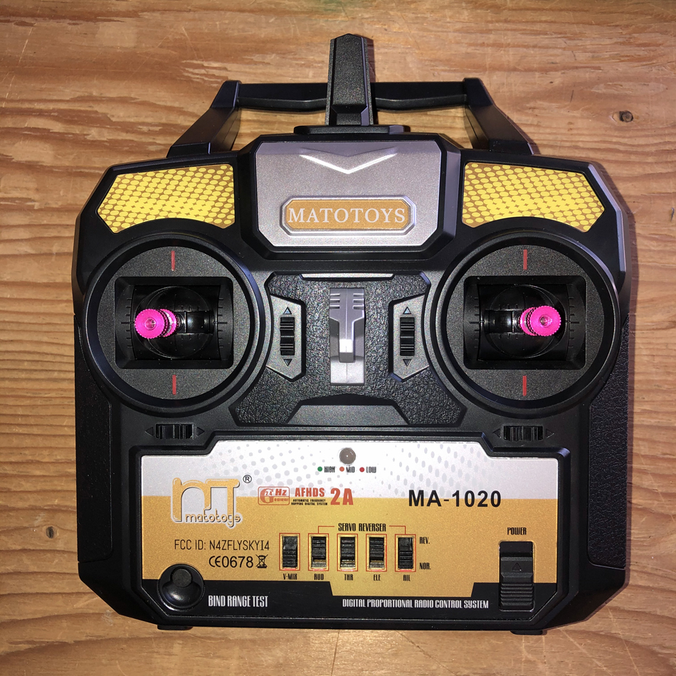

Here is a photo of the transmitter. I took it when I first opened the the M10 to ensure that I kept the switches correct. I see now that it's some version of the Flysky. It does not have a screen such as I have seen on transmitters for sale in hobby stores. ( :think: ) Maybe there is a downloadable program to set parameters. I will search online.

That is a rebranded flysky.
Think no more, no need to measure anything, neither get servo testers. Just plug the servo in the receiver and move the sticks. If they move is because they are fine.

Rad_Schuhart wrote:That is a rebranded flysky.

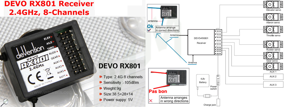

in view of the photo of the transmitter, and my personal opinion? the 3 middle servos are on "Reverse" and not on normal? as already said, take out your receiver and connect the servos to the outputs of the receiver, (supplied with 6 volts) and by operating each stick the servos must move, all ditto
example connection for tests, ignore number of servos on photo
