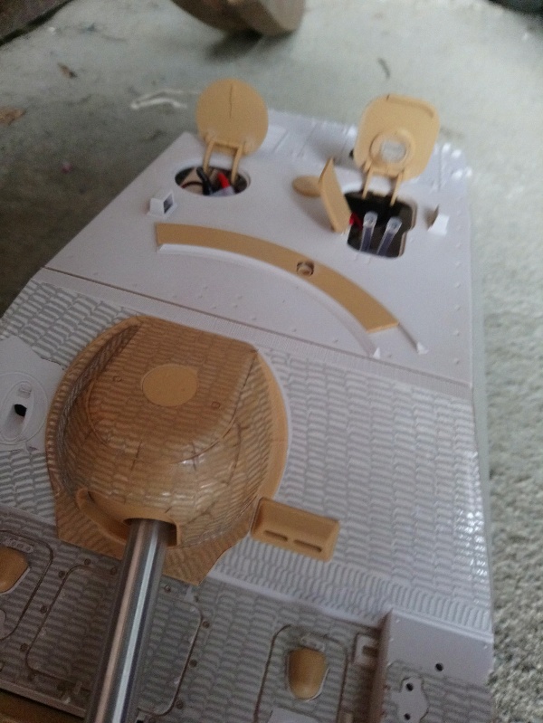

I have been watching, for as I said above, this is a tank I dream to build someday. Am I seeing correctly? It looks as if the axles for the road wheel bogies are mounted under the metal hull with plastic below them. Also, it seems as if you are doing much of the assembly before priming and painting. Did I get that correct?

Herr Dr. Professor wrote:I have been watching, for as I said above, this is a tank I dream to build someday. Am I seeing correctly? It looks as if the axles for the road wheel bogies are mounted under the metal hull with plastic below them. Also, it seems as if you are doing much of the assembly before priming and painting. Did I get that correct?
only the two parts marked in red and the wheels are plastic. The axle and the entire carriage assembly is made of metal. Hope I understood correctly what you asked :)
I think that what the Prof getting at, is that it's tricky to prime and paint the suspension, and the lower hull, when it's fully assembled. When I built the Tamiya Pz IV Ausf, J, I primed (with metal primer for metal parts) the wheels, hull and suspension before fitting the rubber tyres etc...
The same preparation is generally needed on all other Tamiya full-option kits. Metal primer is essential for the hull and running gear, as primer and topcoat won't adhere effectively without it. :problem: You can, of course, strip it all down to paint it- but that would seem like a waste of time and effort. :think:

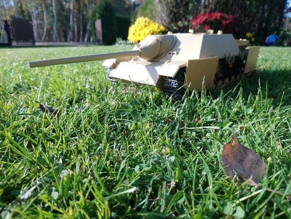

welcome a moment later :) I used tamiya foundation for all parts. but I painted only the wheels separately. I painted the main color (dunkelgelb) from a can of spray tamiya dark yellow. I painted the camouflage with a brush using tamiya paints without diluting. Finally, I put several layers of Vallejo satin varnish and then dirty the model and then again for durability I used satin varnish. As for the durability of our camouflages, when driving in the field, you can always hook a stone or something else that will peel off the paint, so I do not attach much importance to it. the model also gets dirty, which masks such defects. as for the Jagdpanzer IV itself, it is already finished and after a dozen off-road rides, but for the end result I have to wait for you because I wanted to present the entire report from the construction.

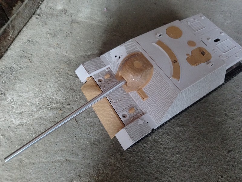

Fotorelacja z kolejnych etapów prac :wave:
