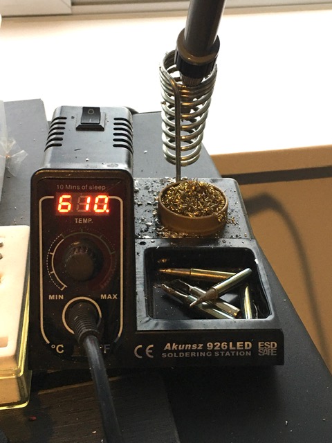

I use this inexpensive but excellent soldering tool. I got this one from ebay for about $75 or so. It is very similar to the one I used @ IBM back in the 80.s,

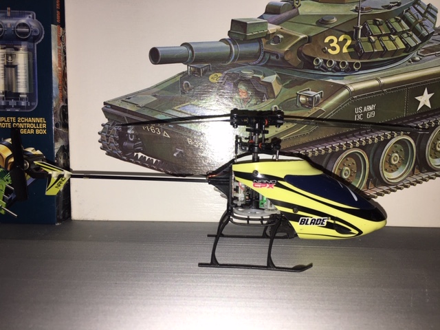

The circuit board in this Heli has a AS3X function that allows for a interesting Tank drive control that includes, Arm\disarm both motors and a precision cruise control in both directions with precision low speed motor control with high response\power output that can be fine tuned for exact speed requirements like emulating scale speed in either direction and more.
Blade Ultra Micro CCP Heli has an excellent 2.4 ghz micro high power circuit board that runs off a 1s lipo that is ideal for small mechanized models.

"Tinning" wires, soldering iron tips and or components before connecting to any other components\circuit boards is a critical soldering skill.
https://www.youtube.com/watch?v=7PWmMxjXwYE
The soldering iron shown here has multiple tips that can be quickly changed. It also has variable temperature control for precise heat control of the tip. It also has a "sleep function" that puts it in a low temp standby mode if not used for a while, this keeps the tips from burning out to soon.
The one shown below has seen a lot of use and works flawlessly every time. This or a similar soldering tool is required for micro soldering.

A most excellent inexpensive soldering tool.

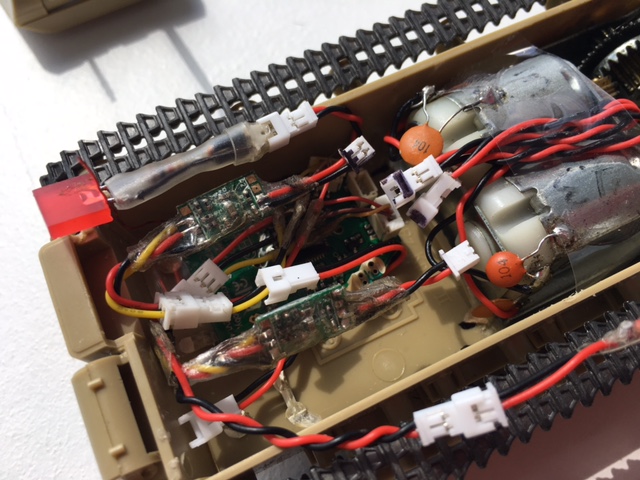

The radio used in this Panzer II is a small and very simple full on\off 2 channel low voltage system (3v) and its output is balanced for 3v motors. I usually start with a simple system like this and as time goes by, and the tanks has proven track performance, I will go to a better fully proportional radio control system

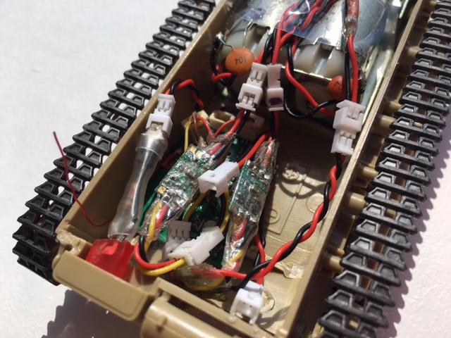

Radio update:
Next I will be installing a new micro DSM2 radio system, This radio is from a UM CCP Heli and will have some interesting features like cruise control and very precise low speed control. I am experimenting with it now in another tank and once I have the TX programming perfected, I will install it in this Panzer II.
Ok I finally got the TX programming figured out and have installed the DSM2 CCP Heli receiver in the Panzer II. It is a tight fit as the PANZER II has very little room for radio gear as well as a battery. This is the tightest tank bay yet that I have worked with.
The new radio setup is the best yet and has some very interesting features.
1. Realistic low speed (scale) proportional operation with programmable throttle decay. This feature is what is lacking in current throttle tech.
2. Gyro stabilization of throttle regulates torque based on load variations (up and down hills) maintains a speed envelope constant.
3. Hands off throttle down slope can be programmed for a few seconds to a few minutes and even a constant "speed control mode" so that tank can move forward or backward hards off at a speed setpoint until throttle stop is activated of decay time is reached.
4. Smooth ramp up\down control of throttle.
I will post pictures and a video asap.

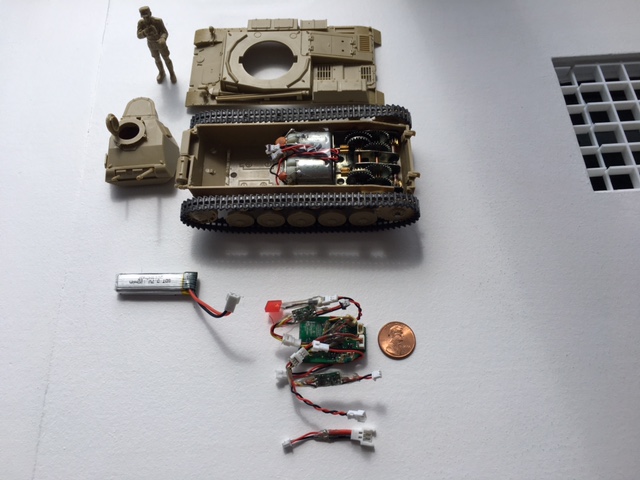

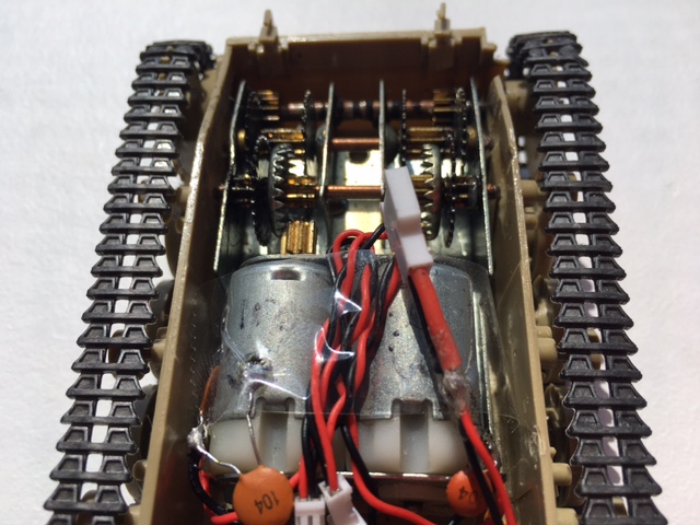

all metal gearbox with upgraded brass pinion gears.

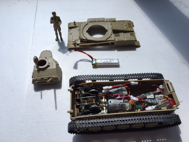

inside view
inside view

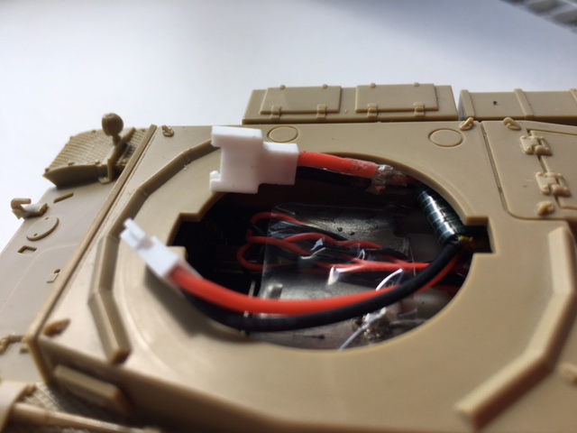

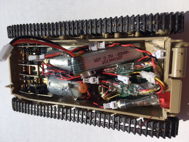

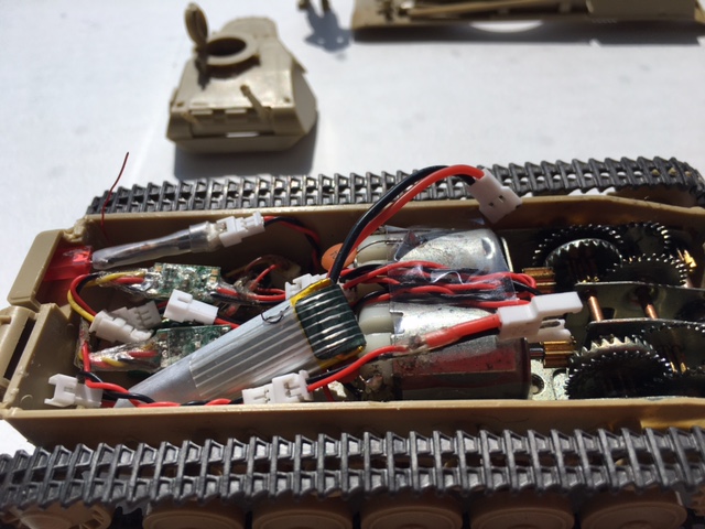

180 mah 1s lipo. The Heli receiver has a lipo LVC (low voltage cut) so no worries about lipo damage from over discharge.
lipo connection for power up. Have not figured out a good on\off switch yet.

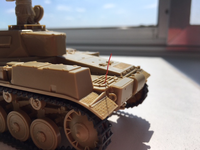

DSM2 Heli antenna is a clue that this is no ordinary radio setup.

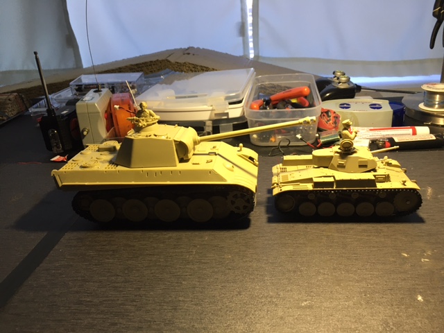

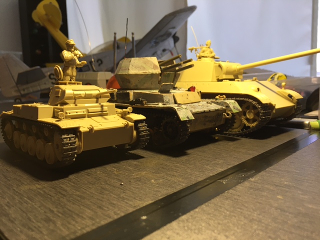

Smallest 1/35 Tank in my collection.
Panzer II, Panzer IV, King Tiger.
King Tiger 1944 shown with the Paner II 1932

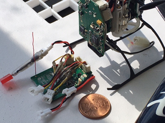

Continued with more info and pictures of Ultra Micro radio setup.

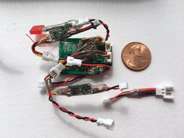

adapter connectors added to receiver to allow twin ESC's to be added.
Heli tank!
Heli tank!

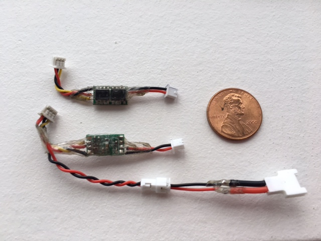

Das micro 1s ESC twin pack upgrade for tank operation.
close up of UM AS3X CCP heli receiver with two externally added ESC's
6 channel gyro stabilised elevator, aileron,pitch, rudder channels.

disconnect 2 motor drive connectors and radio gear is ready to remove.
room for 180 mah 1s lipo.
Oh look, there is even room for a small lipo.
Posts: 6066
Re: Tamiya 1971 1/35 Panzer II F/G >RRC now with video
Thank you for putting the penny in the photos. I kept squinting and blinking, wondering, Am I seeing this right? Are these really that small? I have to wear seven-power glasses to do any modeling nowadays; you must have built-in magnifier eyeballs! Videos will be a hoot to see (if I can see them :) ).

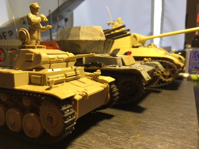

Panzer II with Panzer IV, King Tiger.
