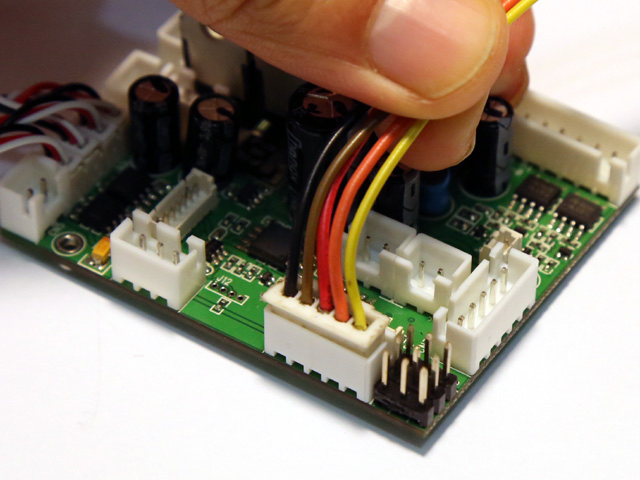

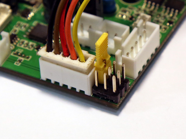

personalization of the tank, just above this photo, look ,the notice of the attached link
http://www.clark-model.com/eng/prod_rx4 ... Correction
switch off, install this in CN 2
place the jumper, and re-power
power on again, make adjustments with Sony, power off again, remove the jumper, power on again, install a servo, and test.

Jim, if you get the incoming round sound and explosion that means you are NOT in programming mode. The jump plug should be in the inner most servo port next to the 5 pin plug. Also you have to have the plug in before you power up the board.
Sorry was offline and didn't reply earlier.

MichaelC wrote: Jim, if you get the incoming round sound and explosion that means you are NOT in programming mode. The jump plug should be in the inner most servo port next to the 5 pin plug. Also you have to have the plug in before you power up the board.
No worries about being offline.
I never could get the jumper to work. The board is in the process of being swapped out with another and this one will go back for repairs.
