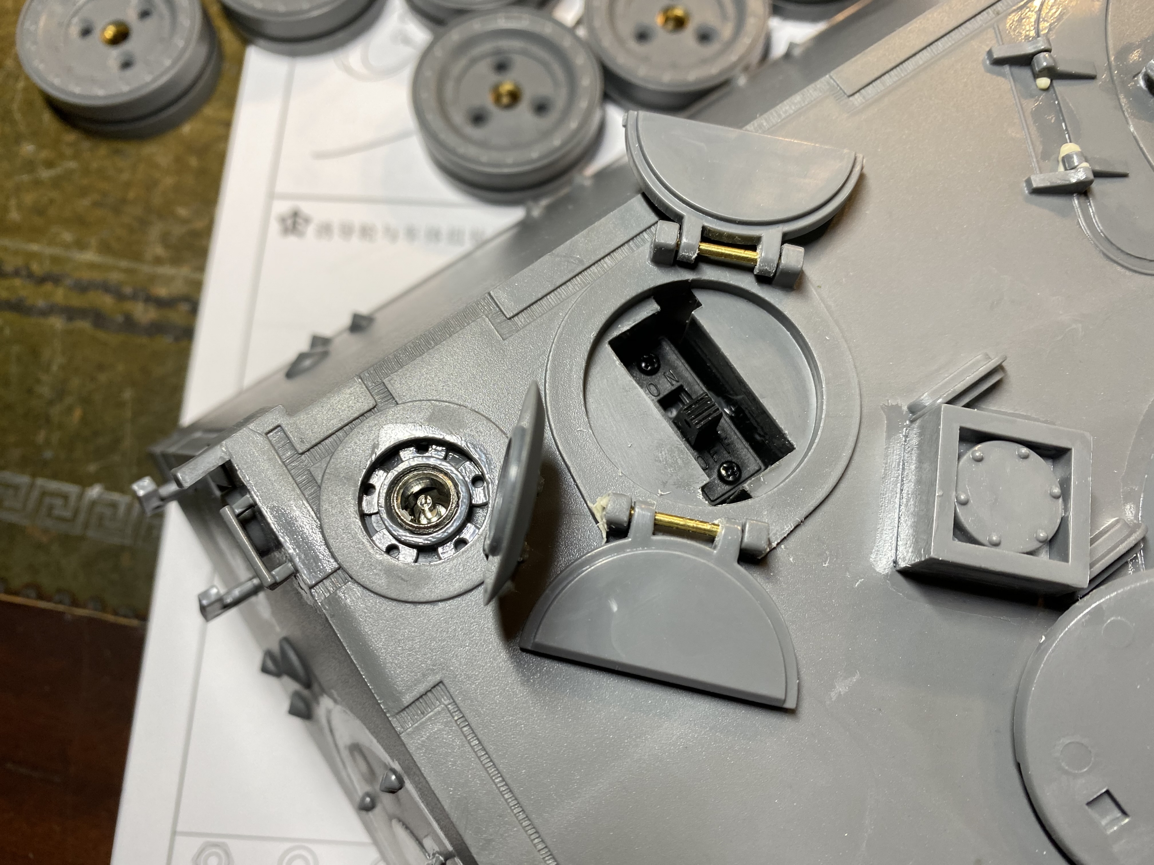

I have added a charging socket as I charge the battery in the tank. It disconnects the controller from the battery when charging so an unwired plug left in the socket disconnects the battery for storage.

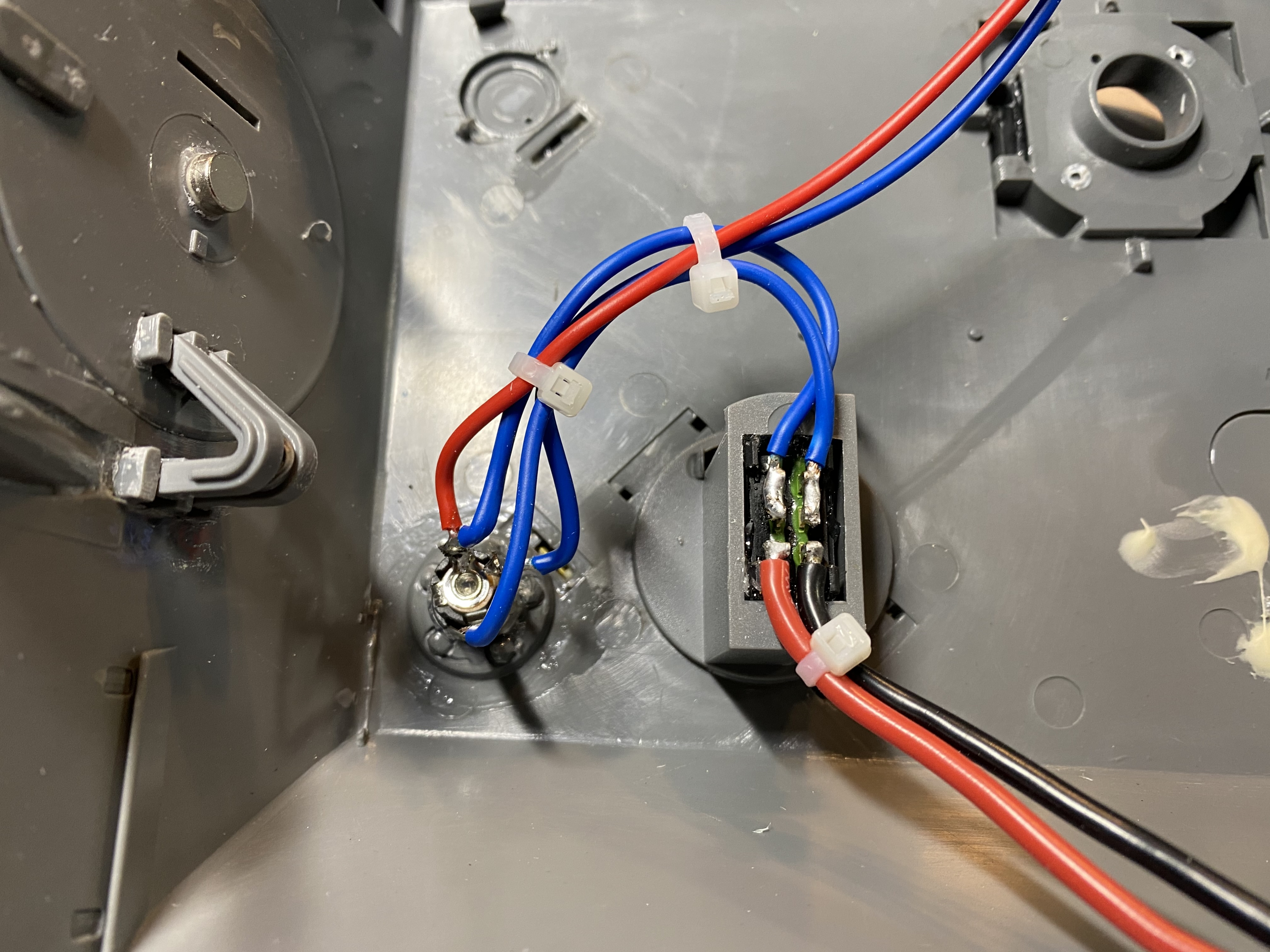

Re: Old dog new tricks
Yes it is not complicated.
I use a standard computer type charging plug and socket.
The centre pin is the +v and it connects to the battery and the VCU
The sleeve is the 0v and on the socket there are two connections that short when there is no plug and open when it is inserted, one of which will be connected to the sleeve of the plug.
You connect the one that is disconnected to the VCU 0v and the one connected to the charge plug to the battery 0v.
I also include a switch to be doubly sure as for instance on the Tamiya system the power switch does not fully disconnect the battery.
I wired one today for the Ferdinand I am building. (NB battery is on the Red/Blue pair)
