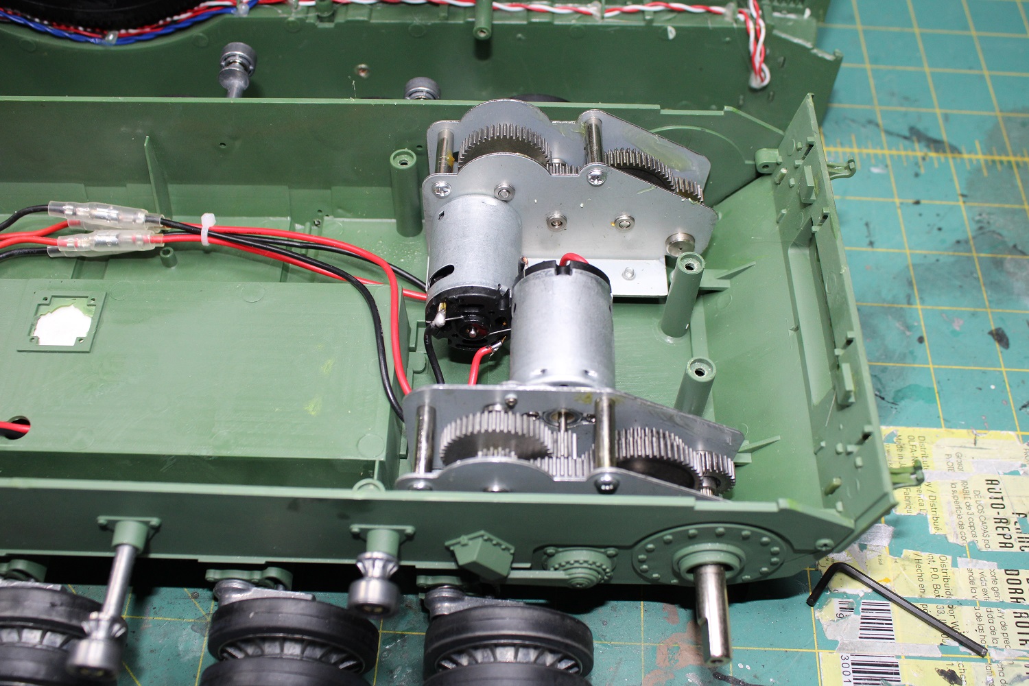

Hi all,
TH sent me the replacement lights and I got the problem solved. But after running the tank for 5 minutes, the tank stops making turns or even moving forward. The sprocket shafts now do not move with the motors so the motors need to be replaced. To be honest I am getting tired of this crap. Same thing happened to my HL Panther G. Very typical of Chinese engineering. Dai

I open the tank and inspect the gears carefully. No broken gears, no falling out shafts. Everything is snug. Every screw is tight everywhere including road wheels, idlers and sprockets. The sprocket shafts turn when motors are on but on the ground, the tank barely moves and cannot do spin. Looks like the motors simply does not have the strength to do anything except freewheeling. The battery is Admiral 7000 mAh fully charged. My guess is one or both motors are bad. Comments please. Dai

Hi
It's really bad luck to have so many failures in such a short time. If you are familiar with the multimeter, take a measurement of the voltage the Engines receives from the MFU ESC when you give it full throttle. Do this first when the tracks are off the ground and the second on the ground. You can put the multimeter in the lower hull and disconnect the upper one while the tests. Then you can check how much current each motor consumes while driving (it should be around 2A). Be careful. You measure the current separately for each of the motors and multimeter must be connected in series with only one wire ( eg. red one ), otherwise you will short the MFU ESC circuit. You can also (FOR A MOMENT) Block the sprocket of each track separately and see what is the max current. It should be around 10A. The safest way to do this is to connect the motor directly to the battery. Be careful to only do this for a while (1 second should be enough).
If the voltage supplied from the ESC of your MFU is correct (with throttle on max it should be the same the battery voltage ) you can try to swap motors from another model and see if there is an improvement. All these measurements to rule out MFU failure if the motors are OK.
