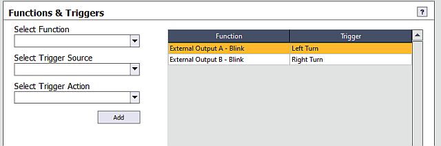

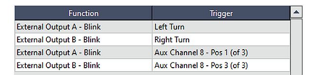

The TCB have this Function.
It is a little bit hidden:
Set this Function Trigger for blink by steering:
for manual blink only asign a switch or for both do it additional:
everything is possible
tankme
Posts: 3253
Location: Elgin, TX
Re: Heng Long ZTZ-99 (Type 98 actually)
Post by tankme »
Hmmm....well I stand corrected, but now that it's all wired I think it will stay the way it is. :) I kinda like the "hazard" lights blinking. I still have two more TCBs for projects so I'm contemplating putting them in my two Tamiya tanks since I really hate the Tamiya joystick/switch/trim setup. I'm also not a fan of how they drive using stock electronics. I did buy the Tamiya TCB conversion wiring kit with my TCBs so it wouldn't be hard to install them. I guess that would be a topic for a different thread.
