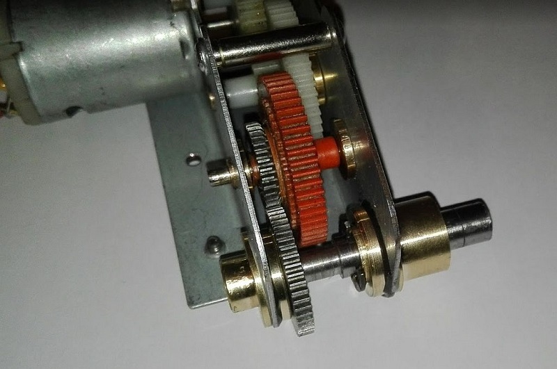

You can have realistic crawling even with stock HL ot Taigen electronics. Gearbox is the key. With proper ratio you got big torque, slow movement and less power consumption. Unfortunately you can't achieve that with stock gearboxes, even with those fancy colored advertised as "pro". Gearbox need to be modified of changed to planetary.
Example - test of stock HL with modified cheap plastic gearbox (last gear modified by my dad):
