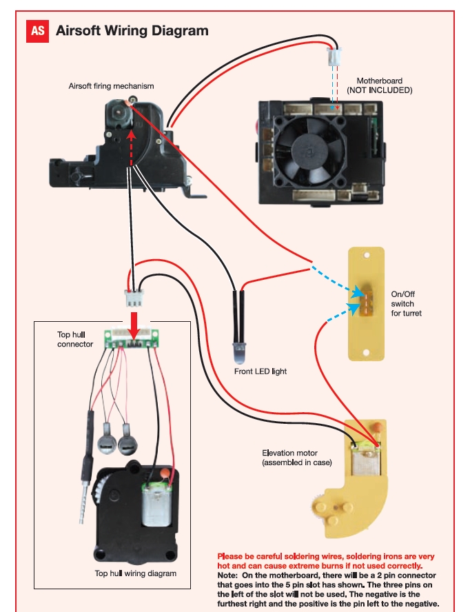

Lastly, this is how Heng Long (and Taigen) Airsoft tanks used to be wired. The elevation motor used to be cycled in a slow, annoying fashion (i.e., you couldn't just elevate and depress the gun directly with the toggle), then Heng Long revised its wiring with the 5.3 models in order to fix the elevation niggle. For Clark board users, it was also necessary to modify the airsoft circuit in order to accommodate
Clark's revised electronics. 'Taigentanks' (Erik of Taigen) posted a video on Youtube about the mod.
This is what the Airsoft circuit looked like when Taigen and Heng Long had pretty identical setups:
Early wiring diagram for Airsoft models
Click on the pic to ENLARGE it.
This is what all that looks like as a complete circuit:
The safety switch has disappeared from later models, as it now requires the user to both the 'A' and 'B' buttons on the transmitter to activate the airsoft gun, making an accidental shot almost impossible.
At the same time, the wire from the Elevation unit has been re-routed. Hope this all helps.
Full wiring diagrams are available for V6.0 series models, but I can't find a detailed one for the earlier 5.3 systems- although 5.3 wiring did include a new 8 Pin connector, which then effectively separated the Elevation and Airsoft circuits.
