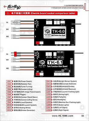

I Think That is a Heng Long TK6.0 board,
Both the TK6.s and The TK6.1s has it written on the front of the board.

jarndice wrote:I Think That is a Heng Long TK6.0 board,
I thought the 6 had a gold label :think:
Posts: 7594
Re: Treated myself to HL Challenger 2
The 6 and the 6.1 are labelled thus.
s-l400 (47).jpg (32.53 KiB) Viewed 1325 times
The one Scott is showing us looks more like a duel sound, or before.
It is possible that the transmitter supplied is the wrong one for the board, but I wouldn't have thought they would have altered the binding circuit through the board upgrades :think: unless the new boards speak a different language.
Scott, did you say the lights flash when you turn the tank on?

Yes the lights flash and you can hear the speaker is live too but it won’t do anything else no matter what I do

I realise that the Chinese grasp of English can produce some interesting results but are all the TK series of Heng Long boards printed with the word Receiver mispelt,
The rule of thumb when dealing on line with a major company is to treat misspellings in official communications as spam so is this a FAKE board or just the Chinese printer mislaying his dictionary ???
