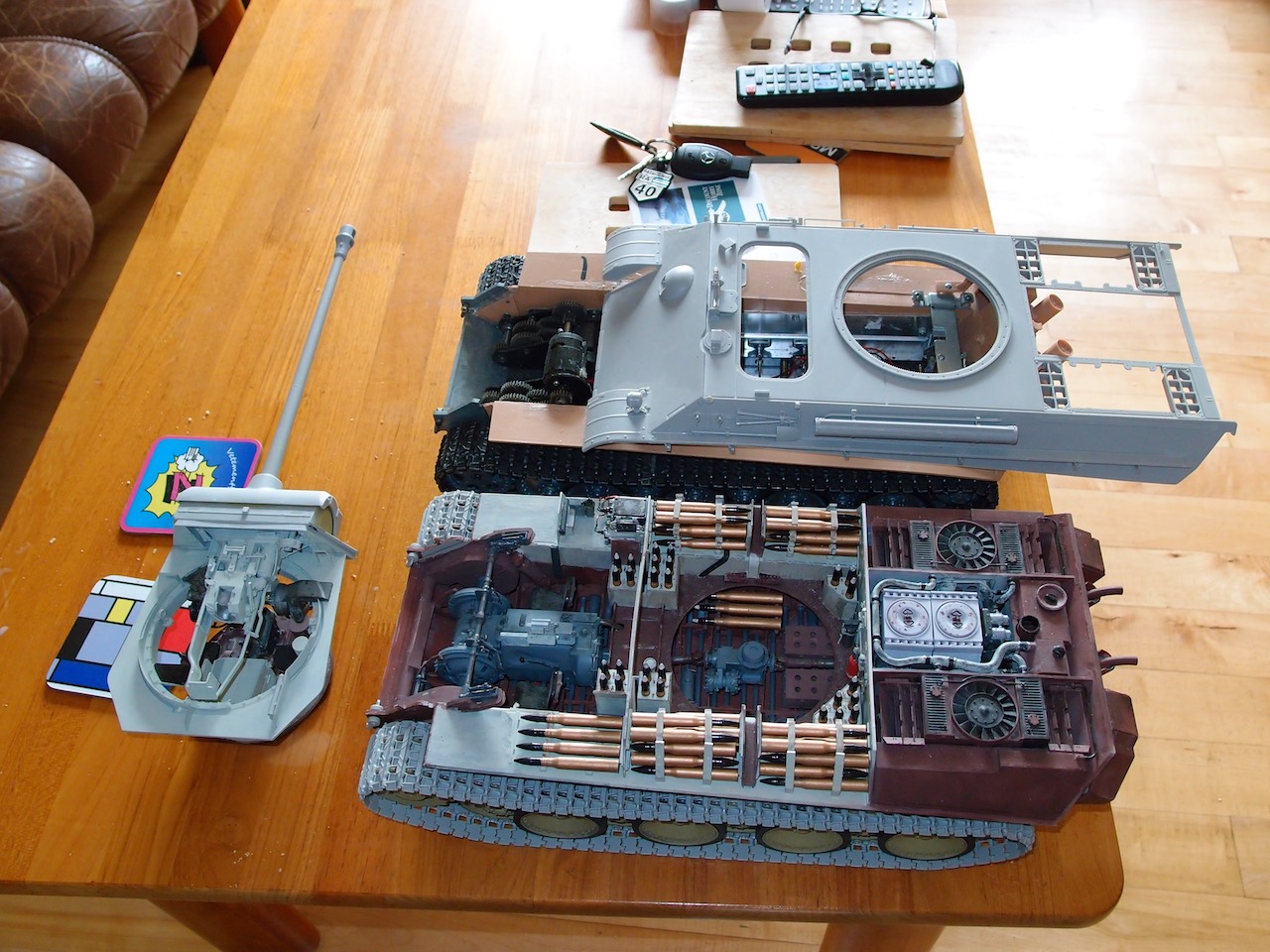

Estnische wrote:That’s great Jon. I’ve always wondered how much of these Trumpeter interiors could be retained in a RC tank. Thinking about a T34.
It would be interesting to try, very difficult though to have both. Take a look at these pics of my King Tiger, not a lot of room in there for a gear box & electronics.
ImageUntitled by jon newsom, on Flickr

Hi Jnewboy Have you tried fitting the Trumpeter KT upper hull onto the HL lower ? Have the Panther and i think its a shame to hide the interior. The taigen lower is about 5 mm shorter ( easy to adjust by changing the angle of the rear plate ) but the Trumpeter upper is really nice./
Styrene panels on inside of the Trumpeter upper and it should be strong enough for rc.

ronnie42 wrote:Hi Jnewboy Have you tried fitting the Trumpeter KT upper hull onto the HL lower ? Have the Panther and i think its a shame to hide the interior. The taigen lower is about 5 mm shorter ( easy to adjust by changing the angle of the rear plate ) but the Trumpeter upper is really nice./
Its a cool idea but they dont line up exactly. I would like to take a Trumpeter KingTiger and put a gearbox in it with all the interior detail, then hide all the rest of the electronics in the rear maybe? You would have to not build the engine and hollow it all out. I guess the main point of this build is to show that with some patience, skill and time you can bring a HengLong up to the quality of a Trumpeter or at least very close but of course it requires completely replacing parts like the gun mantlet, its the same sort of thing as the Henglong Jagdpanther, swap some parts out with Tamiya parts and it looks great... maybe thats cheating? :D
