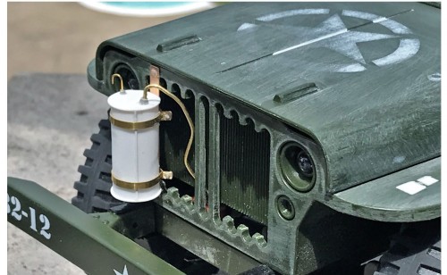

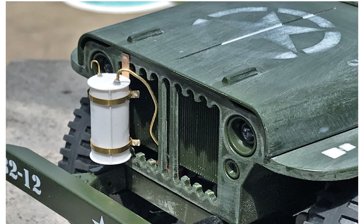

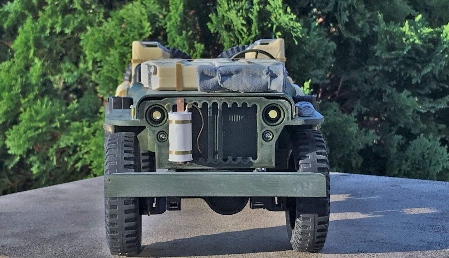

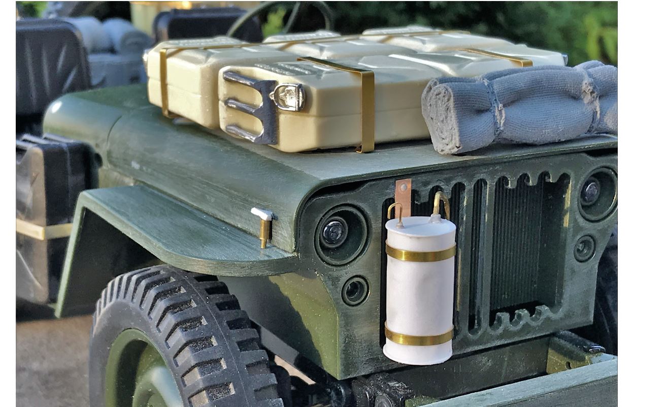

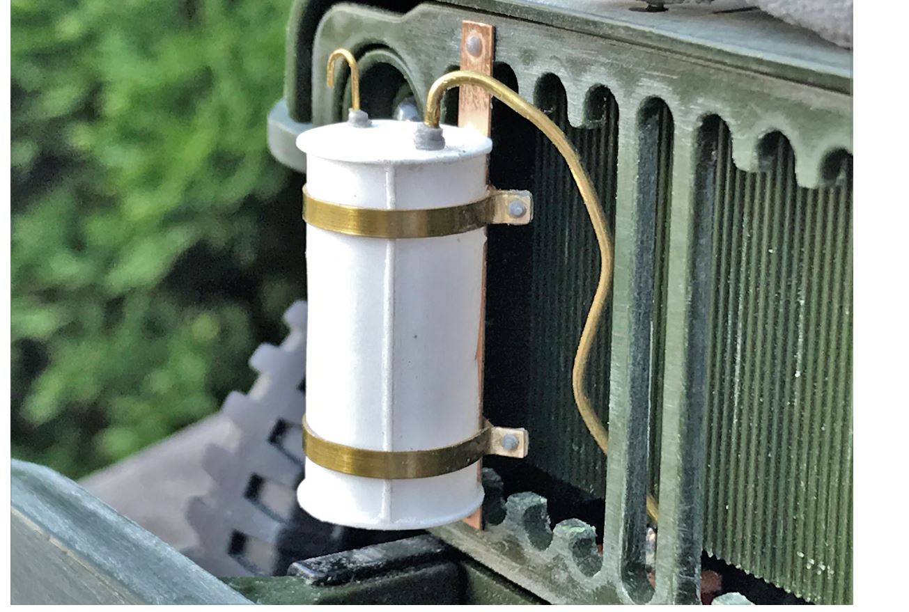

The container used for the condenser show variations in position and size. What is consistent are the seams (top, bottom and across), 2 brackets around the container top and bottom, mounting on the left side of the engine grill and a tube going loosely into the area of the bottom of the radiator.
1/10 RC Jeep Willys MB - Long Range Desert Group - Build

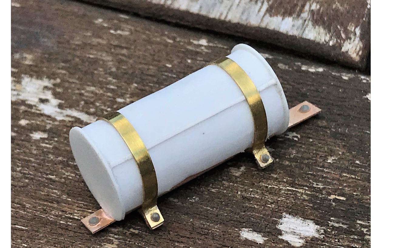

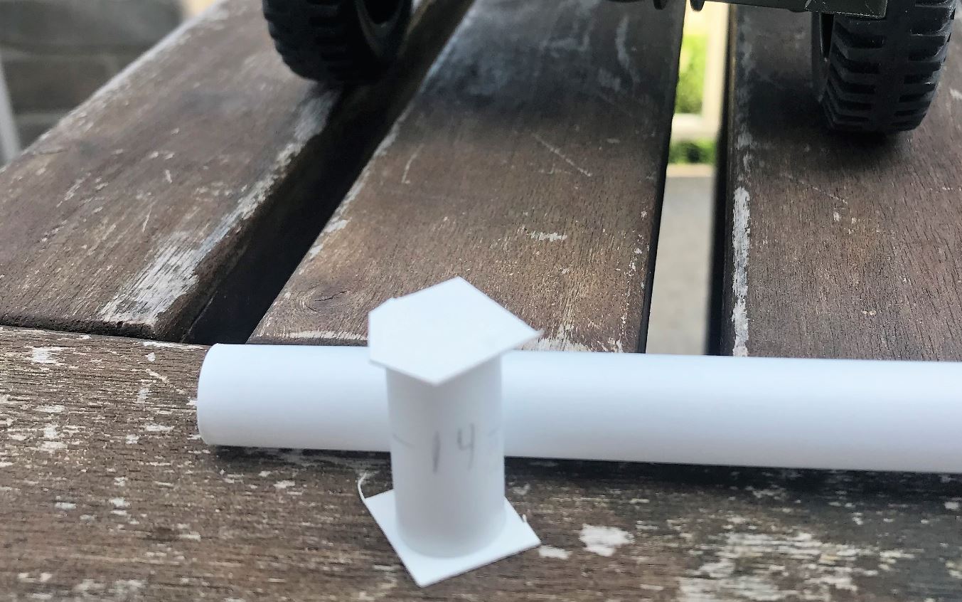

I selected a 14mm diameter plasticard tube for the condenser (the smaller version) but i think a tube up to 16mm would be realistic.

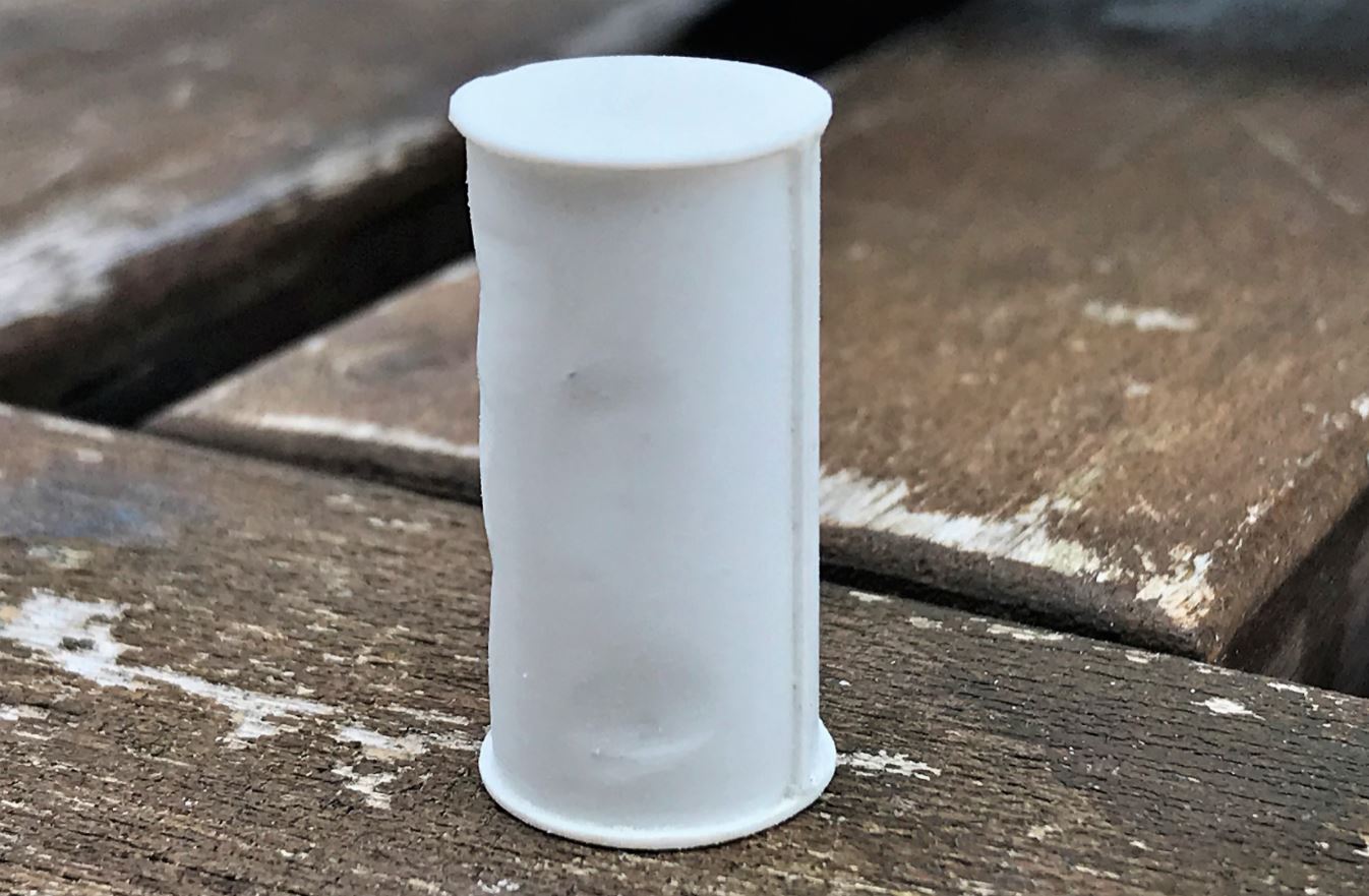

Seams are created and some typical embossed damage is done.
Mounting brackets are done in brass.
And mounted on the left side of the radiator. Notice that the Jeep front grill bars can be easily cut for a realistic representation. I am grateful that the model included a realistic radiator part in the background.

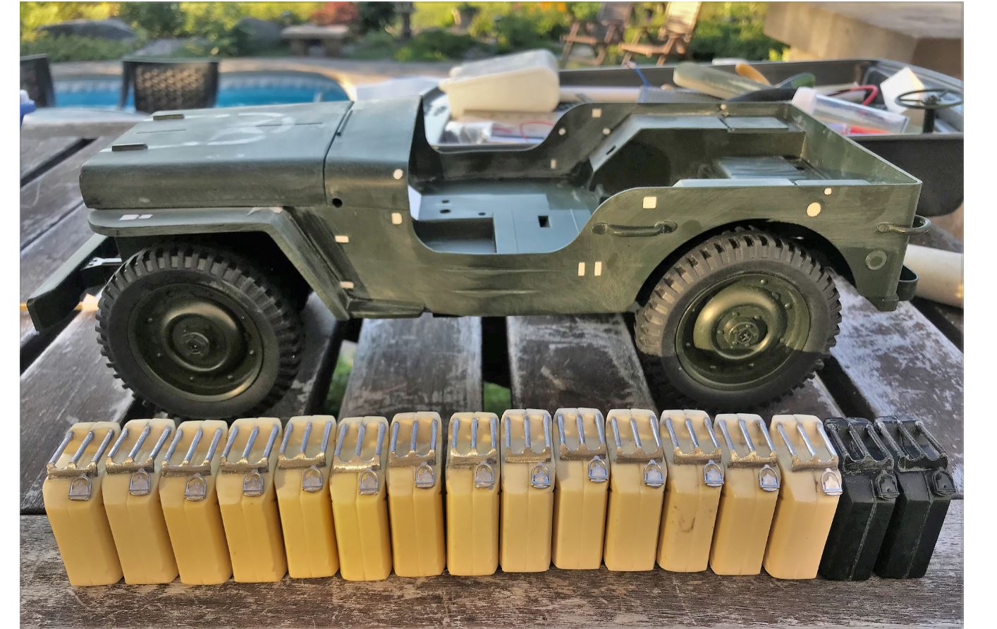

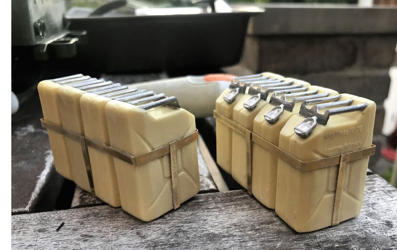

A total of sixteen 1/10 scale German Jerrycans (the Jerries' can, captured in Benghazi) were purchased on eBay Germany and Czech republic, and assembled. They end up costing more than the RC vehicle itself...

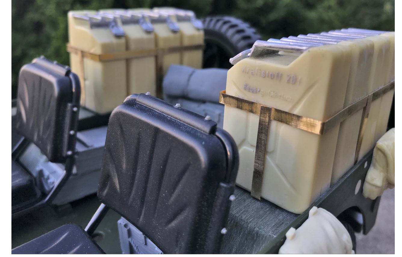

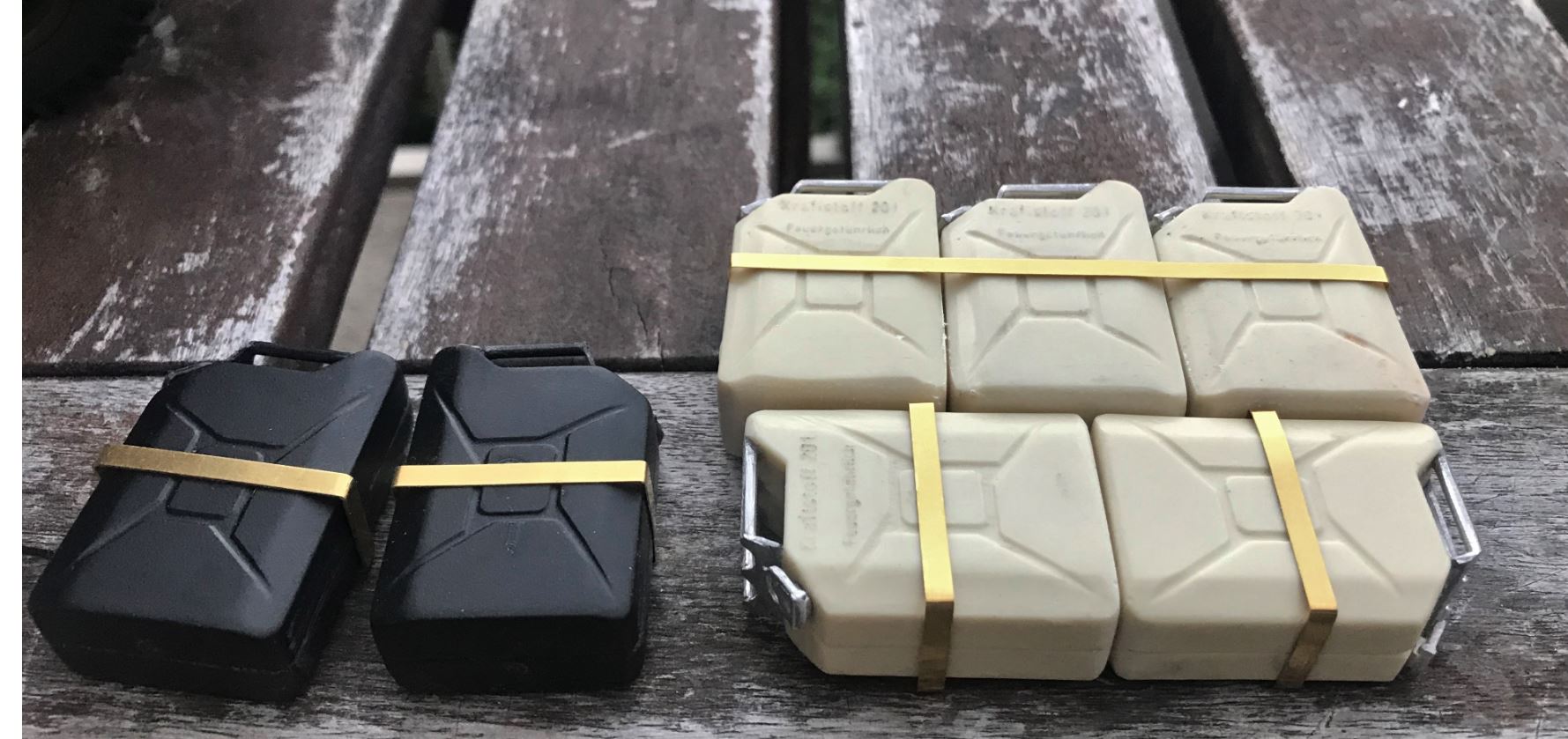

The modules are prepared for installation, with holders in brass strips.

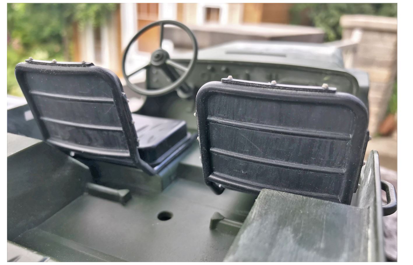

The seats are pretty good. Just need some cleanup of the seams on the mounts and the ejection pins at the back, and the addition of the attachment points for the seat fabric. Noticed the pre-drilled hole on the floor for the machine gun mount. I assume the designer originally wanted the Jeep to be armed but they ended up plugging the hole with a plastic part.

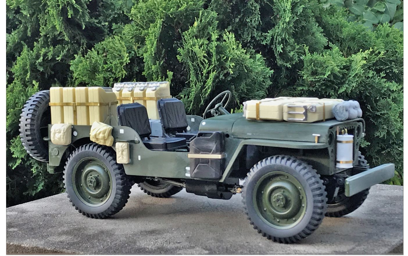

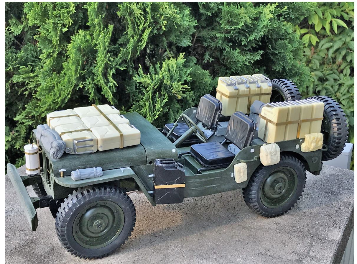

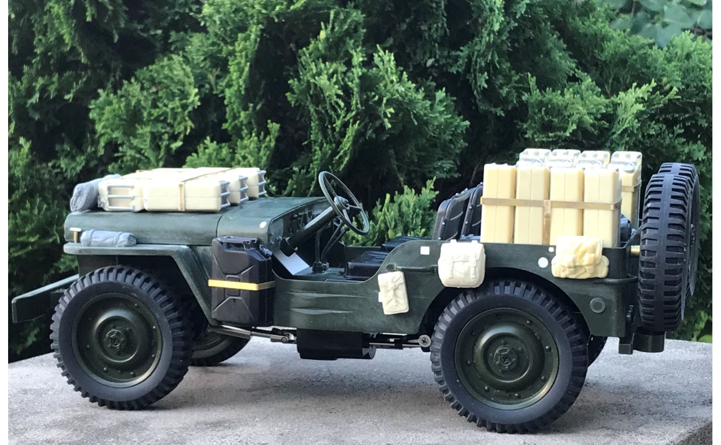

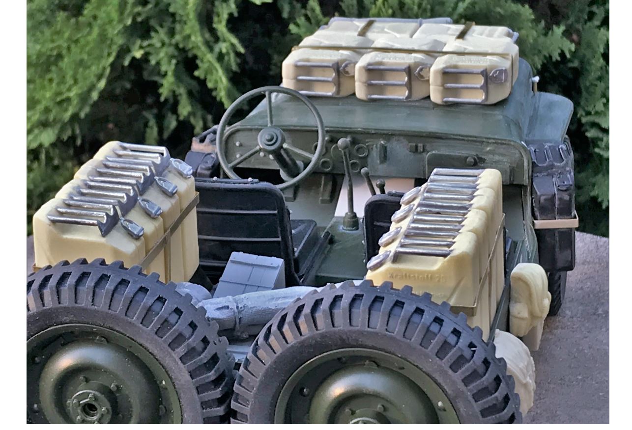

Overview of the vehicle with Jerrycans and some other equipment mounted, minus the armament.

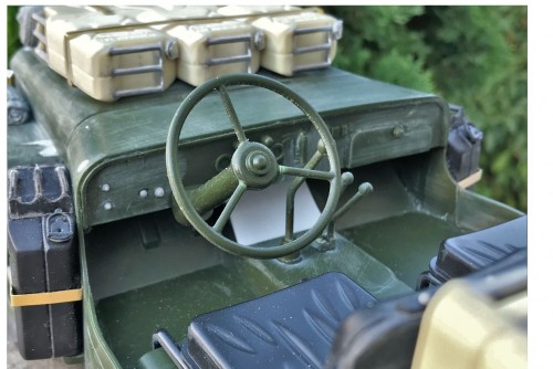

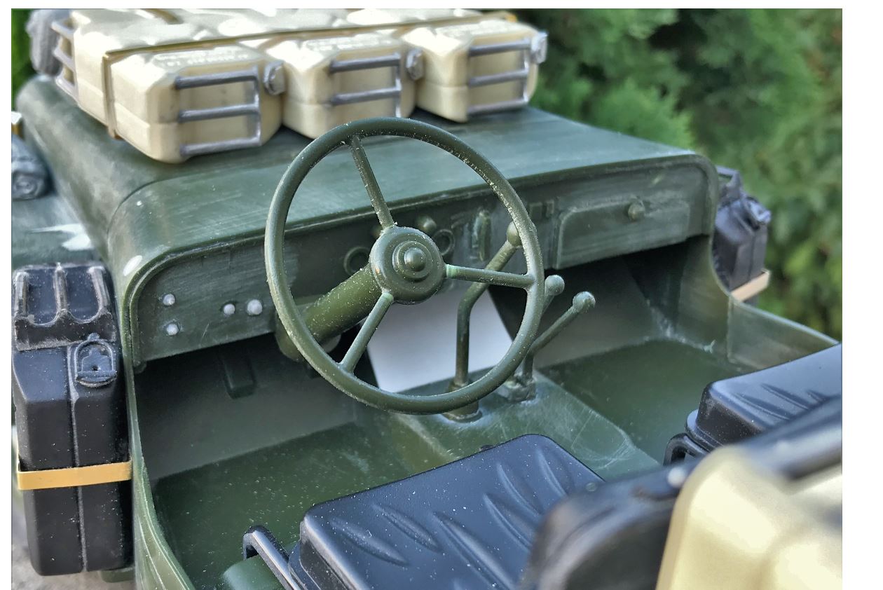

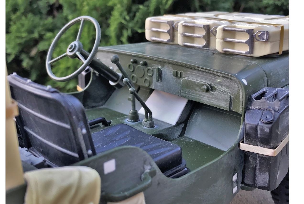

The dashboard need to be cleaned up and reworked a bit, including removal of the windshield brackets, glove compartment made flat, some features added on the left of the wheel but the layout and position of the dials are really good. The driving wheel bar is way too thick but i decided to leave it for now. Making it thinner would make it weak and easily break.
