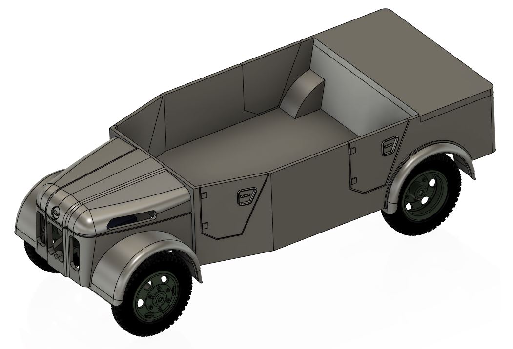

Tiger6
Posts: 1479
Re: M3 Scout car
Post by Tiger6 »
Steyr 1500A.JPG (67.43 KiB) Viewed 776 times
Probably be Christmas before this one is done...

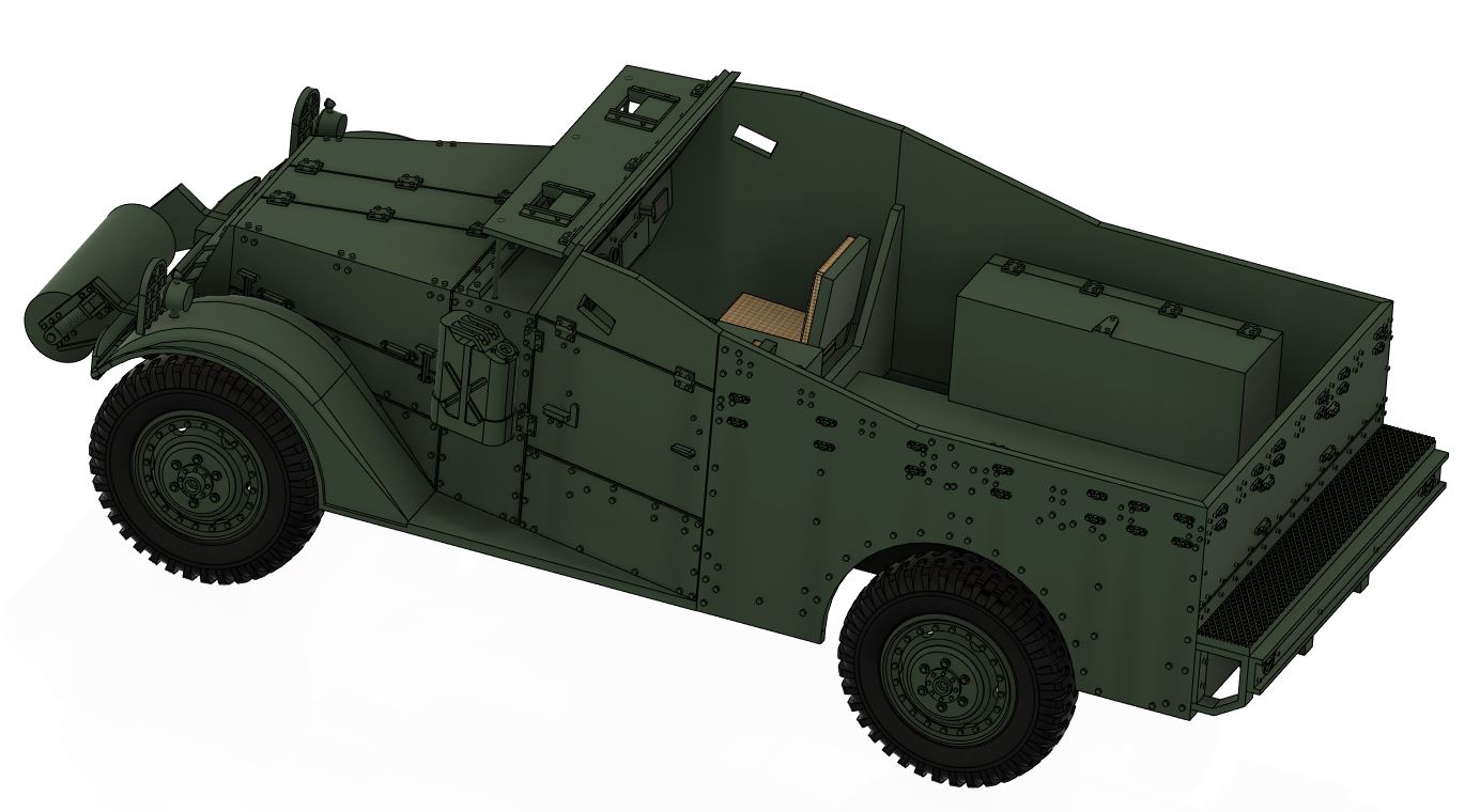

Tiger6
Posts: 1479
Re: M3 Scout car
Post by Tiger6 »
Going to have to call this one done and get back on with the day job tomorrow...
Will01Capri
Posts: 2709
Location: South Scotland
Re: M3 Scout car
Post by Will01Capri »
That is beautiful. Very well done. That will be great
