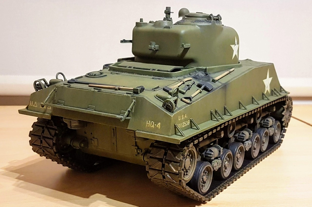

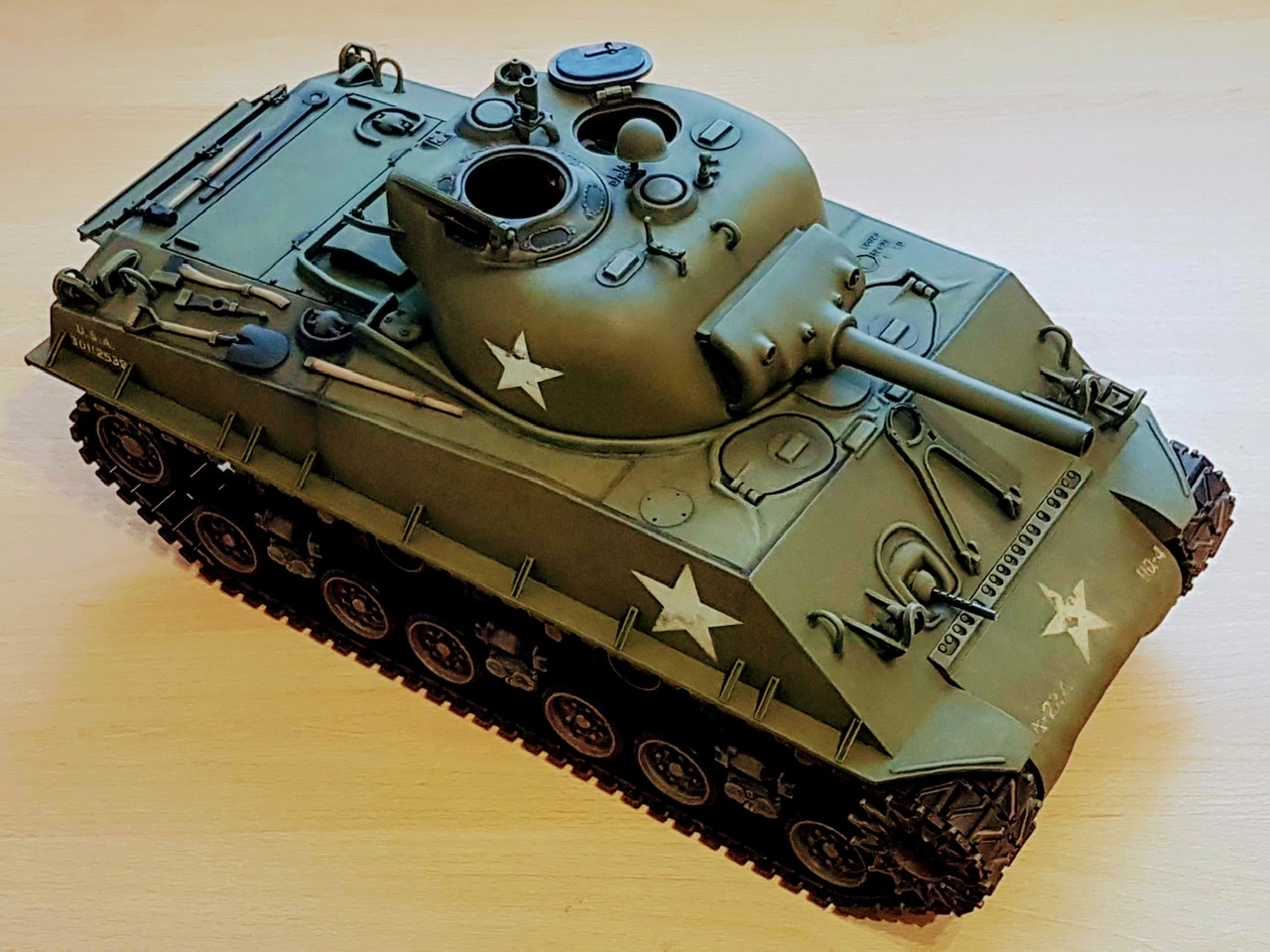

Thanks for putting up the video on gearbox’s Gary, I’ve a few tanks, I’m just finishing a complete rebuild on a Tamiya 1/16 full option Sherman that I purchased some time ago as a none runner, then I hope to make a start on the Panzer III, I’ll keep you posted.

That's the lower hull I need for an E8. Looks good.
