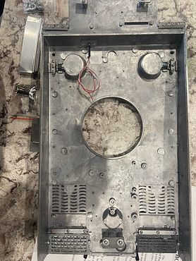

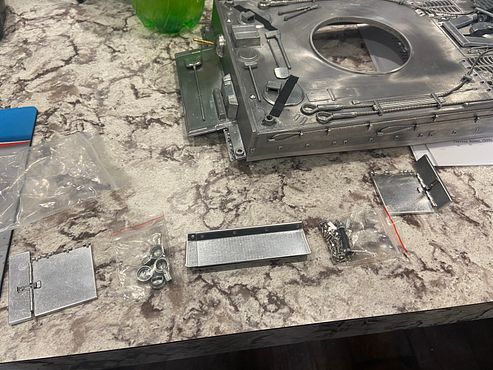

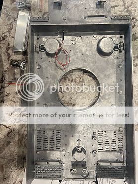

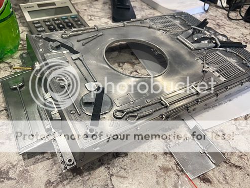

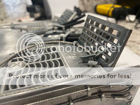

The new upper came in. I am going to start a new build log in 'other builds', but here are some teaser pics.
