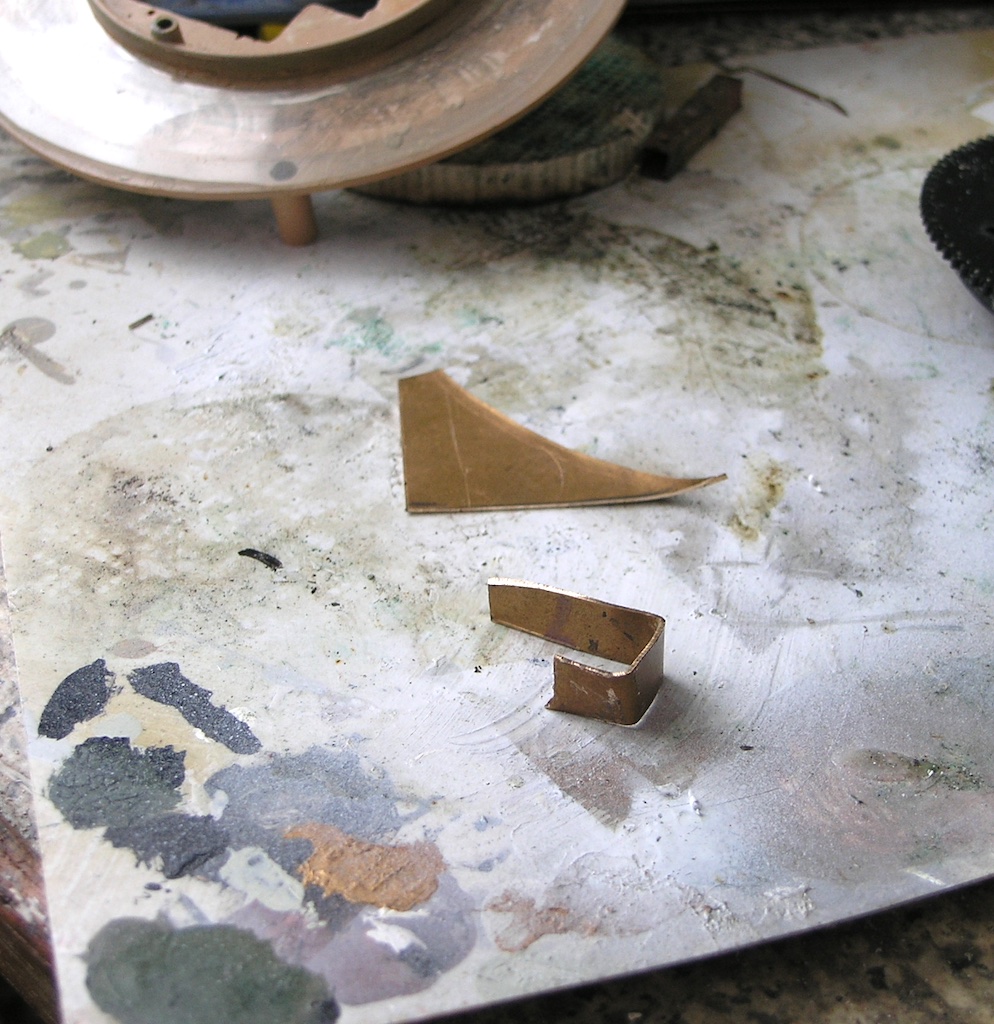

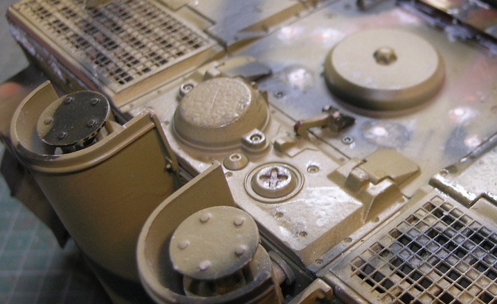

Mid/late have this on the rear deck a triangular plate, another fix required.
Fixing the rear panel on the engine deck from early to a mid . Another little problem sorted out.
For a mid or late the filler cover has to go and the retaining latch moves over to the right.
Removed the detail thats wrong.
Panel and retaining latch fitted.
View along engine deck, the rear of the air intake should be enclosed. May fix it with plasticard.

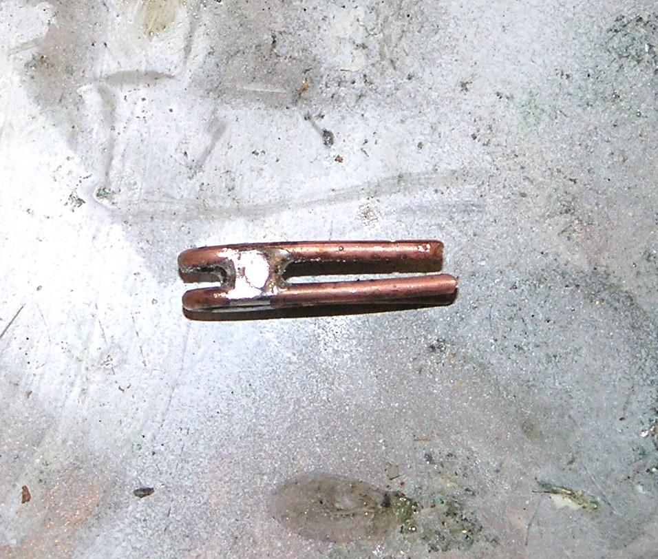

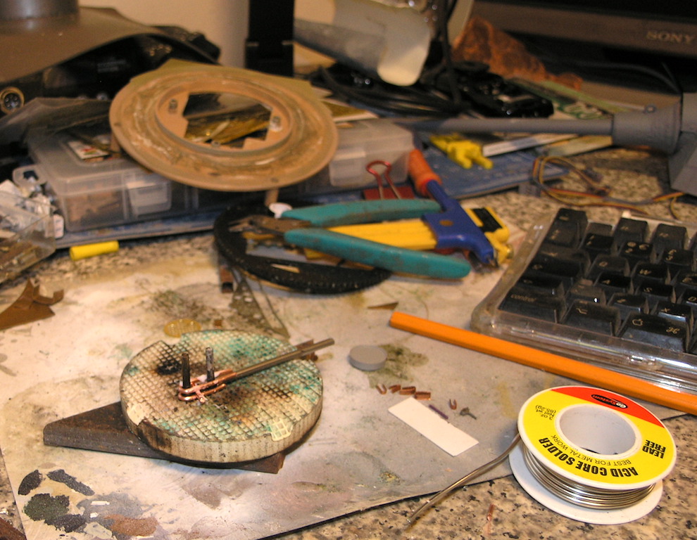

Fixing the tow hitch or lack of it , easy job bend 2 wires into u shape and a wire across . Pics show the way to do it better.
Tow hitch set up for solder
Cut brace wire and file flush ,side view.
Top view ,some filler and 4 holes thro rear hull to fix.

Whilst I applaud the handmade tow hitch it does not look anything like the prototype,
An accurate facsimile can be purchased from http://www.rctank.de/
