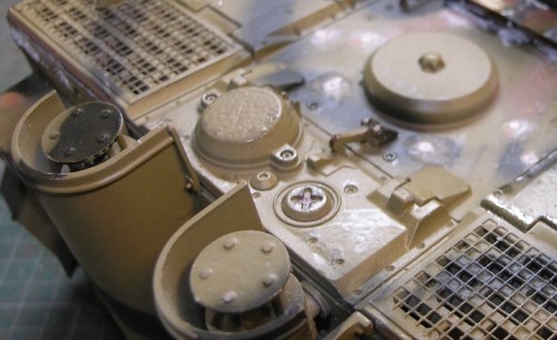

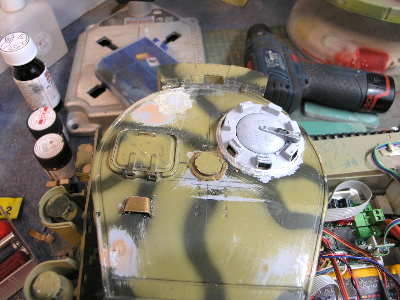

Turret done cover for fan with PE and the loaders periscope guard.
Loaders guard brass
Loaders guard brass
Fan and loaders periscope guard fitted.

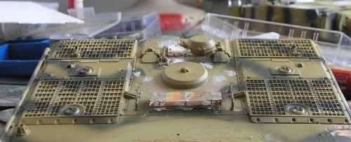

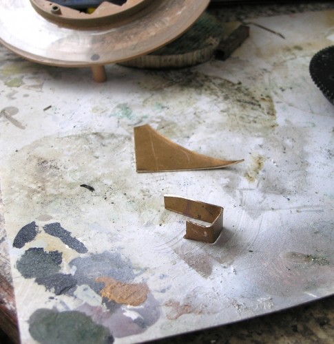

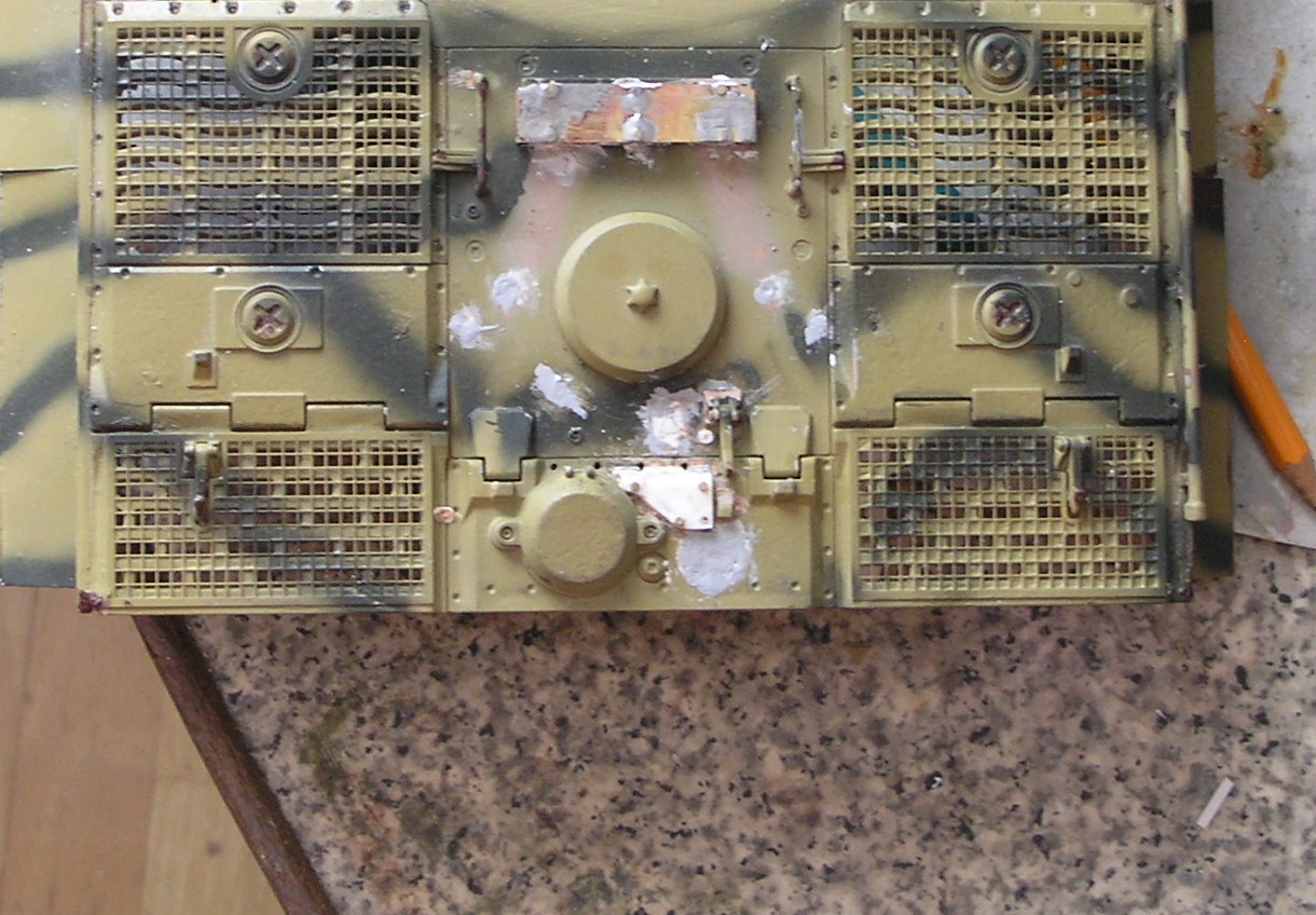

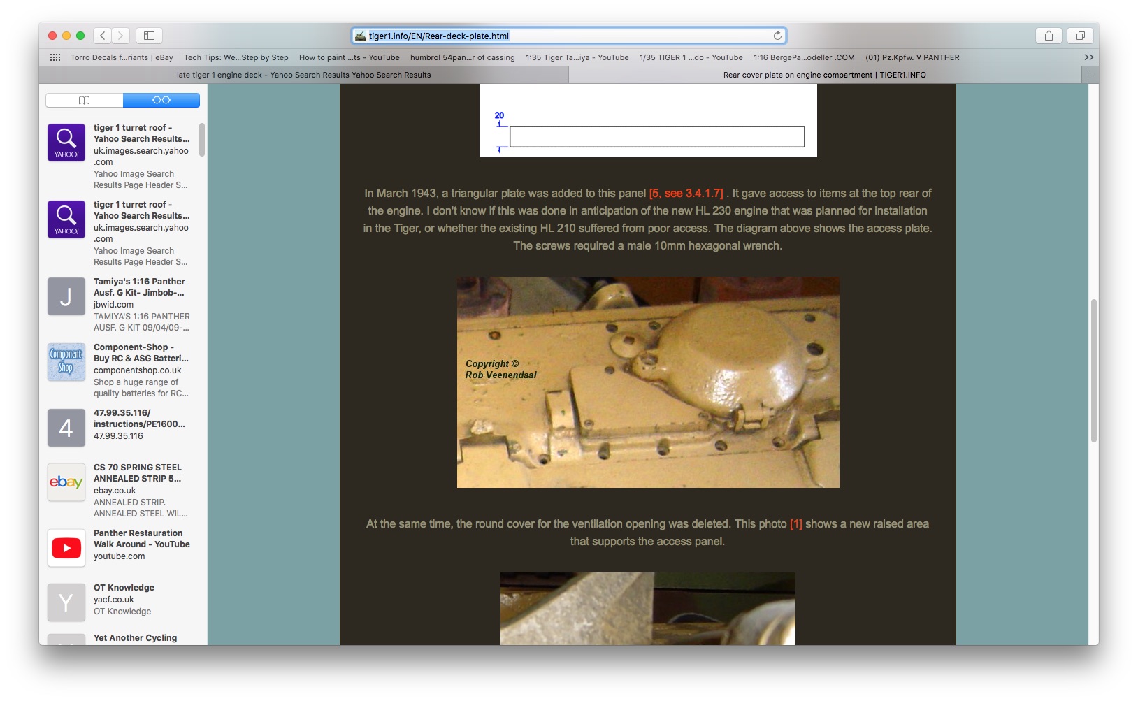

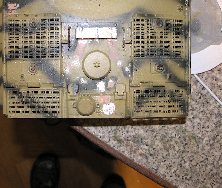

Mid/late have this on the rear deck a triangular plate, another fix required.

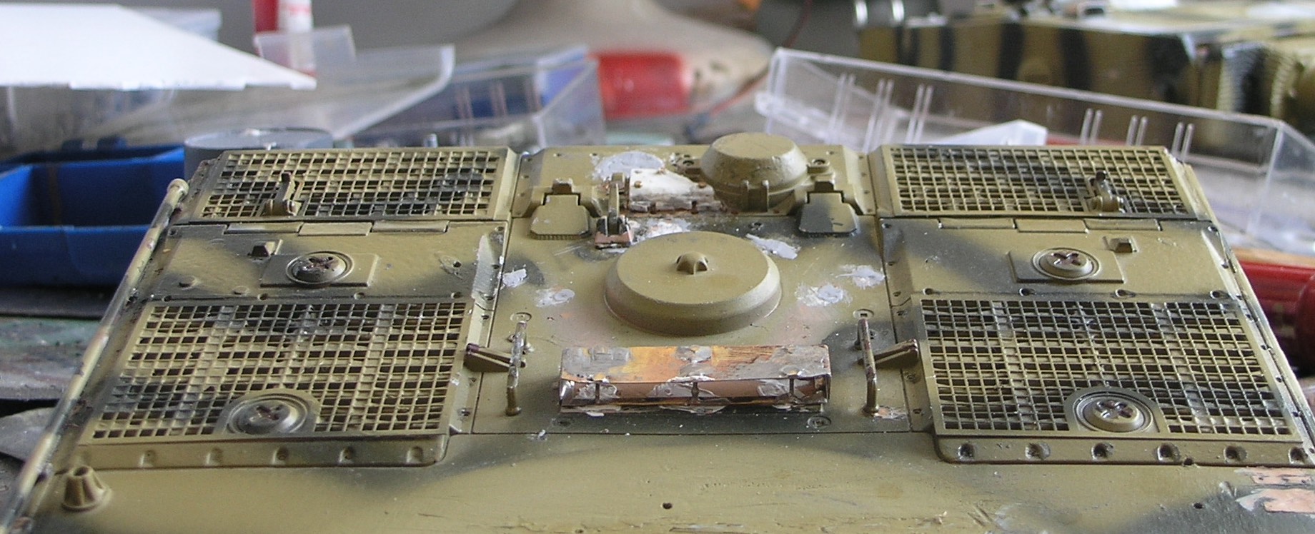

Fixing the rear panel on the engine deck from early to a mid . Another little problem sorted out.
For a mid or late the filler cover has to go and the retaining latch moves over to the right.
Removed the detail thats wrong.
Panel and retaining latch fitted.
View along engine deck, the rear of the air intake should be enclosed. May fix it with plasticard.

DKLM used to sell the filler caps in metal and I spent far too long pin vicing out the plastic/abs blanks and tapping a thread for the replacements,
A side advantage was the opportunity by the judicious rerouting of the plumbing to use the DKLM filler caps as a means to refill the smoker without having to separate the tank body from the hull and with the battery charger socket built into the rear panel of my Tigers via the inertial starter plate I rarely have the need to open my Tigers at all.

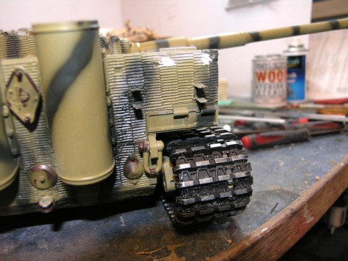

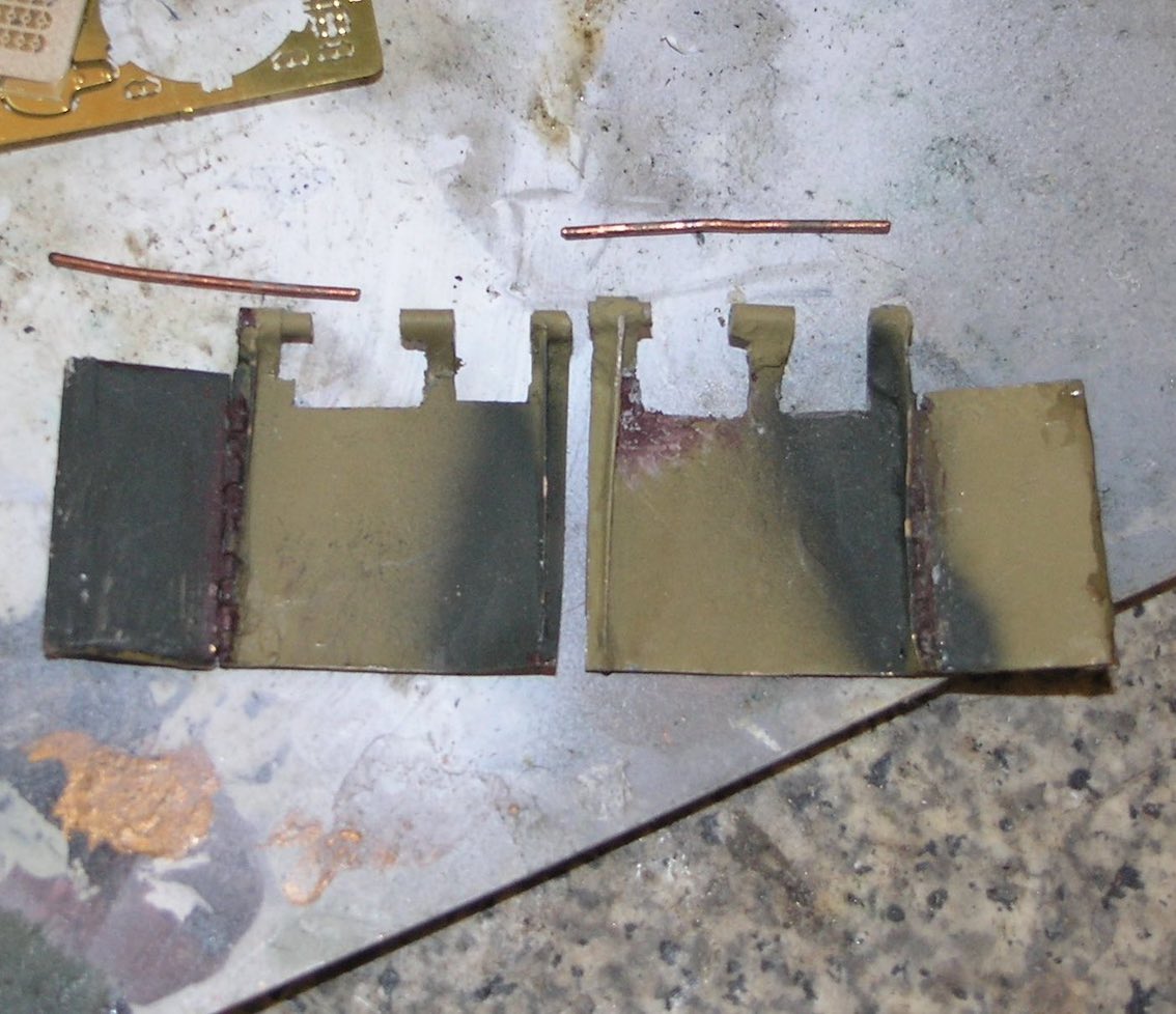

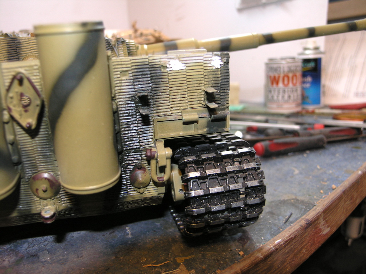

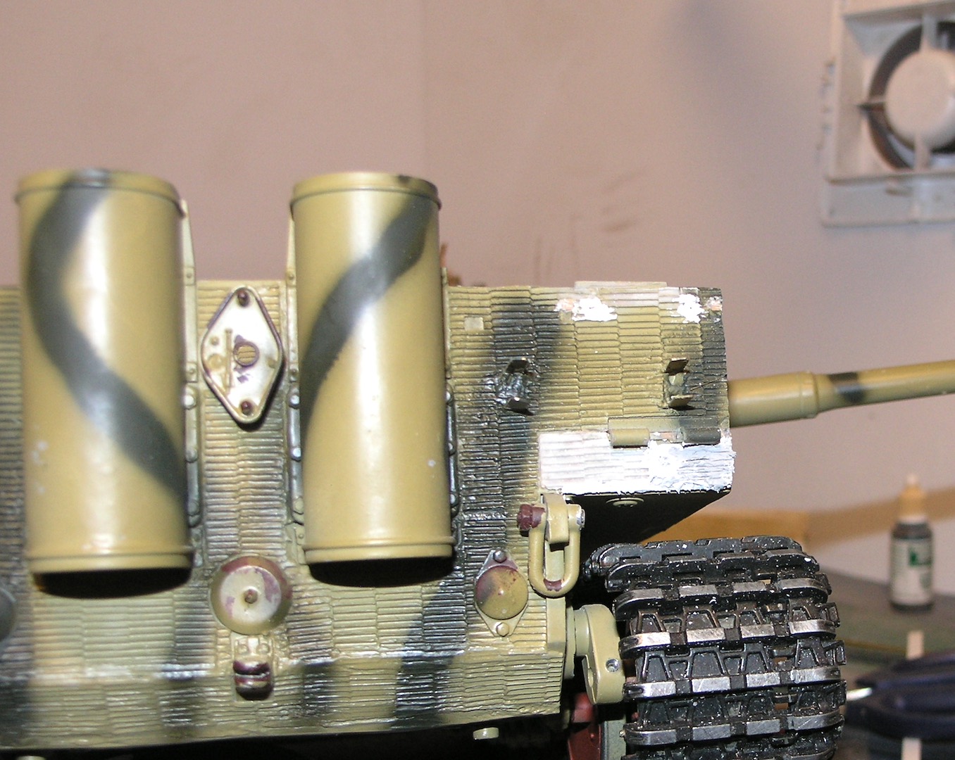

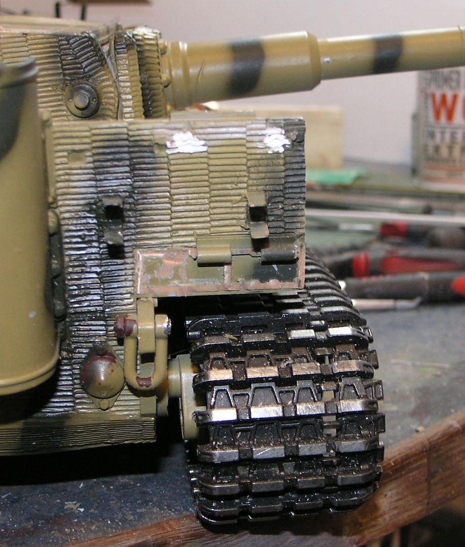

Another fix the mudguards and the frame holding them.
Getting the cutout rectangular no notches.
The frames for the mudguard were deleted, just welded onto rear hull.
Removed
Removed
Some spare Atak zimmermit and AK putty.
Job done and a view of beefed up mudguard in brass.

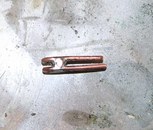

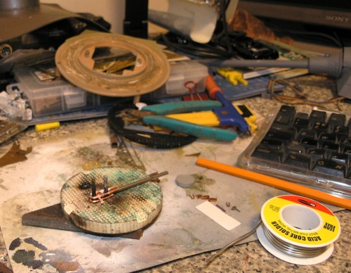

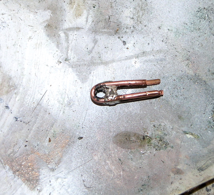

Fixing the tow hitch or lack of it , easy job bend 2 wires into u shape and a wire across . Pics show the way to do it better.
Tow hitch set up for solder
Cut brace wire and file flush ,side view.
Top view ,some filler and 4 holes thro rear hull to fix.

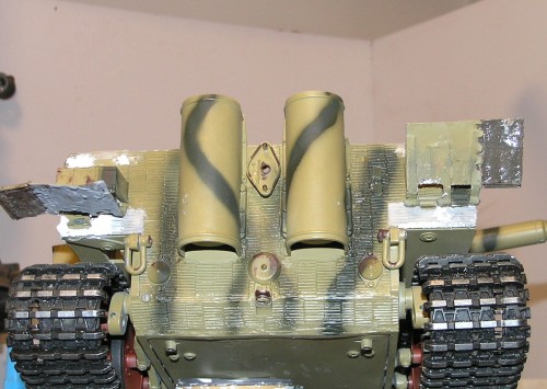

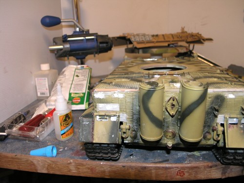

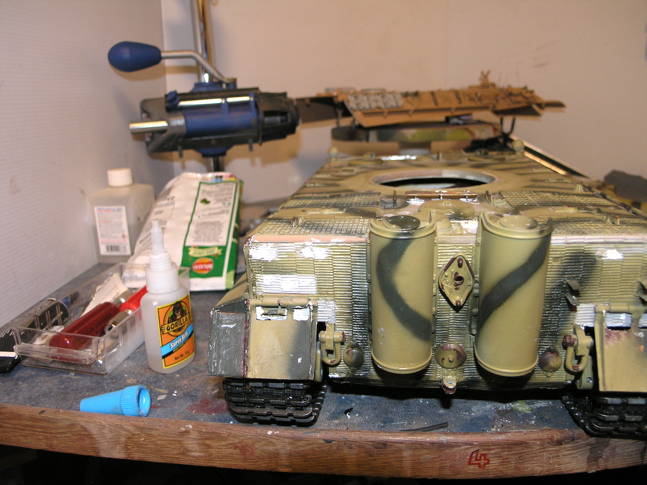

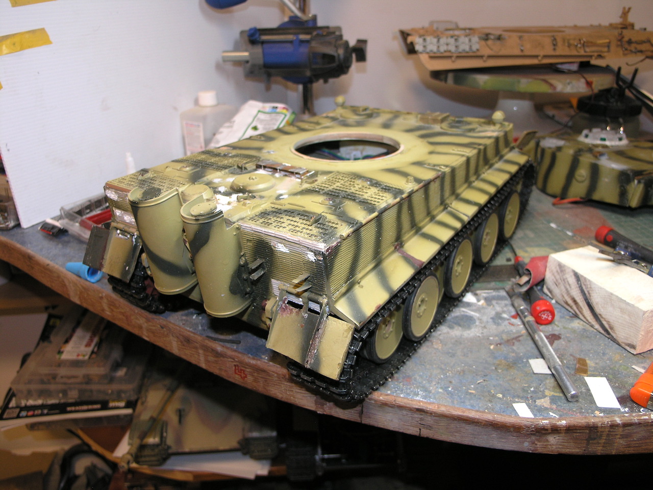

Trying to hide the rear hull joint . Another little error from HL rear plate should sit flush with rear deck, some zimmermit to hide the joint.
Looks bad when the air filters are gone
With paint it should blend in and hide the joint.
Posts: 8425
Re: Torro/Taigen kit Tiger
Another way to hide the rear plate join is to remove a 2mm strip along the length of the rear body and add a 2mm strip to the whole length of the top of the rear plate.
Judicious use of "Green Putty" and a little work with "Wet & Dry" will make the addition to the rear plate invisible.

Whilst I applaud the handmade tow hitch it does not look anything like the prototype,
An accurate facsimile can be purchased from http://www.rctank.de/
