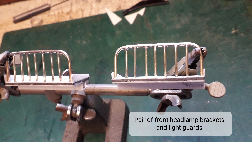

A bit more done, soldered up some brass headlamp guards and fitted to headlamp brackets.

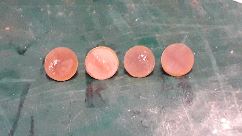

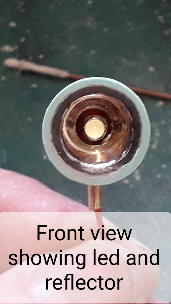

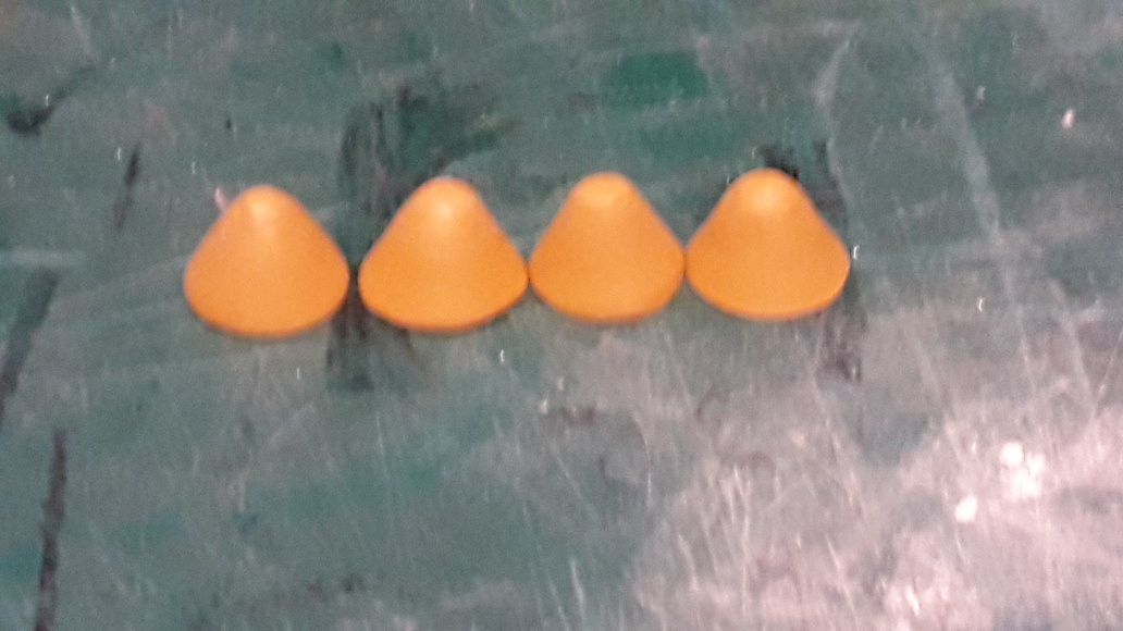

So i decided to make the headlamp shells from resin (easier to machine)
Here's 4 headlamp shells made from a Home made mold there from polyester resin, i painted them in primer to see any imperfections but didnt think they came out too bad, so now onto hollowing the inside out to fit an LED and make a reflector prior to thinking about the lense.

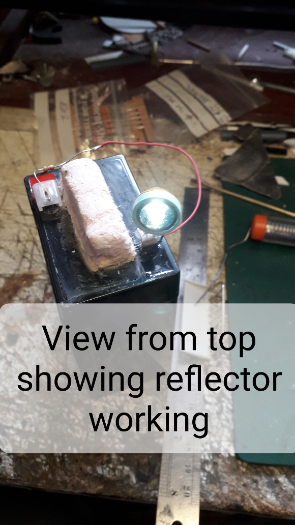

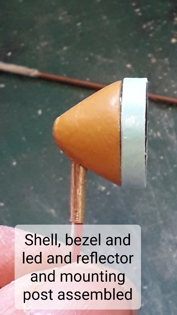

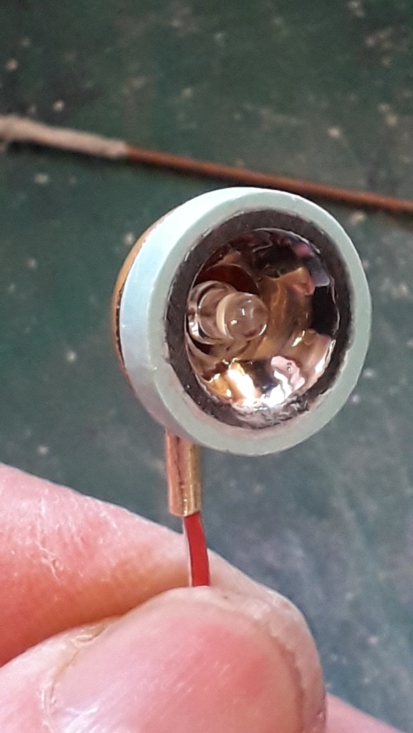

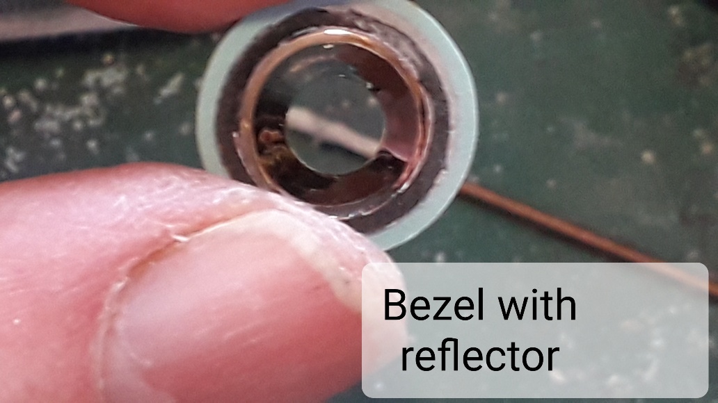

Headlight build up.

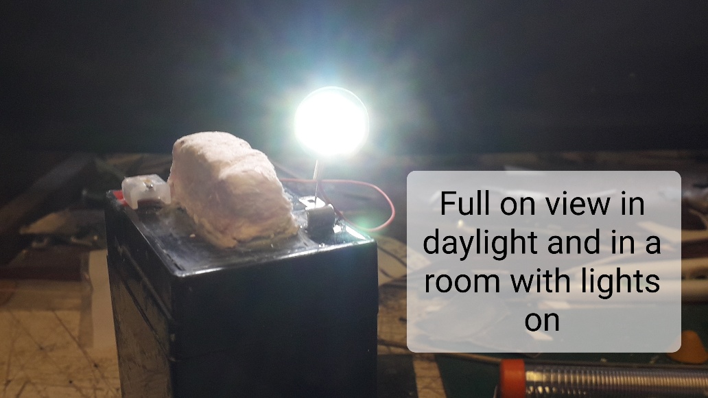

BEWARE, STRONG LIGHT IN NEXT PICS.

With four of these i should be able to operate the model in pitch darkness. :haha:
This was taken in daylight and in a room with the lights on....
You cannot look directly at it without having spots in your eyes afterwards, and all at 3.3volts
Sub.

The LEDS are 3mm ultrabights, from component-shop 0.30p each.
I made the rest.
