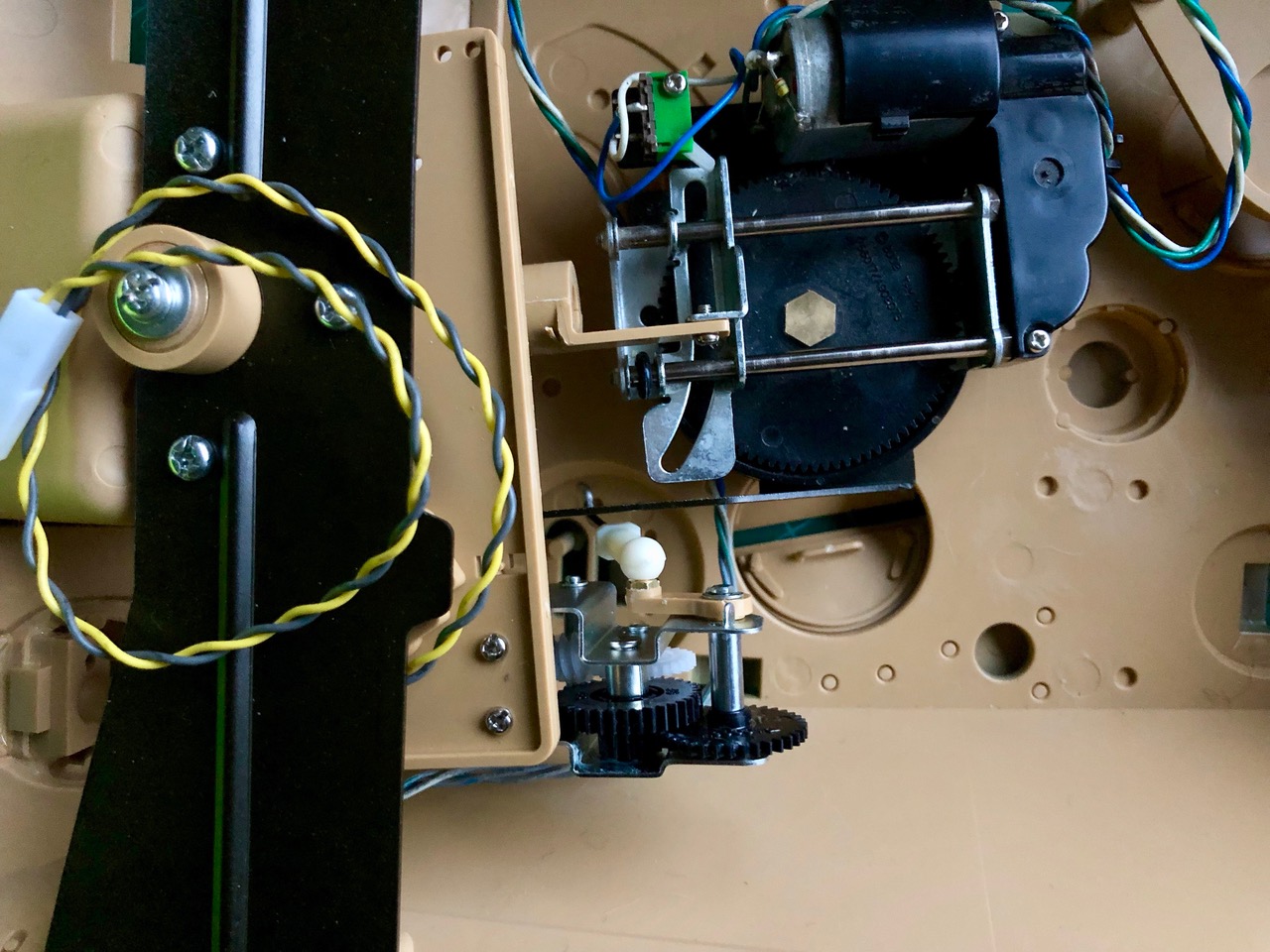

Now that the relatively inexpensive extras (below) have arrived from Axels and Rad, I can begin kitting the Upper Hull out.
Curiously, the Jagdpanther uses two elevation motors. One is for gun rotation, and the other- obviously- for gun elevation. :)
Tamiya JP-Elevation and Recoil motors fitted
Next, the rotation motor goes in- and it's something of a tricky fit for those with gherkin fingers (that also creak :/ )
I still need to source the two return springs needed for the elevation and rotation motors; but after this parts binge, the upper hull is pretty well complete. I have both DMD units (bought at sale prices), and so the build is going well under the budget I would have needed for the Full-option version. :think: :)
So far, so good. :thumbup:

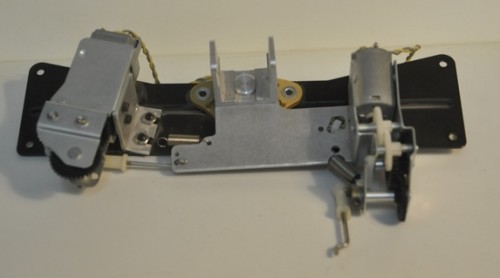

etoarmor.com still has one or two of Daryl Turner's metal jagdpanther trunion kits in stock from the last run, it's supposed to be the bee's knees for solving the issues on the Jagd
Re: Tamiya Jagdpanther and Plate Spinning
pitstain wrote:etoarmor.com still has one or two of Daryl Turner's metal jagdpanther trunion kits in stock from the last run, it's supposed to be the bee's knees for solving the issues on the Jagd
Yes, I think that was the unit starring in Sevoblast's Jadgpanther upgrade:
Daryl's Gun Trunnion Modification
Daryl's Gun trunnion.jpg (19.33 KiB) Viewed 4539 times
I think that Adam (Ad Lav) also used this top-notch component in his highly desirable Jagdpanther upgrade. :thumbup:
