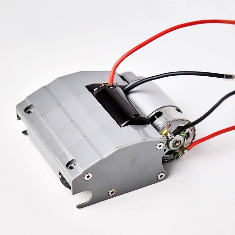

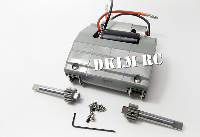

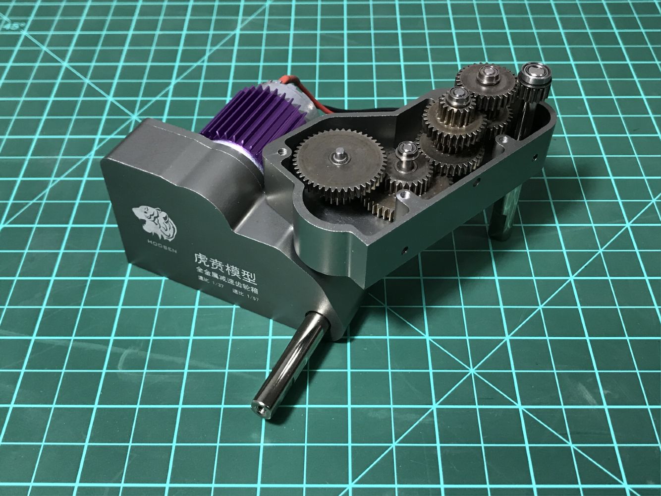

If you're looking for alternatives, FMP has been offering their double differential gearbox for some time, DKLM offers same exact gearbox under their brand & Hooben recently jumped on the bandwagon with their version due this month.
