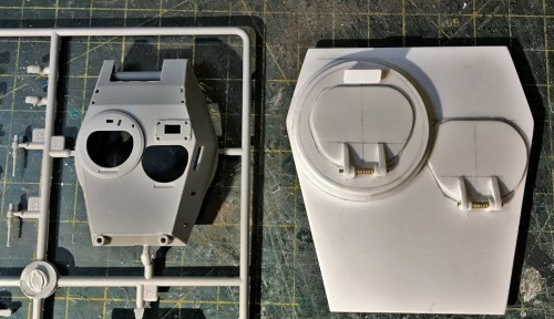

After analysis, i decided to reuse the Ludwig hatches by rounding some corners, and also decided to reuse their base. They are cut from the discarded Ludwig turret roof and prepared to be transposed on the new turret roof.

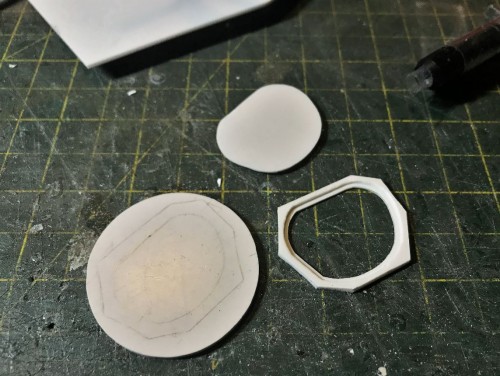

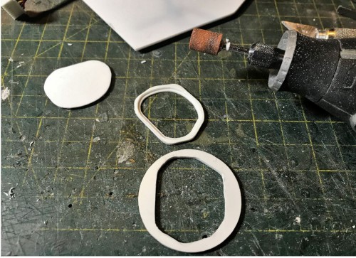

Grinding plasticard with a hard (cement type) file allows for better precision. It slowly remove plasticard material by burning it instead of chipping, and it makes no dust. The new position on the commander's cupola is prepared.

Here is the new turret roof, with a commander's cupola and the gunner's hatch slightly put backyard as per references.

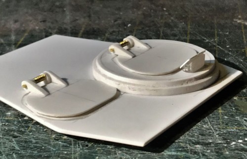

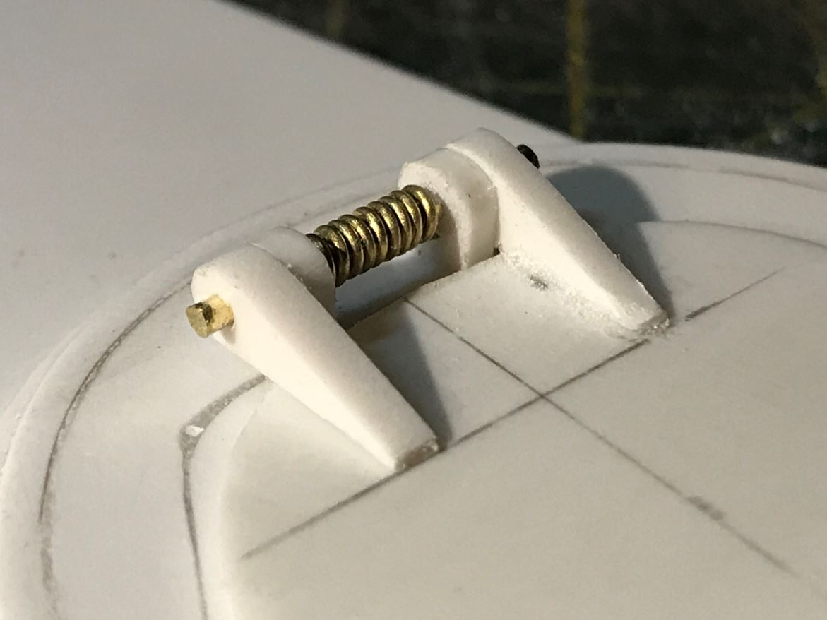

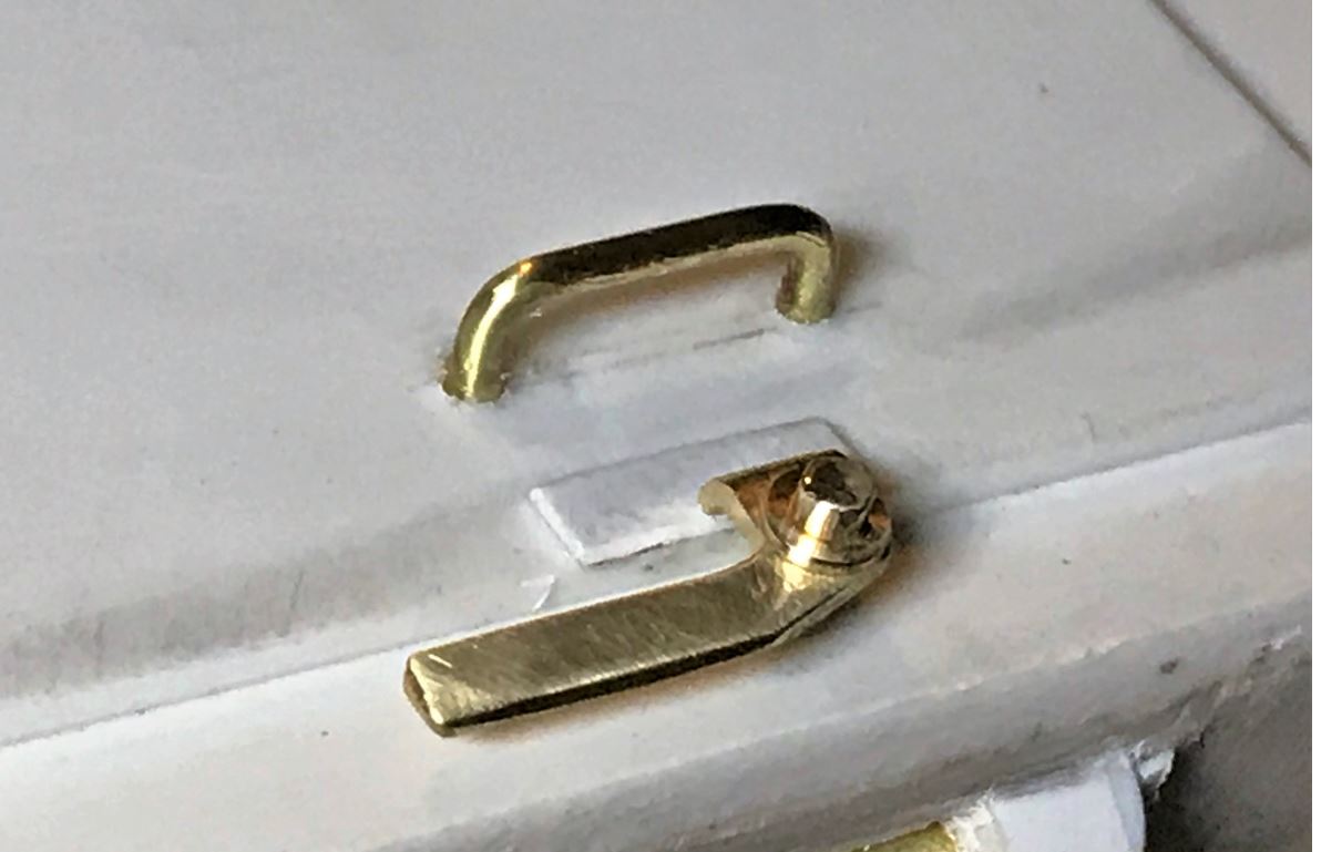

The Ludwig hinges can be used but must be reduced in size and adapted to match references.
RC 1/16 V-150 V150 Cadillac Gage Commando with 90mm Cockerill gun turret

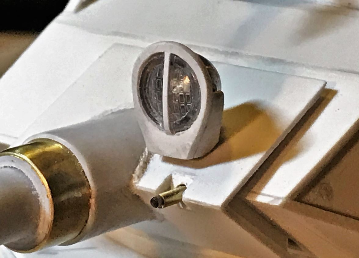

This is the gunner's sight made of solid plasticard plate glued and filed to match the shape. 1.2mm brass rods were used for the guards, assembled with superglue and then polished. Its more solid than any soldering that I would be able to manage.

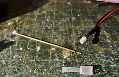

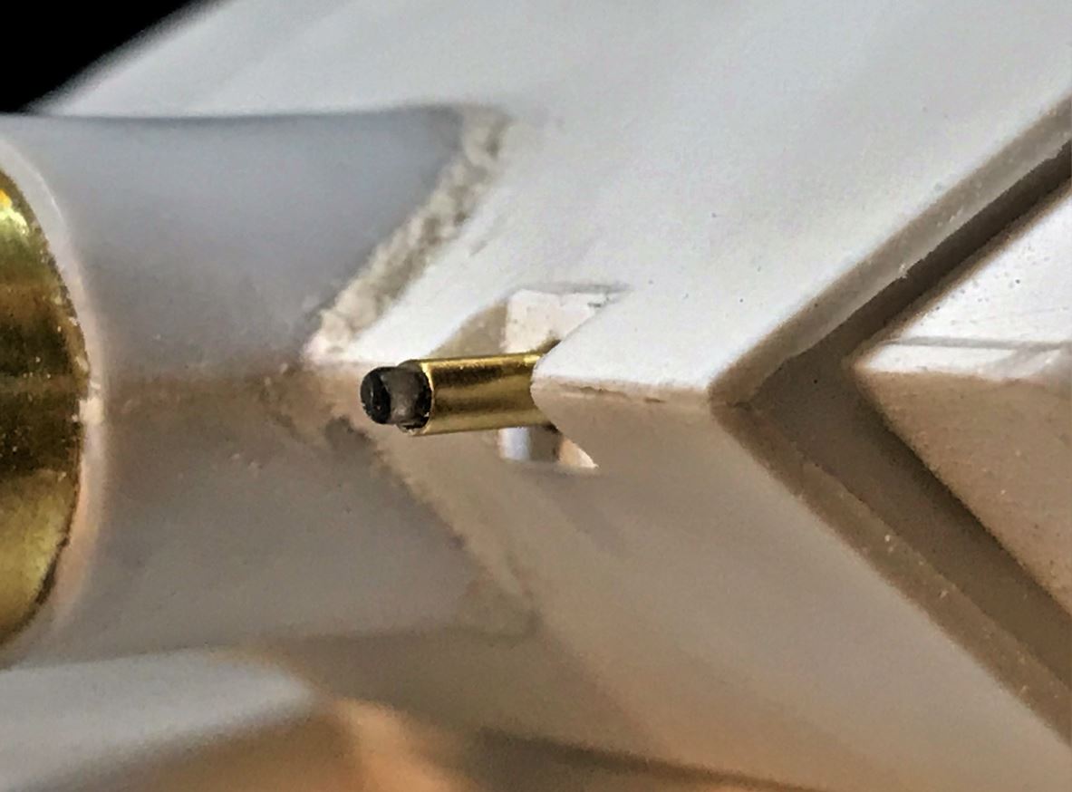

The coax machine gun is made of brass tube and 1mm fibre optics. Notice the cable holder, purchased from Robotshop.com at the same time as the fibre. Its works well in keeping the 5mm LED aligned with the fiber, its worth the 50 cents.

The coax machine gun, of an undetermined type, is installed.

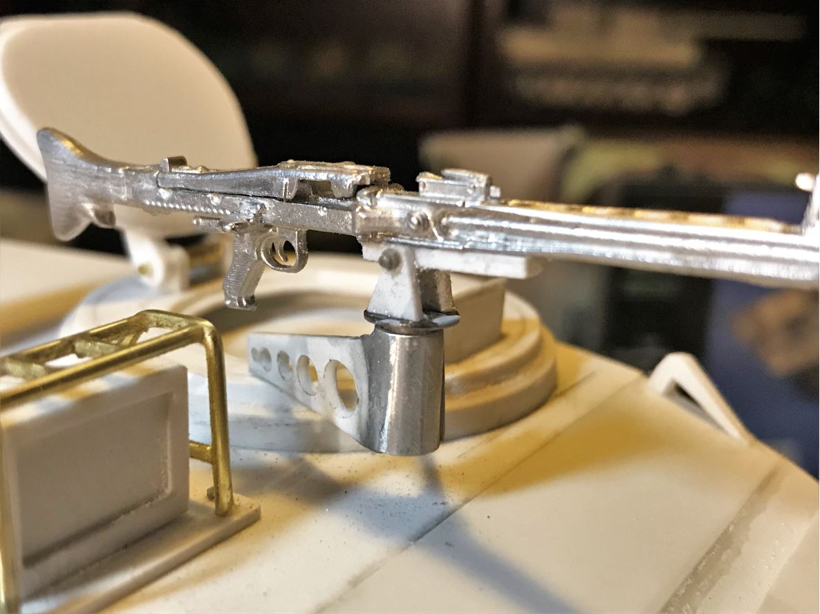

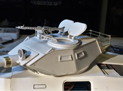

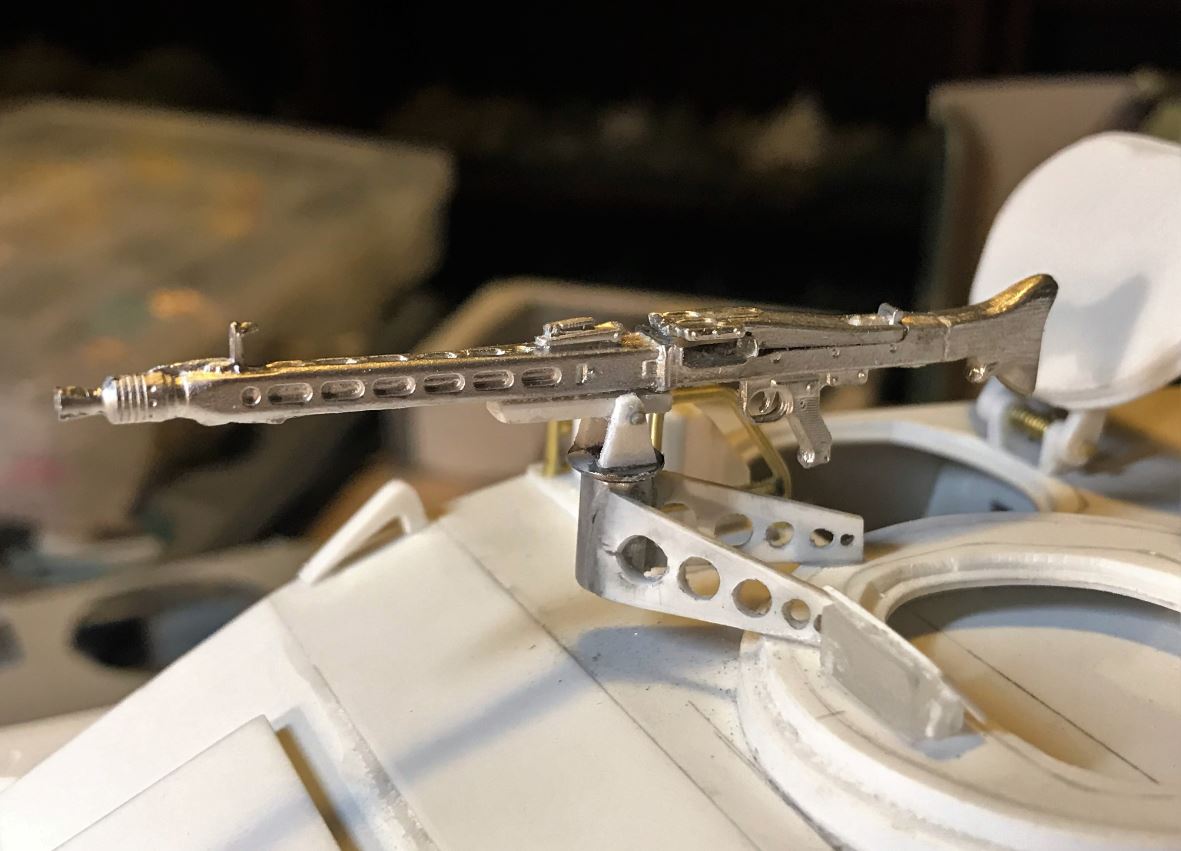

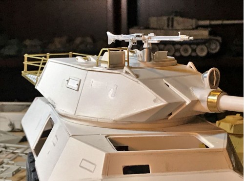

The V150 in Royal Thai Army service are equipped with a German MG3 machine gun on the commander's cupola. The base is scratch built and I tried to mimic it the best I could.
Continuing on following post
Re: Cadillac Gage V-150 Commando with 90mm gun turret - Buil
Posted: Sun Nov 03, 2019 10:35 pm
by lmcq11
The MG3 and mount viewed from the other side

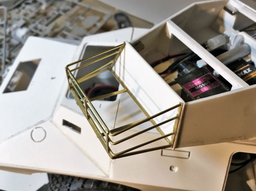

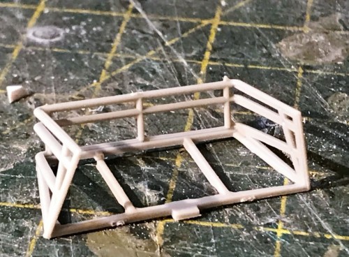

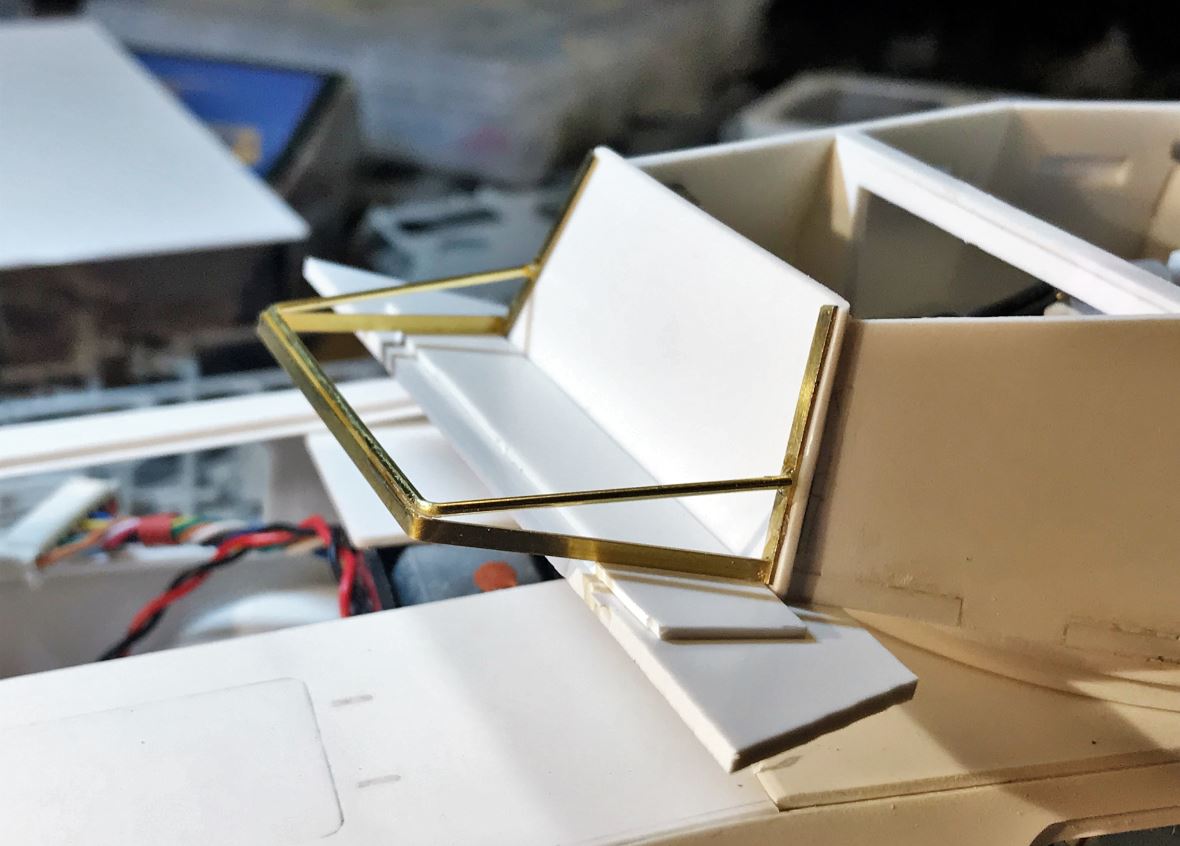

The turret basket is a good challenge, here is the Hobby Boss 1/35 kit basket used as reference. Notice the angles.
I temporarily put a plasticard base with two drop of superglue for the telescopic building of the turret basket. The brass parts are solidly resting on the plasticard strip, the time for the individual components to be created and glue to dry.

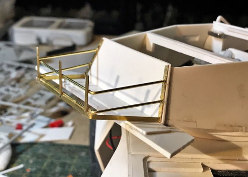

The turret basket is raised telescopically, one part at a time, checking all angles as it go up, it went very well.

The finished turret basket, a two hour delicate operation. Not perfect but looking good. I will polish the brass once the superglue is fully dried.

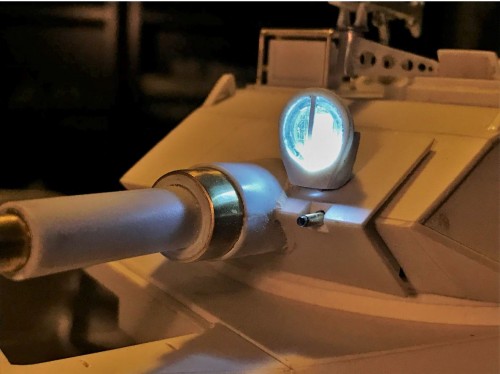

The searchlight mounted on the mantlet is a metal T34 searchlight, dressed up to look similar to the one on the V150 1/35 kit.

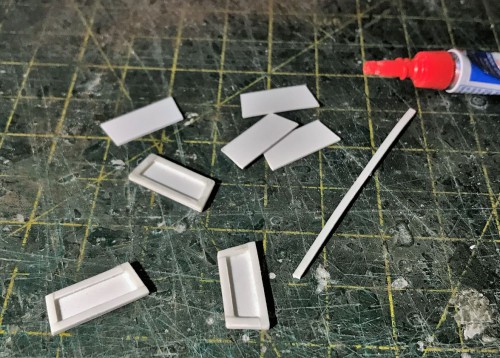

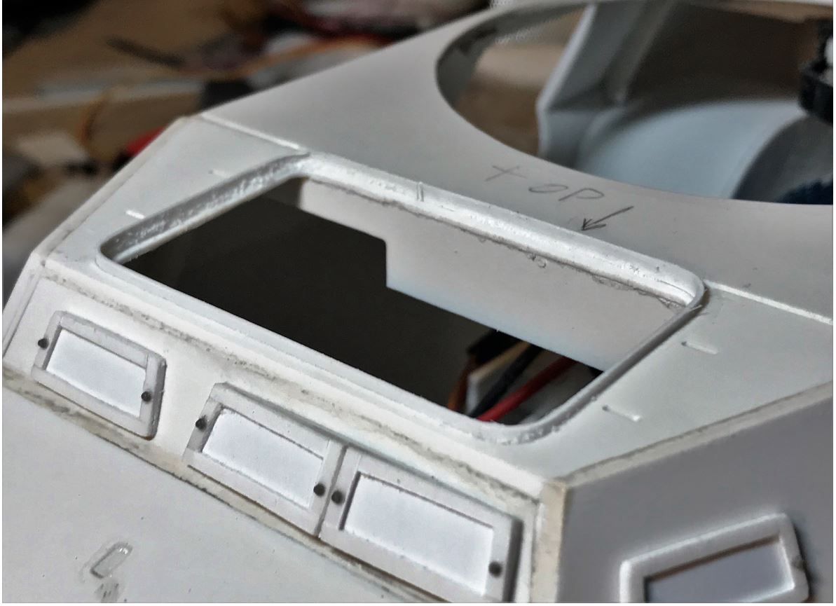

The visors are made of plasticard, dimensions taken from 1/35 kit. They fully cover the location holes on the model.

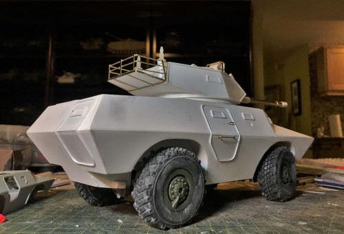

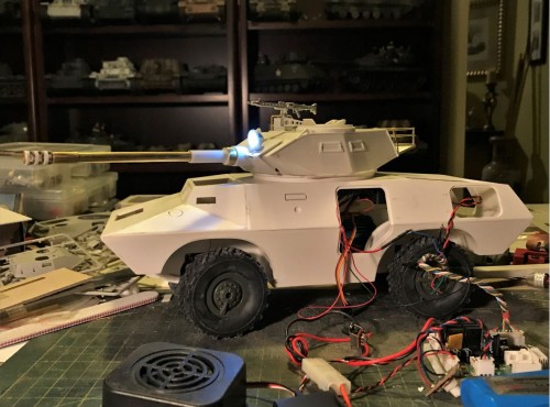

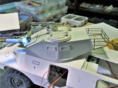

Overview of the model as it stands today. Remaining to be created are the smoke grenade dischargers and the antenna bases.

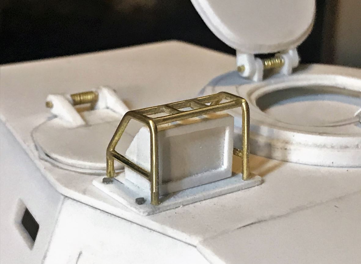

Installing the gutters around the doors and hatches.

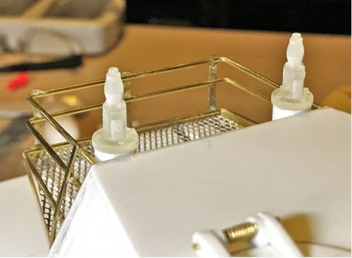

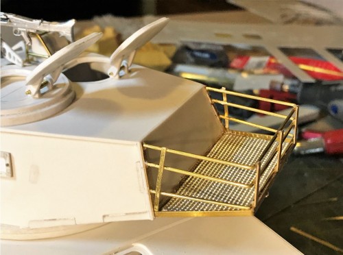

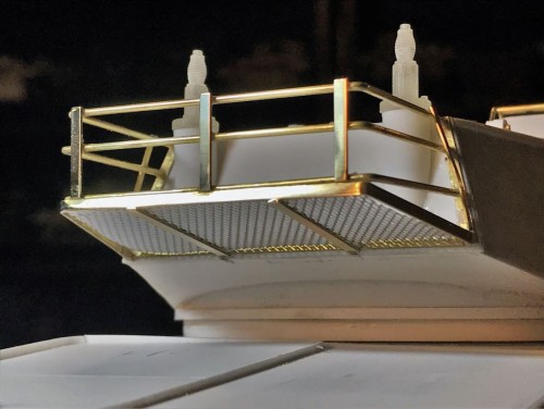

Installing the Shapeways MX6707 US antenna bases at the rear of the turret. They looked good on the M48A3 build so I ordered more of these. Will be useful for upcoming M113s.

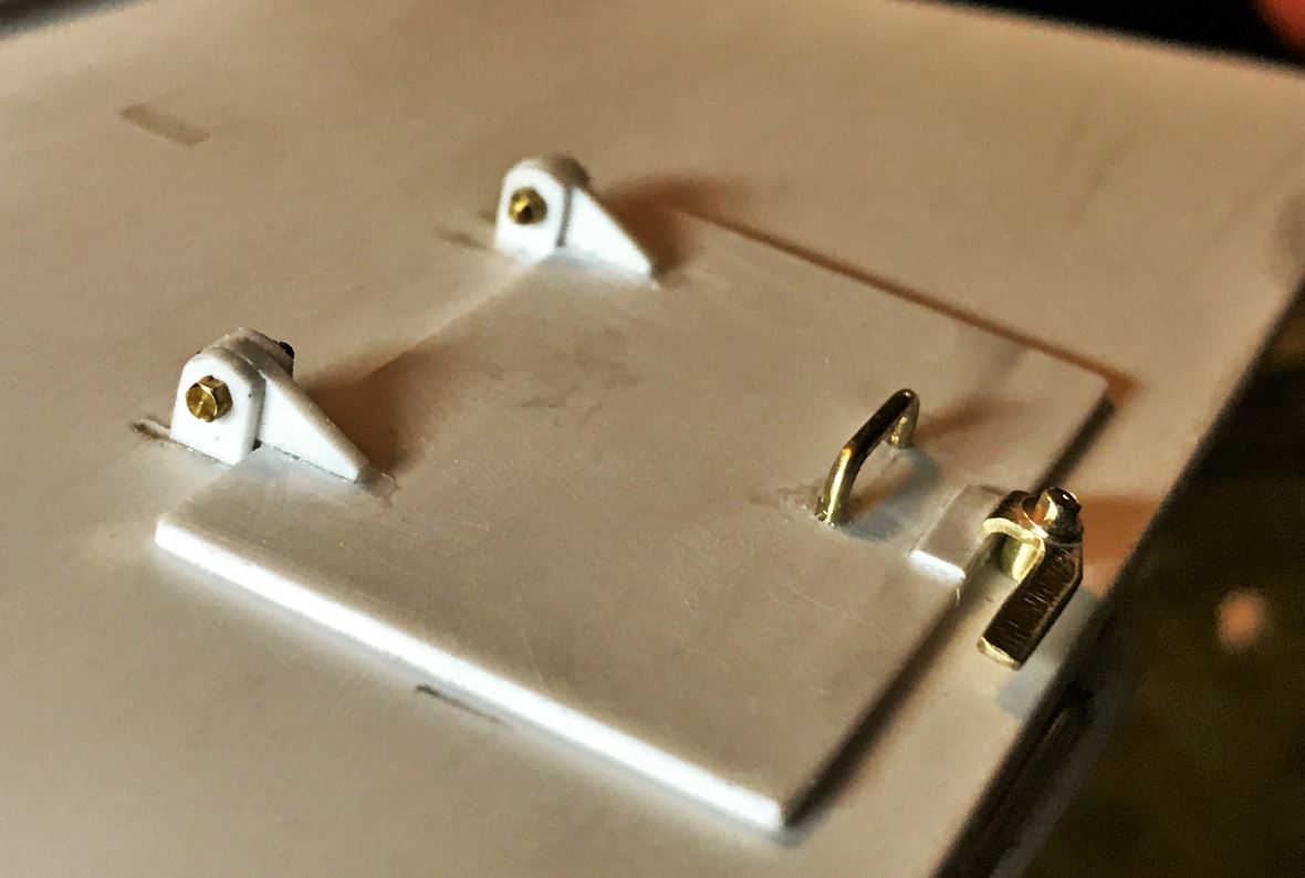

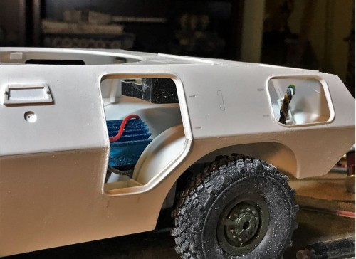

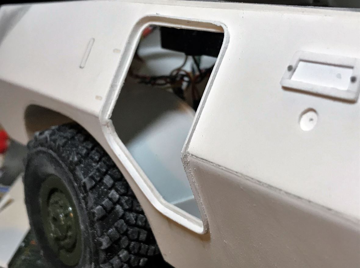

Started to build the doors and hatches. I saw no point in making operating doors since there is no interior.

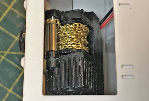

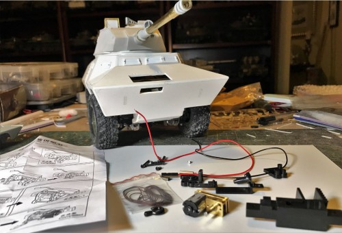

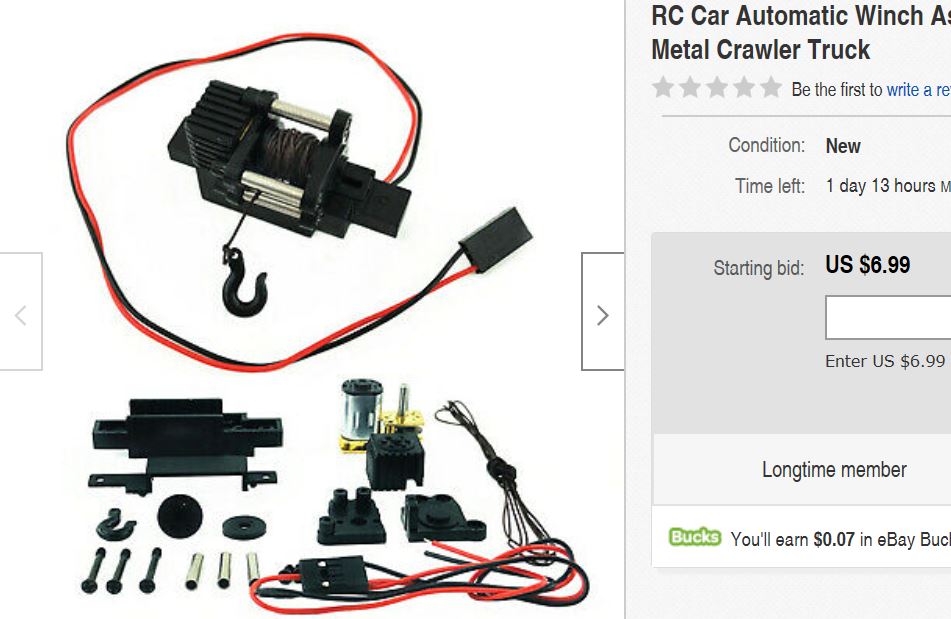

Inspection of the WPL motorized winch components for adaptation and internal installation into the slot at the front of the V150 Commando. As with the real vehicle, the winch maintenance hatch above it will be useful. This electric winch is available for a few dollars on eBay and is a nice diversion.

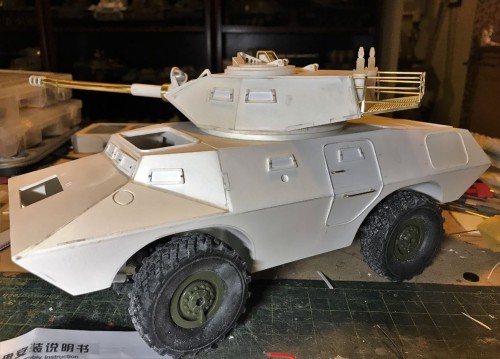

The vehicle as it stands today. This is going to be a good looking Armored Fighting Vehicle. I wish WPL could create AFVs instead of N variants of truck chassis. I personally find that wheeled combat vehicle are much more interesting to build and operate than simple trucks to drive around.

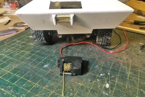

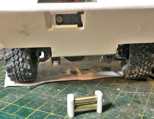

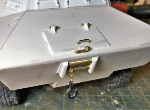

Hi, here is the frontal winch.
The winch can be seen here on the left of the lower front armored plate.
The WPL winch can be purchased on eBay for a few dollars.
The outer frame and rollers of the winch need to be scratch built.
The winch has been assembled as per instructions but I removed two of the rollers as they have been replaced by custom ones, and cut a few un-needed brackets. A metal chain has replaced the provided cable.
The winch is installed inside the model with simple brackets, it just slides into place and can be removed if needed through the maintenance hatch.

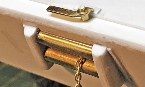

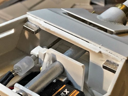

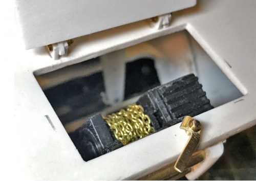

The winch maintenance hatch is scratch built and provided with working hinges and closing latch.
I connected the winch to the TK40 gun elevation motor wires 5 and 6 of CN9 and is activation with the left stick up and down, which give the little chuck chuck chuck sound.
For gun elevation, the servo has been directly connected to channel 6 and is assigned the VRa knob instead of being controlled by the TK40 through sticks. I find that this arrangement provides better control over the gun elevation, but it mainly allows me to control the winch as well.

Here is the final look of the winch arrangement. The operation of the winch needs to be done carefully as to not burn the small motor or damage the gears. It add a cool RC component to the model. I'll replace the plastic WPL hook by a smaller metal one on order.

Posted: Sat Nov 09, 2019 10:03 pm
by HERMAN BIX
That winch is an excellent addition to an already stash out build.
