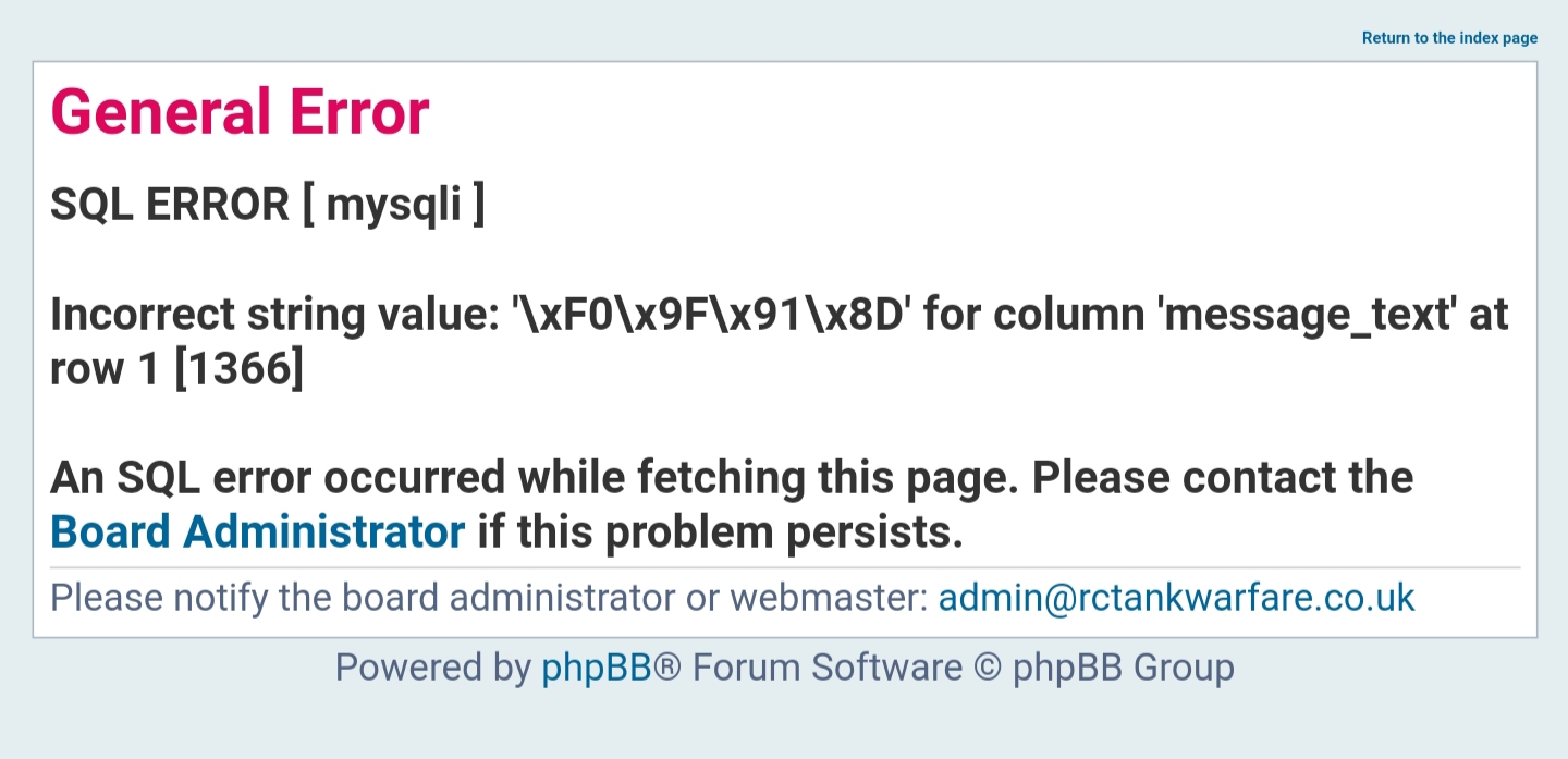

That would be great! Thanks. However, I'm getting a weird error trying to PM you!Max-U52 wrote:Chrizh, that plug is the trigger switch, and goes on the two left-most pins next to the three pin plug for the volume control. I know, that plug is made for a five pin plug, but you just use the two pins closest to the three pin from the volume control. I have some special plugs that Erik sent me, PM your address and I'll send you one. It has a five pin on one end for the MFU and a two pin with a short wire and your two pin plug will plug in there. As for the other end of the wire and where it goes, it eventually gets to the trigger switch on the back of the airsoft unit.
You probably don't have track recoil or cannon sound when you fire it, right?
Re: Need a answer
I just sent you a PM so hopefully you'll be able to reply.
